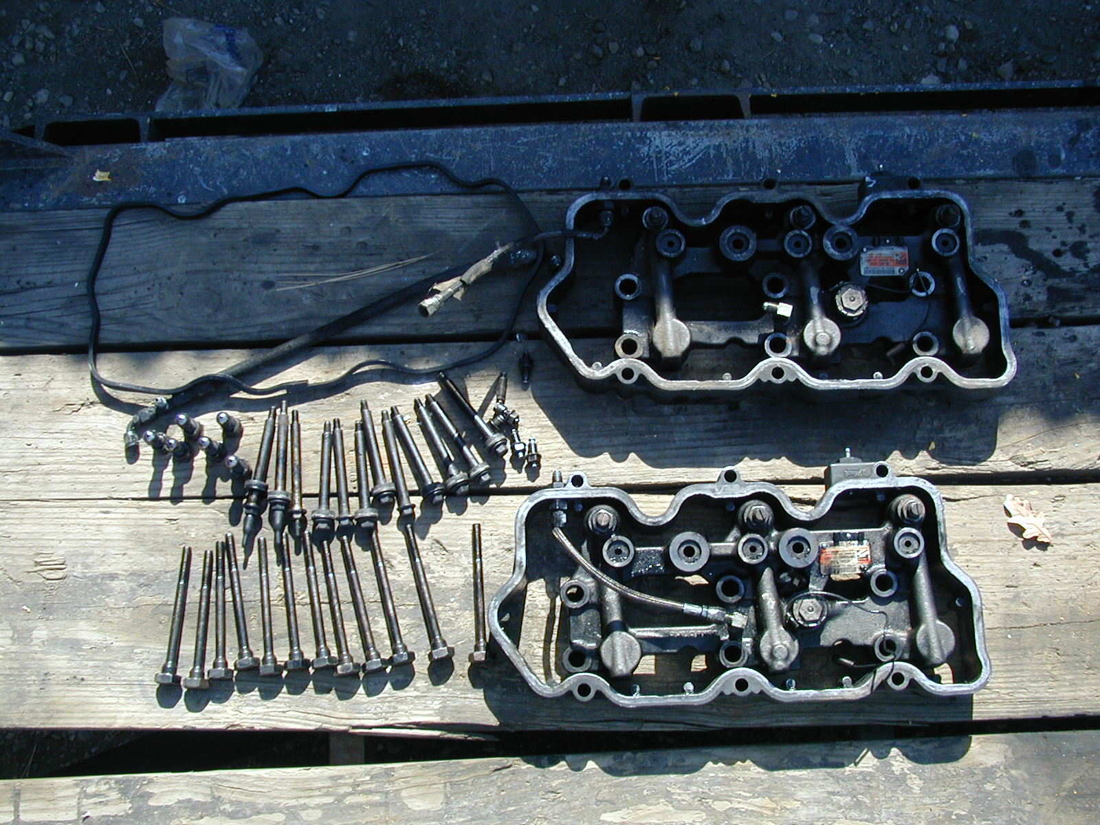

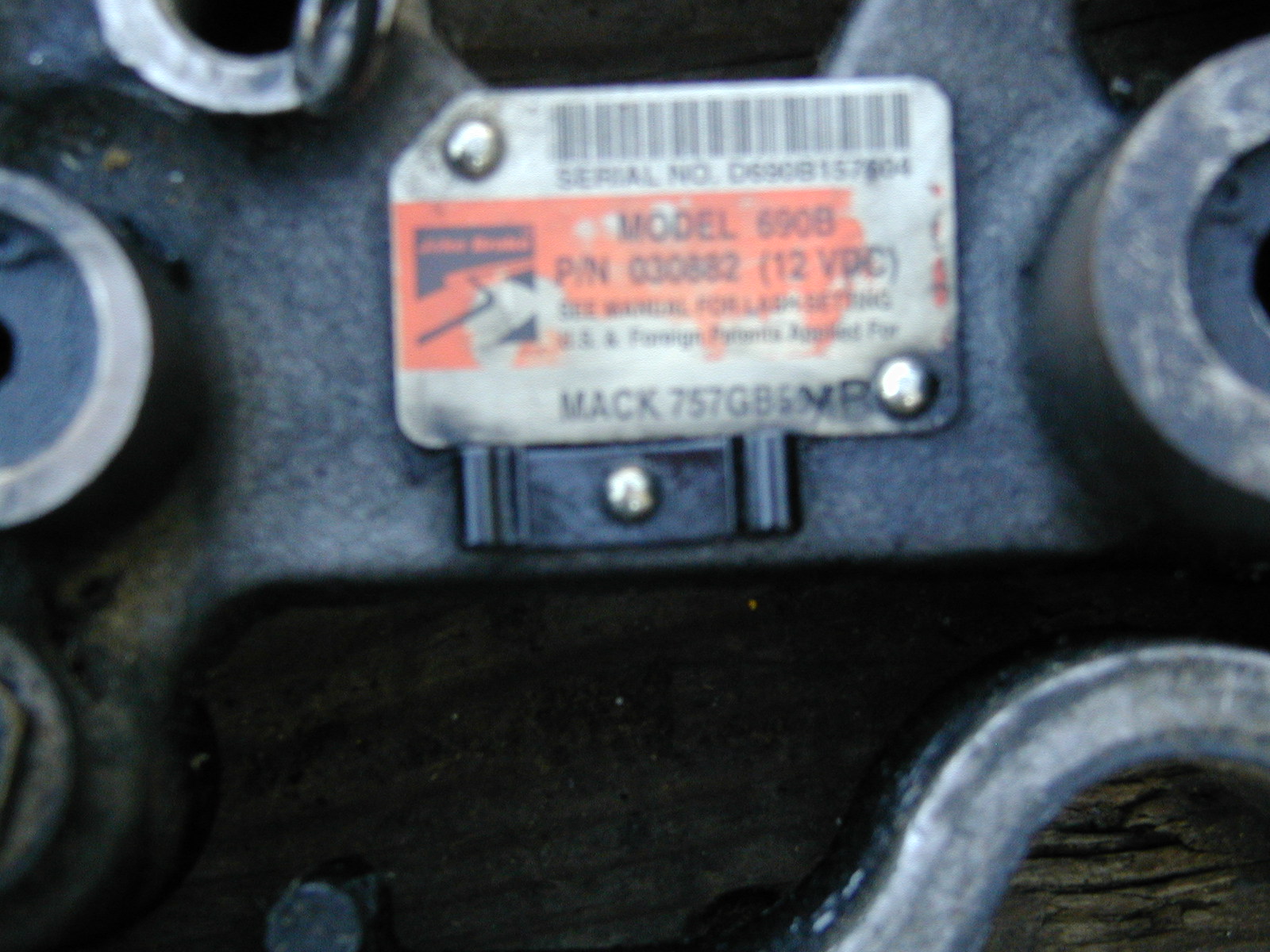

  24. Any body know if a 690 b jake will work on a mechanical e 7 motor?Anyone wanna swap a set of 680B for a set of 690B
