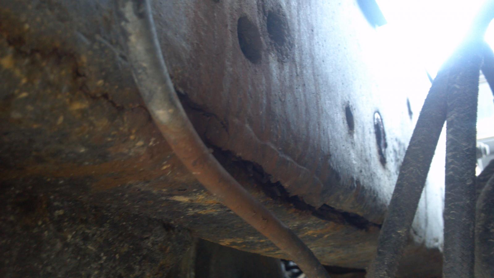

  8. Anyone have any experience with pg adams? Theyre about 1.5hrs away. Im going to talk to bruce at global truck traders tomorrow and see what he has available. He's about 45 minutes from my sister, might have to load up the family and go on an overnight parts run!

  12. Sort of what I had suspected, but I was hoping it was savable. I really like the truck, and if it had a 300 with a jake I would feel better about re-railing it, now I'm wondering what direction to turn again. I'd like to "patch" it up and run it, but I don't want something that could hurt someone.

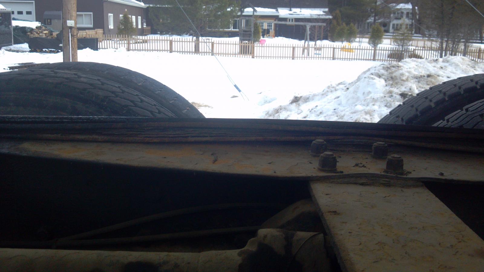

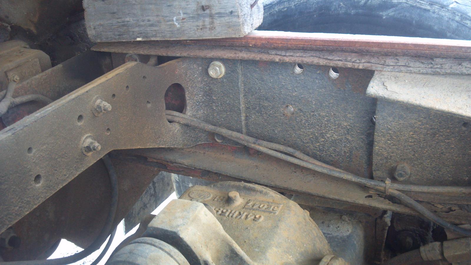

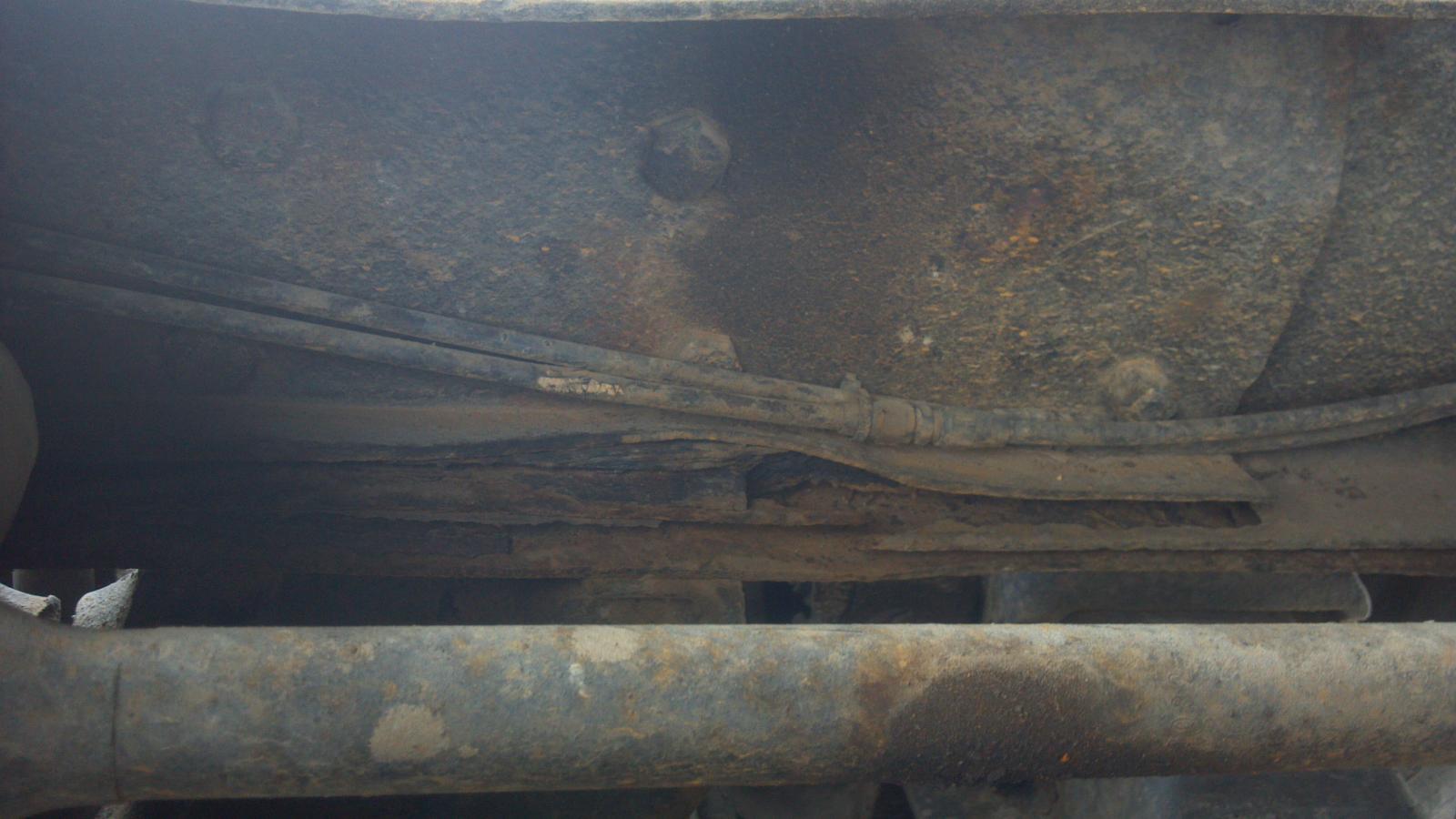

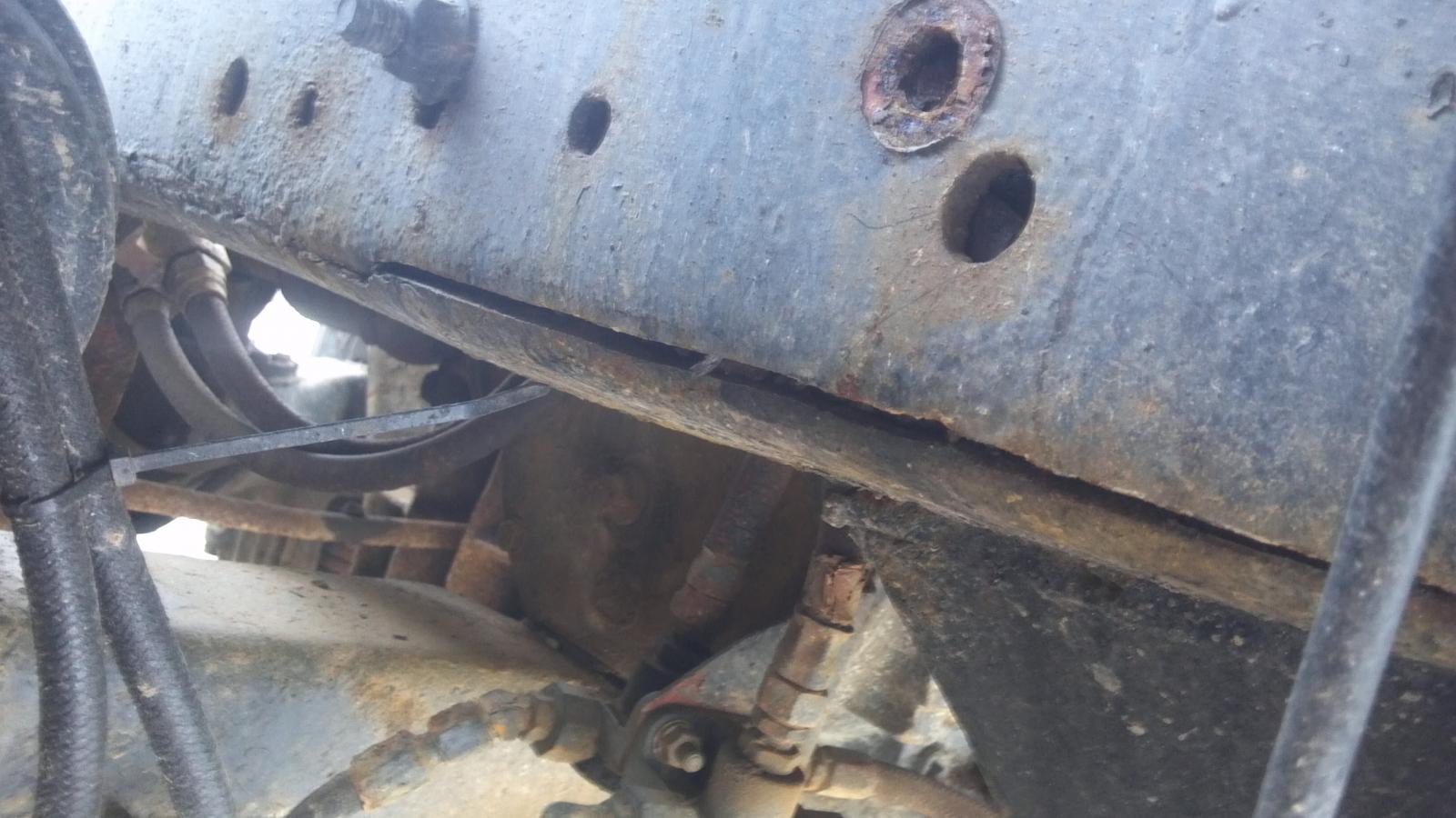

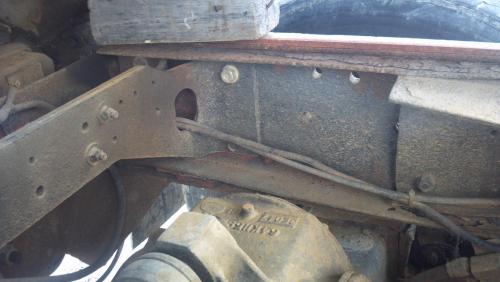

  13. Here are a few pics, the passenger side has been welded up before, as well as between the hangers on the drivers side. Its about 9'9" from the end of the frame towards the cab to where the frame is OK. So having seen the damage, whats the best way to repair it? Should I take the box and tires off, and beat on it to get some rust out, weld it and treat it, or is it worse than that? I wouldn't be opposed to re-railing the rear of the truck, but I'd like to have it make me some money first so if I could get it fixed up and run it for a while first that would be great. I'd forgotten about the 5th wheel I have too, maybe that would be better on there than a log body, then I could be much more versatile!!!

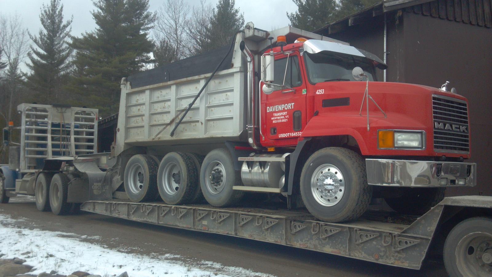

  17. Thanks oilburner. It has a Mack air suspension. I'm pretty ignorant on air rides, but it has mack stamped in numerous places. The owner has it permitted to carry 25 ton. If I were to permit it in NY, I would probably be able to carry 20. As of now I won't permit it, as I figure it I will be able to haul 15-16 ton without a permit. This will allow me to take a decent load across posted bridges. From everyone I've talked to it sounds like the air ride has some pucker factor at first, but after you get used to it, its not that bad. It should be nice on our rough roads around here too. She's supposed to be here tomorrow!!!! Sooooooo, that means the '74 is on the chopping block. If it had a bigger motor I would probably consider the tractor conversion, but its not really my ideal tractor specs. However If I can't sell it, I might still consider it. 1974 RD685 20 Fronts 58 Rears ENDT 675 237 HP 2 stick 6 speed 14' box 94,000 miles pintle plate a/e to rear. Make offer!
