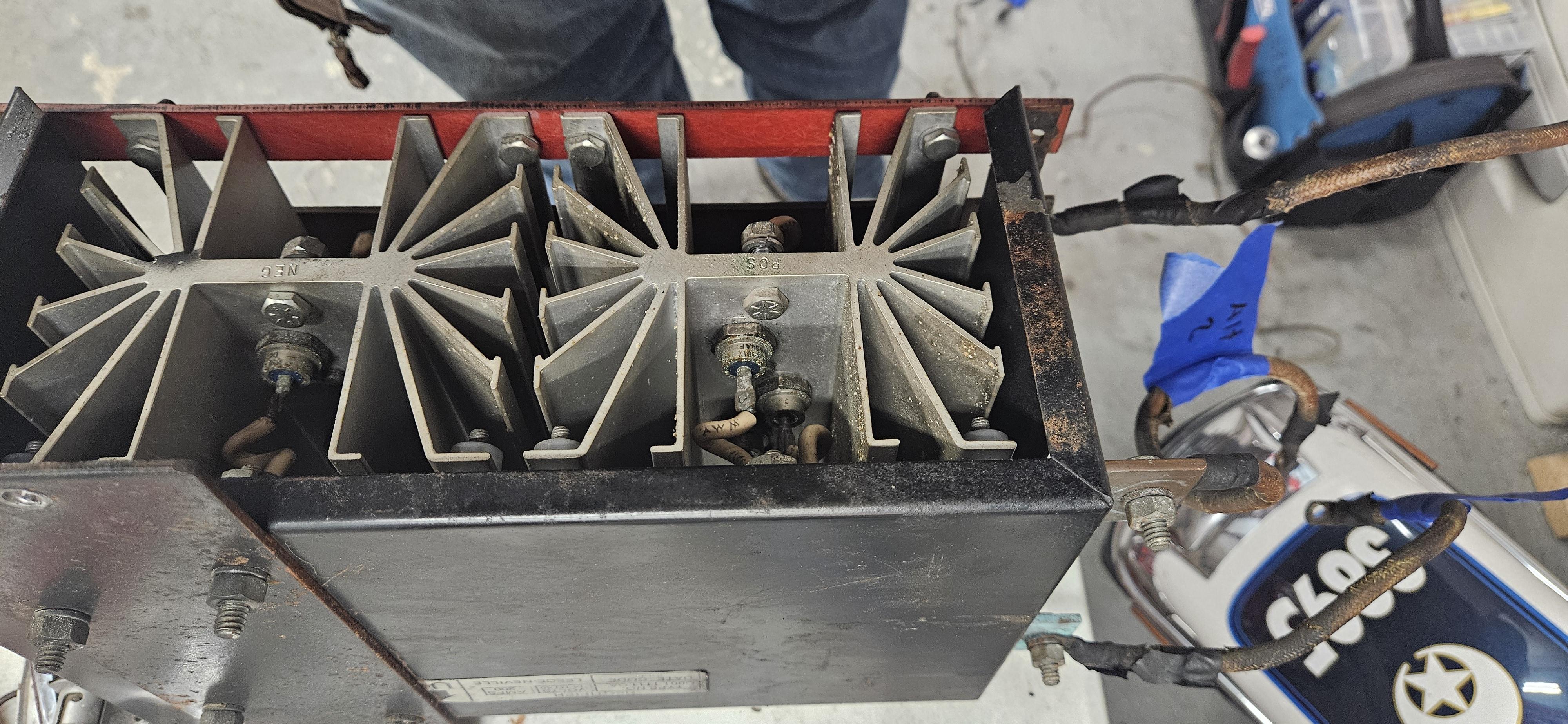

  5. We had multiple wires frayed, currently re-wiring the truck. The Amp meters both always read 0. Drove it an hour tho and it didn't die, so maybe it works. So can't truly confirm it's function. The one bar marked AC is heavily blued tho. Wouldn't want to switch the grounds around tho bc the radio and siren are specifically 12v POS.

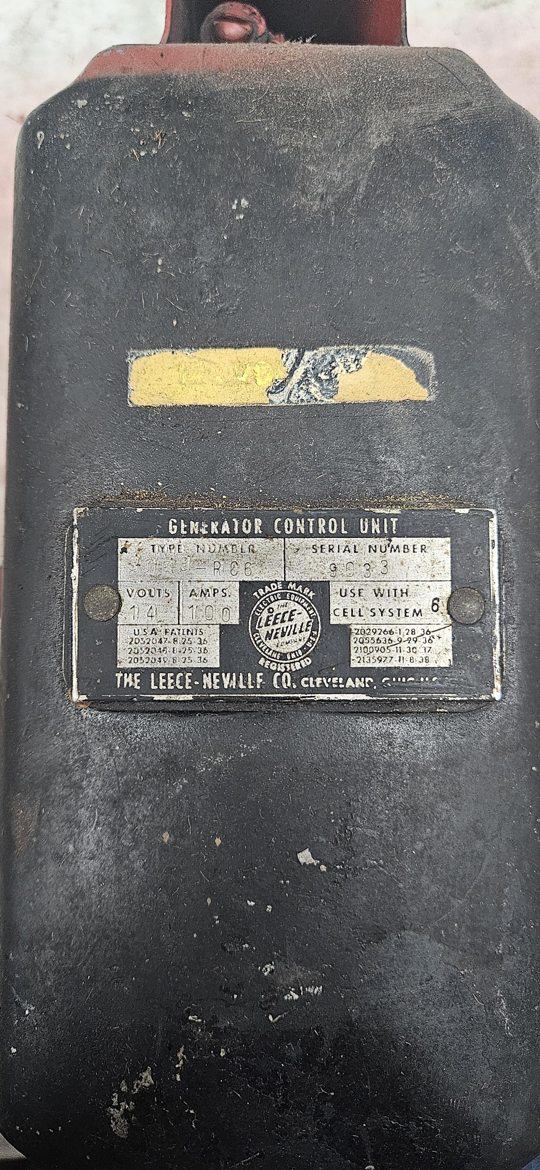

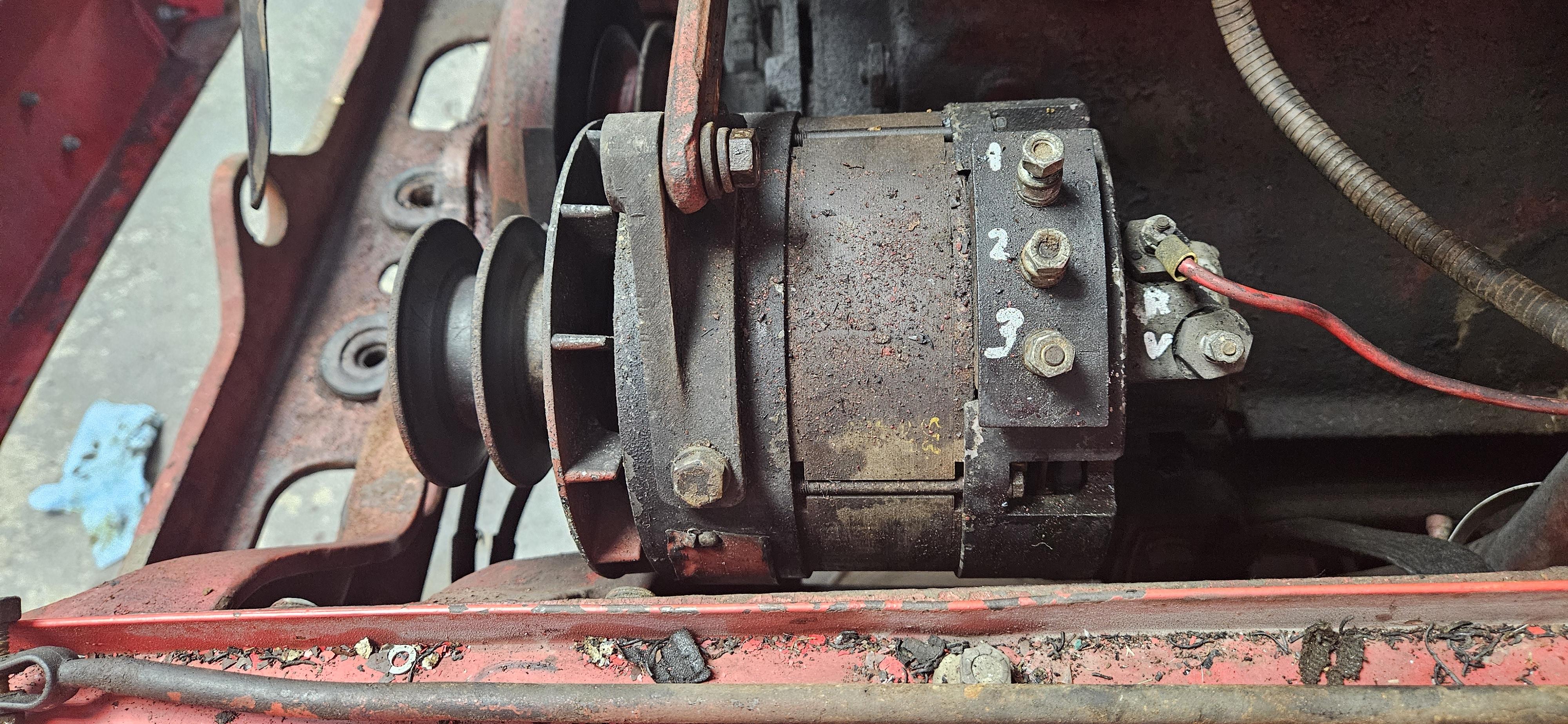

  6. Here's how ours was setup with 12v positive ground: -Battery Selector switch to "B" on voltage regulator. -Left Ignition Switch to "IGN" on voltage regulator. -"G" on voltage regulator to "NEG" on rectifier. -"GND" on voltage regulator to "POS" on rectifier. -"F" on voltage regulator to rear field post of Alternator. -the top post of the voltage regulator grounds to the mount/firewall. -the 3 larger posts on the alternator (phases??) went to the long 3 bars on the rectifier, they are marked "AC" on mine. - the other rear alternator post, I assume another field, goes to the "POS" on the rectifier. I'd love to get rid of all this and go single wire alternator.
  7. I have mine all pulled and mapped out. I'll share Saturday next time I'm messing with it how these fire engines are wiring with the rectifiers. I am looking to swap the system out to a 1 wire alternator tho.
