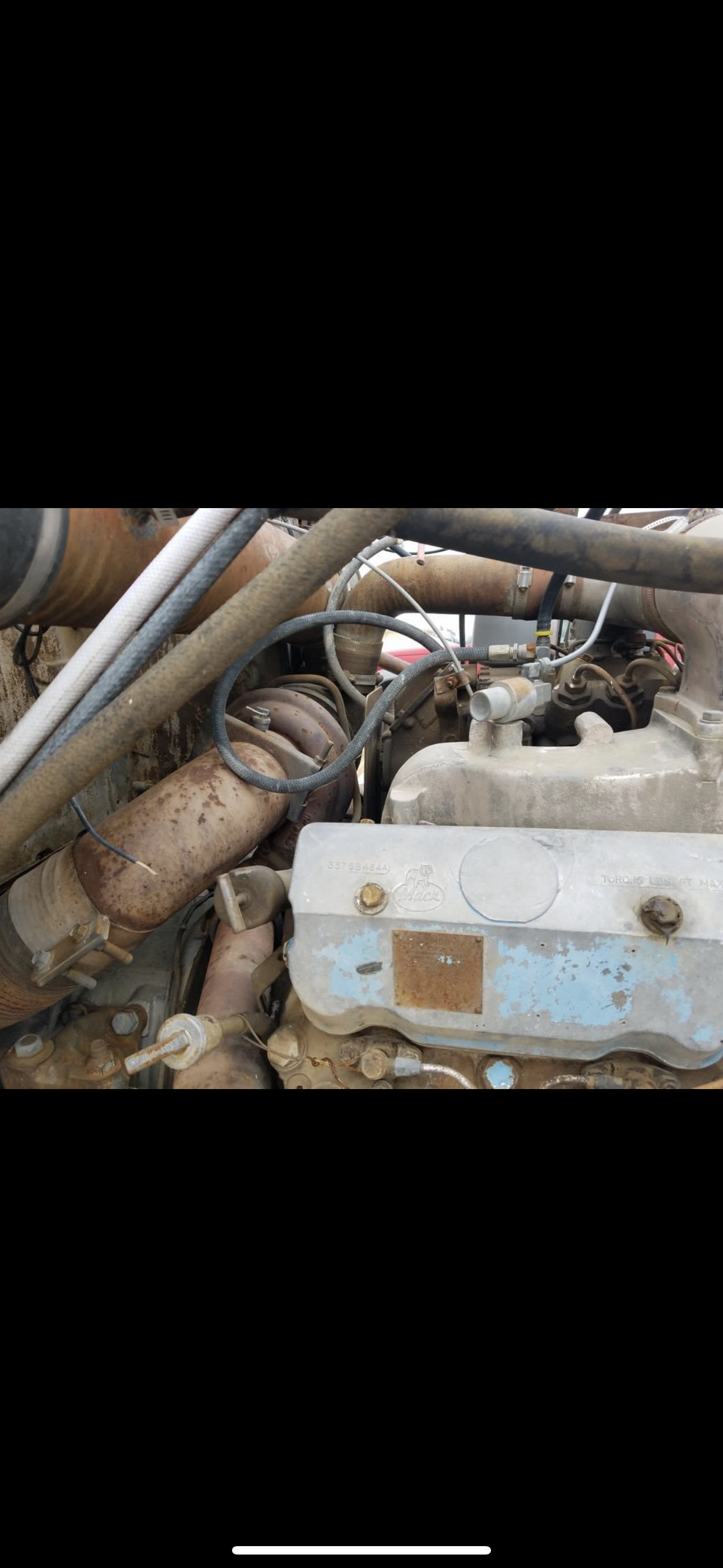

  4. I know it’s pretty difficult to identify with just some pics. If it’s the 866 I wonder if it’s the 375hp version. I read somewhere that Mack put the 12spd behind the 375. The cab interior pic looks like a 12spd. The truck is supposed to be a 74, R700. So was the 375hp version available in 74 ? So difficult to get definitive info on the old v8’s.

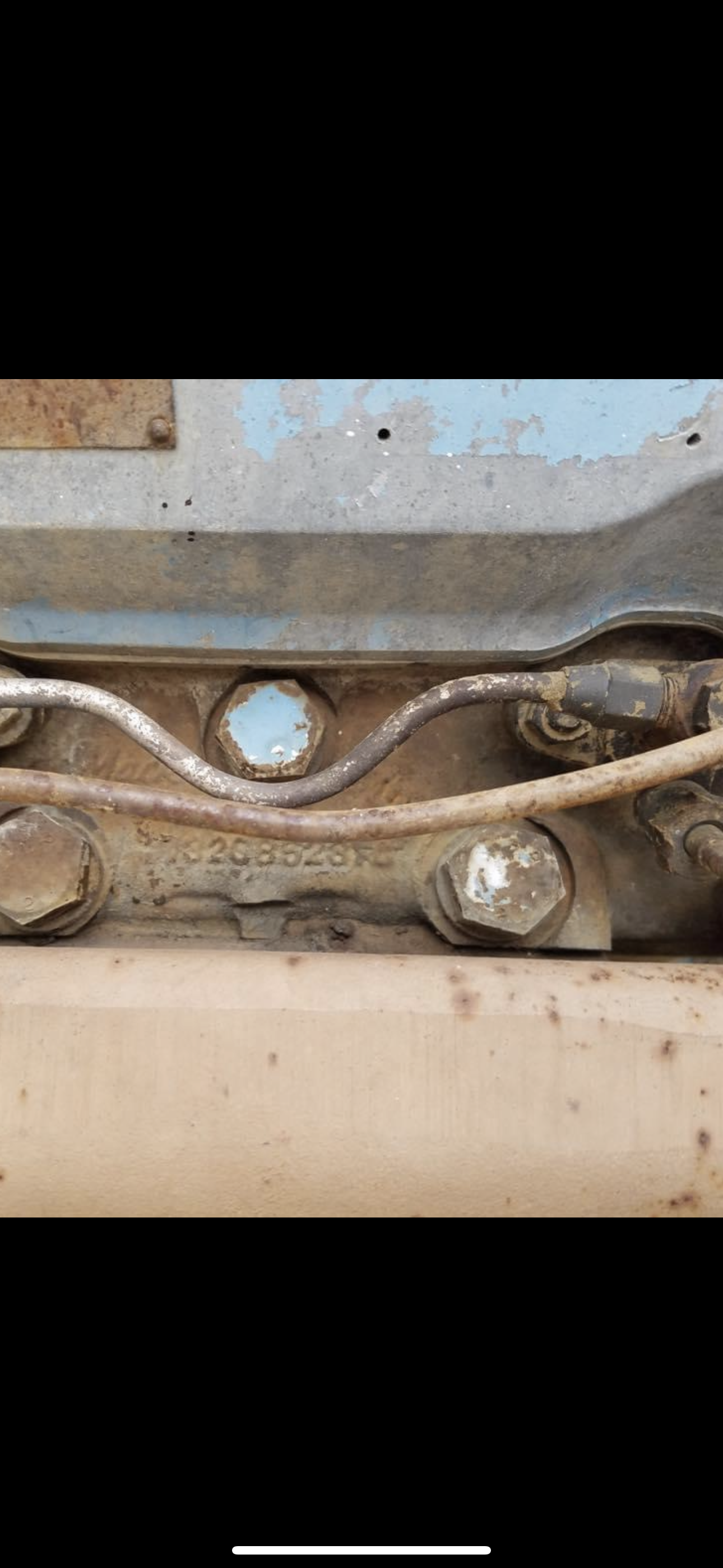

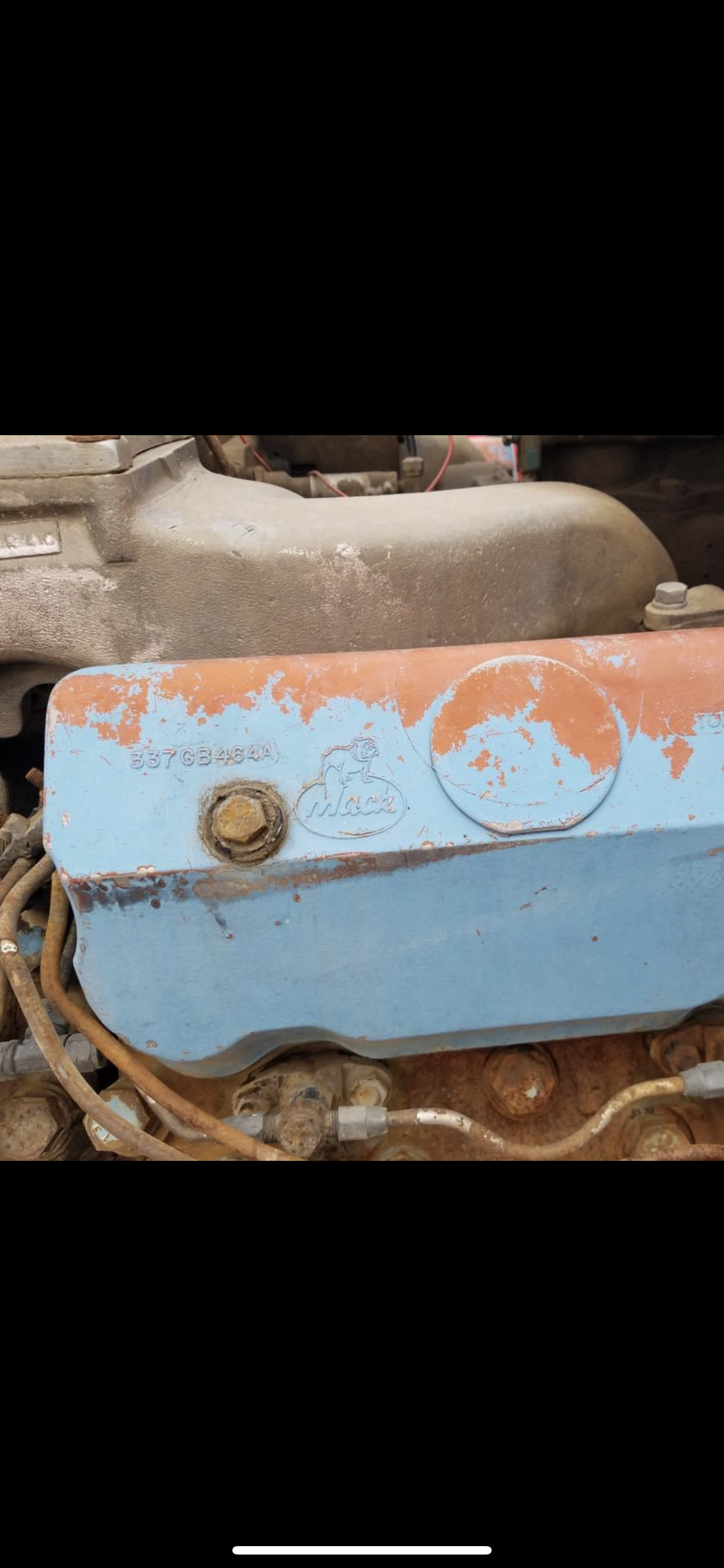

  5. Here are some additional pics of the V8 I am trying to identify. Hopefully in a week or so I may see it in person.

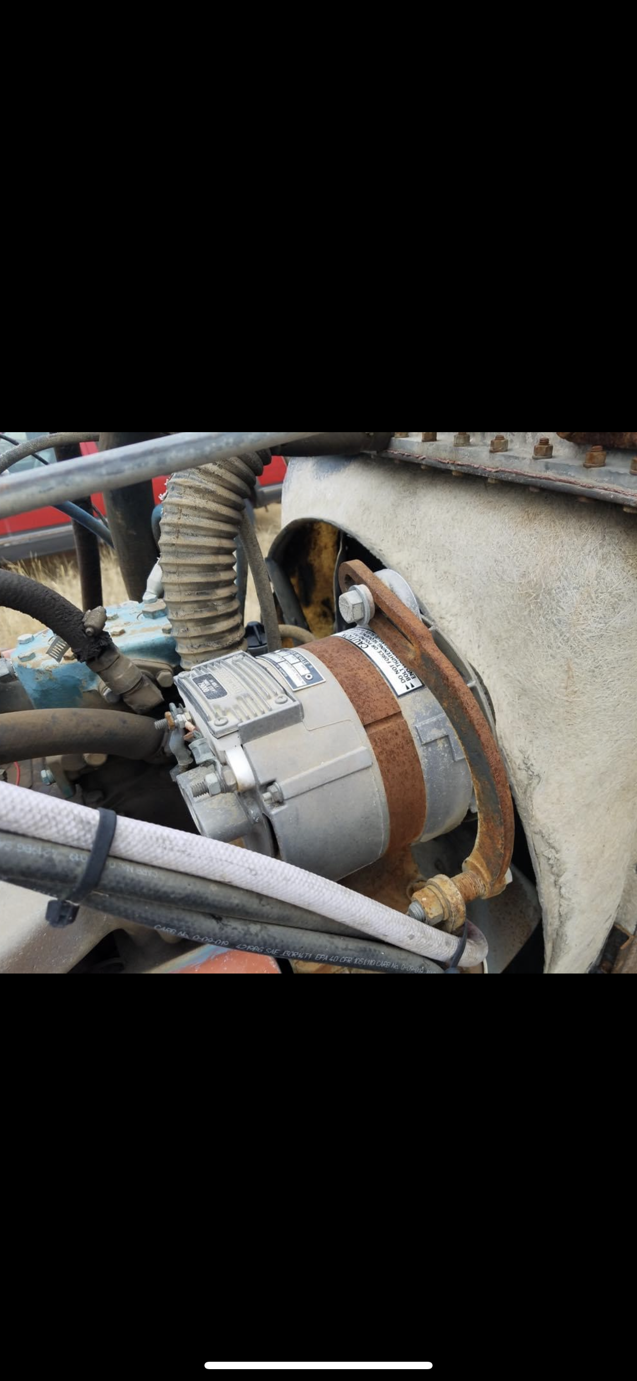

  6. Some trivia I guess. Can anyone tell which version v8 this was ? All I have are the pics at this point. 864,865 maybe 866 ? Sitting in a field in Wyoming. Thanks
