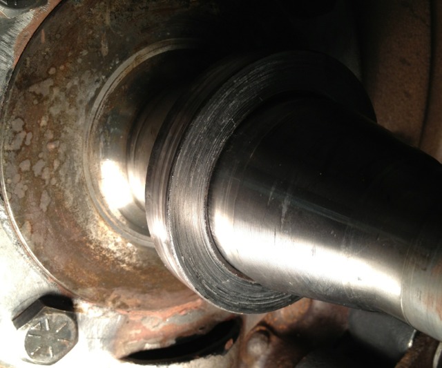

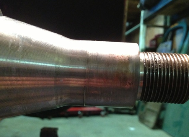

  2. BC Mack, It is a b model and it might be difficult to find a good replacement. If I need to replace the spindle and can't locate one I will look for a place that can chrome it for me. Thanks for the information. Trenton Sent from my iPad using Tapatalk HD
  3. To All, The bearings and cones look good with the exception of some galling on the inner bearings where it meets the wear ring. I found a set of wear rings and will get them installed tomorrow. I suspect that the groove on the bottom of the spindle is not as bad as I originally thought. I think there is a bur there that is making it look and feel more significant than it it is. I will file the bur off and assess the issue with a clear head. So what is the cause for this kind of wear-- bearing too loose or too tight? Trenton Thank you for the information. Sent from my iPad using Tapatalk HD
  4. Hi folks, I have a front spindle that has noticeable wear where the outer bearing sits. The wear is on the underside underside of the spindle. The wear ring is also less than perfect. Is there a repair method for the spindle? Is it acceptable to repair it or is replacing it a must (its a hobby truck)? What is the cause for this type of wear on the spindle and the ring? Appreciate your input. Trenton Sent from my iPad using Tapatalk HD
