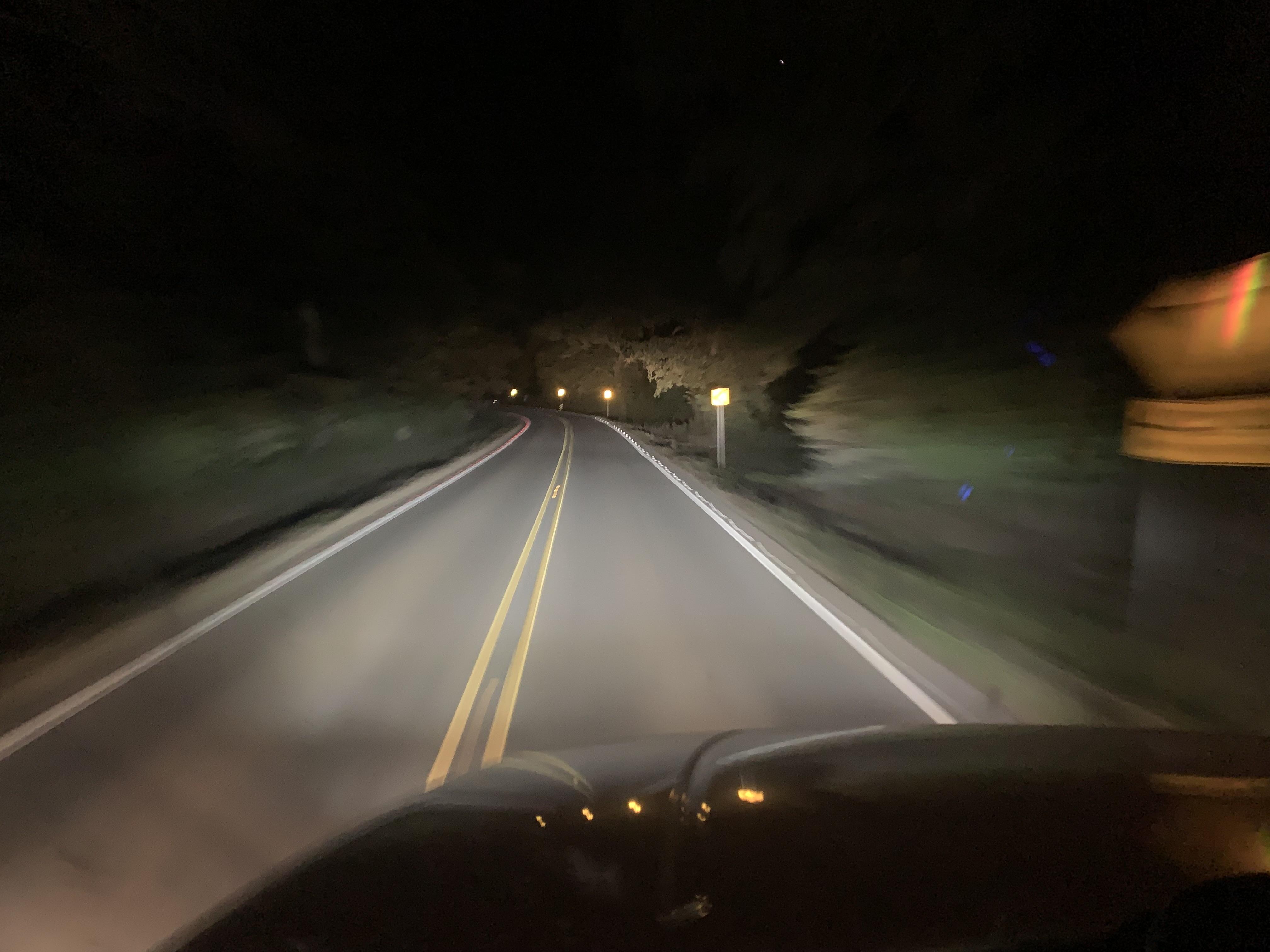

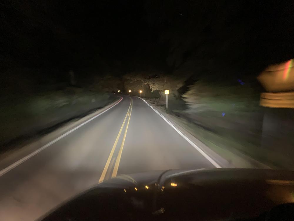

  4. I put the Doorman 8885126 & 8885127 in my 2013 GU713. I went with high quality LED Bulbs and load equalizers / anti flicker canbus decoders. They really light up the oil field lease roads at night !
