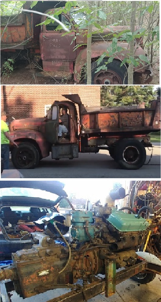

So here it is. I know a lot of people aren't too happy to see a "Slime green Dripoit" in a B, but I have my reasons. None of them are hauling 20 ton up Mt Everest or winning the Indy 500. Just love the sound of a Detroit and the look of a B-Model. Had to get pretty creative with the drivers side engine mount. The steering box was in the way. So i built a engine mount that brings the Detroit mount forward 4". Then I had to make a frame mount that could "Sqeeze" back under the steering box as far back as possible. My first attempt I tried using the stock Mack frame mounts. Even using my homemade engine mounts (reversed side to side from the picture) they would not bring the engine forward enough to clear the firewall or allow an exhaust manifold to be installed in any direction. This was the best solution I could figure out. Exhaust manifold will still be tricky. I have built the other side frame mount and I am able to use the stock Detroit Engine mount(Sorry no pic it was late last night when I got it built and the paint was drying". Now to the cradle front mount...

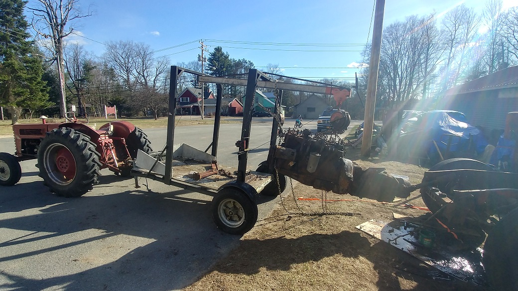

Little "Sketchy" Lift. This thing wasn't designed to lift this much...but it did it. The frame of the trailer is made from 3" thin wall tubing. The axle is mobile home and the arches are 2" x4" x1/4" Channel. The Ibeam is 4". She bent where the front angle braces are welded to the frame. I think it tried to rack when I had to jerk on it a bit. No Fear...I will use the engine hoist to install the 6v with out the tranny. Now its time to figure out how to shoehorn the 6v53 in there. Steering box and exhaust manifold are fight for the same real-estate. Rear engine mounts will need to offset to push the engine ahead enough to clear accessory pulley. Fun Fun Fun!

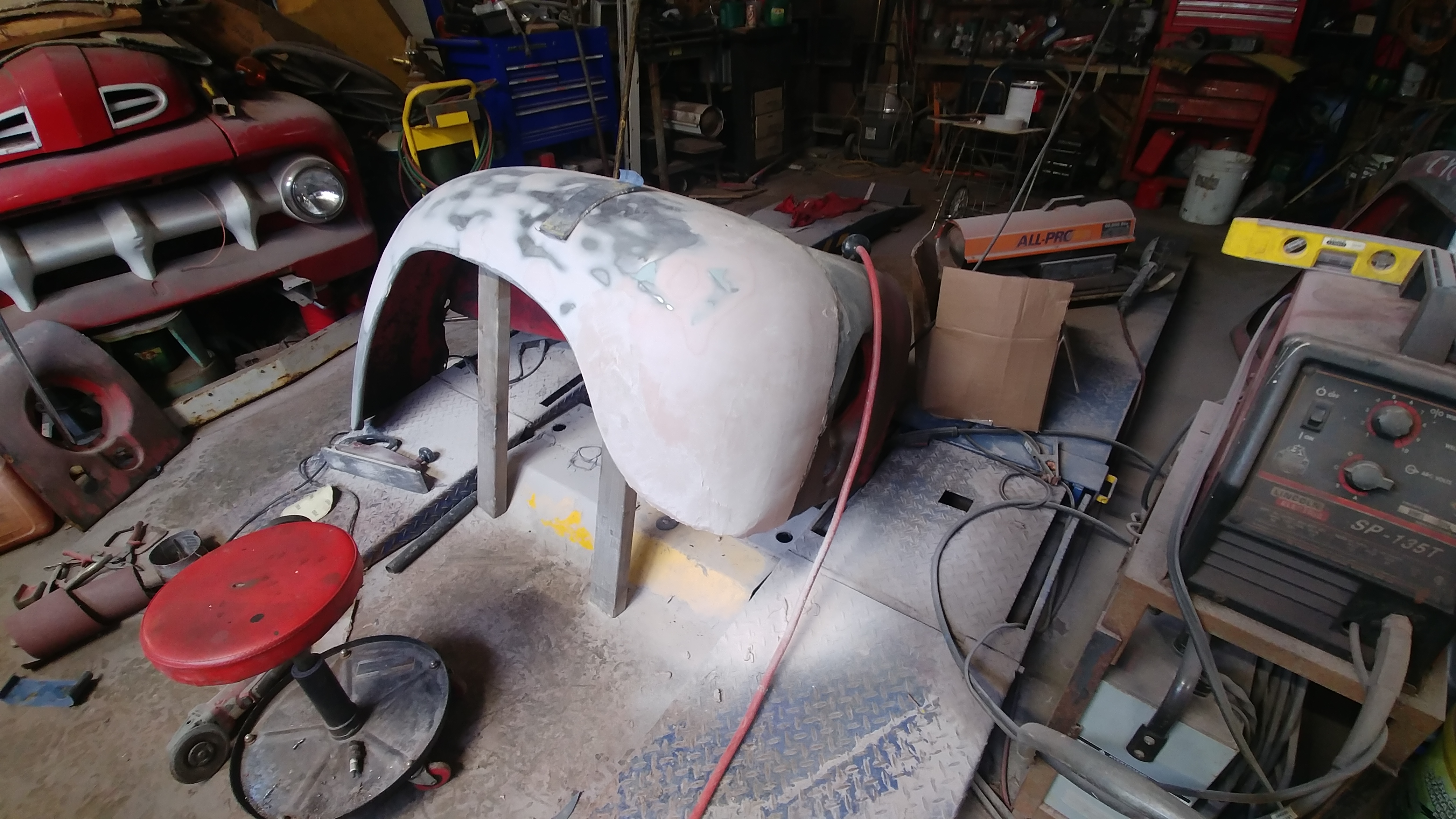

This weekend project. The fenders are going to be black so I'm trying to get them straight and use not 5 gallons of bondo. -
