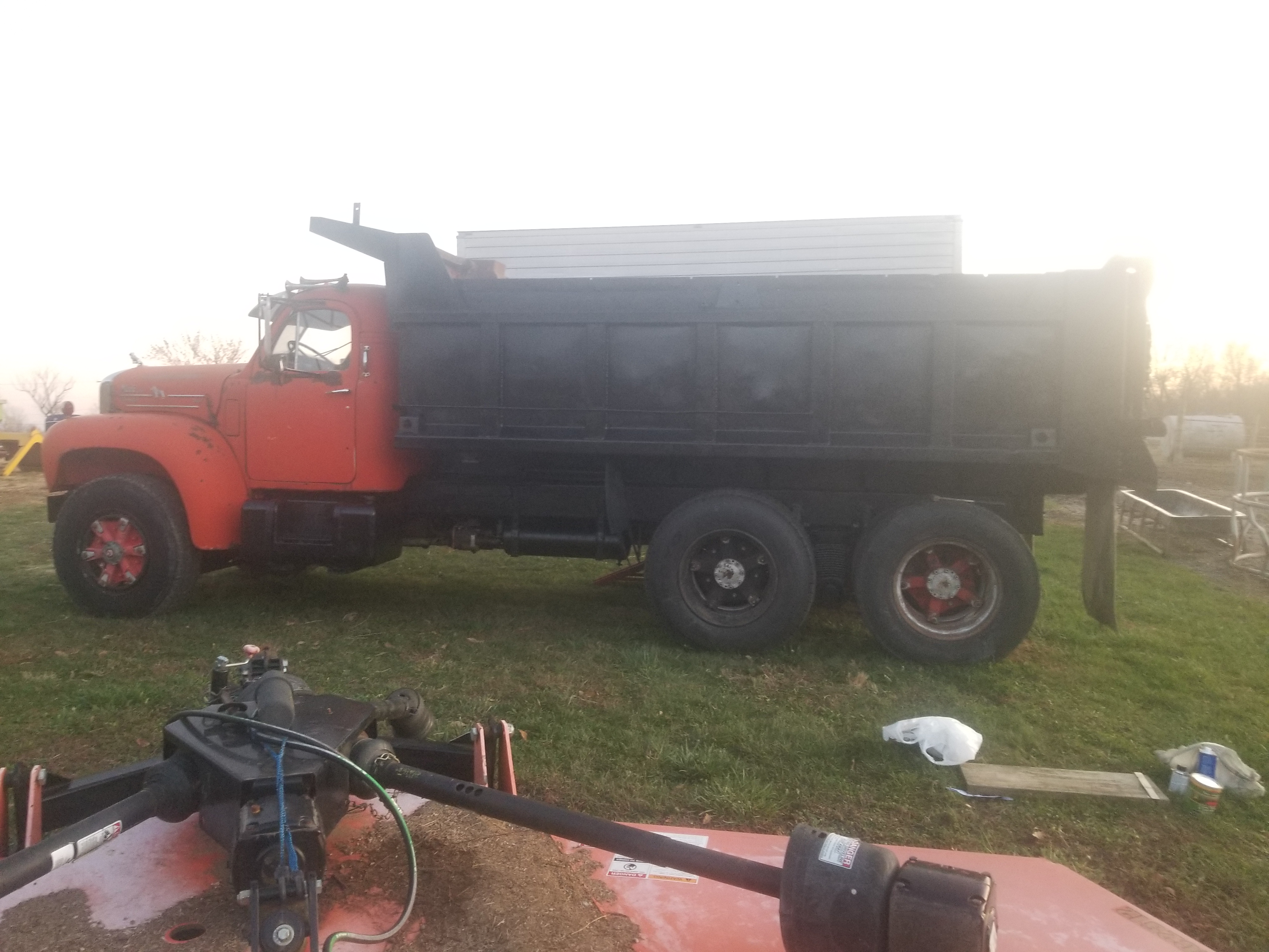

By all means it's all around a little lighter duty truck than I'd prefer. It's a R686ST and only a single frame truck too. It's not a very big tandem, only a 14ft box. It was a conversion done by a township after it had retired from pulling coal. So it'll never see the full 54k a regular tandem would see in this state. It's only been grossing 48,860 max lately. It's probably plenty on that chassis, but it has no problems toting it. -

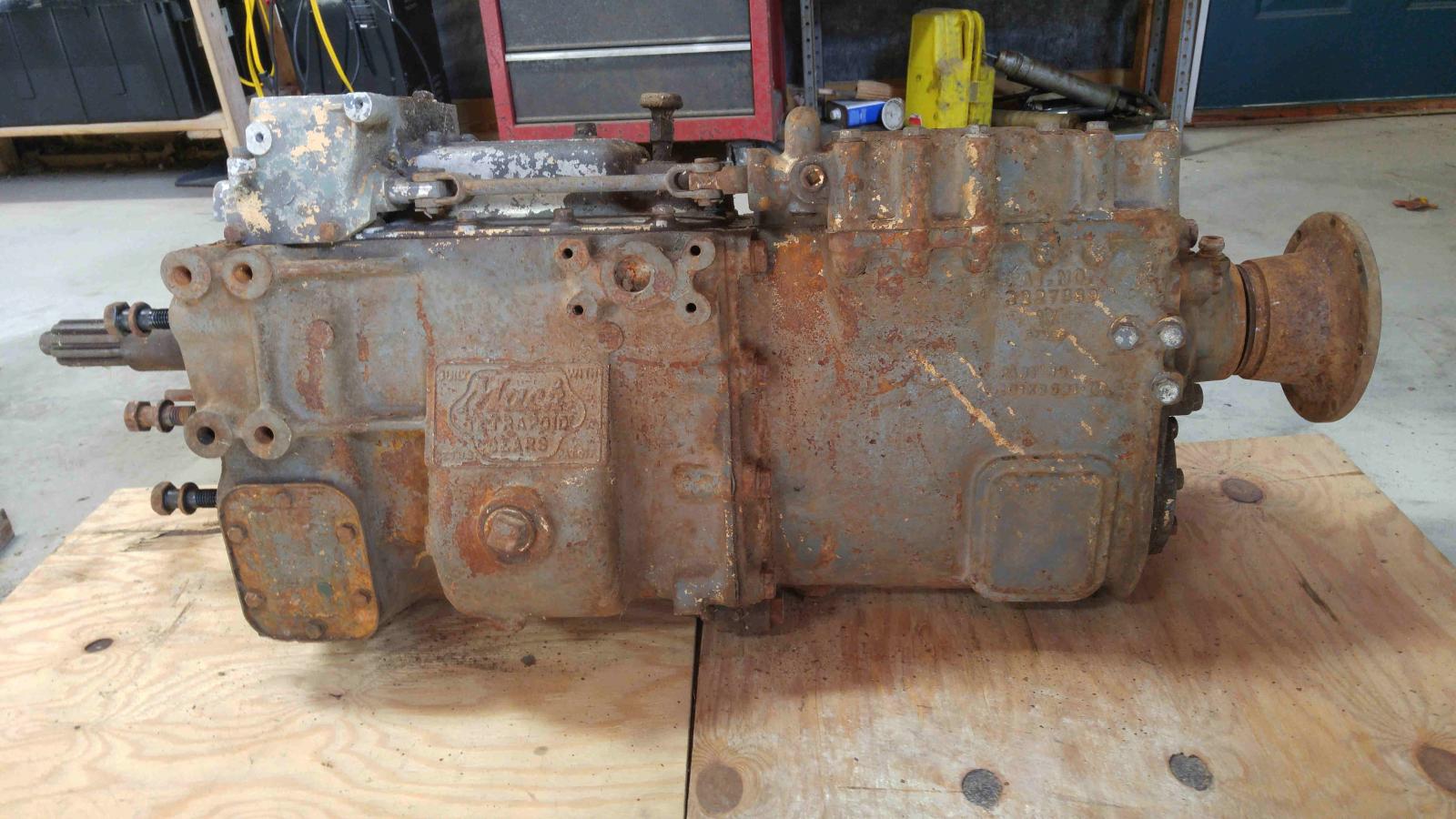

I have read other posts here in the past that mentioned welding up the end up of the auxiliary stick and grinding it back to factory shape. After so long the rod rounds off at the end causing the shifter to hang up or pop out of the gate without completing the shift. I have the same issue with the quadruplex in my B. It jumps out of the gates usually when crossing over the H pattern from LL-Lo to Dir-Hi. I'm not sure that the same applies to the Duplex, but this is what I've heard. -

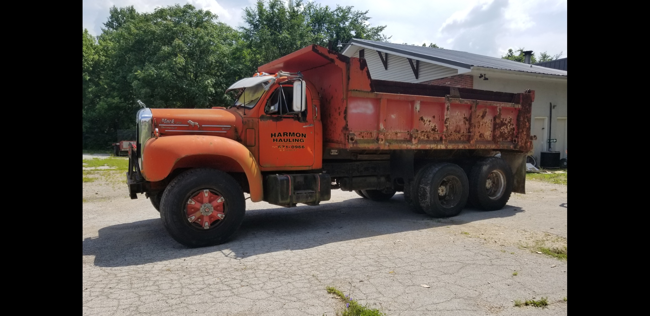

Just the ol dogs parked up with eachother. Need to get the B fired up again and out of the weeds. The other R was my Dad and Grandpa's first Mack, it was a good runner until a rod went. Would like to find another e6-300 for it. -
