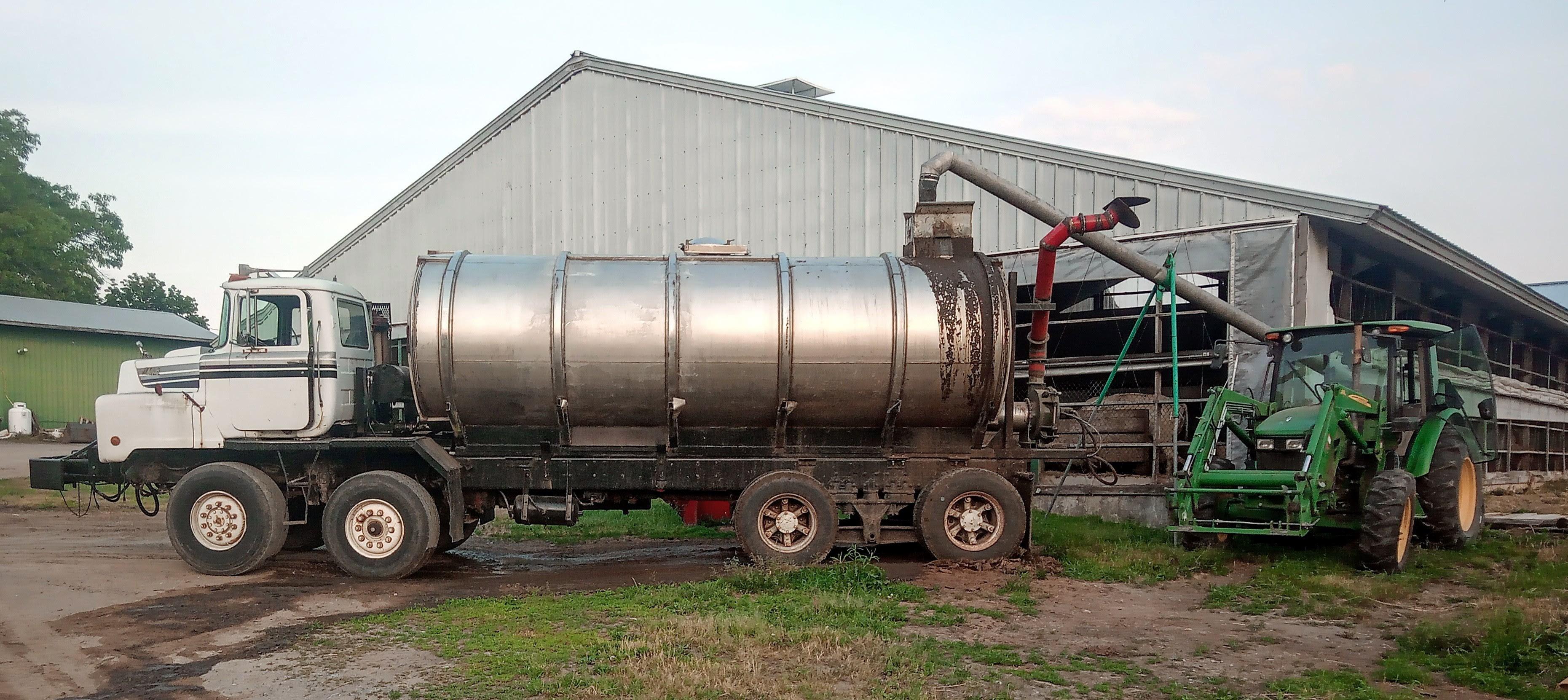

  9. I realize this is several years ago, but this is exactly the issue I have with our EM6-275L. The puff limiter is disabled and the fuel plate is adjusted and ground down a little, but still when you hit 1700Rpm, those governor weights pull your fuel rack back because the springs cannot hold it in anymore. In my case I do have an "L" rated engine, which I know was designed for fuel economy, but now in the second life performance matters a lot more. I can't shift gears going uphill because you lose so much speed, by the time you get into gear it's dropped to 900rpm,and the sky turns black.
  10. No this is incorrect. You can set the high idle screw to 2300 rpm all you want, but if you have 1800rpm governor springs, you will only make idle power at 2300rpm. What you can do is put 3000rpm governor springs in and then turn the high idle screw down so you don't exceed 2200 rpm. At that point it will likely behave a little bit like a farm tractor. As soon as the engine rpm drops to 2100, all the horsepower will be available. You won't have to wait to drop down to 1700rpm.
  11. In neutral I've got 1990RPM. Under significant load I've got 1800. My understanding is that the e6-285 has different governor springs than the e6-275L but otherwise should contain identical internals. The low rpm version was designed for fuel savings, which is no longer an important issue for this vehicle. Time savings and performance is worth it for us. The people that do extreme truck pulls with these, are there any of those guys here?
  12. Maxitorque 8 speed. Everything on the truck is factory. It used to be a cement mixer. Just made for local city driving. Now I'm taking it all sorts of off-road up very steep slopes trying to keep my speed and engine rpm up in order to unload my load. Overall GVW is pretty similar to the mixer configuration, because the tank has a very heavy subframe and I've got 5990 USG of manure
  13. You can still adjust the high idle stop. I don't want my engine to actually turn 2800, I just want full fuel all the way to 2200. The notice on the sun visor says it's good for 2300rpm. I'm sure people have pushed that a bit and gotten away with it too. I have found that on an incline of any sort, I can't get above 1700rpm, then when I try to shift I'm down to 900 by the time it gets in gear. Then I'm turning the sky black for 3 minutes before we get some boost and some RPM going. If I could shift at 2000 or 2100 it would be much better for everyone especially the guys behind me. And if I can maintain 2000rpm in field in second gear that would be nice too. The governor springs from my spare motor would be guaranteed not to hurt it, but not sure how much of an improvement it would actually be.
  14. Following on a thought I had in a previous thread. I know a few people with Cummins pickups( same fuel pump as my E6-275L. ) Who have replaced their governor springs with higher RPM springs, and they say it really awakened the truck quite a bit. I know these trucks were made with the L destination for low rpm in order to be more fuel efficient. Fortunately for me in my off-road application the fuel economy is pretty much irrelevant, what matters to me is having the widest possible power band. There are times where I can definitely tell that the pump is de-fueling due to high RPM, but I'm not talking 2000rpm, I'm talking about anything above 1550rpm the engine starts to work less hard. It is my understanding that higher RPM governor springs will help to solve this problem. Obviously I'm not going to go 4000rpm like the truck guys do. But I am thinking perhaps a stock spring from a Cummins would work in the Mack application. Or possibly the spring out of an E6-350, or maybe even just a 285 non-L Does anyone have experience with this? In the Cummins, the fuel pump is mounted with the governor springs on the outside so it is a 10 minute job. On the Mack, it seems to be on the inside, so the fuel pump may have to come off... Looks like the stock Cummins is set to 2800rpm. That should do nicely, as long as I don't actually allow the engine to over-rev
