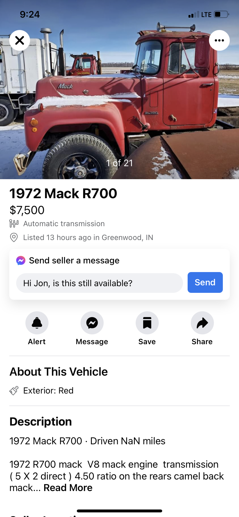

  15. Not mine just seen it for sale. Not many around here like this.
