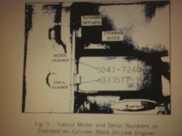

  3. right hand side of the block in the upper rear corner look at the pic i posted in the previous post
  4. not sure joe there should be 8 digit model number on top of the serial number like this
  5. let me no what the numbers are and i can tell you just about everything
  6. ill check for sleeves and rings for you head bolts will be fine an overhaul kit is 600 that includes sleeves pistons rings gaskets bearings thats all i can find right now the engine number and serial number are stamped on the right hand side of the block in the upper rear corner
