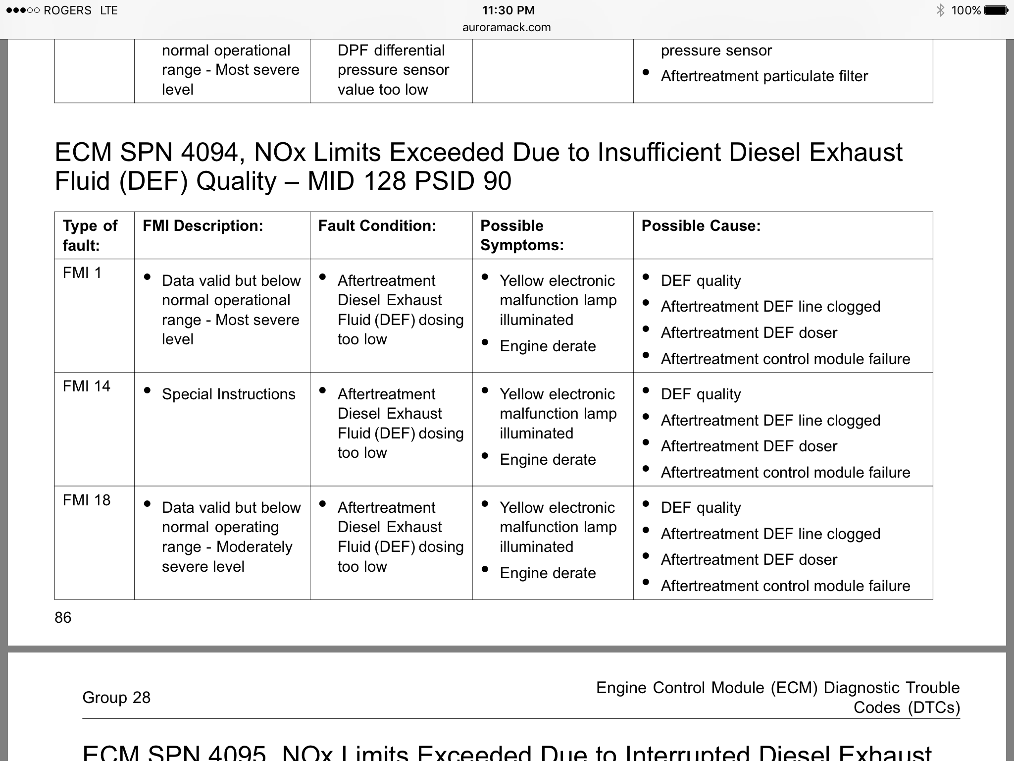

	SPN 4094 signifies that Nox limits are exceeded due to insufficient diesel exhaust fluid or poor DEF quality.
