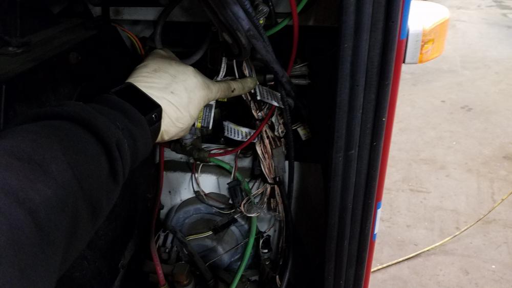

  1. Hello, I have a 2014 Mack LEU613 & for the life of me cannot located the P-brake Pressure switch. Any help appreciated. UPDATE Found location on passenger side behind panel under right side driver steering wheel.
