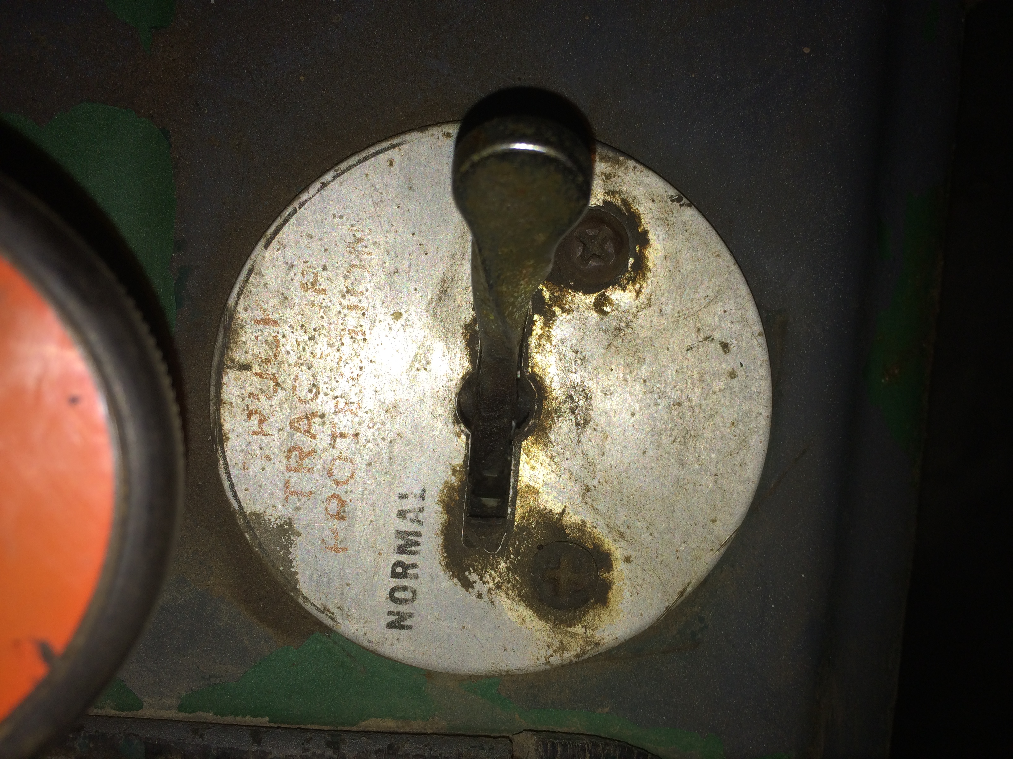

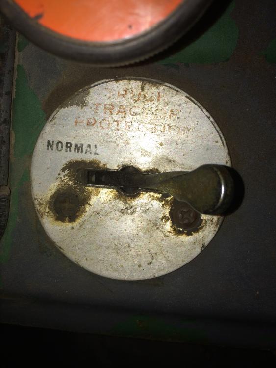

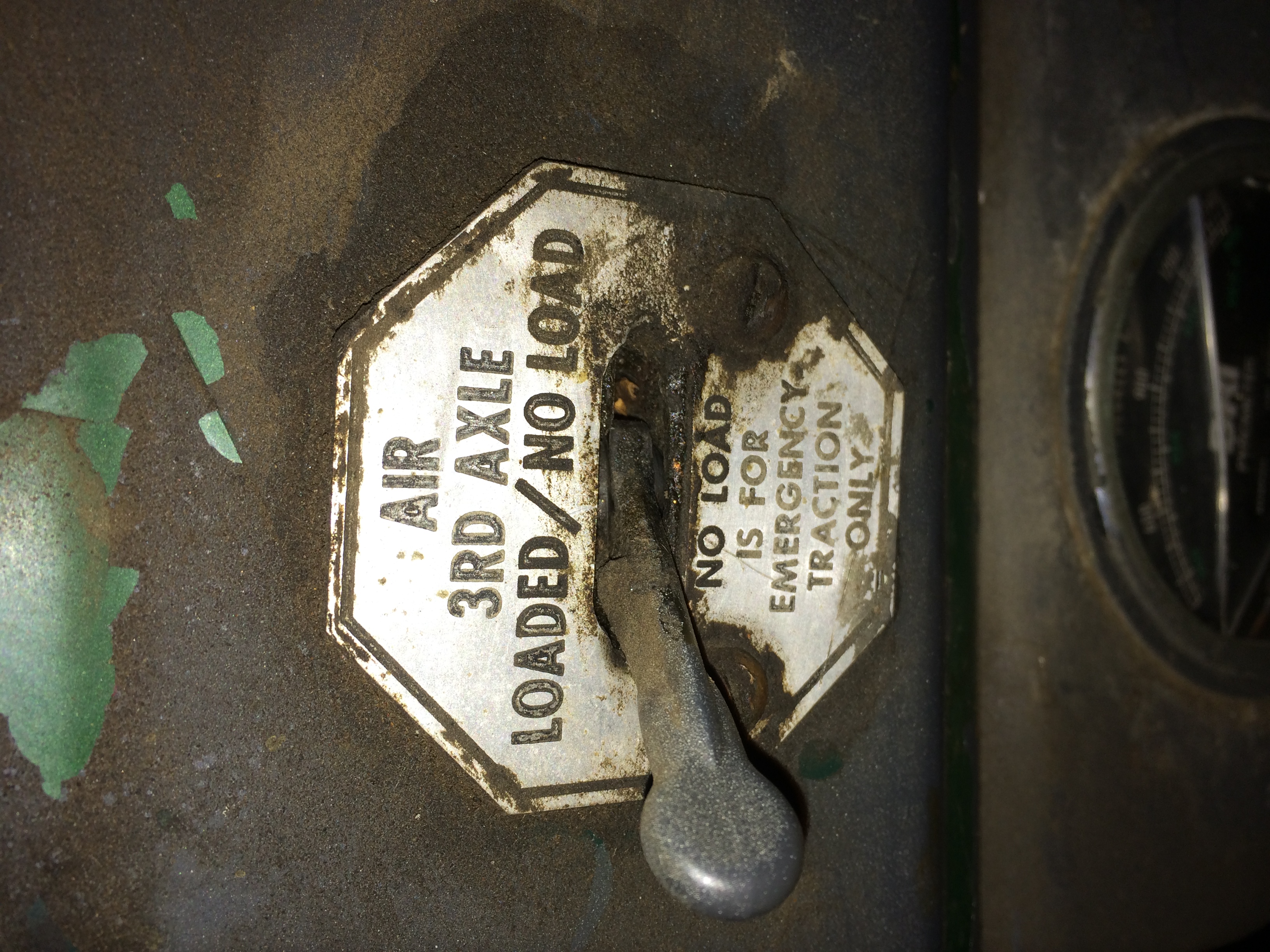

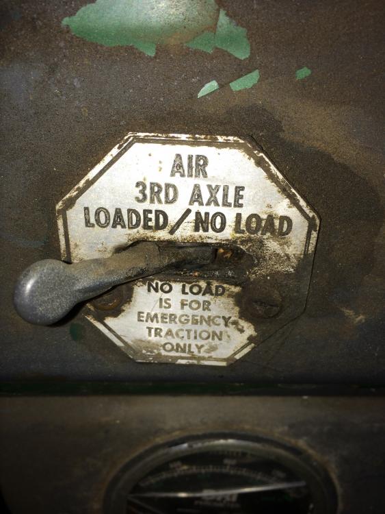

  7. I found out that the Third Axle Air valve is blocked off. I checked my factory build sheet and found that my truck never had a power divider. I don't know why the switch is there, but it definitely has been blocked off for a very long time. The truck tractor protection valve works, and sends air to the trailer hoses when flipped.
  8. Here's those flip valves
