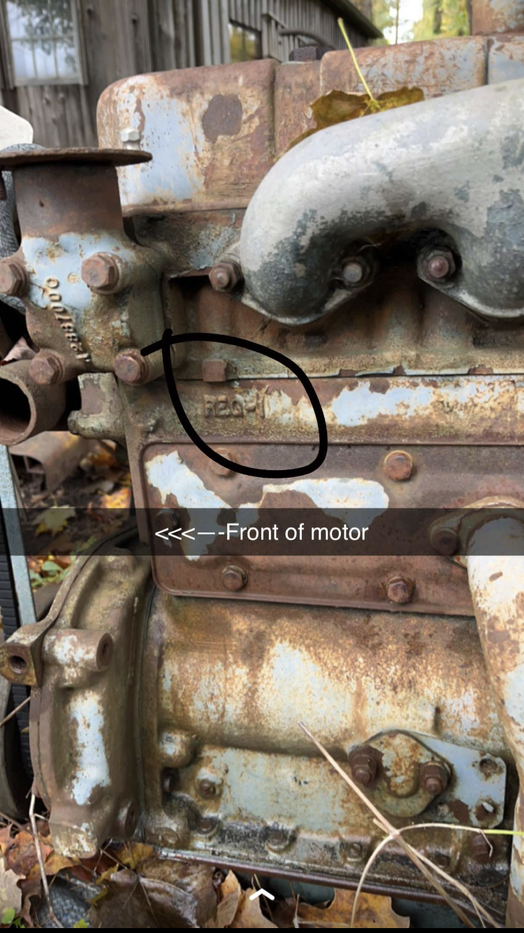

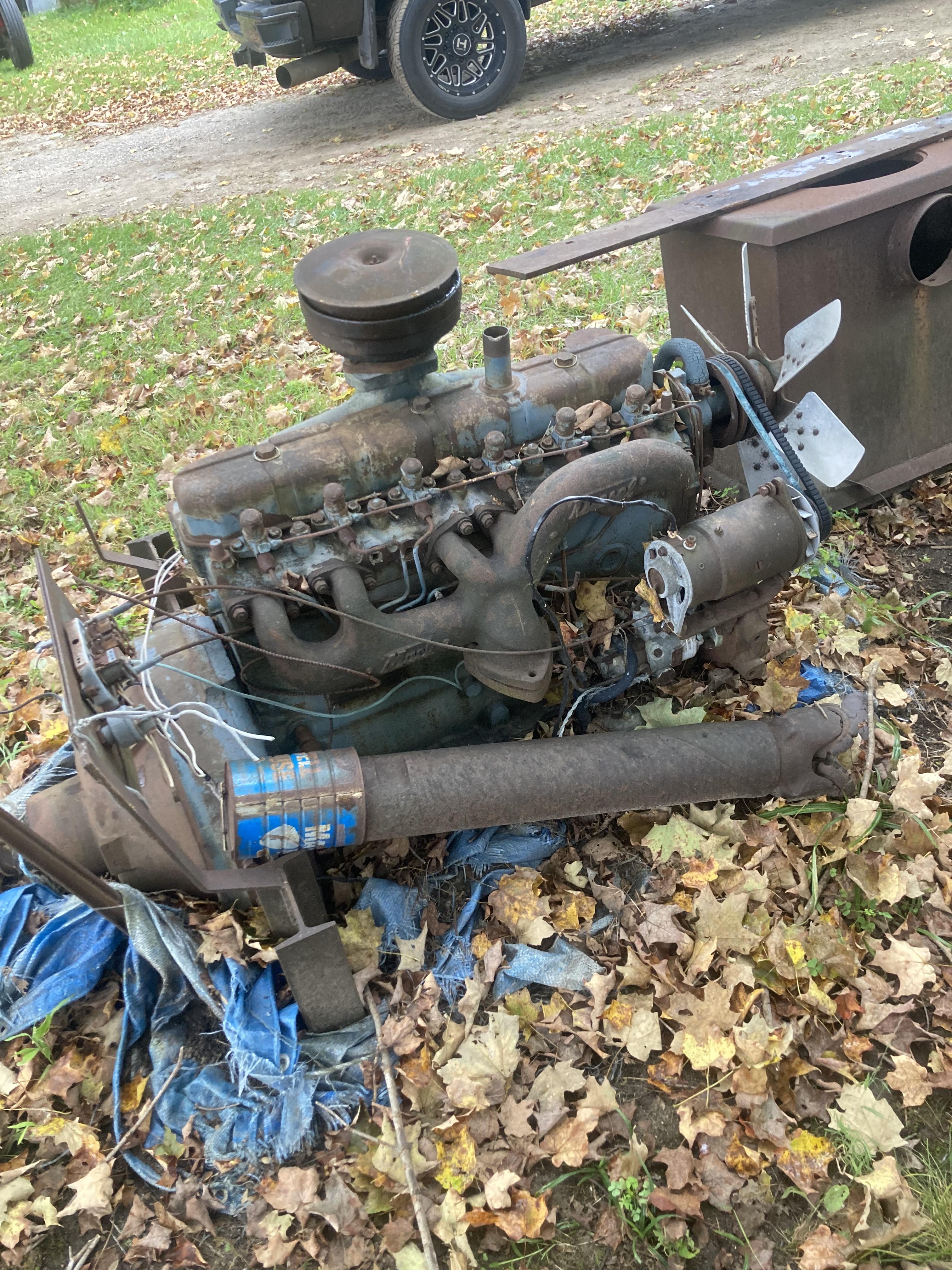

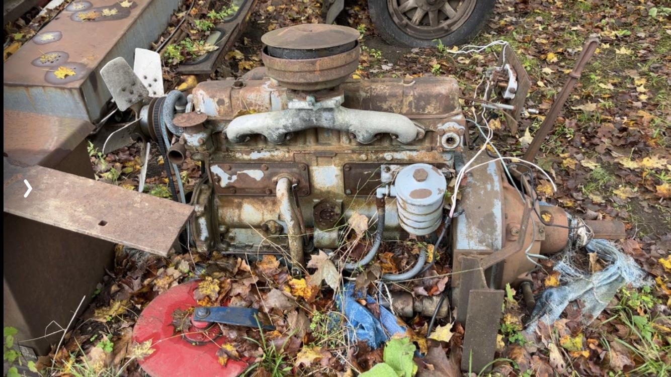

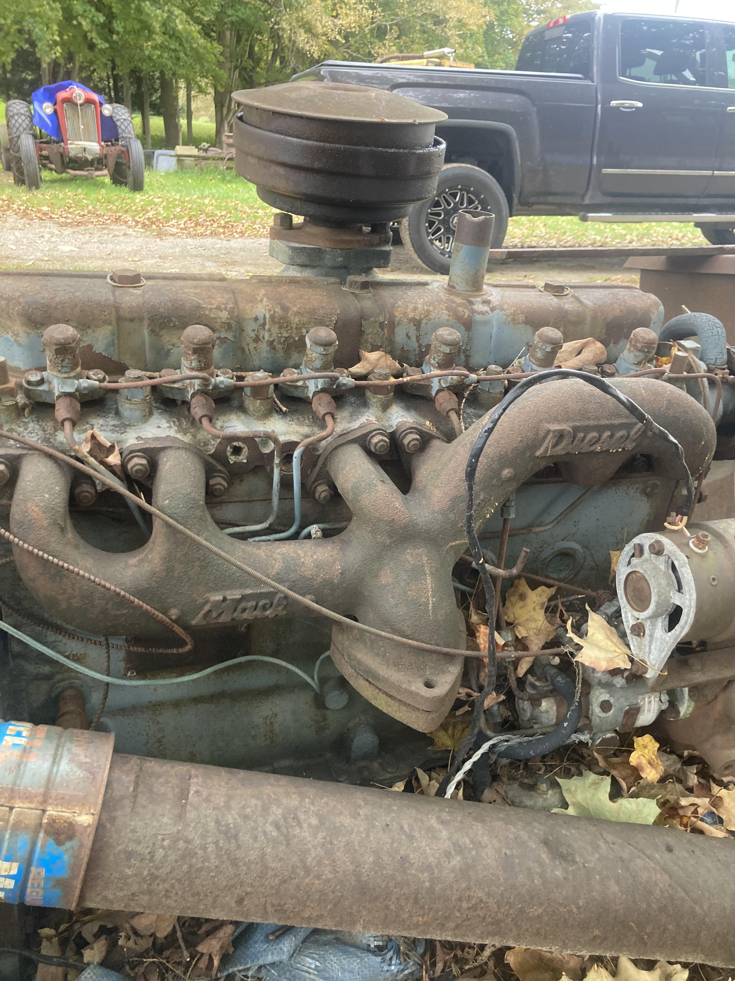

  1. Thank you. Mystery is solved. Kinda disappointed it’s not a real Mack. Think I may still grab it and see if it’s any good
  2. The data tag is missing, but it used to be under the exhaust manifold
  3. I know the guy that has it. He’s supposed to send me more pics and look for data tag. He told me I can have it, if I want it. Didn’t have anything there to load it in my truck at the time
  4. I don’t believe roosamaster pumps were in production until the mid 50s
  5. E-5? Never heard of 1 before. But the more I look at it, the more it reminds me of an ih d361. I actually thought that’s what it was before I saw it said Mack diesel on the exhaust manifold. But wouldn’t e5 indicate that it would be in the 500 cubic inch area? It’s way to small for that
  6. Stumbled upon this old Mack diesel with a roosamaster injection pump today. Forgot to look for a data tag. I’ve never seen/ heard of a Mack diesel this small or with a roosamaster injection pump. I would say it’s around 300 cubic inch. Naturally aspirated. Anyone know what it is?

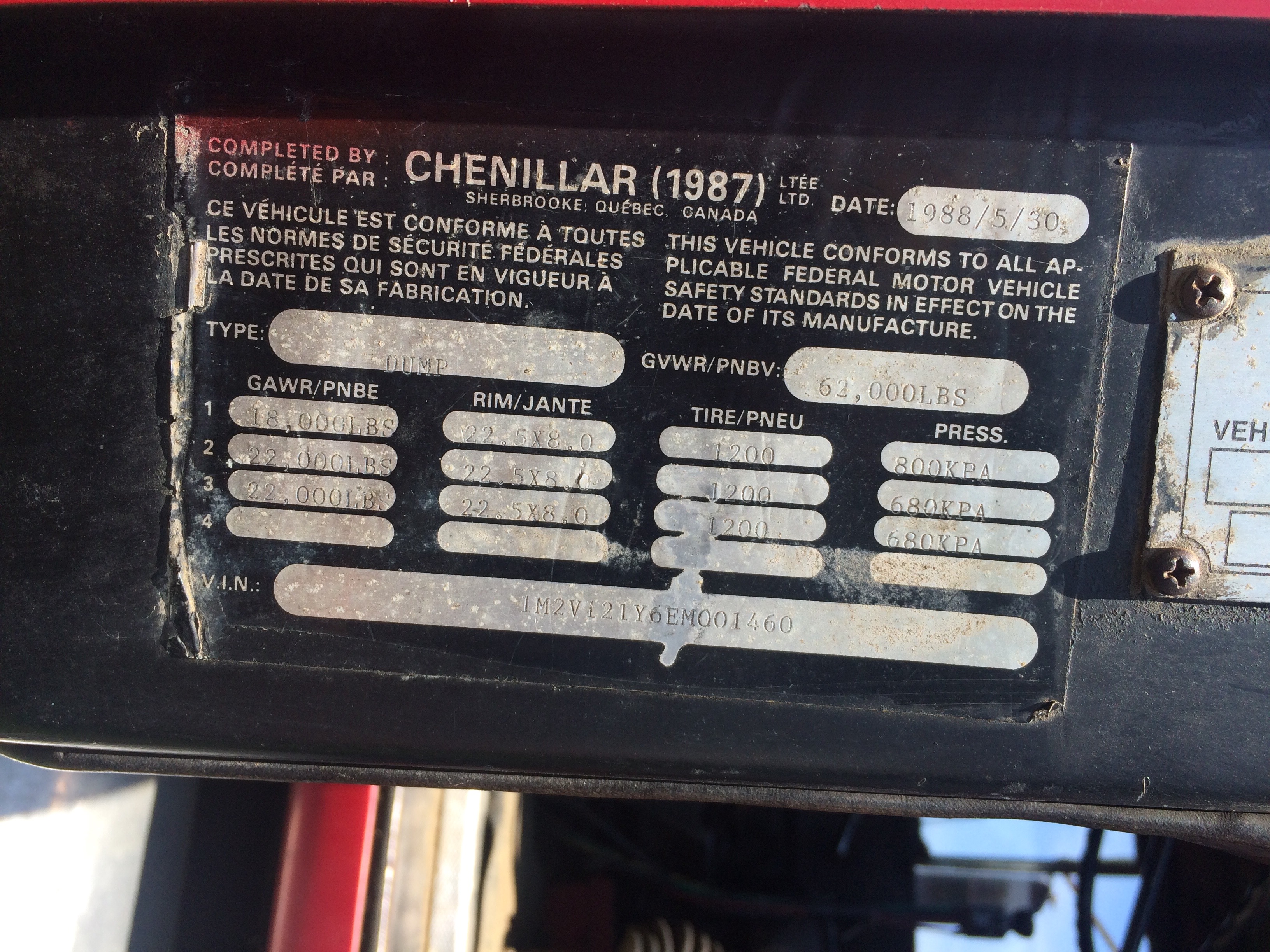

  12. it is a Canadian truck. speedo in km/h only and Canadian spread rear axles. also has the steering box mounted on the front axle. only reason I know it was a tractor is the trolley valve on the steering column doesn't do anything even though you can hear air moving when you pull it and the capped off air valves at the back of the cab and glad hand hangers on the back of the cab too. it could have been doubled later in life, it has Hendrickson walking beam rear suspension ans has another tag on the door from 87 stating axle capacities and other info I cant remember

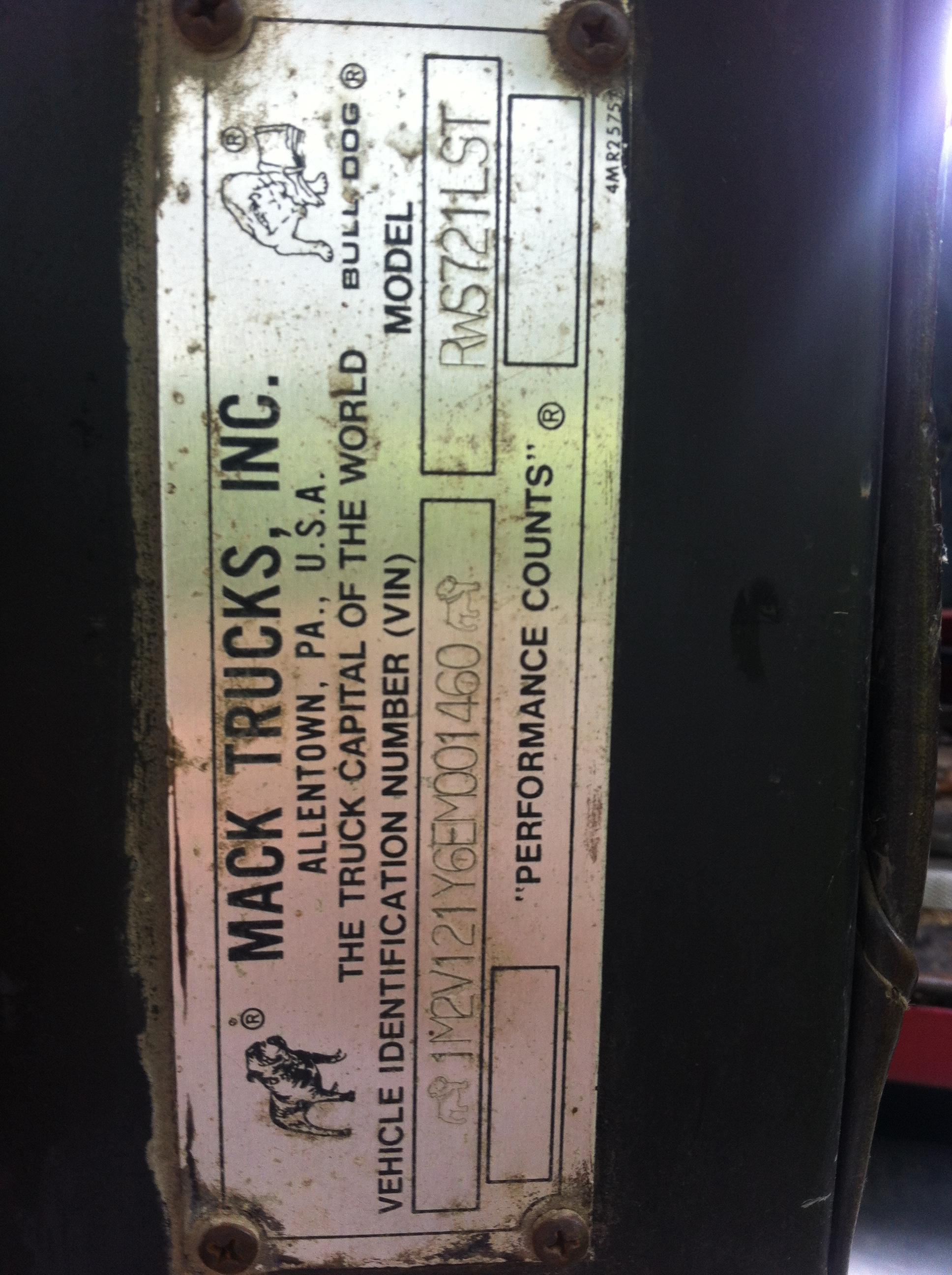

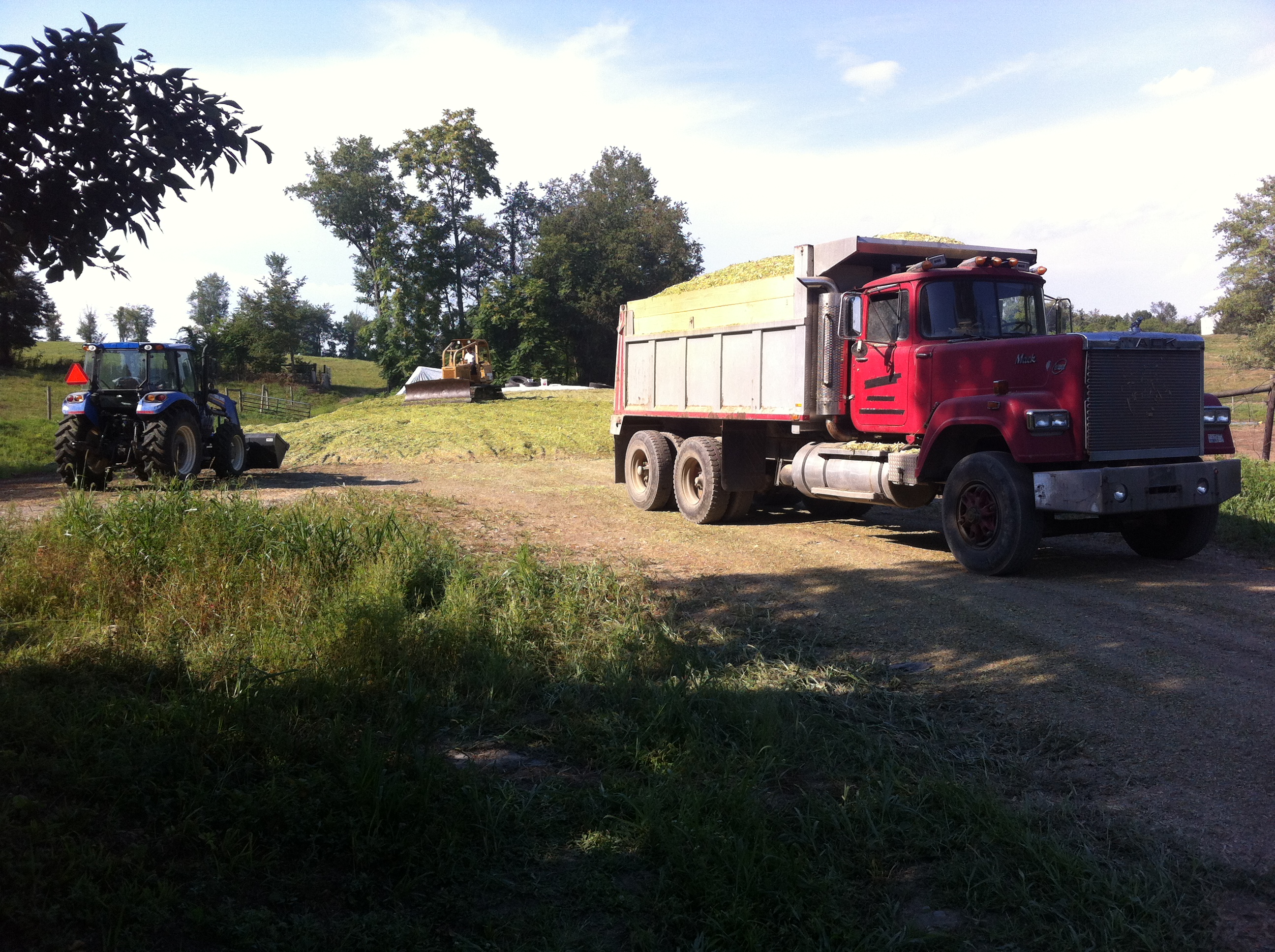

  14. Thank you for the info. I will give them a call. I was hoping to find used parts for the time being, but have read about people upgrading the cross members. Right now it hauls silage on the farm 1 week a year, which is coming up soon. Pretty rough going through the fields with it. Here's the data tag on the door and a pic of the truck. Thank you again on edit, realize I left the s out on the first post in the rws
