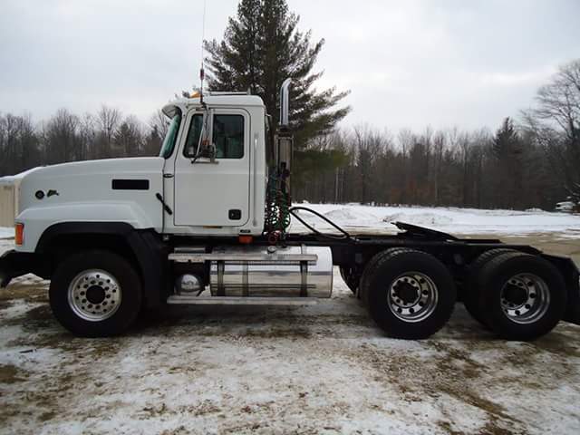

  2. I have a 2002 CL713 with a Mack 460, the electronic malfunction light will flash on and off at times while driving but will not while setting still. I had it checked out for codes and came back with engine position sensor problem. I changed it but still have the light flashing on and off at times. when this happens, driver says he can hear a slight change in engine sound and slight loss of power when this happens. Other than that truck runs great. I'm not much of a electronic guru but just need to pointed in the right direction. any thoughts or answers on this problem is greatly appreciated.

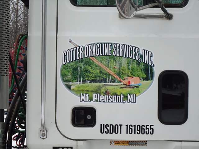

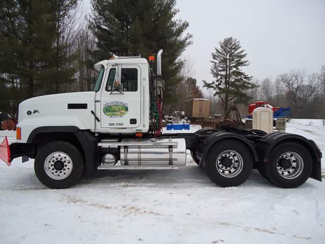

  6. This is the end result before and after putting on fenders and logo
  7. I'll post some better pics when I get it home
