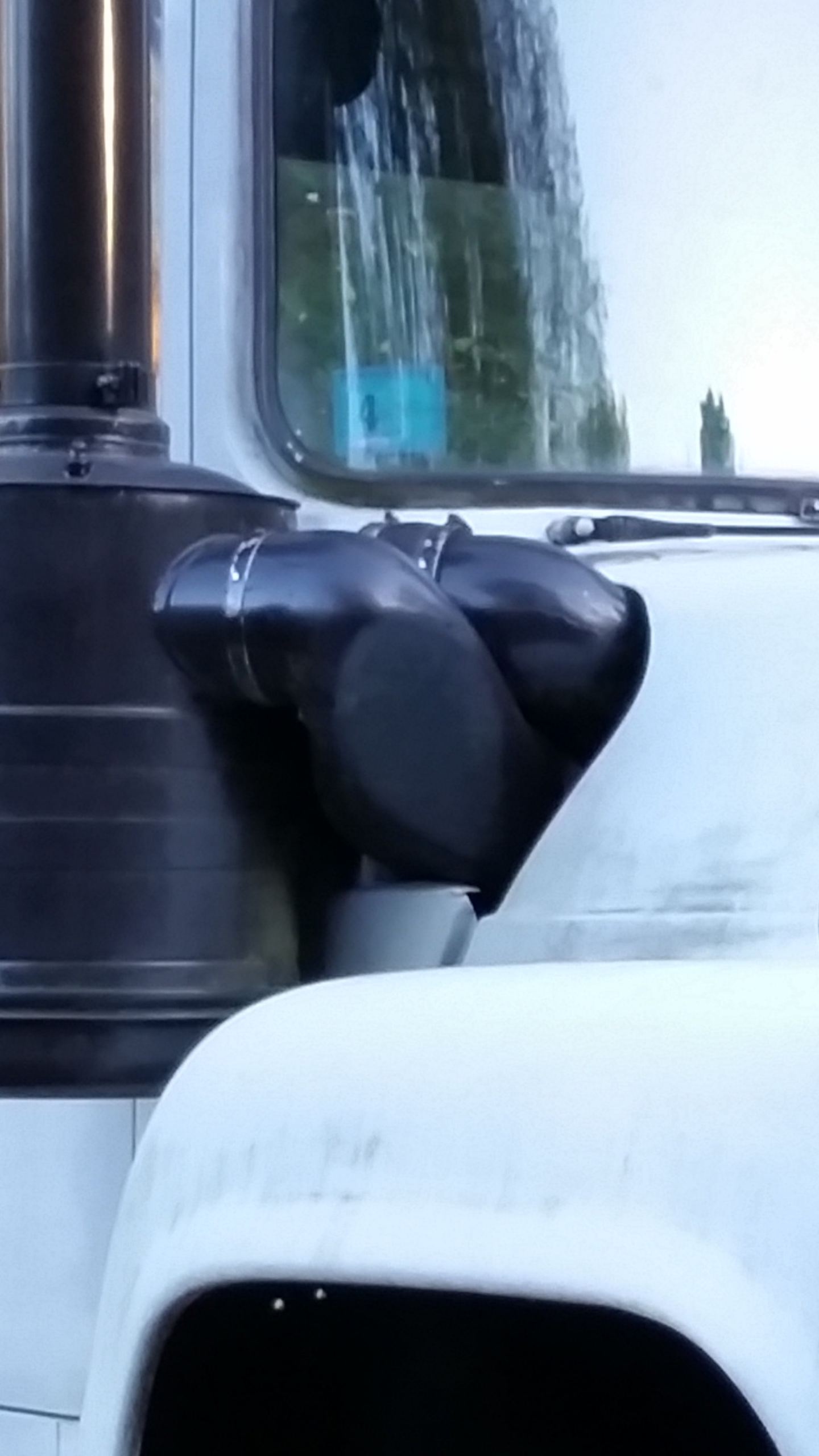

	  Early R model intake need helpjpavao1066 replied to jpavao1066's topic in Antique and Classic Mack Trucks General Discussion Ive called Global a couple of times now and havent had any luck with them getting back to me. Im going to try calling them again today. I found another place to try around here, hopefully I can come up with something.
	  Early R model intake need helpjpavao1066 replied to jpavao1066's topic in Antique and Classic Mack Trucks General Discussion I will check today when I get home from work. Hopefully I can see it, the tube got crunched while the truck was apart for paint (and im kicking myself in the butt for not being more careful). Ill hope for the best!
	Hi everyone, I am in need of the fiberglass intake tubes that run from the air cleaner to under the hood on my 66 r600. The longer one that goes to the turbo intake pipe is broken and I need a new one, and the short one that just goes under the hood for when it is raining/snowing is cracked but I can probably fix that one up if I dont find another one. I havent been able to find one yet so if amyone has any leads to where I could buy it I would really appreciate it! Ive tried Global and havent had any luck yet unfortunately. These are the pipes I am talking about here in the pic. Thanks in advance!

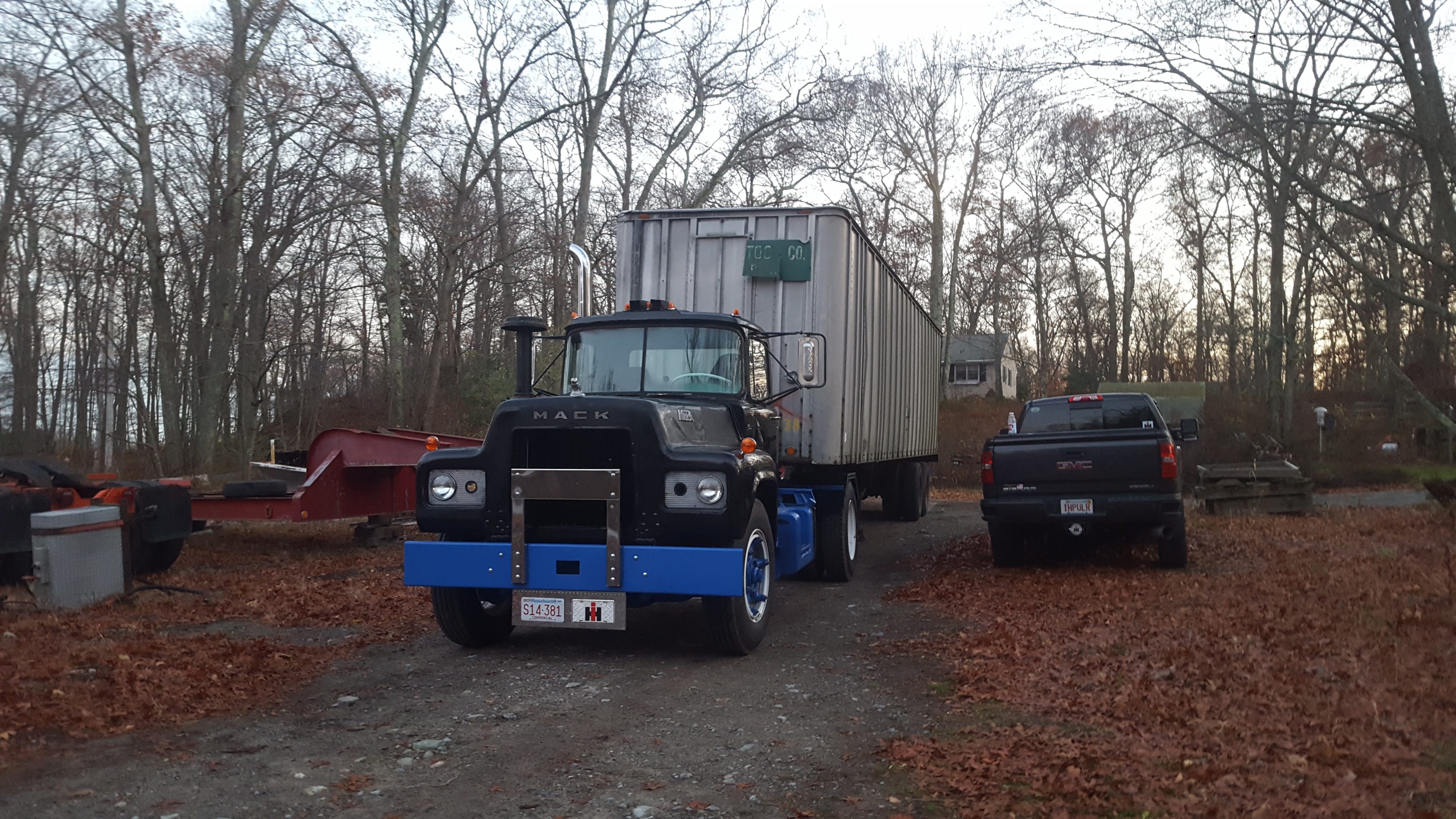

	  '66 R Model Restorationjpavao1066 replied to jpavao1066's topic in Antique and Classic Mack Trucks General Discussion Well Ive got a bit more done on the truck this year, winter slowed me down a bit since I dont really have any shop to work in. But since then Ive gotten the interior about 90% finished. I put another air ride seat on the passengers side, finished the wiring, put all new gauges in the dash, wired in a fused accessory block for added electrical circuits like work lights, strobe lights, a radio, etc. I still have to put the headliner back in, and put the card board curtain back in the lower half of the back of the cab, paint the doors, and a couple small things here and there. On the outside I bit the bullet and bought 6 new 24.5 tires and rims and mounted them up, put a new front bumper and grill guard on, and welded up a set of diamond plate rear fenders and mounted some new led tail lights in them. I also changed all of the lines and hoses over to new ones under the hood since the old ones were in such bad shape, and started to mock up a visor and some new air horns. I officially put the truck on the road the beginning of this month, and was finally able to stretch its legs a bit out on the road. My pinion seal started to leak a little, which was the only leak on the truck, so I pulled that apart sunday and I am getting a new seal today after work. Its getting really close, i just have a little bit of body work to do and it should be ready to paint. I will try to get some pictures uploaded when I get home.

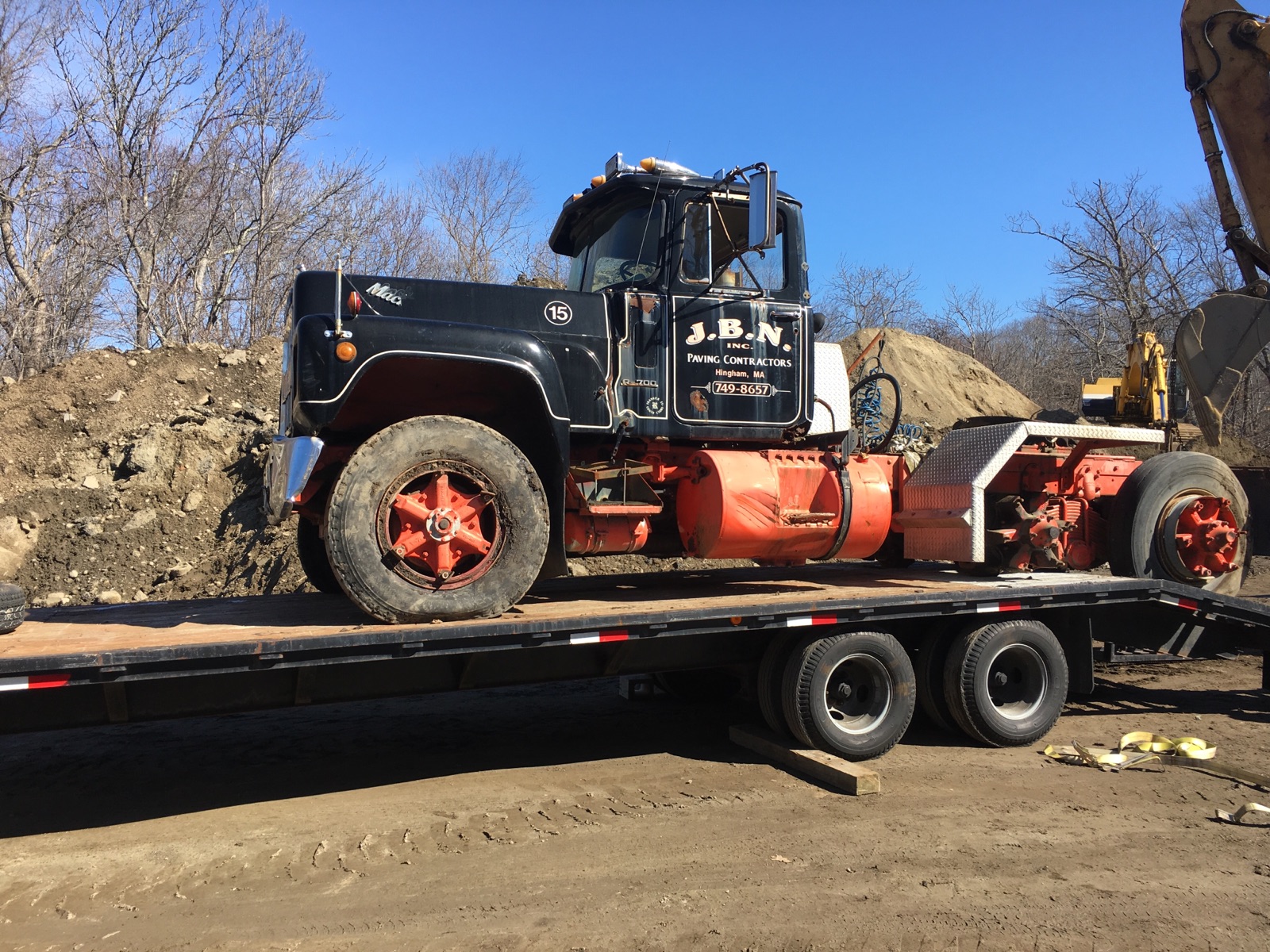

	  the new r700jpavao1066 replied to jpavao1066's topic in Antique and Classic Mack Trucks General Discussion Thanks guys, I cant wait to get her fixed up, I see alot of pontential left and just cant bring myself to part it out. I love the fenders too, theyre pretty heavy and whoever built them did a really nice job. A bit of polishing and they will be like brand new. We are slowly going to pick away at it over the summer. I am getting my '66 r model close to being finished so i need to wrap that one up before me and my buddy dig too deep into this one. We are hoping to have both trucks with plows on them ready for next winter to put them to a little use in their retirement. Haha no that was my friends father. He spent alot of time behind the wheel of old Macks so he loves them as much as we do!

	  the new r700jpavao1066 replied to jpavao1066's topic in Antique and Classic Mack Trucks General Discussion It was on craigslist and facebook as well. Short money so I assumed it was pretty much toast but its got alot of life left still!

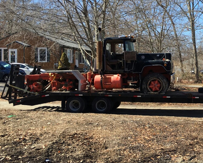

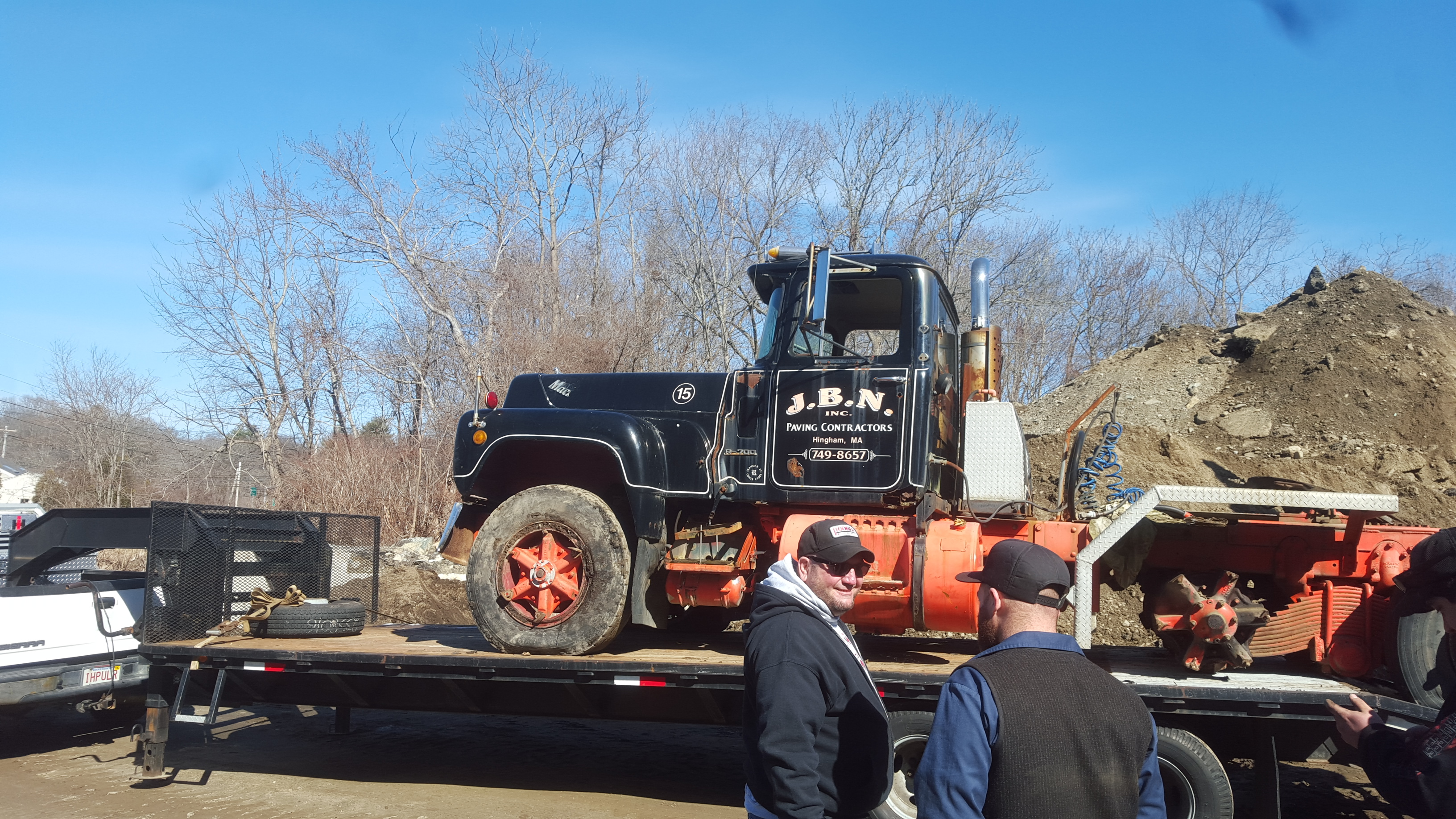

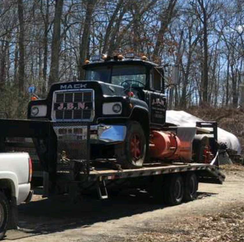

	Well this past weekend me and my friend saved this 1969 r773st. Originally I wanted it for parts for my 66 r600 but after getting it home I think we have decided to resurrect the old girl. The engine must have been swapped out from the Detroit to the 350 Cummins that is in it now. It was listed as unknown running condition, but we had it running within 10 minutes of having it home and it runs great. It has a 13 speed road ranger behind it, and im pretty sure 58k rears by the looks of it. We are pretty excited to get it moving, have most of the tires already, just looking for a couple more, and have a couple doors for it too. One piece at a time and we should have a pretty sweet ride to ad to our small collection!

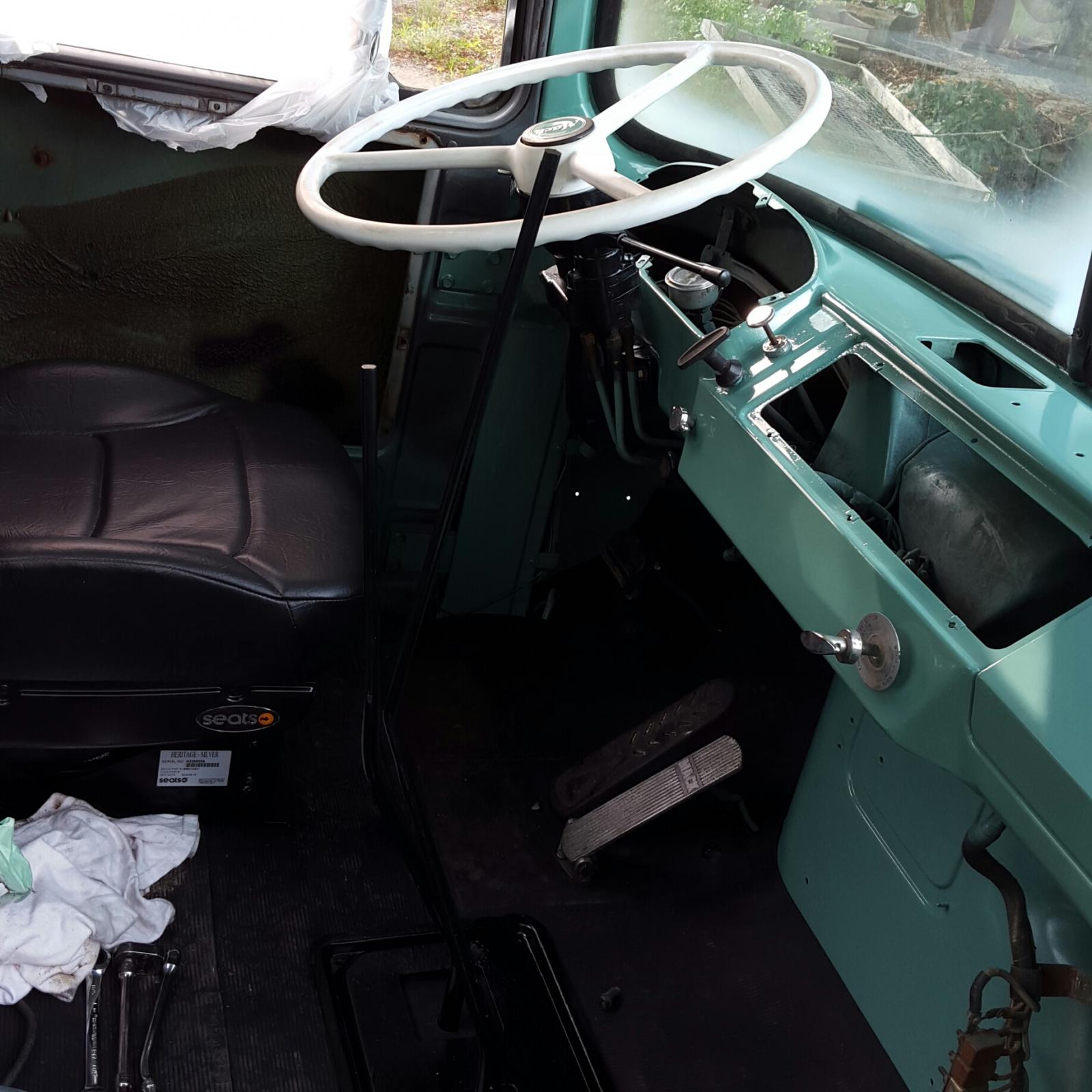

	  '66 R Model Restorationjpavao1066 replied to jpavao1066's topic in Antique and Classic Mack Trucks General Discussion Ah ok thank you! I never realized to check the orientation of the picture. Ill keep that in mind the next time I grab a few pictures

	  '66 R Model Restorationjpavao1066 replied to jpavao1066's topic in Antique and Classic Mack Trucks General Discussion Thanks everyone! And I will definitely look into those shift pattern plates and try to get ahold of one for the dash, thank you guys for the advice and help!
	  '66 R Model Restorationjpavao1066 replied to jpavao1066's topic in Antique and Classic Mack Trucks General Discussion Does anyone know why when I try to post pictures, some of them show up on their side, 90 degrees off? The rest of my pictures other than this one all show up on their side.
	  '66 R Model Restorationjpavao1066 replied to jpavao1066's topic in Antique and Classic Mack Trucks General Discussion Well I finally made some progress on the truck, mostly all interior work. I figured I would tackle the interior first then move to the outside. I stripped almost everything out and fixed a few rot spots, repainted everything back to the green it is supposed to be, dynamatted the floor to help with sound and insulation, put new front and rear floor mats in, pulled the steering wheel, fixed all the cracks and repainted the wheel, repainted the horn button, put a new air ride seat in it, and cut out the old bent/broken/welded/hacked shifters and made new ones. I also have the rest of the dash pulled out and repainted, along with the heater box, which I pulled apart to get the rusted up flaps and vents working again, and to fix a small coolant leak. I still have to clean up the headliner, and make a new back curtain piece for the lower half of the back of the cab. Its been a slow process but im glad to finally see it take shape! Ill try to remember how to post some more pictures.
