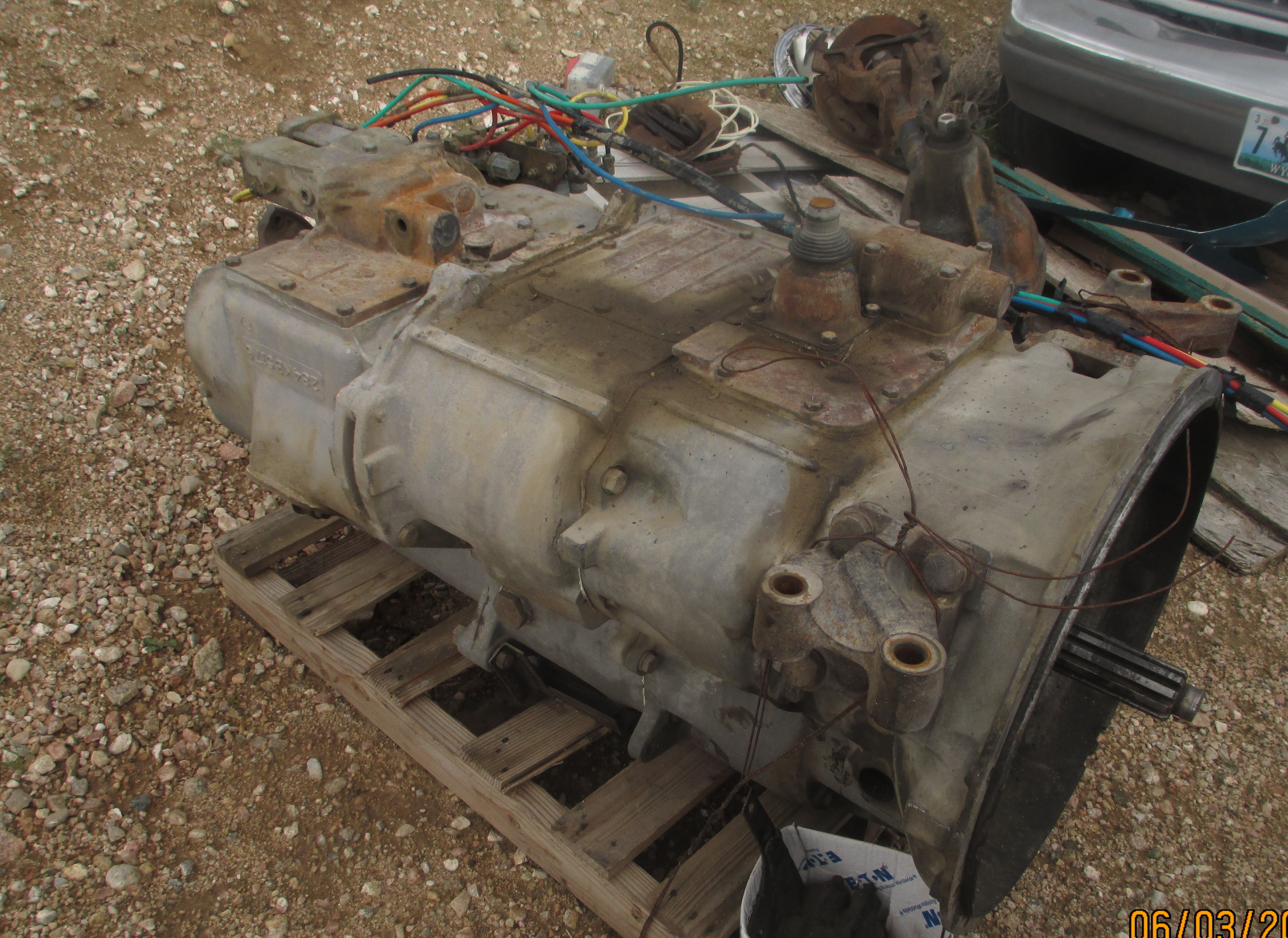

I talked to Inland Truck Parts, they have no use for it. Not another trans shop within 600 miles and Macks aren't real popular in the Rockys
I don't know what scrap weight on this is, but I'm gonna find out next scrap run I do. Need a taker or off it goes

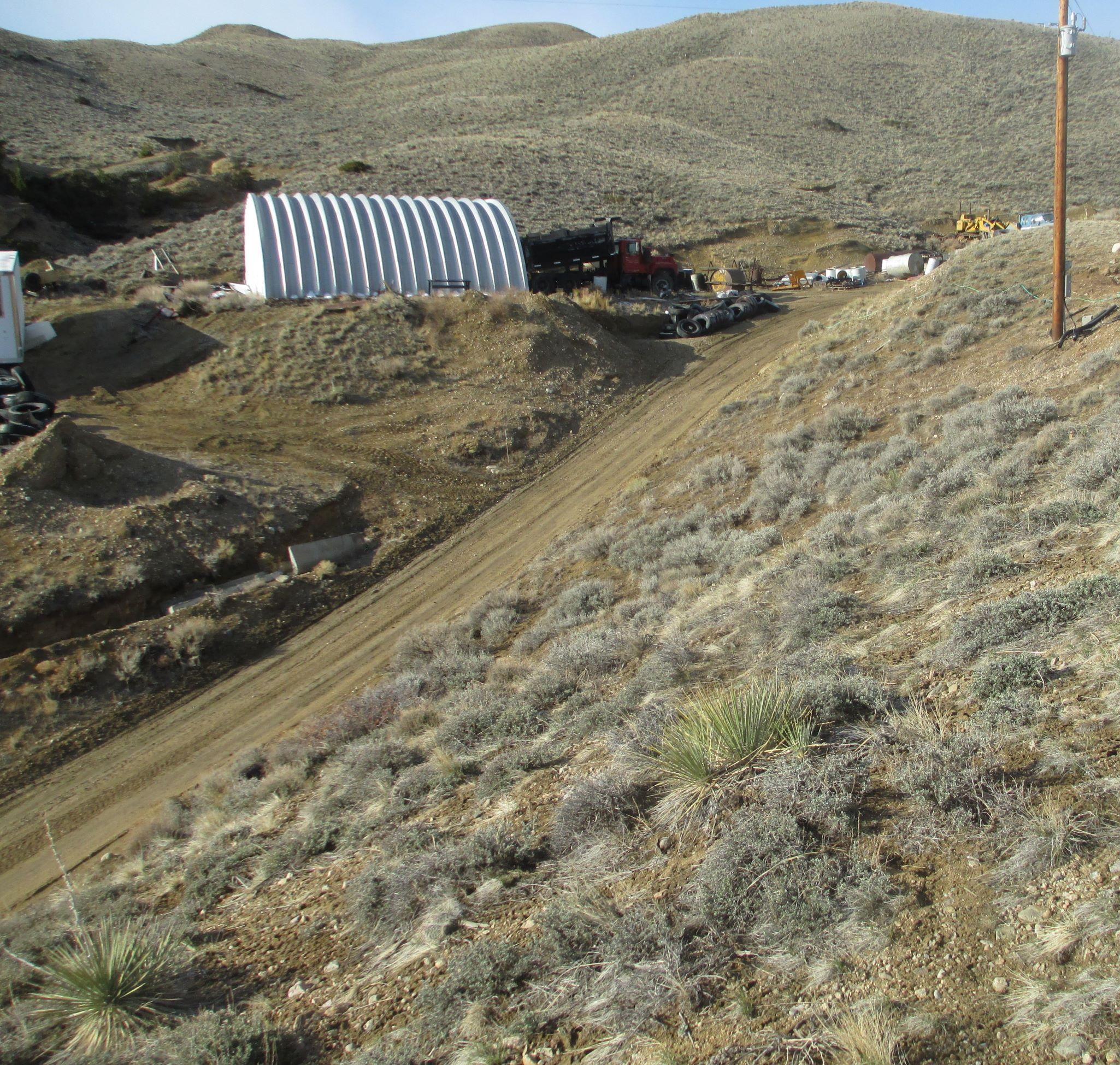

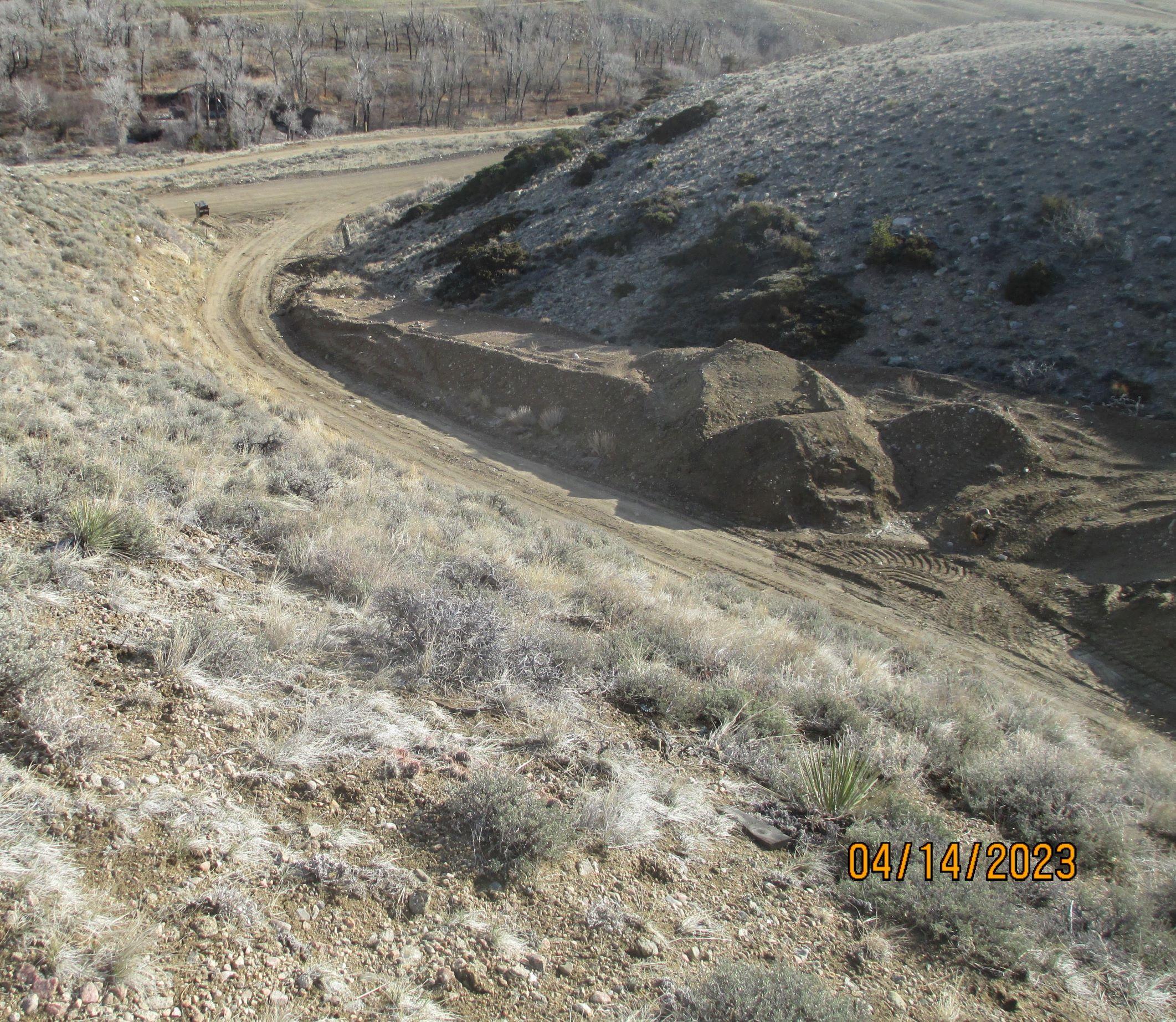

I finally got the loader, excavator and dozer running good all at the same time - and the dump truck is holding up the new driveway. Last pic is the new driveway I'm cutting in.

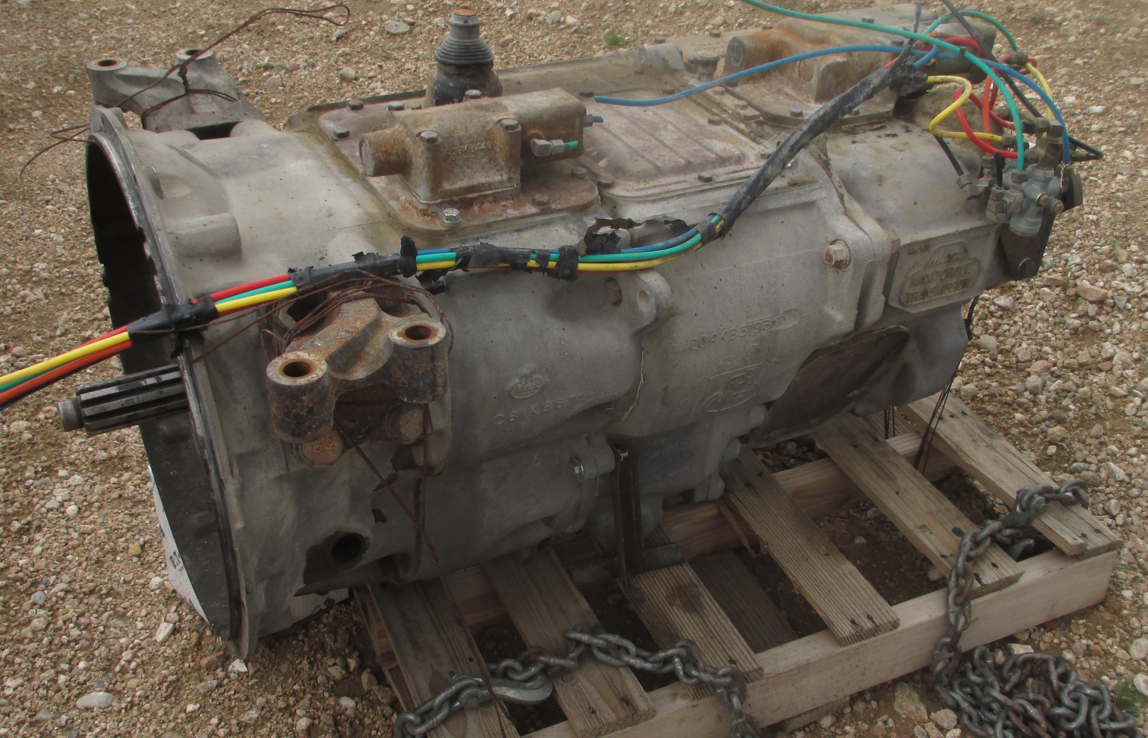

I can't compare it to the other ones you listed, as this is the only Mack trans I have experience with. You are correct in that it shifts like a Super10, with an additional 2 deep reduction gears. It also has 6 reverse gears and a Neutral position on the shifter(that is what got me in trouble with it). I haven't pulled the dash air switch (for the deep reduction) yet, but it goes with it. It is a .73 or .78 OD and runs out at about 70mph with 4.42 gears and 11R22.5s Text first as I don't answer calls that I don't recognize (or leave a message and I'll call back). 303 two04 three 28two
