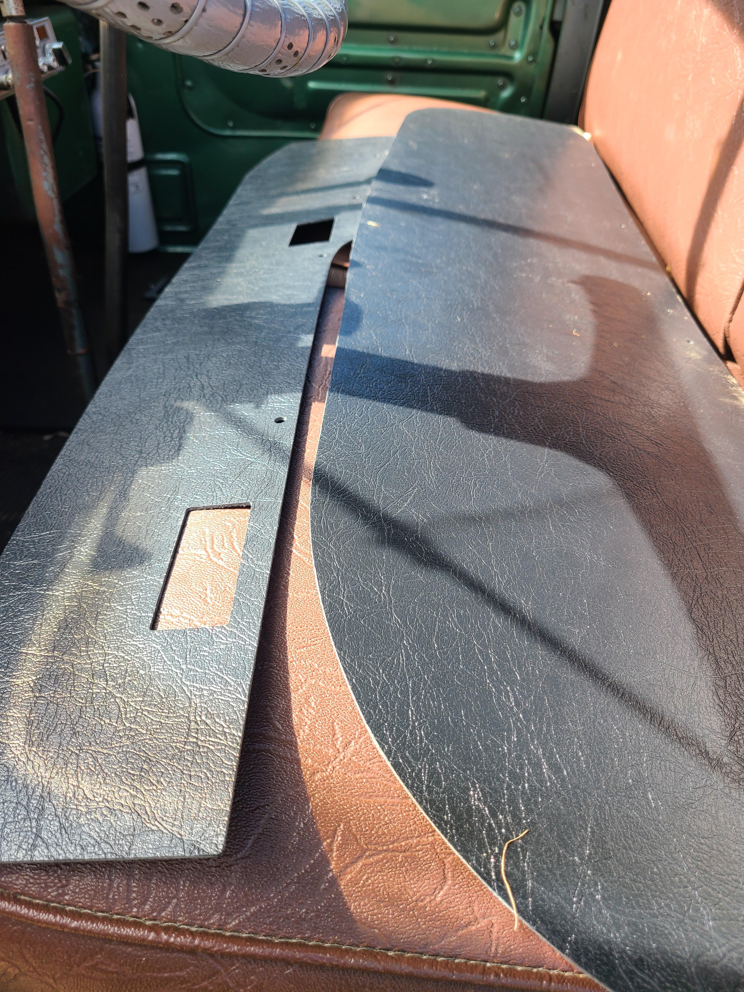

  4. I just received a headliner from Quiet Ride and am trying to fit the pieces. Have nothing to go by since truck had no interior. These 3 pieces can't figure a place for.

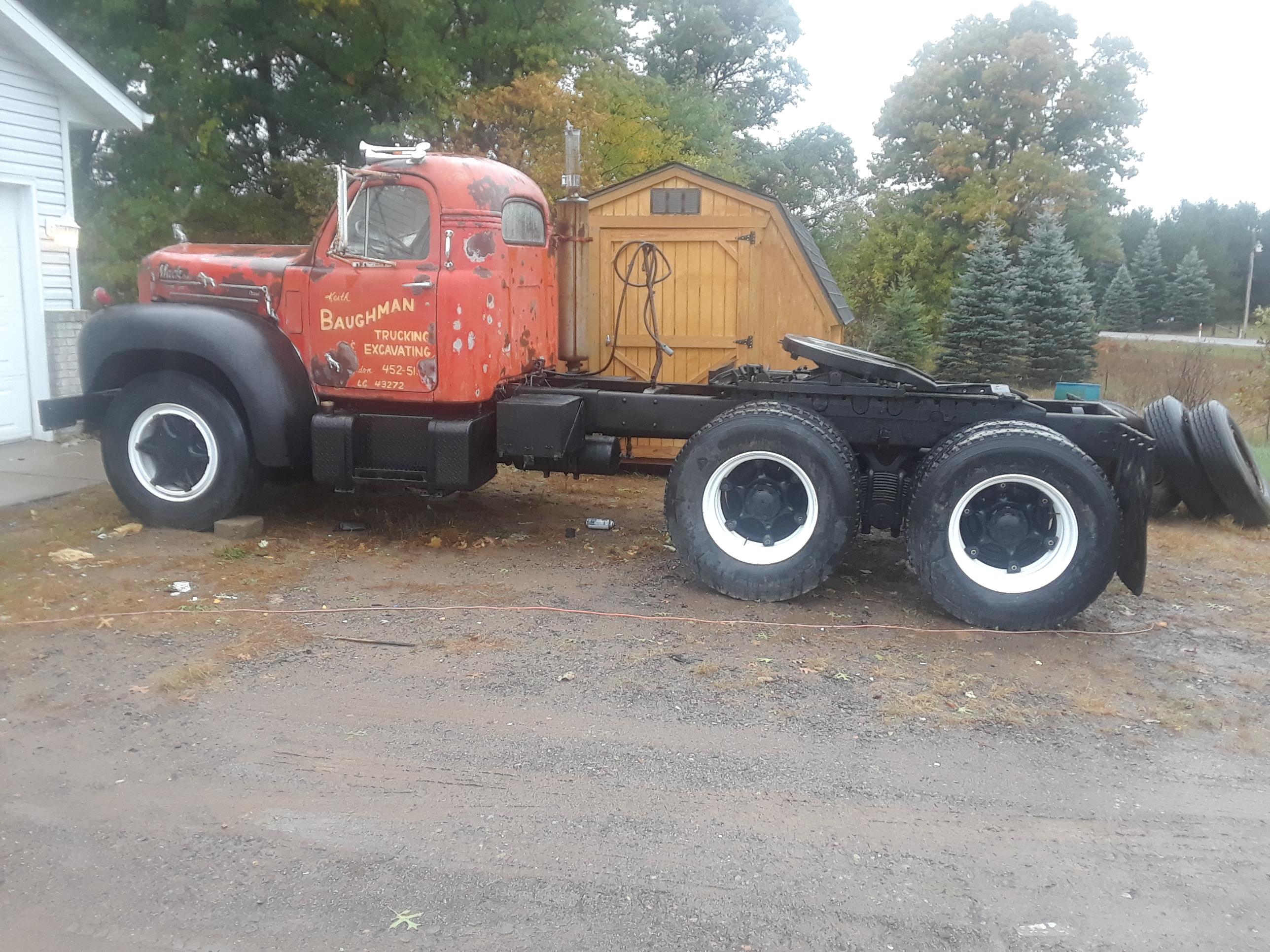

  11. Still working on my B61. Interior painted and seats redone in original material. Frame painted, front fenders painted. New 22.5 tires and wheels. Gonna leave can as is for now

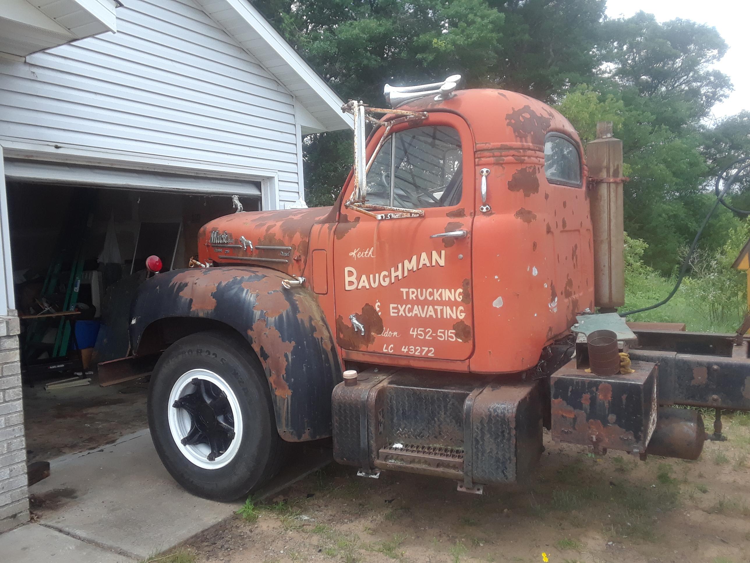

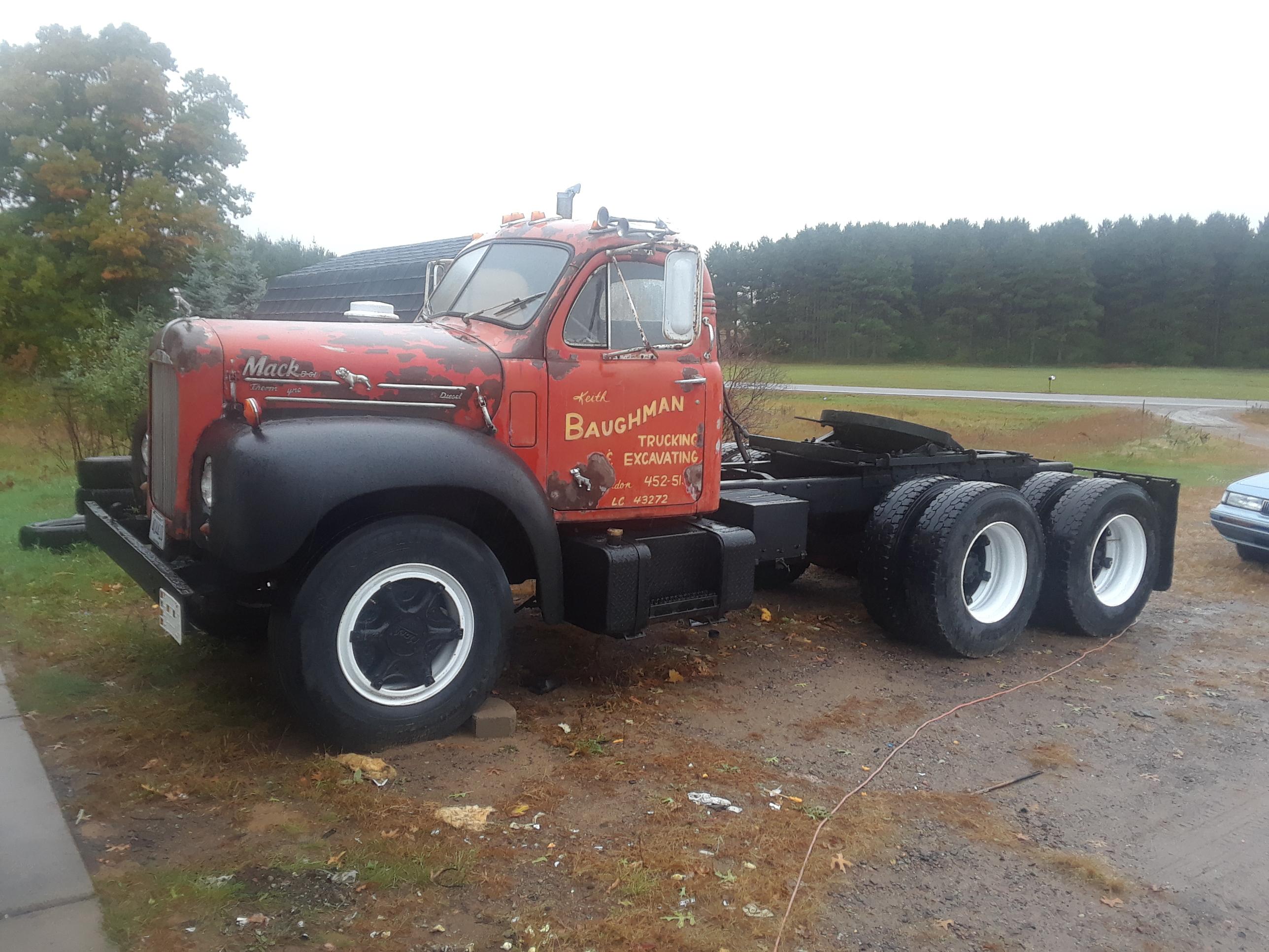

  14. My latest project. Sat for many years, got it running well. Painted interior original color, seats out getting redone original. Now trying to decide to strip and paint exterior or leave as is.
