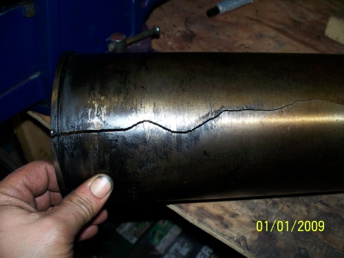

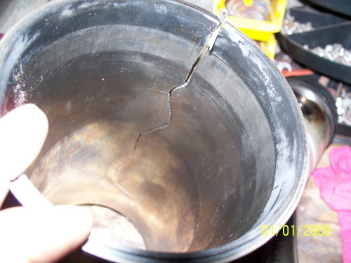

  7. update on the 673 cleaned and measured block today and found that the # 2 cylinder was bored ~ .030 over, assuming std bore being 5.0945 compared to the measurement of the #2 cyl being 5.1240, when this hole was bored whoever did the engine work put a std size sleeve in, they did not put a oversized sleeve in it which is most likely why it cracked, maximum clearance between block and sleeve should be .002 to achieve sufficient heat transfer and support, i think .030 is a bit out of tolerance. new correct size sleeve is on its way. Mike

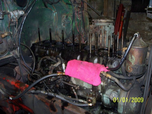

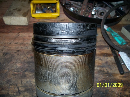

  9. Hey all, pulled engine apart today found more than one issue, ran engine with the fenders off to get a better look before dissassembly, found the rear head gasket leaking blowing oil bubbles out where the head meets the block, pulled intake, ex, and heads, found that the #2 cylinder sleeve had a large crack almost the whole length of the sleeve, pulled piston and found a large chunk below the top compression ring was missing, also found that there are two different style heads on the engine the front head had 5/8" corner studs and the rear head has 3/4" corner studs. On a positive note, found that the bottom end was gone over some what recently the bearings look great, no scratches or copper showing through the babbet
