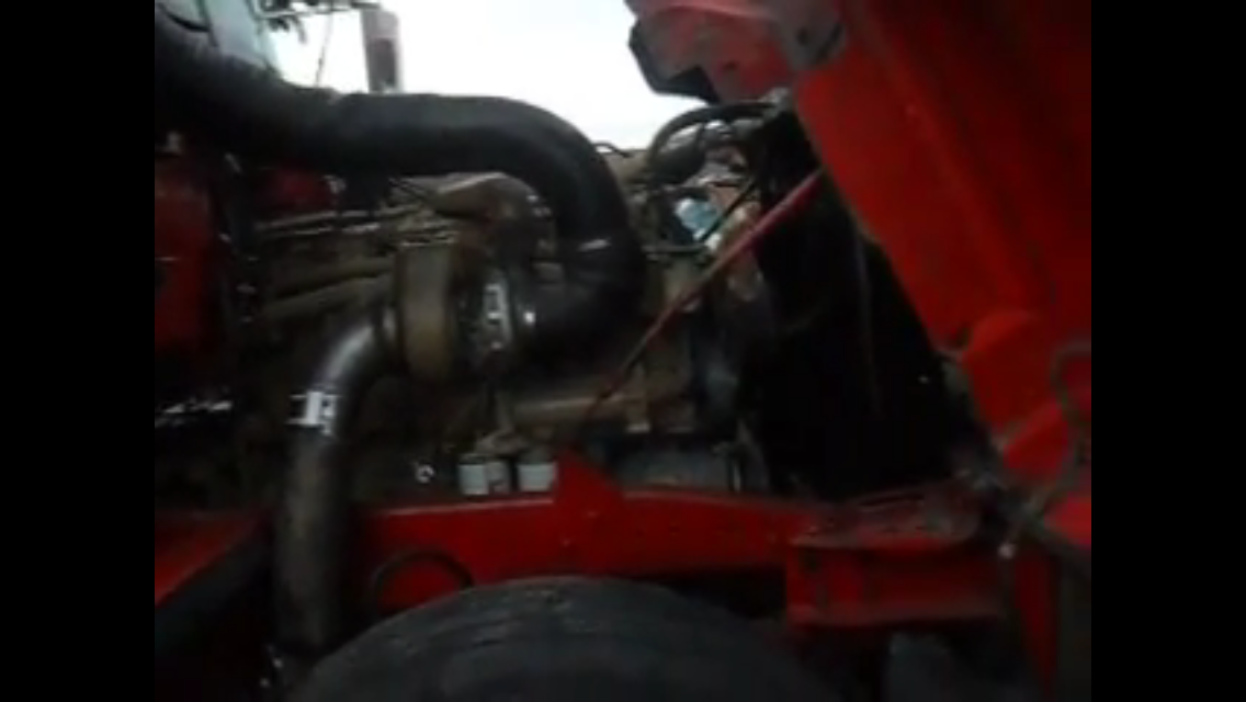

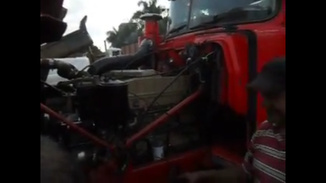

I wouldn't think it could fit without the R700/Superliner hood but there is a Youtube clip with a Big Cam powered RD600.
Would the cab have been modified or can you squeeze a Big Cam in by pushing it up as far forward as possible?
I have never seen a Big Cam under a short Mack hood until I came across the clip.

It's not something I particularly want to do - was just surprised when I saw the Youtube clip and it got me thinking. I am about to rebuild a Big Cam to keep as a spare for another truck and was curious whether it could go in the R686 if that engine goes first and I don't have time to rebuild it. I never thought a Cummins 855 would fit without moving the cab back until I came across this video (unless it is an L10 and they are calling it a Big Cam - must have a better look at the video).
