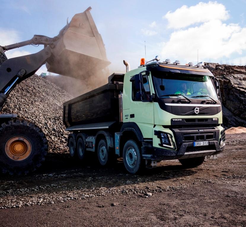

Volvo Dynamic Steering for dual front axles: Volvo Dynamic Steering is now also available on trucks with dual front axles, a very common configuration in construction operations. Since such trucks often carry particularly heavy loads or superstructures, the benefits are very noticeable for the driver. In addition to far lower turning resistance at low speeds, the steering wheel returns automatically to the straight-ahead position after full lock, cutting out the need for added effort in close-quarter manoeuvring and saving the driver both time and energy. Volvo Dynamic Steering, which was launched in 2013 and was showcased in for example the YouTube hit "The Hamster Stunt", consists of an electric motor that compensates for vibration and steering wheel movement while minimising the amount of force needed to steer the truck.
Increased front axle loads, dual front axles: Volvo's heavy duty trucks with dual front axles increase the maximum technical capacity from 18 to 20 tonnes. Customers benefit from both improved productivity and added flexibility. The extra load capacity translates directly into increased income-earning potential, something that is particularly valuable when transporting heavy materials in construction operations. On a 4-axle truck with a gross weight of 32 tonnes the load bed is also longer and there is greater flexibility regarding where to place a load such as gravel in a tipper body. This means maximum load is reached more quickly when loading and that the driver can be certain about meeting weight limitations. Higher load capacity above the front axles also permits a greater variety of crane configurations and allows other applications with considerable weight on the front axles.
Five-axle trucks, 10x4 and 10x6: On many markets, the trend is towards increased gross combination weights of between 50 and 76 tonnes. In order to meet the demand for heavier applications both on highways and in construction, Volvo Trucks is now launching factory-built 5-axle combinations. The two front axles permit up to 20 tonnes maximum load and the three rear axles can handle up to 36 tonnes, resulting in both increased payload and greater flexibility for customers. This solution is also suitable for concrete pumps and large crane trucks that need uniform axle load distribution. By reducing pressure on the axles, many of these vehicles can be transported over longer distances on regular highways, resulting in both faster transportation and increased income potential.
