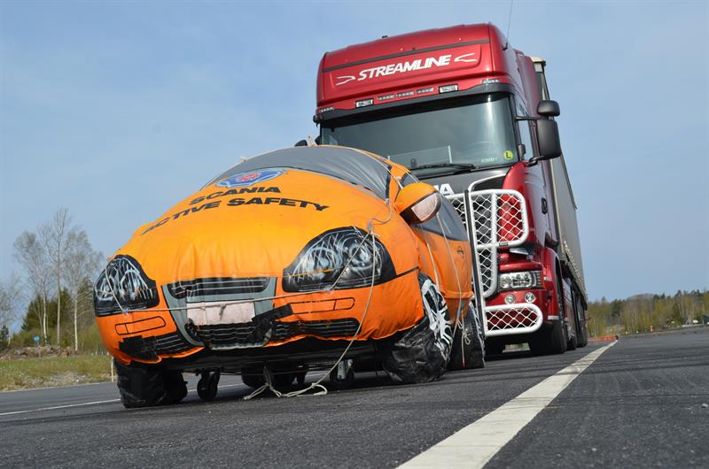

Before leaving Scania's R&D labs, a swift demonstration at the test track provided a timely reminder of just how fast technology is progressing. Many in the industry will have seen their first AEBS (advanced emergency braking system) demonstration only a few years ago. My first encounter was on a Mercedes-Benz track in Boxberg, where it seemed highly futuristic. I saw another at the Scania test track, but it had already become a formality, as AEBS will become a mandatory fitment for new trucks this November.
With that in mind, think about how soon platooning, AD and HUD systems may become realities. Meanwhile, Scania's test track revealed how the company is ticking big environmental boxes with a range of developments. Bput through their paces were: a 26-tonne parallel hybrid distribution truck, which was virtually silent; and a 10-axle, 35 metre, 72-tonne combination that Scania's transport laboratories has been running on the highway. Sweden always seems to be first to push its national gvw limit in Europe. This month, it is being raised from 60 to 64 tonnes.
