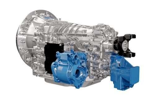

post-16320-0-79148000-1409882630_thumb.p

Eaton is bringing a new transmission to the medium-duty market that boasts car-like drivability with full-manual performance, a design of 10 years or 400,000 miles, and 8-10% better fuel economy than a torque-convertor-equipped automatic transmission.
The new 7-speed transmission, called Procision, features a dual-clutch design and electronic shifting that uses grade, vehicle weight and throttle input to provide optimal fuel efficiency and smooth, continuous delivery of torque to the drive wheels under all shift conditions.
The Procision transmission will be available for order in mid 2015, Eaton says.
Eaton's senior vice president and general manager of Commercial Vehicle Transmission business, John Beering, says the target customer of this transmission wants a truck he or she can climb into, turn the key and drive away, while still meeting the unique needs of the multitude of applications that use such a product.
"Procision is a clean sheet of paper," Beering told a press gathering in Galesburg this week. "We took a hard look at what we had done in the medium-duty space in the past and we listened to the voice of the market that told us there were gaps they wanted addressed. This new dual-clutch technology addresses those gaps."
The transmission itself is a 7-speed set up rated for up to 660 pounds-feet of torque with direct drive in 5th gear. The overall ratio is 10.13:1, with a ratio of 6.5:1 in first, right up to 0.64:1 in seventh. It weighs 364 pounds and will be available in 26,000- and 33,000-pound ratings. It also offers right, left and rear PTO positions.
The key to the Procision transmission is the dual-clutch shifting technology. Eaton says the torque path to the drive wheels is not interrupted by the gear change, so the driver never feels any lag in power as he or she would with a traditional manual transmission -- even an automated manual. To the driver, it feels like a torque-convertor equipped automatic transmission. But the benefits of maintaining a constant gear mesh throughout the shifting sequence improve fuel economy significantly, especially in stop and go situations.
There are two input shafts and two clutches, explained Jeff Carpenter, engineering manager for the Procision transmission. "Think of input shaft A linked to clutch A, and input shaft B linked to clutch B. While the transmission is in a particular gear, the next gear path is preselected in the unused clutch and input shaft. The shift is executed by transferring the torque path from one clutch and input shaft to the other, and that transfer of power is seamless. The driver will barely notice. From that gear, the next gear is preselected and the torque path shifts back to the first clutch, and so on. It's a closed-loop control system that significantly reduces slip and steady state losses associated with torque converter automatic transmissions.”
The dual clutch module is fully contained within the transmission, hydraulically controlled and oil cooled for extended life. A five-spring damper is used to control torsional vibrations.
The electronic controls are mounted on the transmission to reduce wiring and connector complexity, and the entire unit is fully sealed to eliminate contamination.
