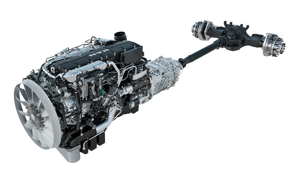

The MAN TGX has gained more grunt with a new D3876 15.2 litre engine to be launched at the 2014 Hannover IAA international truck show in September.
Based on existing MAN engine architecture, the new D3876 powerplant will be available in horsepower ratings of 520, 540 and 640.
The engine features MAN’s characteristic compact two-stage turbo charger which the company claims results in higher power density with lower fuel consumption.
A high pressure common rail fuel injection system injects fuel into the combustion chamber with peak pressure of up to 2,500 bar.
Interestingly the new engine is capable of delivering peak torque from just 930rpm. Torque ratings for the engine are 2,500 Nm for the 520hp, 2,700 Nm for the 560hp and 3,000 Nm for the 640hp.
The engine is backed by a TipMatic 2 automated transmission (AMT) which will allow peak torque to be available in all gears.
The new 6 cylinder engine is 160kg lighter than the previous Euro 5 V8 version, with the lighter weight coming from using a heavy duty plastic sump and valve cover as well as an aluminium flywheel housing.
In a claimed first in truck engines by MAN, domed valves have been used to reduce flex while in operation and increase durability.
The engine also features eight cylinder head nuts per cylinder and improved lubrication due to the use of fire rings to keep the cylinder clear of carbon deposits to increase durability.
