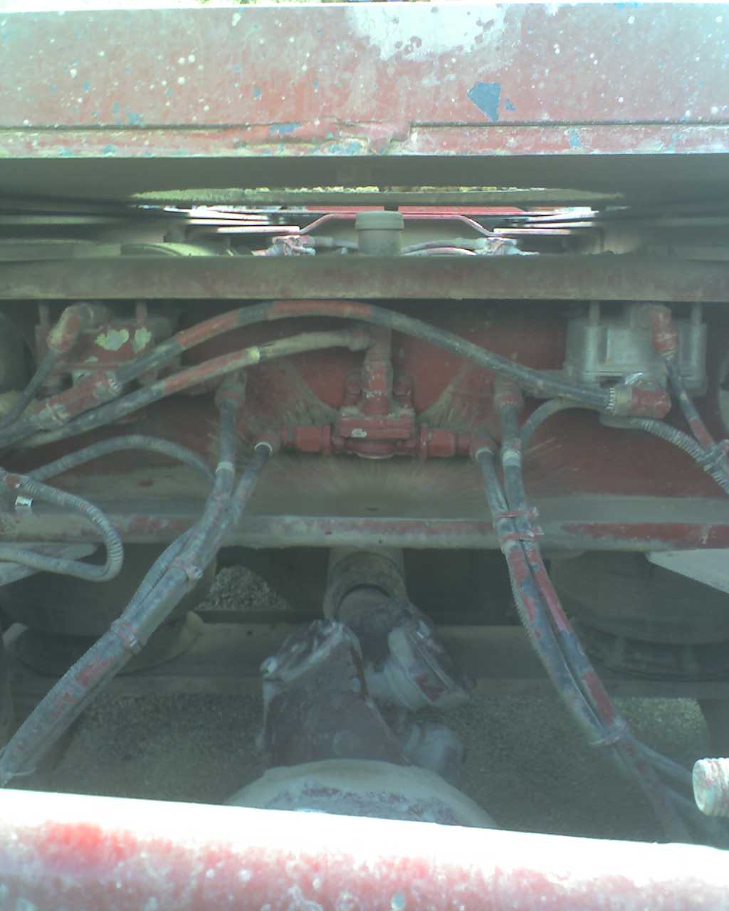

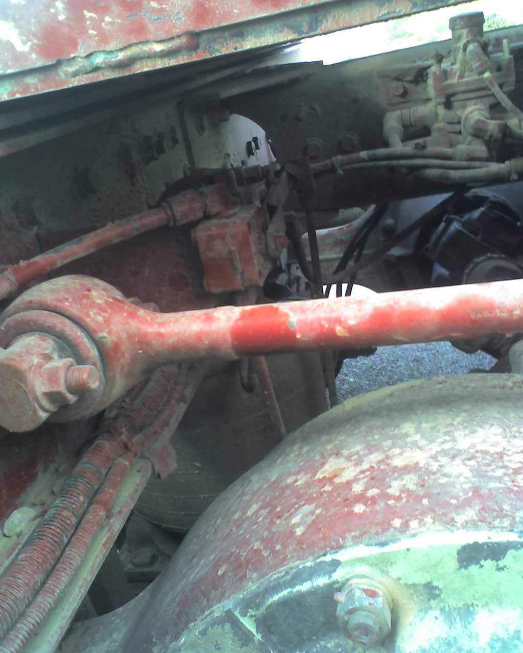

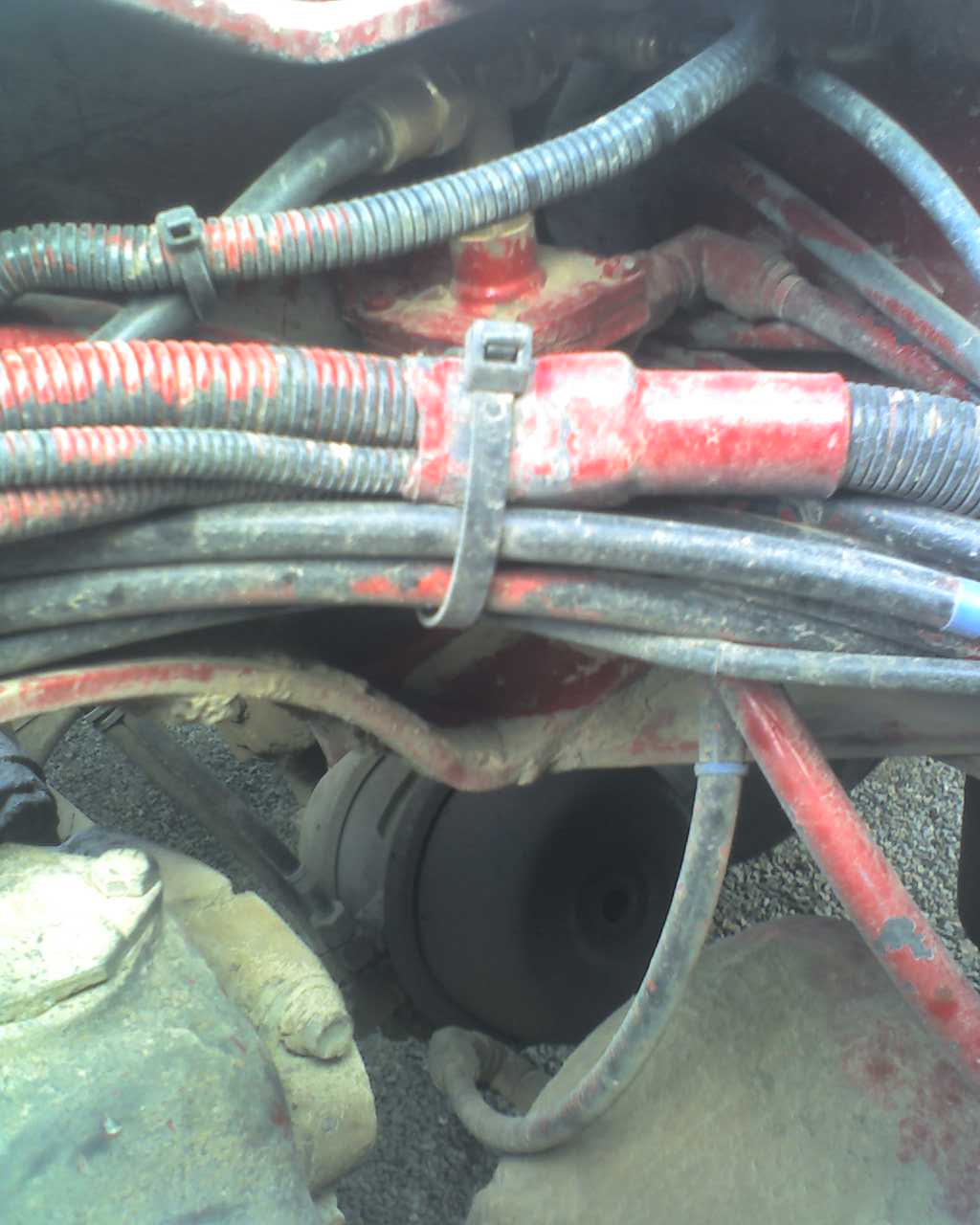

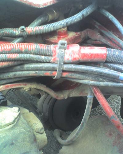

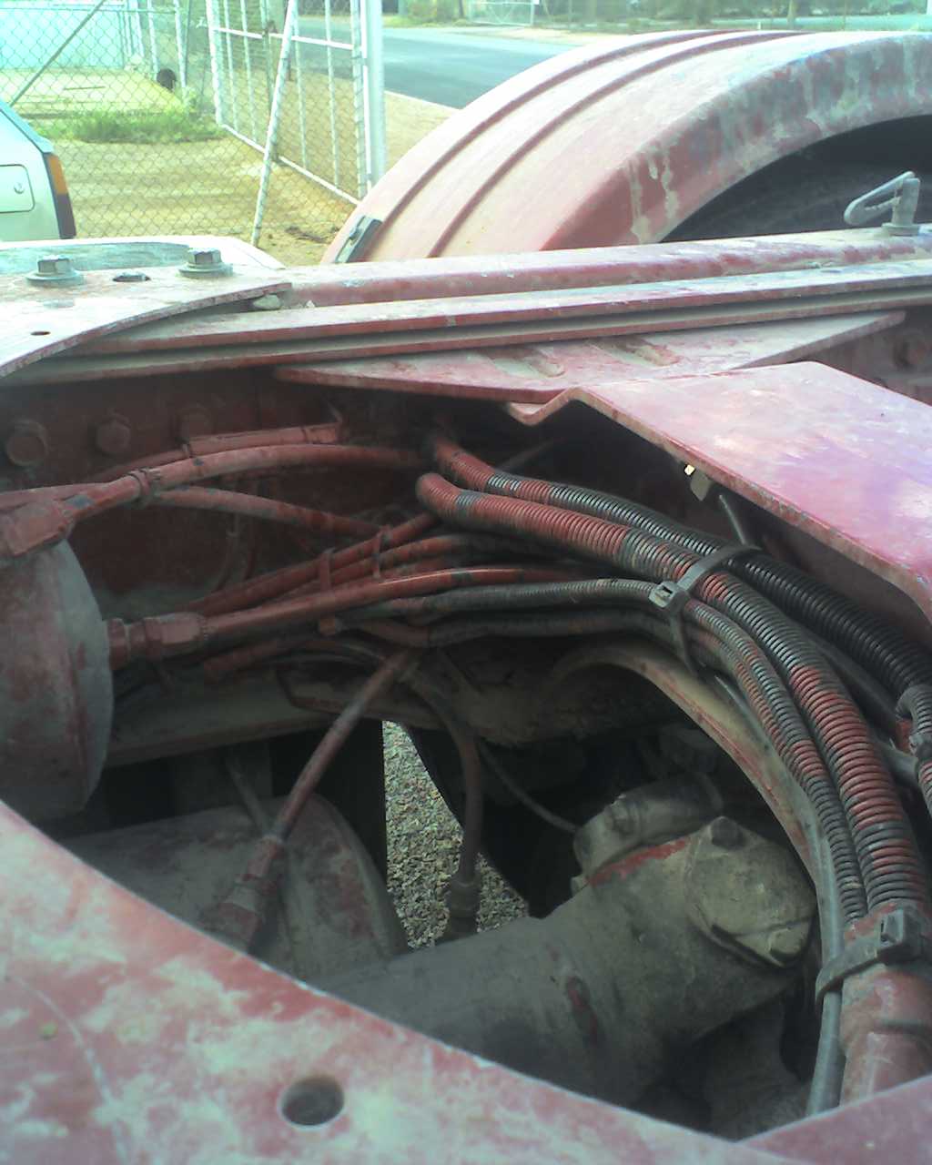

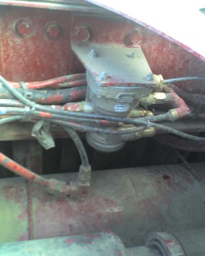

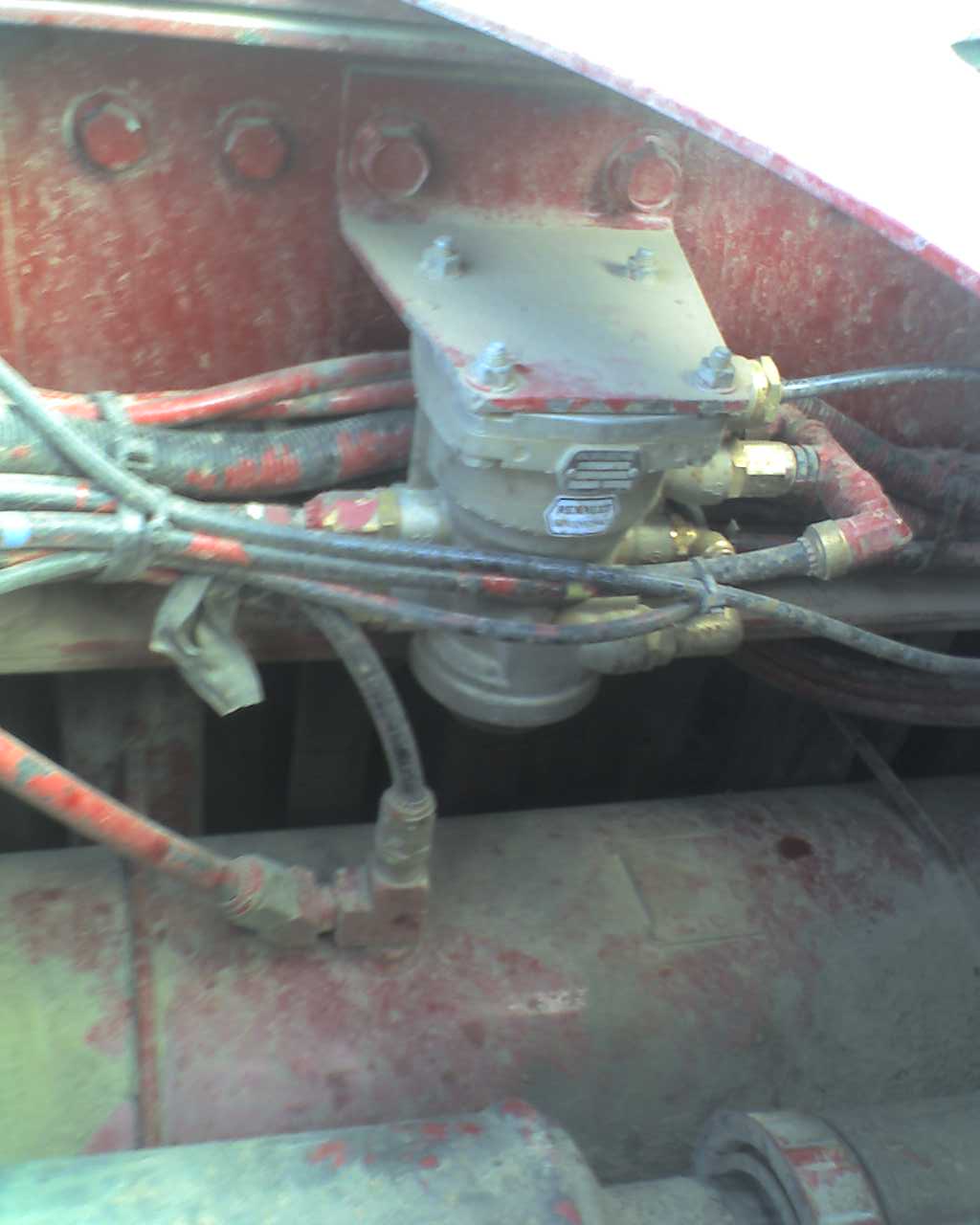

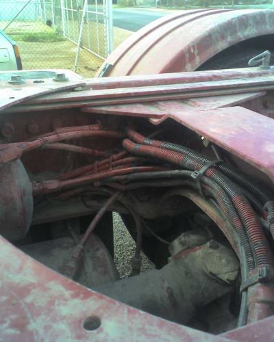

Yep can do that for you Thaddeus. Won't be til tuesday though. I finally got an air leak on this thing that was easy. Leaky QR valve on the rear drive. 10 minute job. Something has to go my way sometimes. Pretty average looking engine bay til you look at it from underneath. LOL. Just an EA7-470 stuffed into a european (Renault) chassis. Will post pics tues night (local time) hopefully.
Some pics of this things air system rear of the gearbox.
