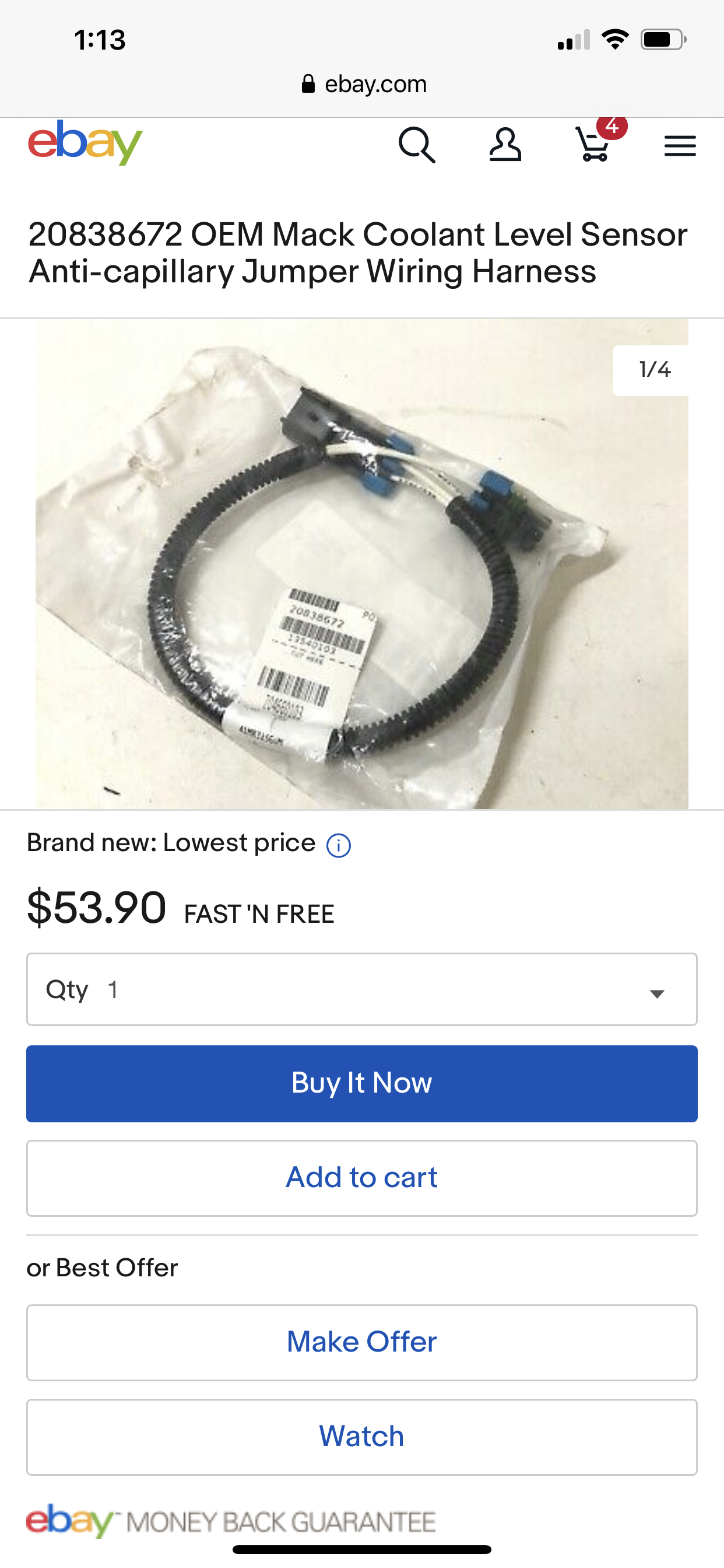

Good find on that., Mack had a issue with the coolant level sensor leaking coolant into the wiring between the copper and insulation. The coolant would travel back into the engine ECM . One of the side effects was the dash cluster going out. Mack Service Bulletin SB237009 covers the issue. They came out with a jumper wire to go between the coolant level sensor and engine harness to block the coolant from getting to the ECm . Unplug your coolant level sensor abs see if it’s wet inside.
Good info.  I will check this today.  The truck had a slow coolant leak for the past couple years.  This past summer we were adding roughly half gallon a day.  The truck originally had the two plastic purge/overflow tanks. The radiator cap was not sealing so this was a suspect coolant leak.  Both of these plastic tanks were replaced this past summer with the new aluminum single purge tank.  And then in December the radiator was replaced.  I suspect the motor was cleaned / sprayed off during this last repair.
