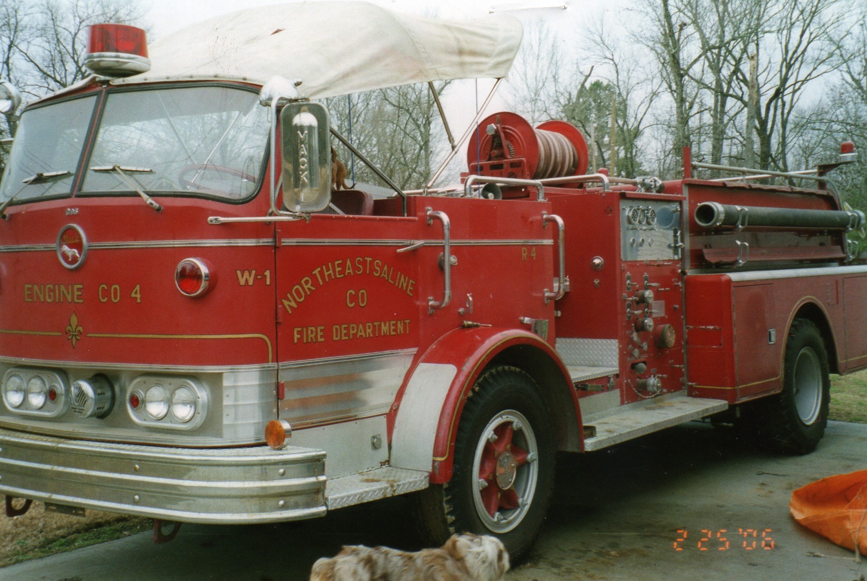

Recently acquired an 1966 C-95 open cab Mack fire truck. This truck has the thermodyne gas engine. Looking to convert it from a 12 volt postive ground system to a negative ground system. It does have the big alternator with AC output as well.
I've been doing some reading in a factory service manual for the truck and it appears that it should not be too hard to convert. What i'm not sure about is the alternator. Will the alternator charge correctly as a negative ground system? Will I need to change the leads on the coils around to optimize the performance as a negative ground? Any help would be appreciated.
