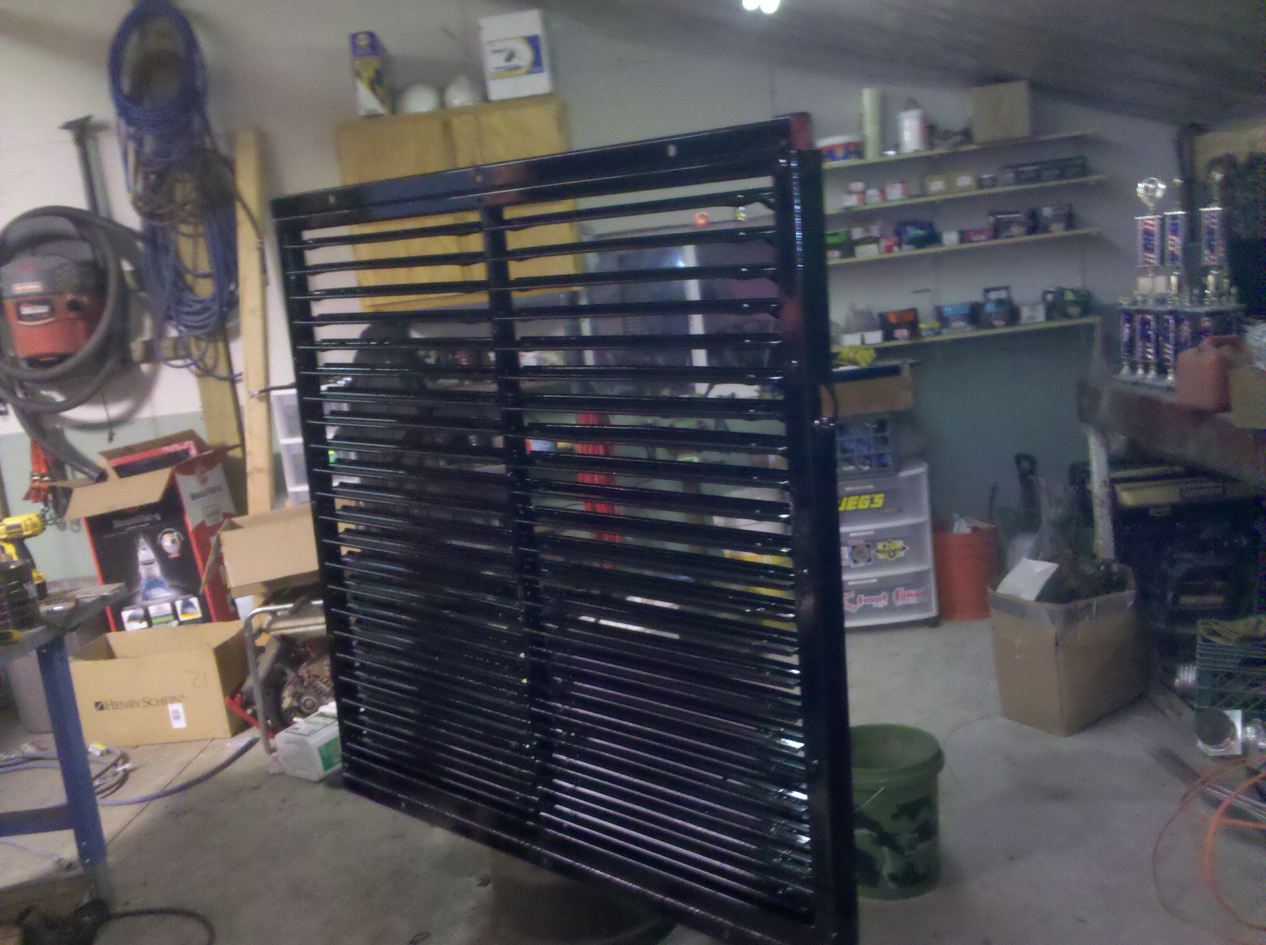

I got my old B Model home a few months ago and she has been doing a lot of sitting, but this weekend I actually got a few things done. The first part I decided to restore was the shutters, seemed like a good place to start, at the front, LOL. Hopefully I can actually get a little heat into the engine once I get them back in. Before wide open with a 22K lb trailer I could only get 150 deg. post-4682-0-15139000-1294640749_thumb.jp

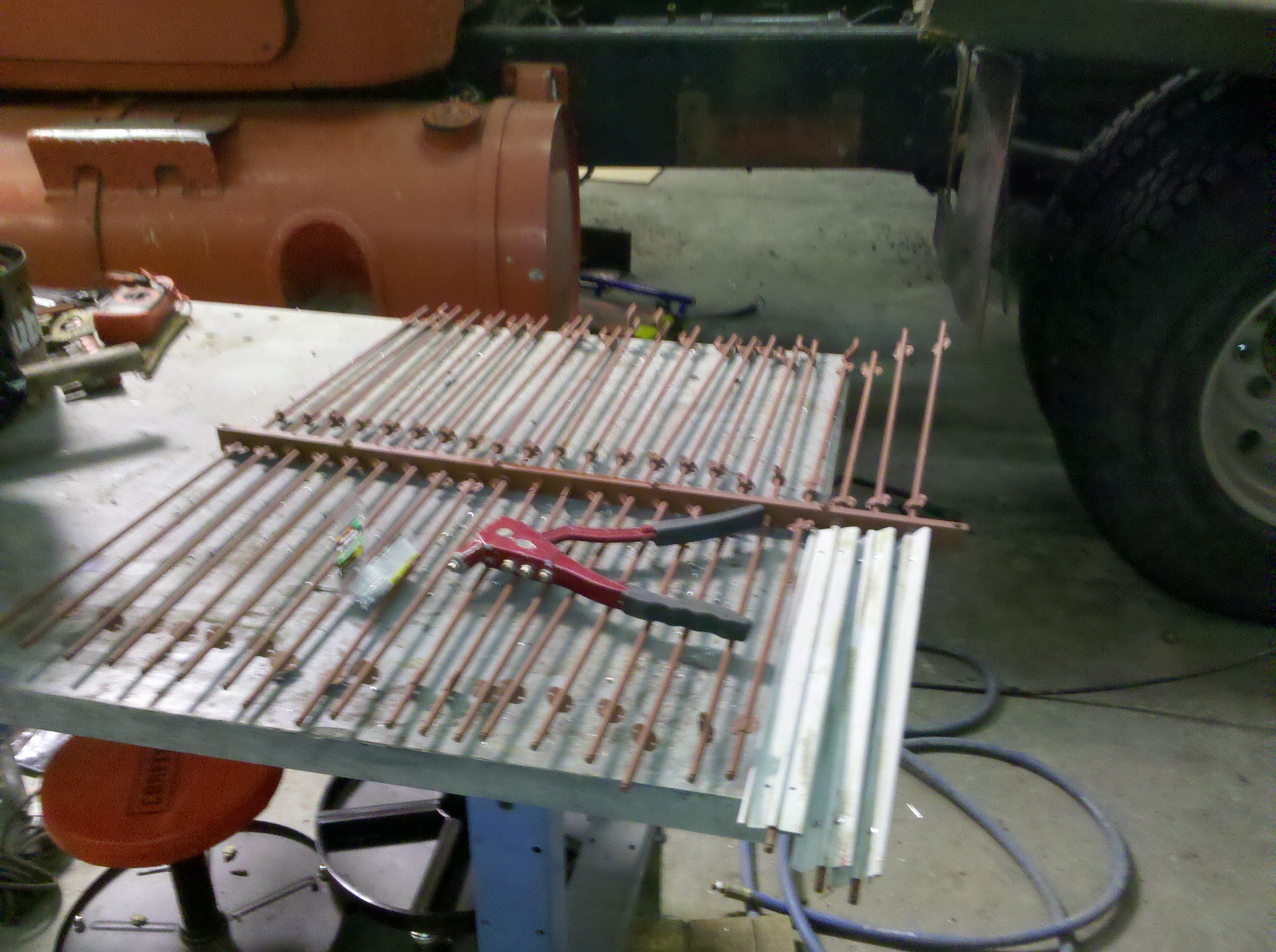

Completely stripped them down and blasted each part, refreshed the cylinder with some air tool oil and a clean up, and then riveted it all back together and a fresh coat of paint. post-4682-0-80851800-1294640828_thumb.jp
