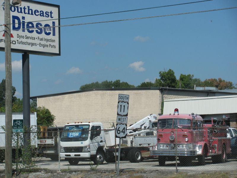

After being in storage for 2 years, last year I found that my '64 Mack C series with the 707 Thermodyne gasoline engine (6 cyl) is running very rough, won't accelerate under power, and smokes and backfires when I try. I brought it to Mack of Chattanooga and after 3k and 4 months, got back a truck with the exact problems I brought it in with.
At their recommendation, I tried SE Deisel of Chattanooga and now, after hundreds more, and another 4 months, they tell me that they suspect a valve/cylinder problem and have been unable to locate parts.
HELP! Does anyone know of a shop, or a private mechanic, that has resources to either find or manufacture engine parts to get my Mack back on the road? Here is the email I just received from SE Deisel :
"The valves are not seating in the head. Problem could be valve, valve insert, or piston burnt in valve, or a number of other possible problems that caused the valve not to seat. By the valve not seating the engine cannot fire due to loss of compression. We have called our Suppliers and have not found the parts needed. No valves, valve inserts or head gasket.

I am not a mechanic, nor do I have contacts that have been able to help me (these are the two shops that have done prior work on this Mack over the last 20 years). I'm very frustrated that TWO shops have been unable to make the repairs needed. Obviously I can, and have, researched on-line, but would much prefer to get some input from other collectors, preferably here in the south, who may have experience with such places that might help me get this work completed. I hate to think I have to tow this back to the yard and leave it to rust as a playground oddity.
