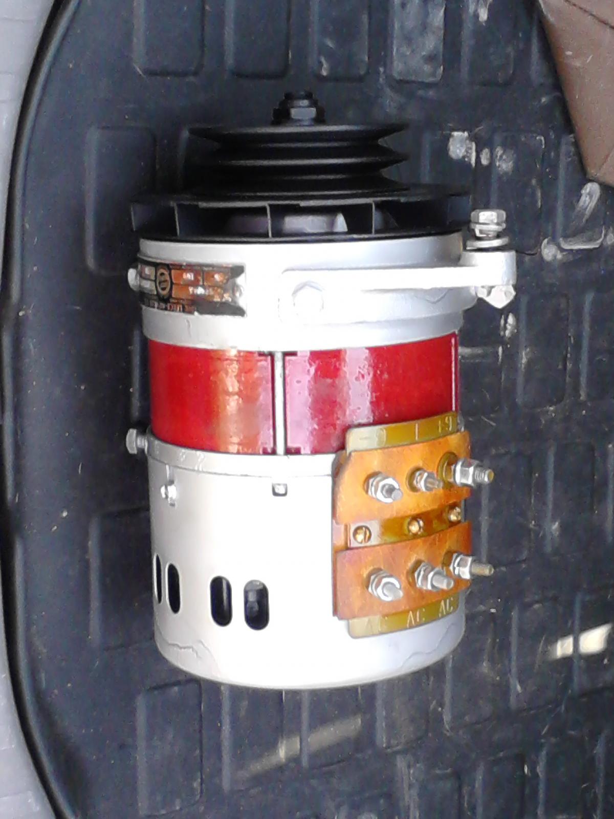

Does anyone know what voltages I should be reading between the different poles on an 8000 Leece Neville alternator when the engine is running? There are 6 studs with wires coming out off them on mine. Batteries are not charging when engine is running. It is on a 1966 C-95 Mack. Thanks fellas.
