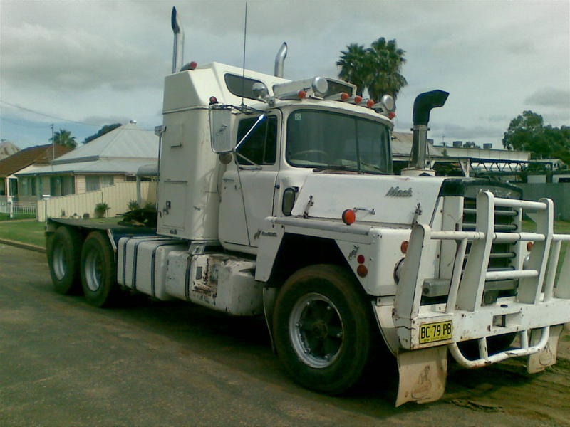

doe70 replied to doe70's topic in Truck Stories
Yeah it looks ok, or did, is stripped down fair bit now - dog box & aircond is off. was pulling road trains up till last yr, was used in northern aust mostly then worked its way down south. Had 73' dash put in it in mid 70's as well as leather lining etc to modernize it i guess. The quadbox was taken out and replaced with a D1070 ten speed, is easier to drive but will put quad back in soon. Also had chassis lengthened in 70's, has hydraulics and long range tanks. Motor is very good, has power steering (leaking). Plenty of rust in cabin but doable. Will repaint in yellow. cheers ellis -
Name: Mack R600 Flintstone (1967) Date Added: 09 September 2010 - 07:37 PM Owner: http://www.bigmacktrucks.com/index.php?/user/4534-ellis/'>ellis Short Description: http://www.bigmacktrucks.com/index.php?/garage/vehicle/335-mack-r600-flintstone/'>View Vehicle
