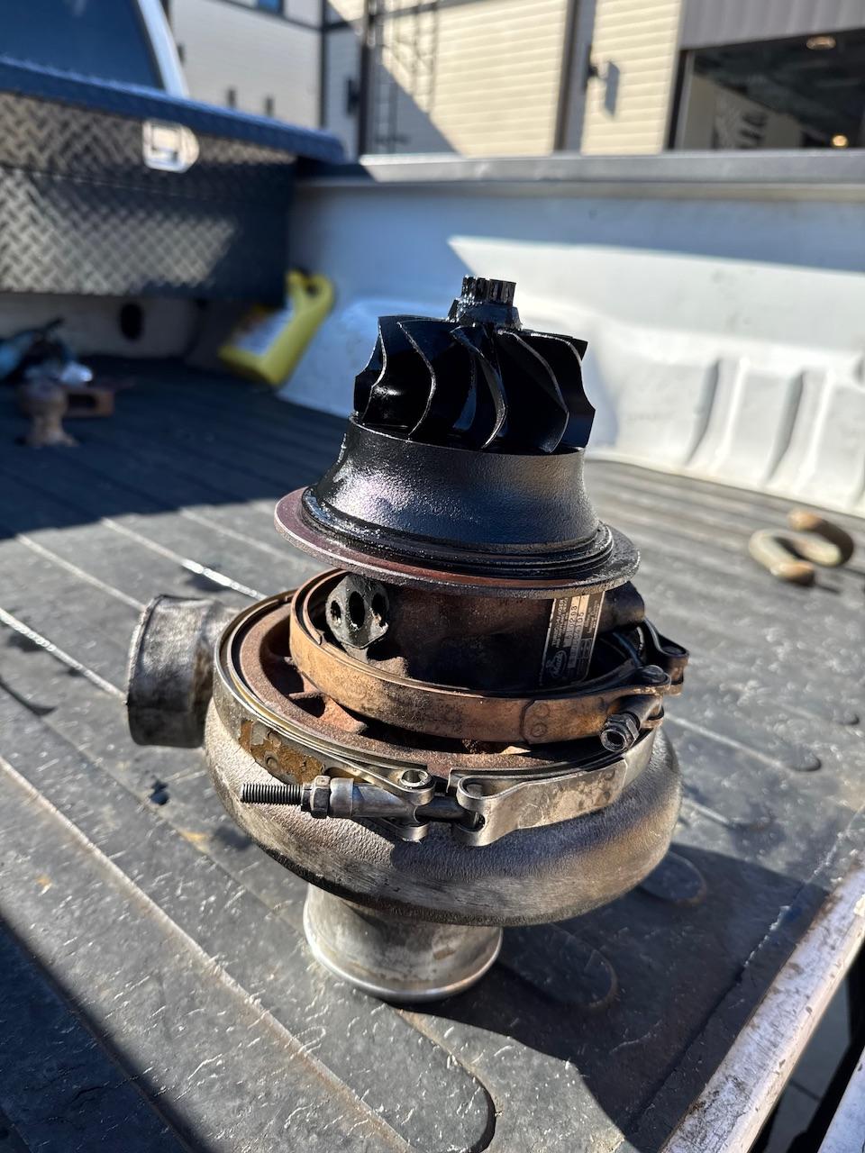

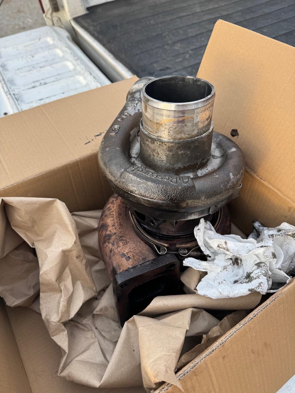

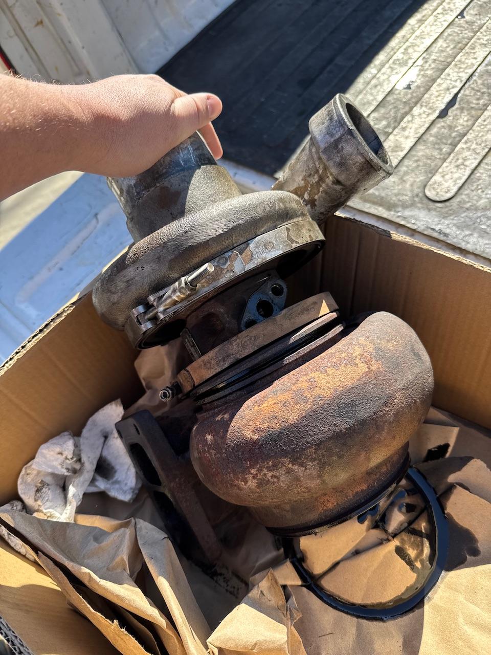

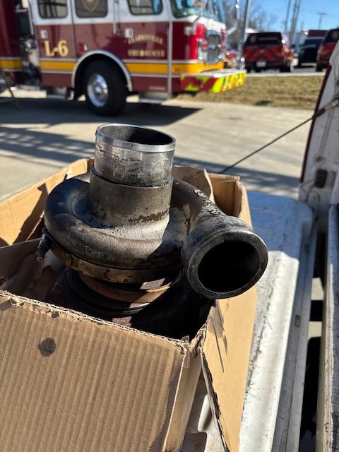

  8. I’ve been very curious about the 865/866 since I bought my fire engine with one. Not alot of information out there on them. still can get parts just have to dig. Turbo was discontinued but I had new one built to specs so it can be done reasonably

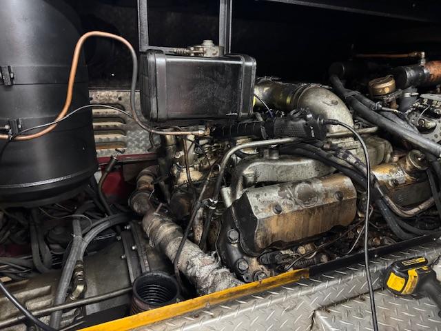

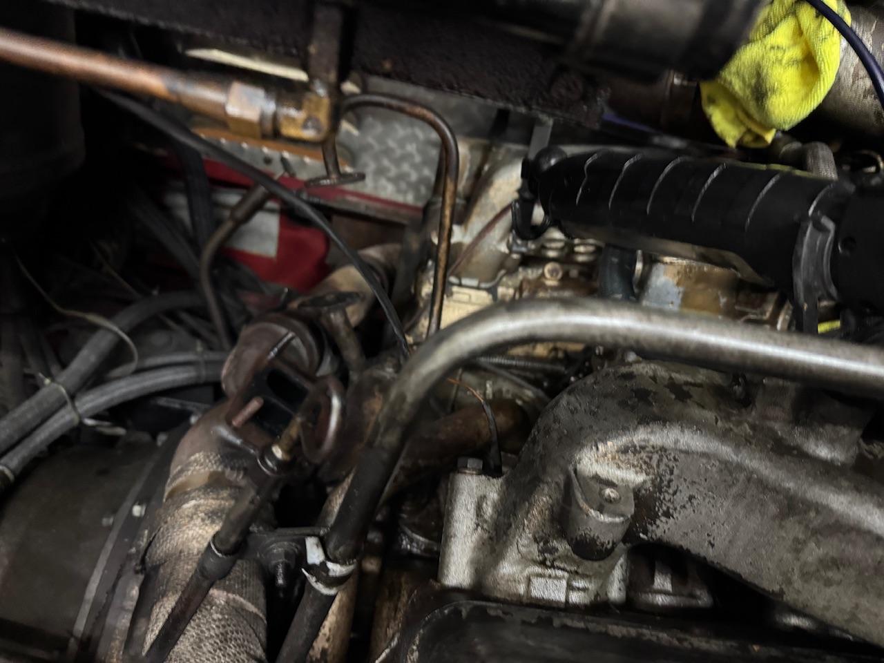

  9. Just wanted to thank everyone and give an update; Today I was able to get the old girl out for its first successful journey since thanksgiving. She ran flawlessly. 90lbs of oil pressure hot cruise and 45lbs hot idle on a fresh service. the new turbo is definitely an improvement over the original. Now just have to run it some more to build up my confidence
  10. That’s awesome!! Another cf700. bearings, I’ve seen a few floating around. You can get parts just takes some digging. they are out there still. Just went thought similar with my 865 finding a turbo. Takes some patience and research.

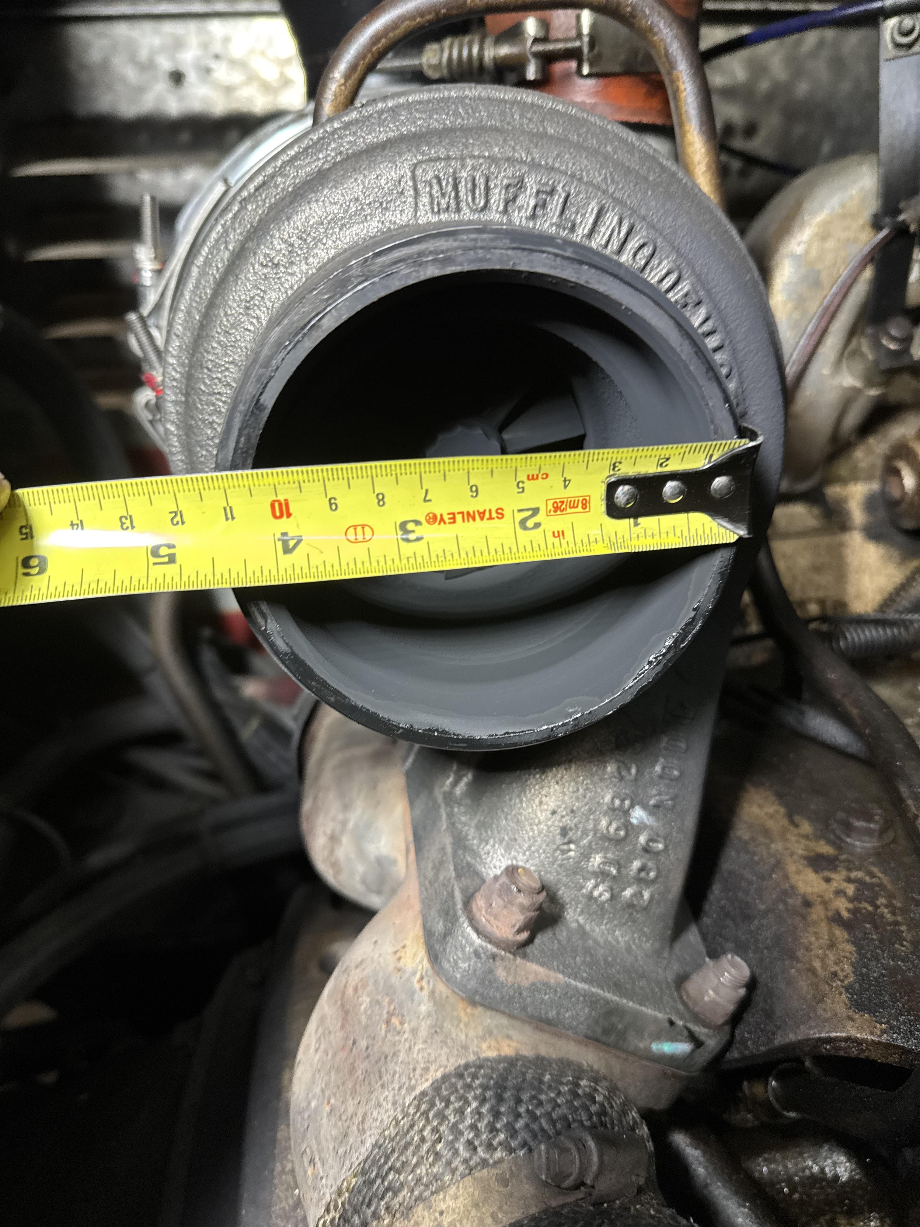

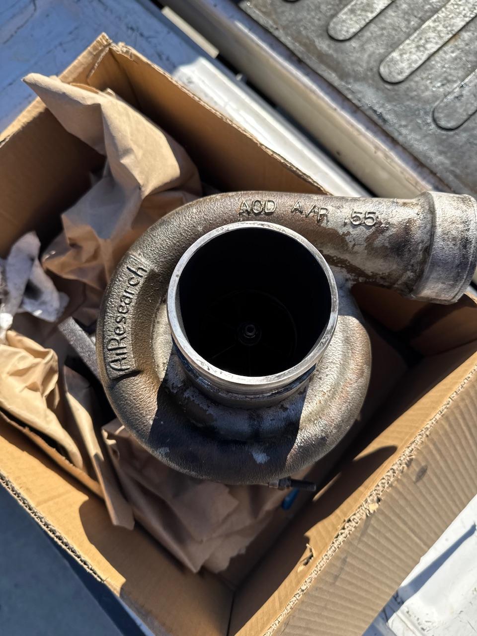

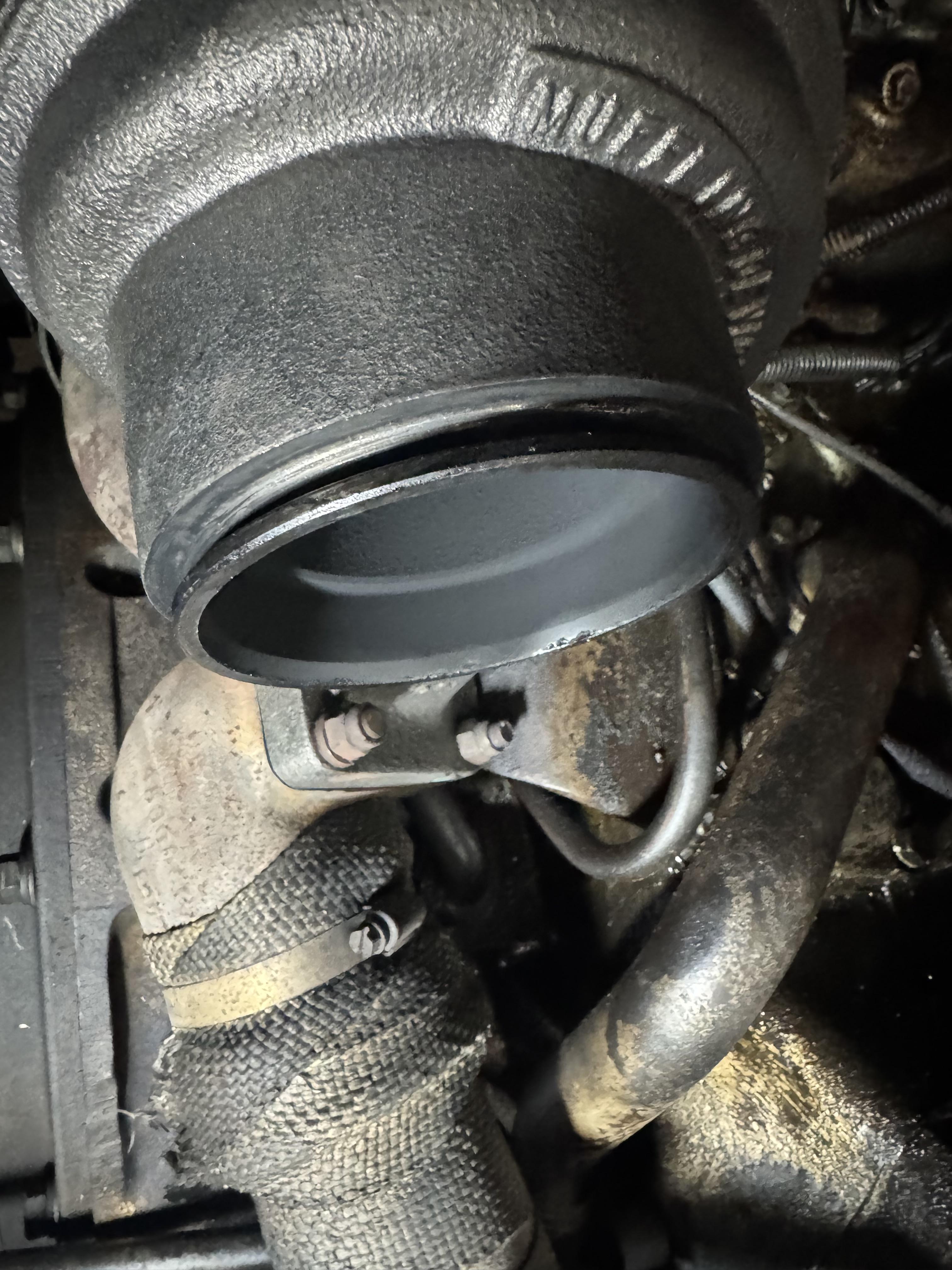

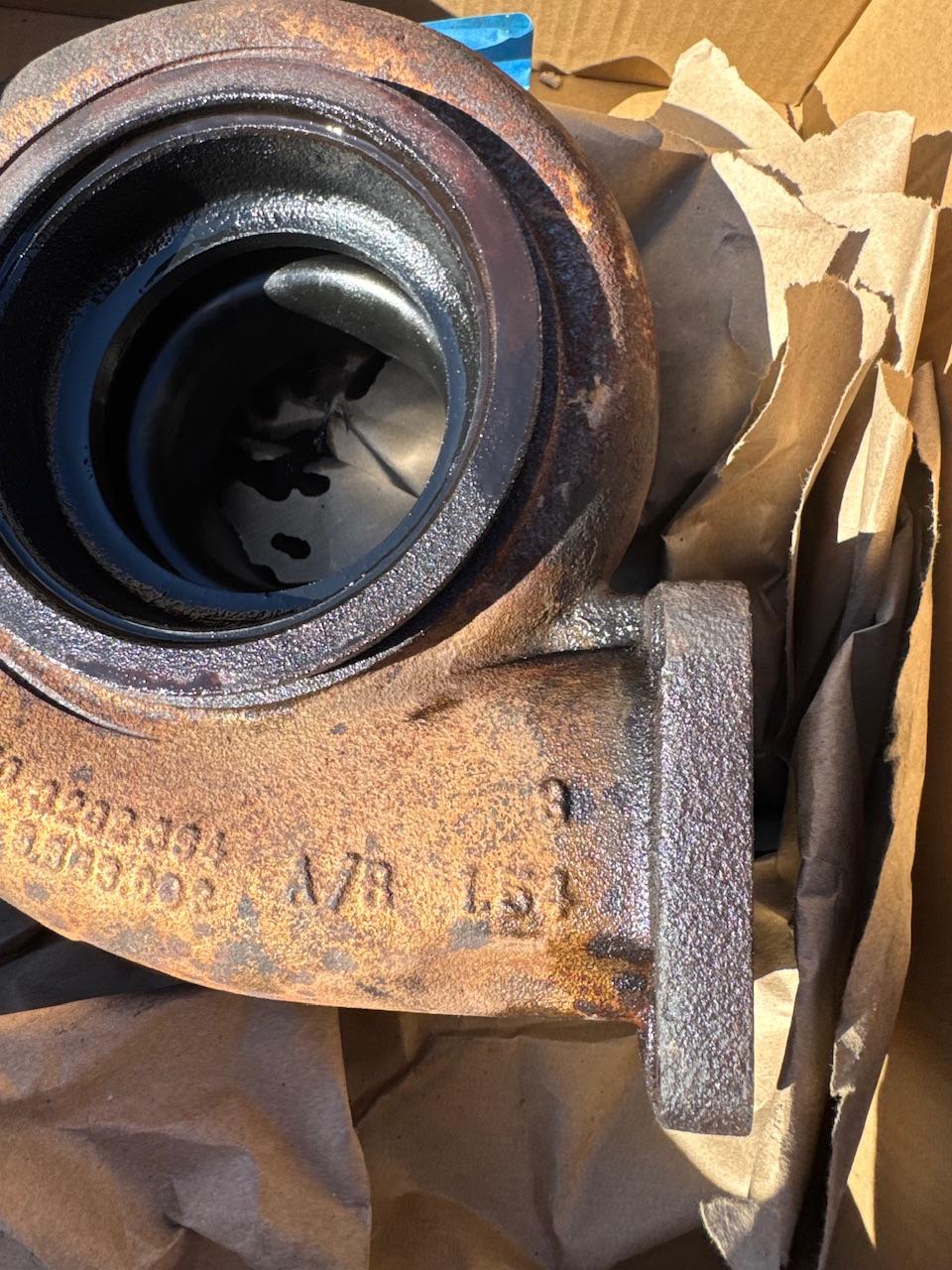

  12. Gents, recently put a new turbo on my 865 in my CF795 i need help identifying this turbo flange to get the right parts to build a new downpipe as it is different than the original. Thanks in advance.
