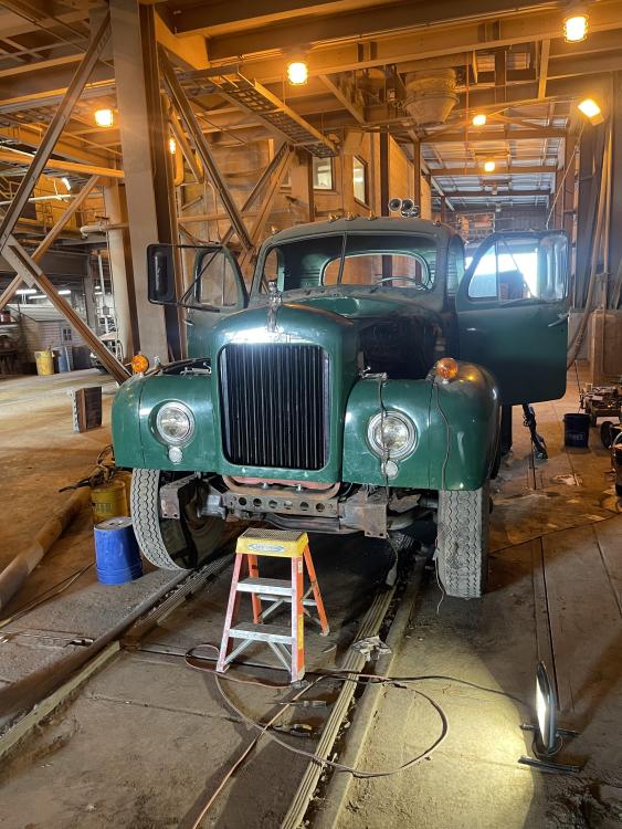

	Thanks, guys!! I drove it around the port for about 20 minutes yesterday to “shake it down”. Got it up to operating temp, or just below. Shutters seem to work as they should. Everything seems tight, but I’ll look at it better today to be sure. Exhaust stack should be going on today. I’m going to go get my seat from the upholsterer in a few minutes, so that might go in today. Should be better than the folding metal chair I have in there at the moment haha. Maybe get the hood on today too.

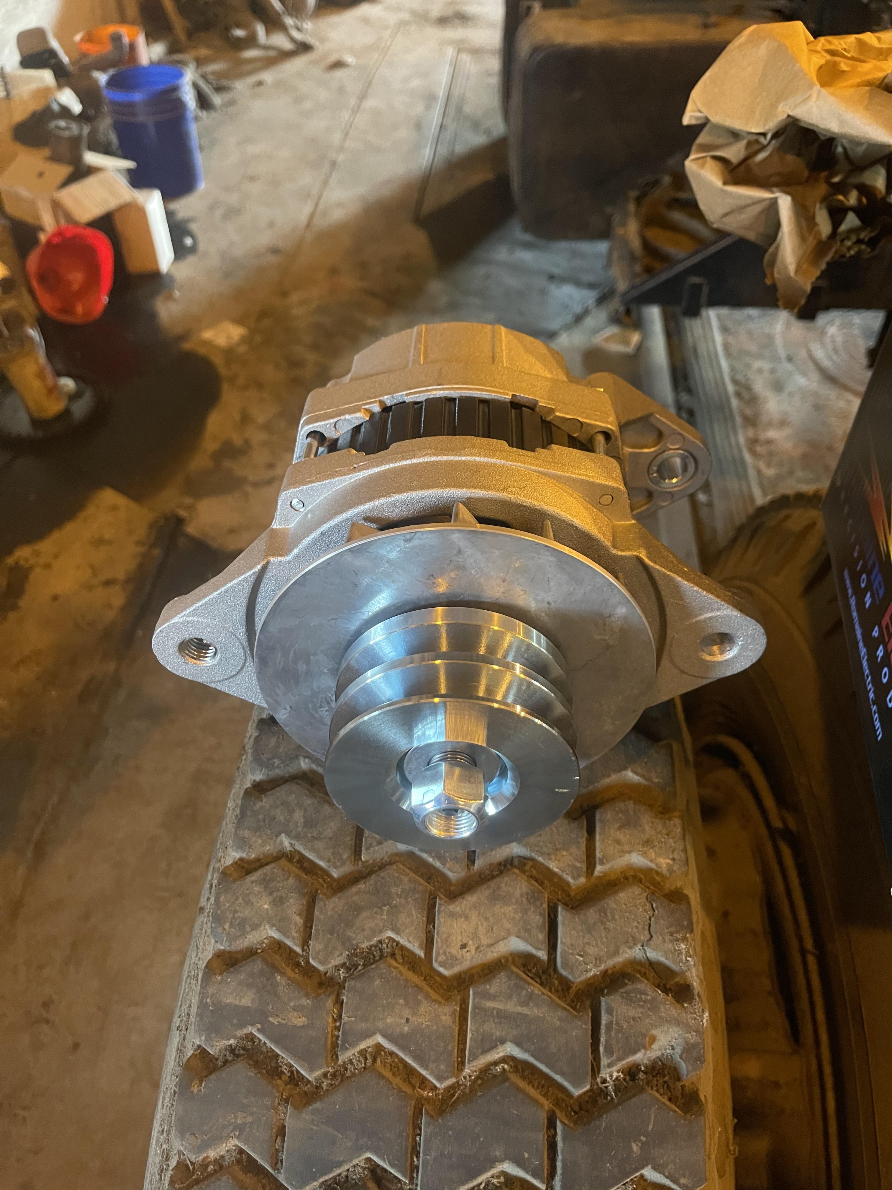

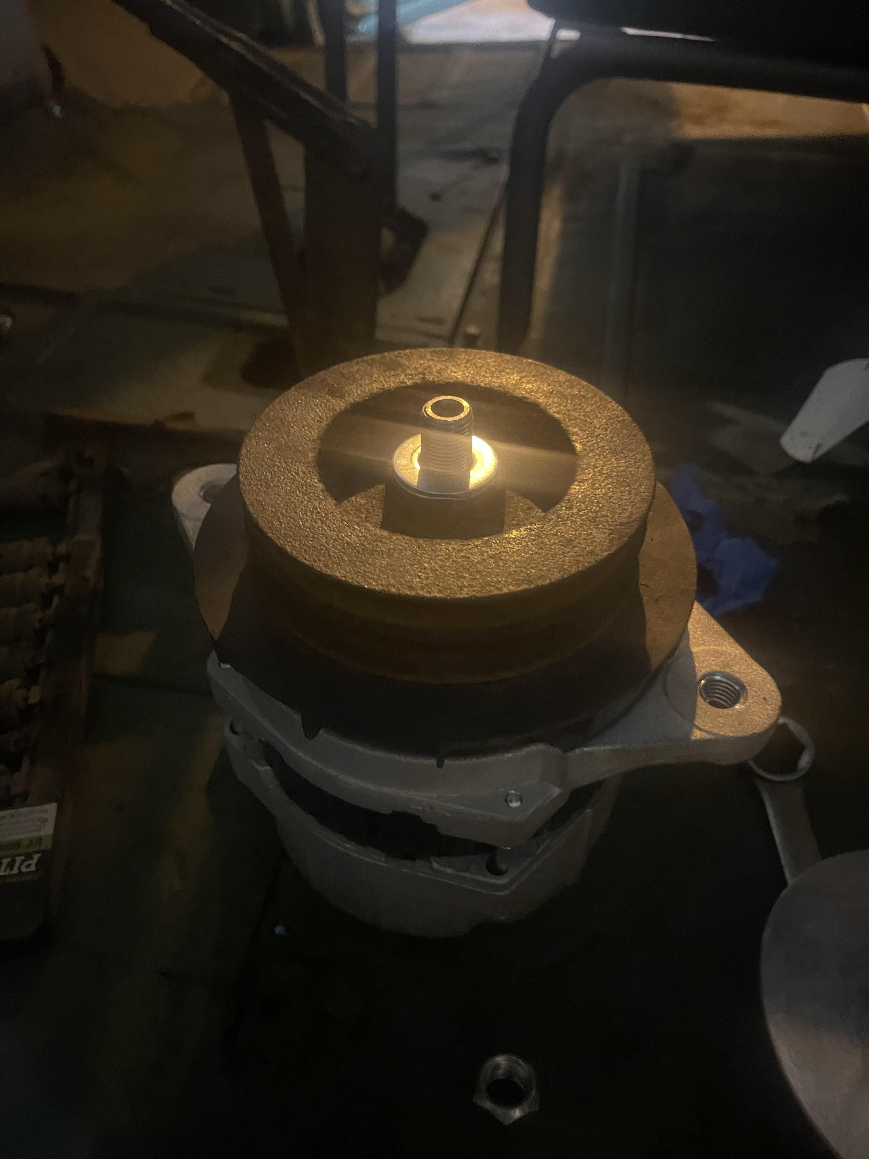

	I’ve got the smaller pulley, I can run that. I was just thinking of not having to figure out what size belts I’ll need and saving a few bucks haha. I’ll put the smaller one on tomorrow and try to get it mounted up. Just gonna run some 1/2” all thread for the bottom bracket I guess.
	So, what’s to stop me from using the pulley from the generator? Fits right on the shaft. Doesn’t seem to have any interference. Anyone do this?
	What size fusible link are you all running between your battery and alternator? For those that run an alternator. The alternator tested at 180 amp, so a 200 amp fuse is my thought.
	Shutters seem to be working too. Also have a new voltage gauge and temp gauge. Might get those installed and wired tomorrow. Have an alternator for it too. Still waiting on the pulley to arrive. I’ll fiddle with the belts once that’s installed. Floors bolted in again, too. Brake light work. Was messing around with the threadle valve and saw the brake lights going off when I’d block the air coming from them. Had the line to the service brake valve off and was blowing shop air through it to clear all the oil that was in the system. Old compressor must’ve leaked by I guess, I don’t know. I’m sure I’m missing some stuff to add, but I’m getting closer.

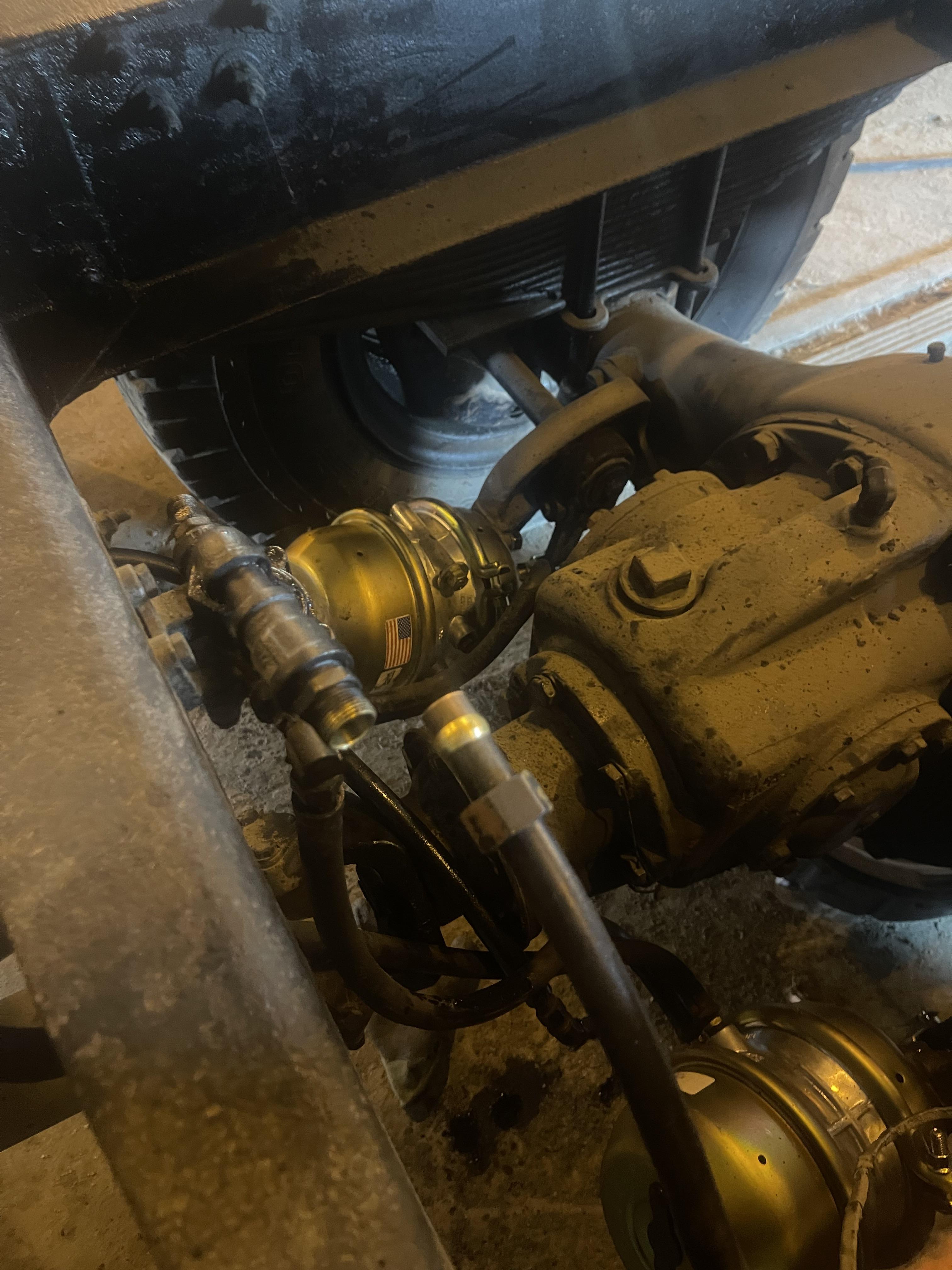

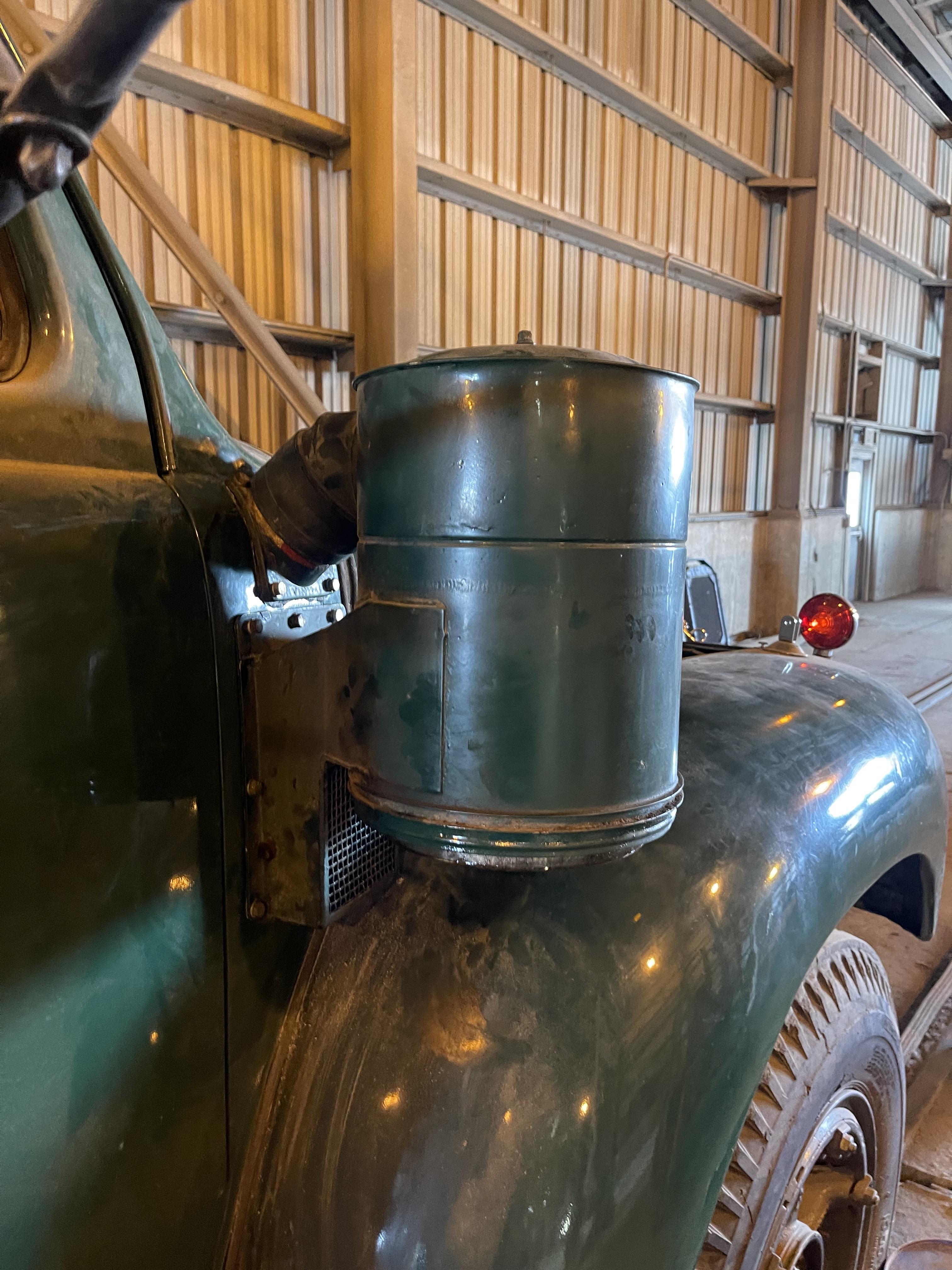

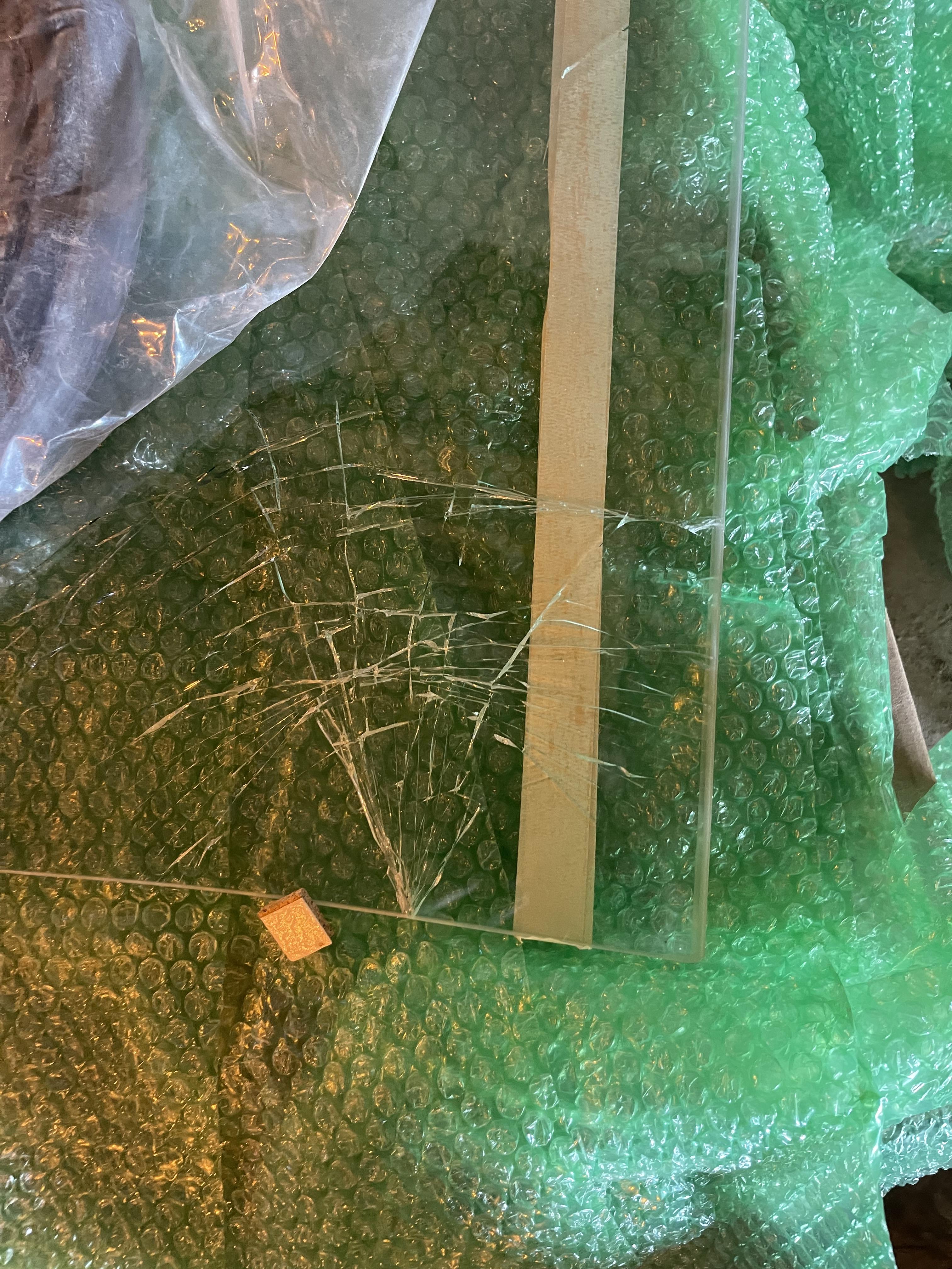

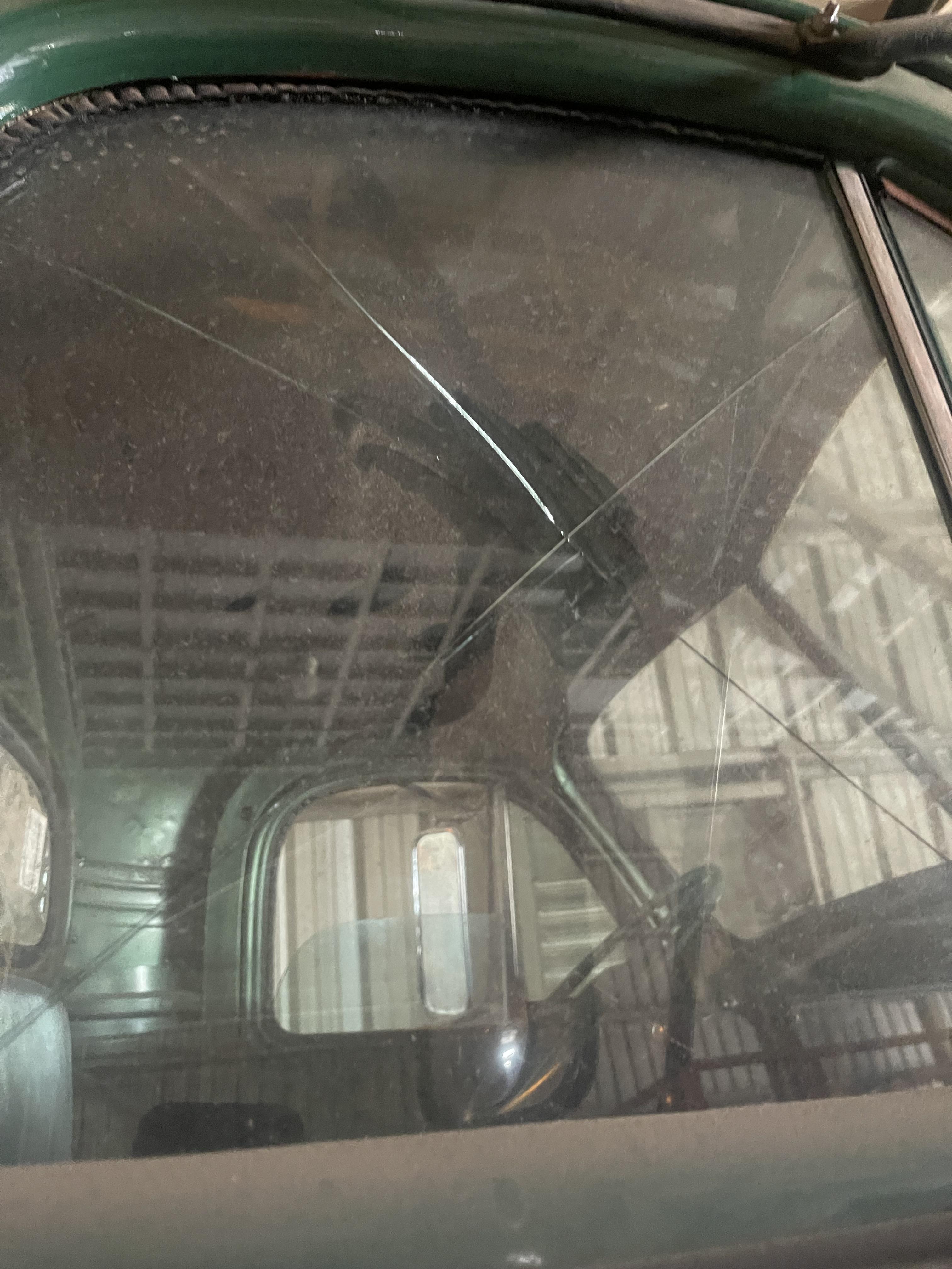

	Making progress. Pulled the windshields out of the box today and broke one. Pulled one out of the red truck. Got them all installed anyway. Boy, that lock strip is a pain in the ass. Adjusted the passenger door latch, slammed the door and broke the passenger window lol. I’ll pull the drivers window out of the red truck, someday, and replace. Got the fenders and grill shell bolted up today. New brake chambers got out on this week. Brought the driver seat to the upholstery shop this week, should get back next week. Got all the fluids changed. Got the air box mounted up. Whittling down the list.
