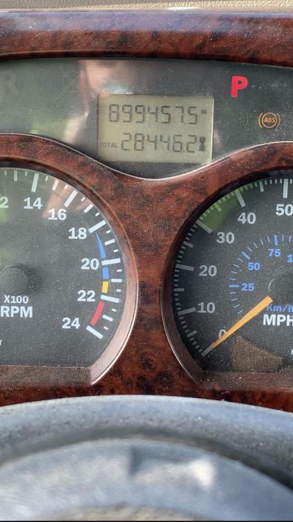

  8. There is a difference between an ASET-C and an E-Tech 7?? This whole time I though I had an E-Tech 7 engine, This may look crazy to a lot you that I’m asking and saying that lol sorry I’m new to owner operating I’ve completely got myself in a situation buying this damn truck. I can feel a whole hell of alot of potential on it until it starts acting the hell up with its low PSI Engine Oil and blue smoke accelerating struggles. Damn 😌
  9. Ok I’ll keep that in mind to get that aluminum coolant tank. Yes as you see I do have a few things going on and I’m curious as well as to what these issues are to Mr Green( the truck) he has so much potential I’m just not understanding what the hell 😣 that cold start engine is completely fine and runs at 50 psi idle. Once the engine everything is warmed up and the coolant temperature is warmed up (my engine temperature gauge isn’t working) that’s when the Engine Oil PSI drops to 10psi idle and accelerates up to 20PSI. This sucks 😌

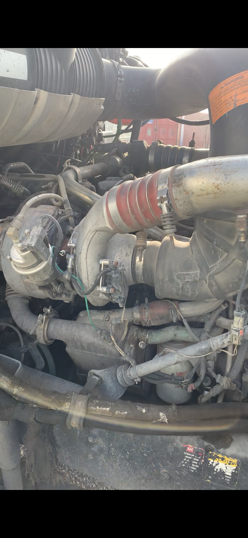

  11. This is a screenshot from the video I did that I was trying to post on here yesterday. Can you tell what I have from here?
  12. I actually tried to post two videos yesterday and I wasn’t able to. One video of a walk around to my engine so you guys can visually see what engine I have (I beleive the E-Tech 7) and the other video was to look at my gauges with the engine warmed up at idle.. I was told by the previous owner this Engine is very computer based on functioning so it can complicate a lot of things 😏

  15. May I also throw in that I have had my rods and main bearings checked and those are ok. I have had my oil filters cut open to check for debris and there was none found as well. Just throwing info in; in case any may ask about those.
