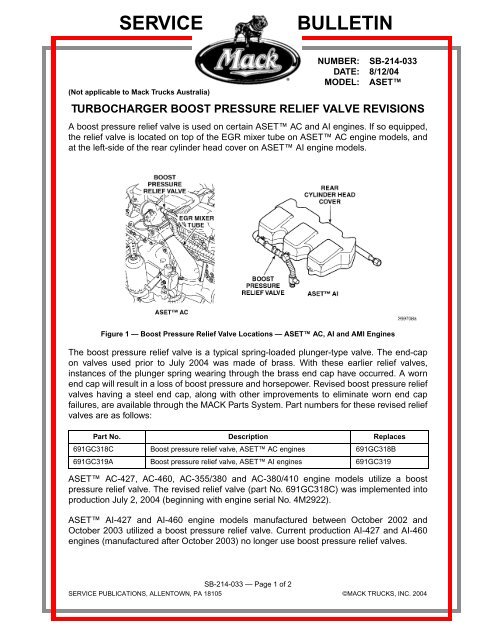

@fjh New Oil Pressure gauge, new Oil Pressure Sensor new oil pump, new oil cooler, correct gasket for oil filter housing New ECM 6 new EUPs pulled out camshaft that looks ok, but put in new Cam Bearings Kit Pai industries OverHaul Kit I heard on the service bulletin and through this forum the only things left could be the rockershafts missing plugs to hold the oil In; if those plugs are missing then that could be part of low oil pressure or the relief valve in the oil filter housing. what more could I look at for low oil pressure? -

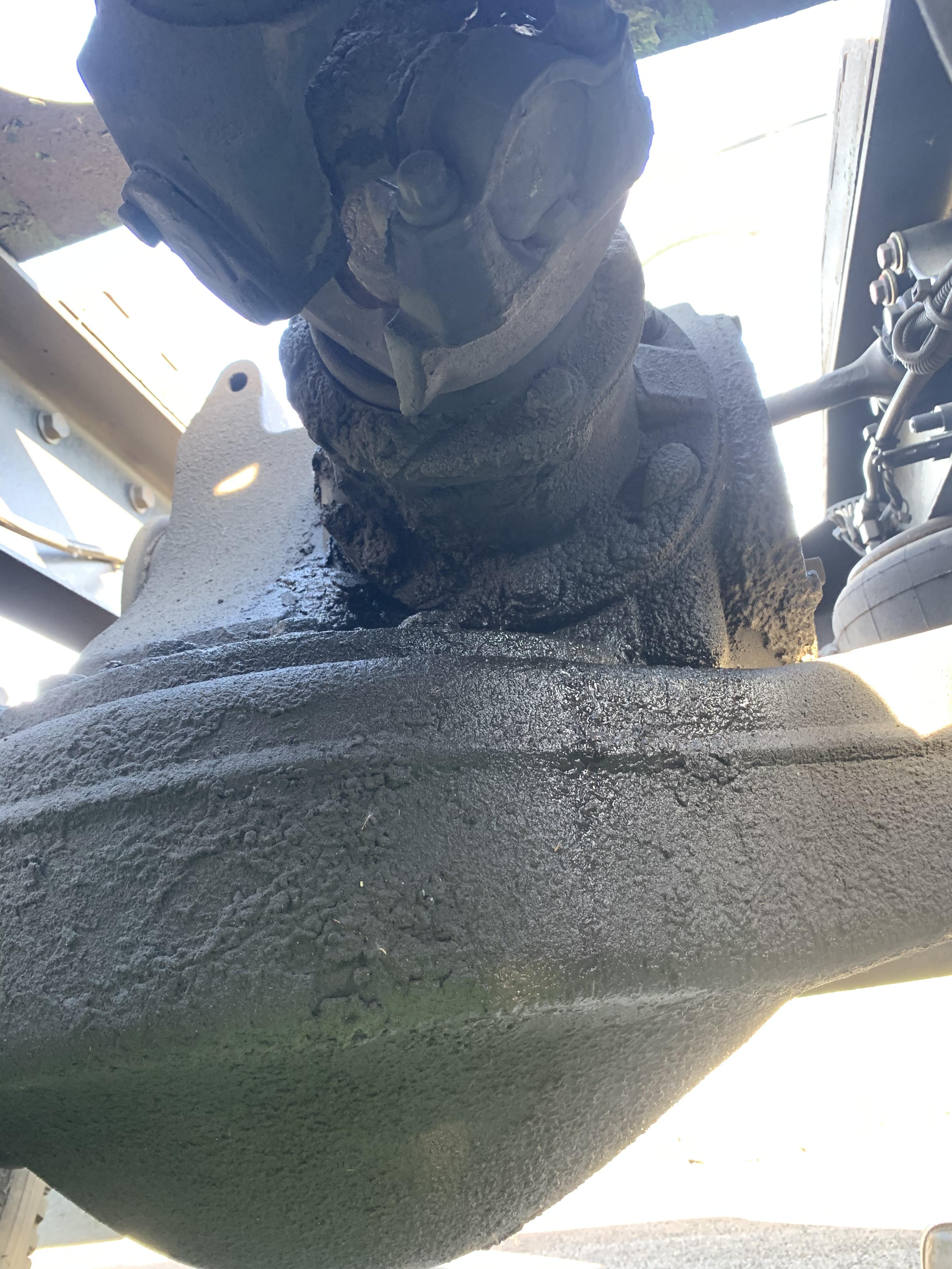

My post will be as stated in the Title. I’ve recently passed a DOT inspection 10/11/22. That same day at that same shop; they had filled differential oil in both rear ends. I drove 400 miles fine the next day (Wednesday) and by Thursday morning I heard and felt the performance in my truck very odd. I brought the truck back to the shop it was just inspected at. I had seen it for myself that the front rear end plug/bolt was missing and both rear ends were completely wet with oil! My front rear end was smoking pretty hard, cooked. This shop had failed to either put the oil filler bolt back on properly or forgot to even put it back on at all. Anyways, they’ve installed a reman front rear end but are trying to negotiate with me; admitting there at fault for the missing bolt for the oil but that another area to fill oil in that differential was either dry or little to no oil. This shop is saying where that other area to fill oil had no oil that THATS where the damage was and NOT where they failed to put the plug back on the rear end… I am trying to fight for no negotation to pay the new Reman for their behalf of failing to put the oil Bolt back on. I will try post pictures.

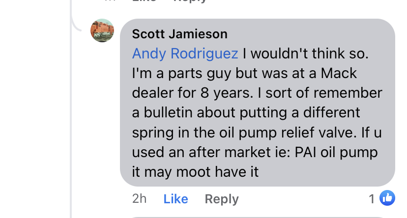

as far as I know is I’ve had my oil pump replaced from the first shop I went with that is well known in my region quite some time ago.. I am not sure if they used aftermarket or Mack brand but hypothetically if they used Aftermarket; have any of our guys heard of this issue with the aftermarket oil pump having a problem with the spring??? -

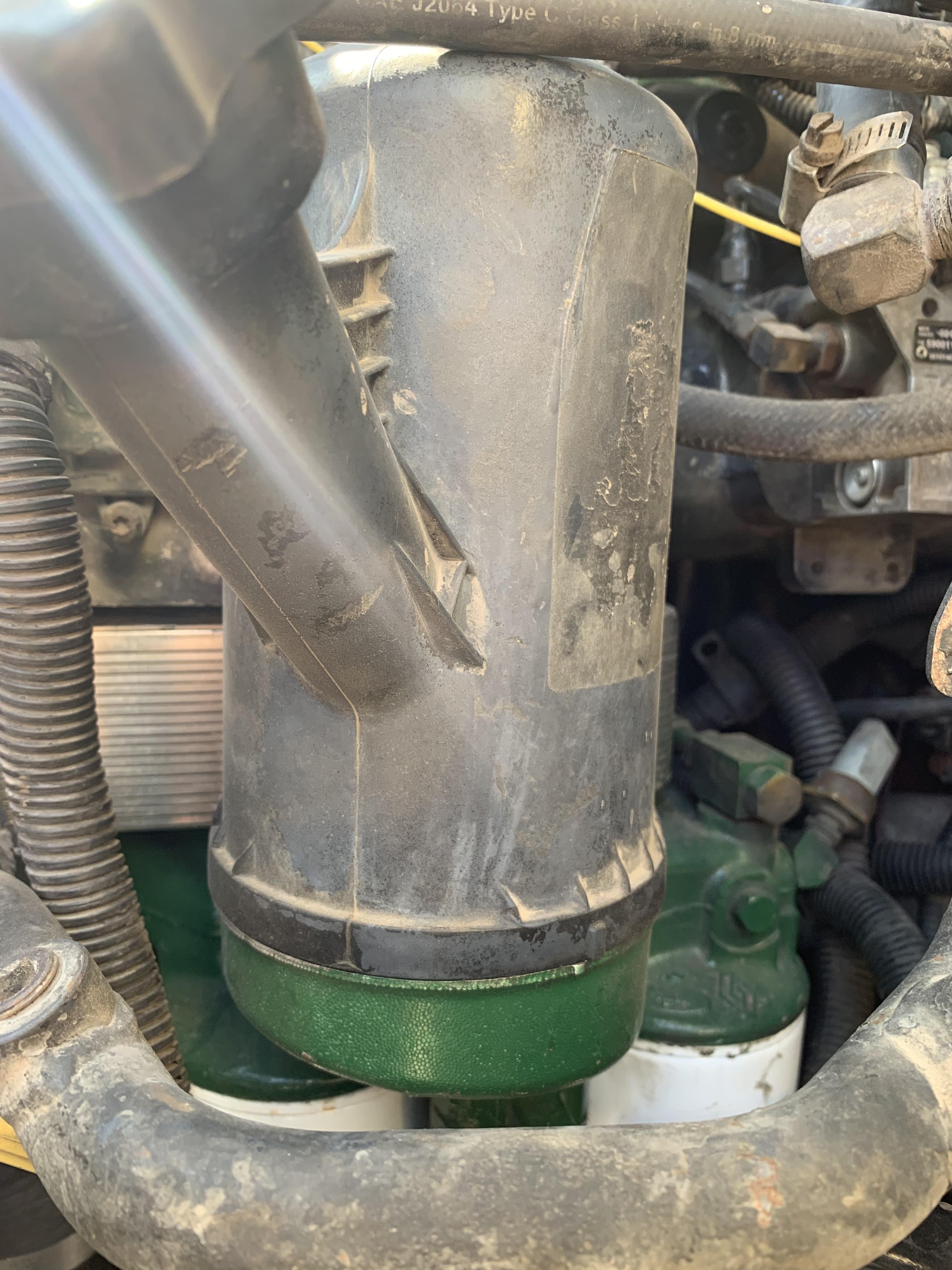

Ok fellas. Go back to the picture with the oil filter housing for me. That green painted part. What is that called? I installed a new oil pressure sensor and that didn’t change anything. So if I change that green painted part I am really hoping that solves my low oil pressure issue for damn sure. Again, what is that part called? (Thankyou Dawgs!) -

Ok so the green part with the white filters would be the pressure relief valve?? Am I looking for the loose/broke spring in there? Do I replace the spring or replace that whole part?? That oil pressure sensor I’m gonna say is attached but not wired/connected to anything… -

Is this where I need to be looking at? Inside that black oil filter?? Am I looking for a loose/ broke spring in there??? Also, do you guys see on the right side of the picture that dirty light blueish thing pointing upright what is that? Is there something that needs to be connected to that??? -
