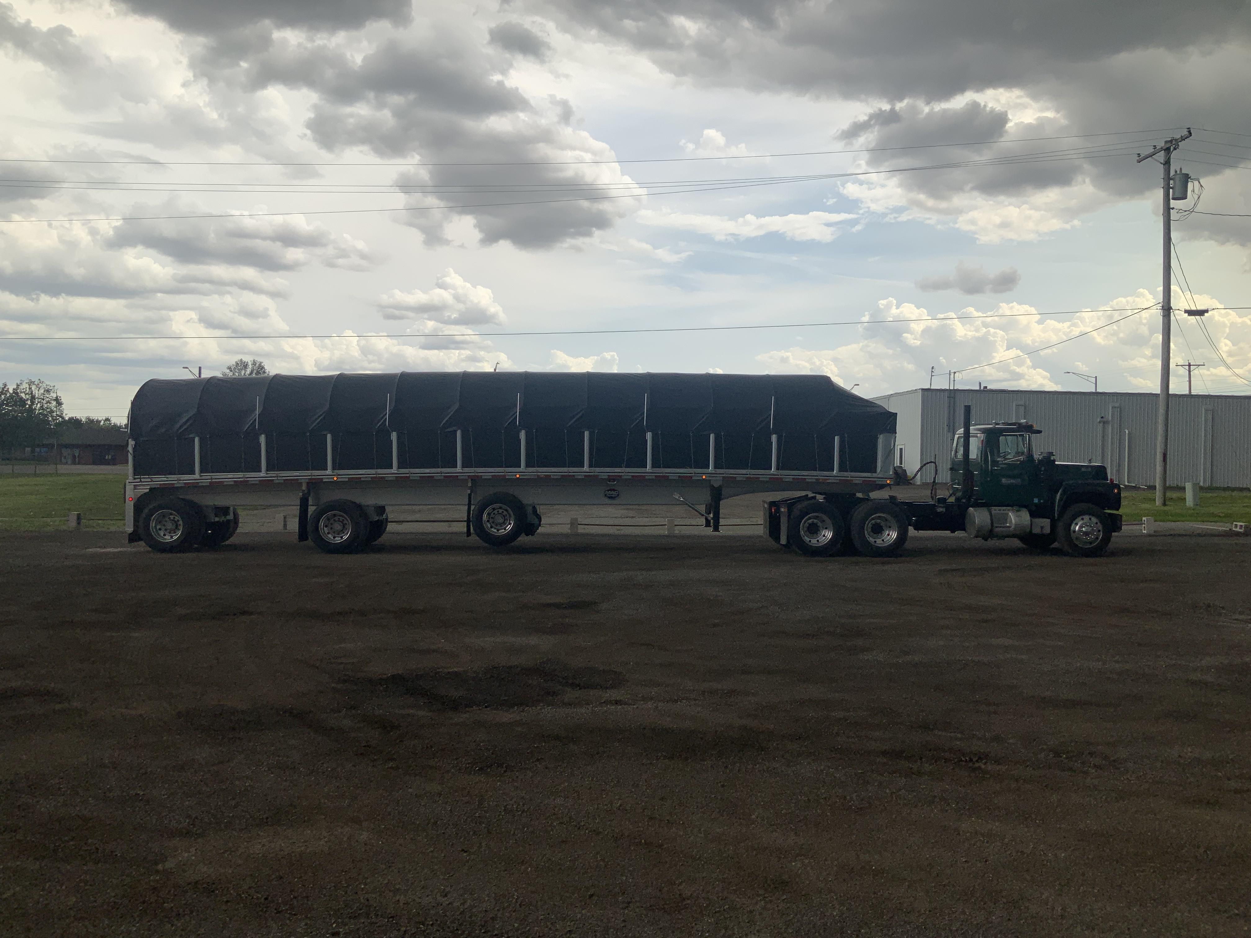

Not completely done but going back to work next week if all goes right. Still need a good set of tanks and a few other things but its close enough for now.

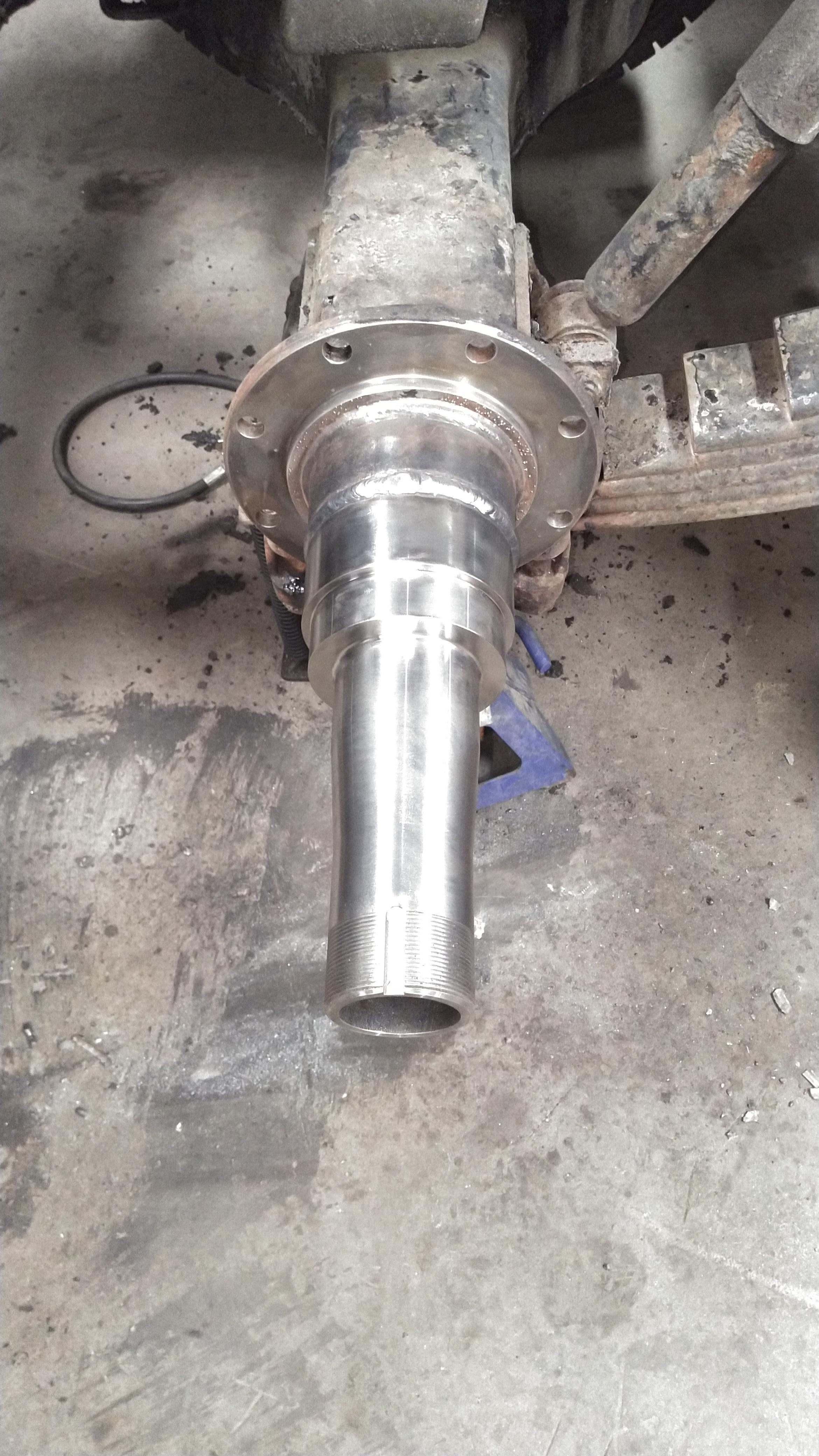

Maybe i'm as my wife says "just being me". I don't like vague or questionable. I like definitive. My jeep 6 died so it got a 440/727/dana300/dana60/14 bolt driveline. Its never left me walking. Given the original assembly was spin welded and it seems to have all the innerds that make up 44k axles (at least according to mack) and it is definitely better than the trail fix it had before so I'll run it. My 94' has a bad trunion and We were going to make it air ride so maybe i'll use a housing from that if they are the same. Still better than it was.

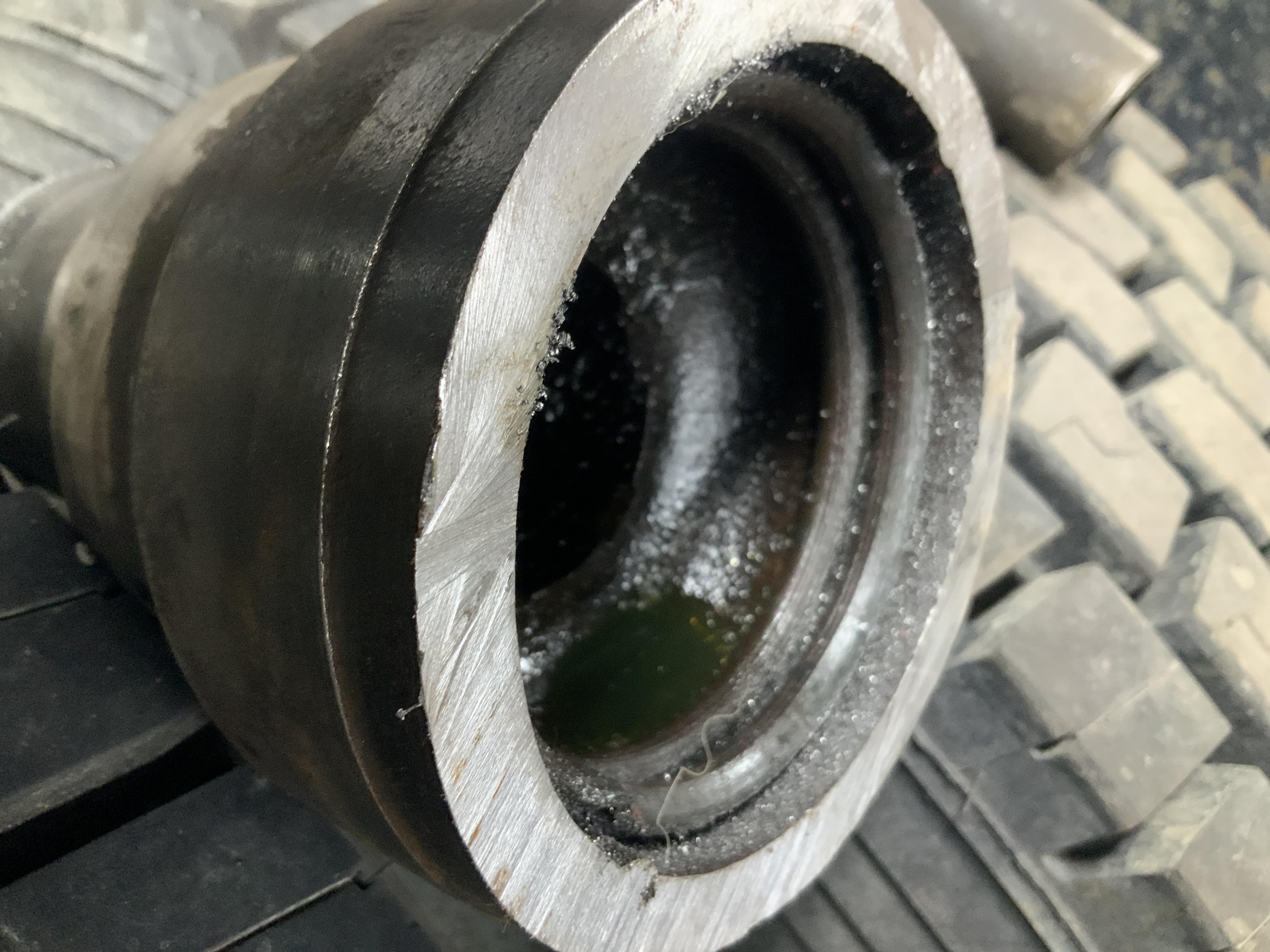

That spindle is hanging on the wall of shame. I do agree steve l. a pressed in spindle is what I wanted but apparently not available and after it was cut just inboard of the spin weld It became apparent why. Where the original housing goes from square to round is only about 4" deep. The transition from sq. to rd. takes about 1 7/8" leaving approx. 2 1/8 of clean round tube. In my opinion any insert is better than none but the axle fixer people apparently disagree. I guess time will tell. Maybe ill take a housing from the 94" r when it gets converted over to air ride and use it on this truck.
Sorry i said everyone as that was not the case. I did have quite a few people say the would run it though. The original spindle was a friction/butt weld. nobody had or even offered a press in spindle As far as straight well its not. It seems to be measuring out .010 ish pointed down and square L/R.
Hmm. guess i should have kept the 4" badly welded stub that everybody said they would run. The original was friction welded so no sleeve fit either. springs are 4003a's bearing surfaces on all four are 3.25 inner 3.00 outer with 2.27 id tubes with stamped housings. guess ill just keep my fingers crossed.

well he came and went and this is it. when he measured it it was 1/16 out vertical up and 1/16 horizontal forward.
Same here. axle surgeons should be here anytime. When I get it off i'll cut it in half lengthwise just so we can see if i was right.

Its been in the family for years. my wife thinks it happened in the late 90's and her dad had it done in a pinch and just never fixed it right. The truck was only used around the county to move asphalt trailers and rarley ever saw 55mph or a full load. I've got it going in on monday for a new spindle at axle surgeons. Really glad that I decided on new brakes and seals otherwise I wouldn't have known it was there. Really can't believe its lasted this long.
It was completly cut off and a piece welded back on. Some say run it. I personally don't trust it and with my luck it will definitely break right on the I-69 michigan scale and send the wheel set rolling into the scale house. So either a housing or a new spindle is the choice. Here at BEA transpotation failure is not an option, It comes as standard equipment.
