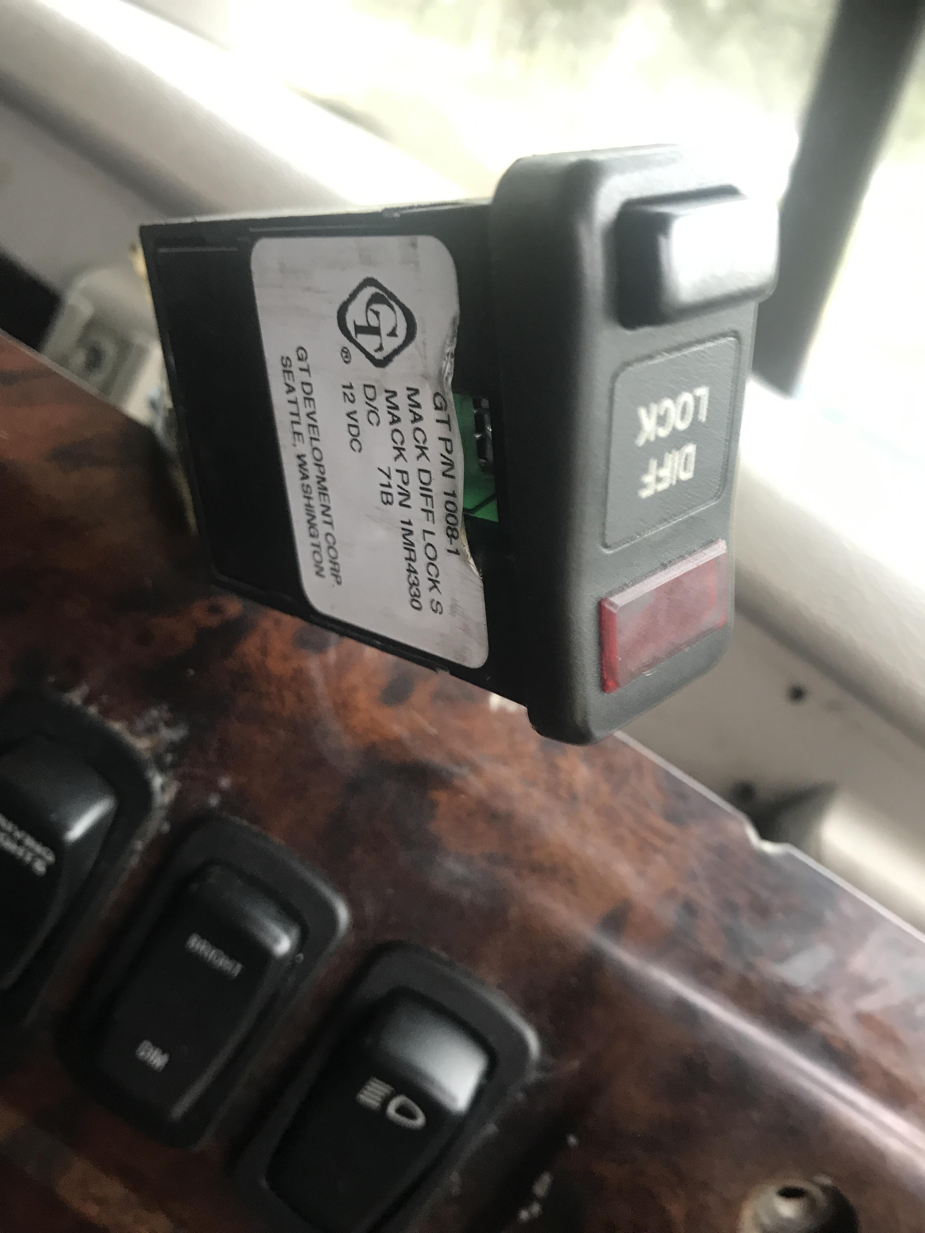

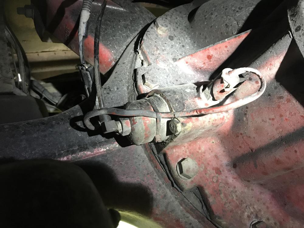

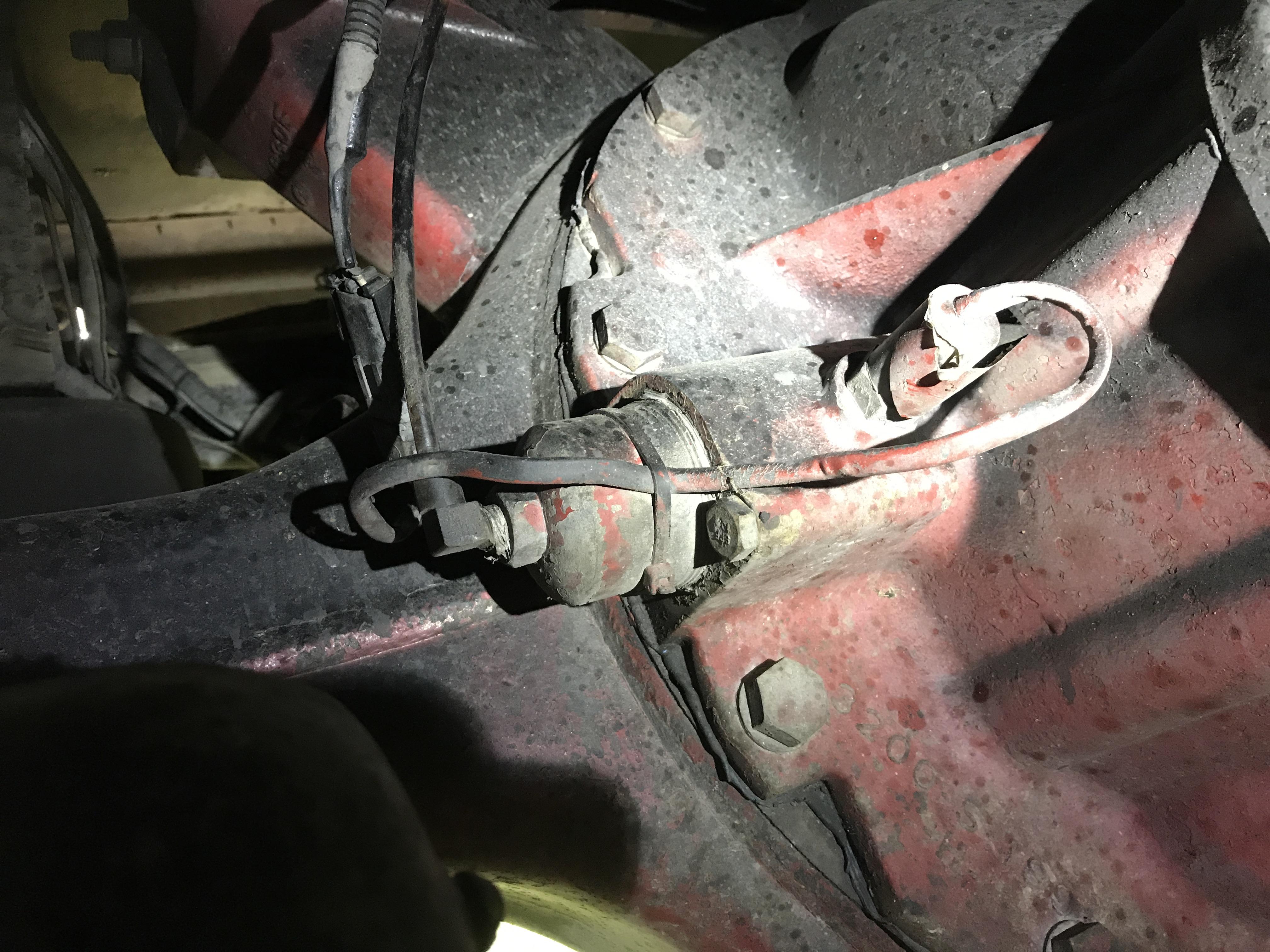

  3. I removed air line and got a pipe wrench with a bit of pipe over handle 5 ft long and undone the round screw in part which turns out is the piston barrel. Barrel was full of rust and piston was in good shape and it had a double lip type seal clipped on outer perimeter of piston. Half an hr with sandpaper in barrel and a smear of grease had the piston back in, barrel screwed back on with a bit of sealant on thread. Hooked air line back up and pressed the button in cab to test it. Couldn’t hear any air coming out breather but the red light on button didn’t come on either..... Unscrewed the diff lock sensor/ light switch from diff and looking in through hole I verified the piston is actually moving and all looked good. Done continuinity test on switch/ sensor and Its open circuit but has continuinity when pushing on the plunger so that looks ok. Ran a jumper wire across harness plug where it clips to sensor and still no dash light. Hmmmm. Traced harness along chassis and found another plug farther up. Disconnected it there and put jumper wire across pins and diff lock light in cab came on!! Found rotted internal wire on the diff lock harnes extension on not only the rear diff but also on the front diff as well. Cut the bad bit of wires out and soldered in new wires. Put it back together and Yee Haa, Both the diff lock button and the cross locks buttons working great. Reversed truck up a muddy incline to test and both buttons and diffs work as intended again. Thanks guys. she’s fixed. 😃

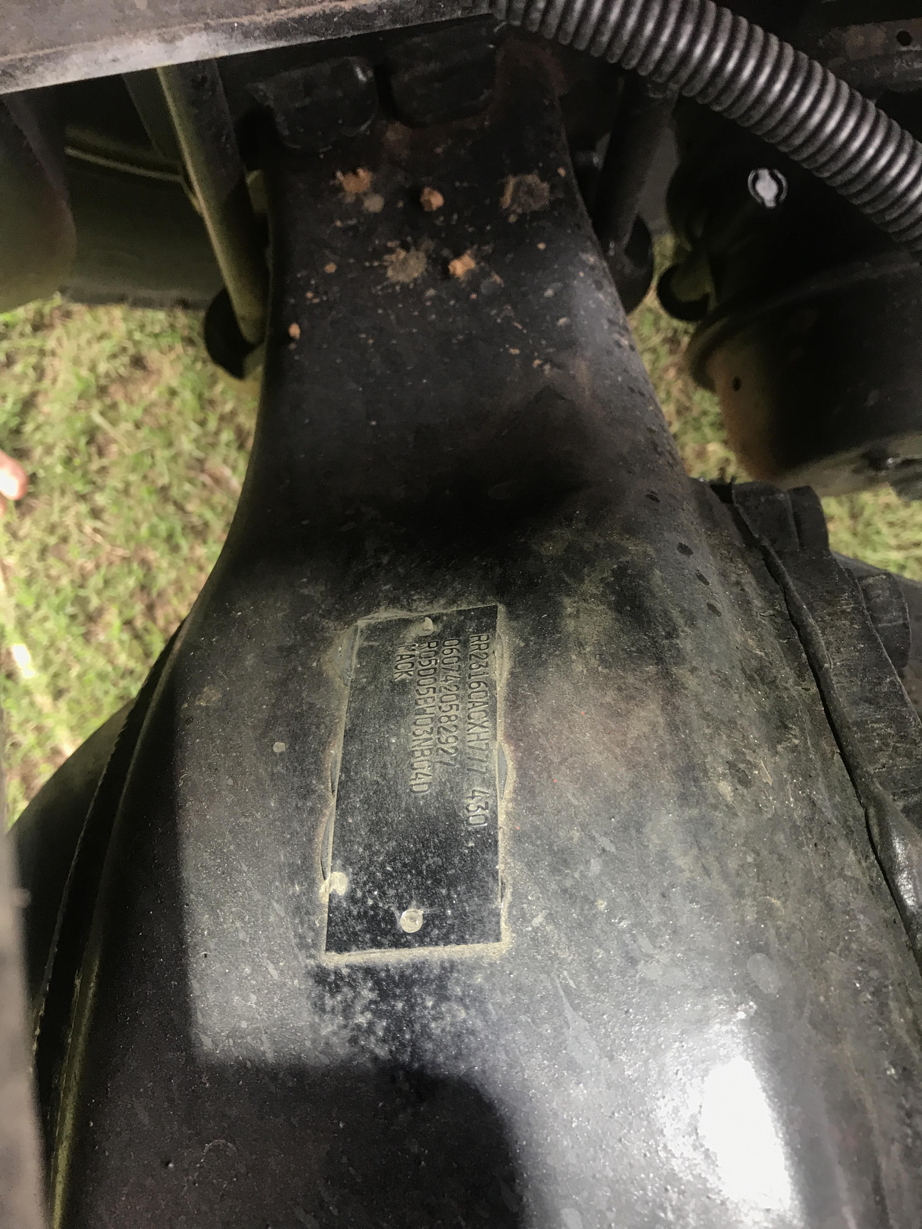

  6. If you click on the diff tag picture it might make it clearer. That file was a couple megabites.
  7. Theres 2 buttons for locking diffs. One electric which sends air to both diffs with the same looking pistons screw in thing that we can see in my pics and then theres an air type switch with hoses that only sends air to front diff
  8. The diff is a meritor RR 23 160 Australian version. thanks. I’m not sure what that bolt does. Only bought truck a few days ago and it’s my first truck so dont really know much about it
  9. Hi, I have a problem where I press the electric diff lock button on a 2004 mack vision bogie tipper and the light on switch doesnt come on and I can hear a heap of air coming out of the rear most diff breather. I’m guessing the diff lock button light is not coming on because the piston isn’t moving to press the switch in diff? the diff has a label which I will post picture of and another picture of the part I may need help removing to check it. Can someone explain what I need to do or tips to remove this contraption out of the housing please? thanks

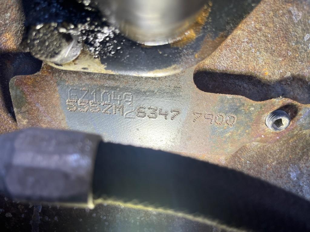

  11. Hello, I’m about to buy a used mack 2004 tipper and seller says its engine has been replaced before he bought it. I’m trying to figure out if its the 460 hp motor or if its an etech or an acet or what it is? truck is a days drive away so i cant quickly look at engine. I was sent picture of engine numbers on rh side of block below oil filler. Can someone say if this is the actual engine number or if hes looking in wrong spot? I’m in Australia heres pic. Any help appreciated please guys.
