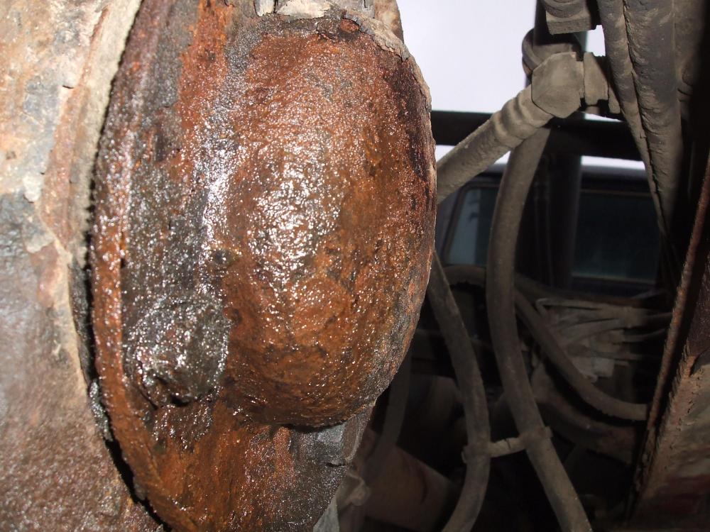

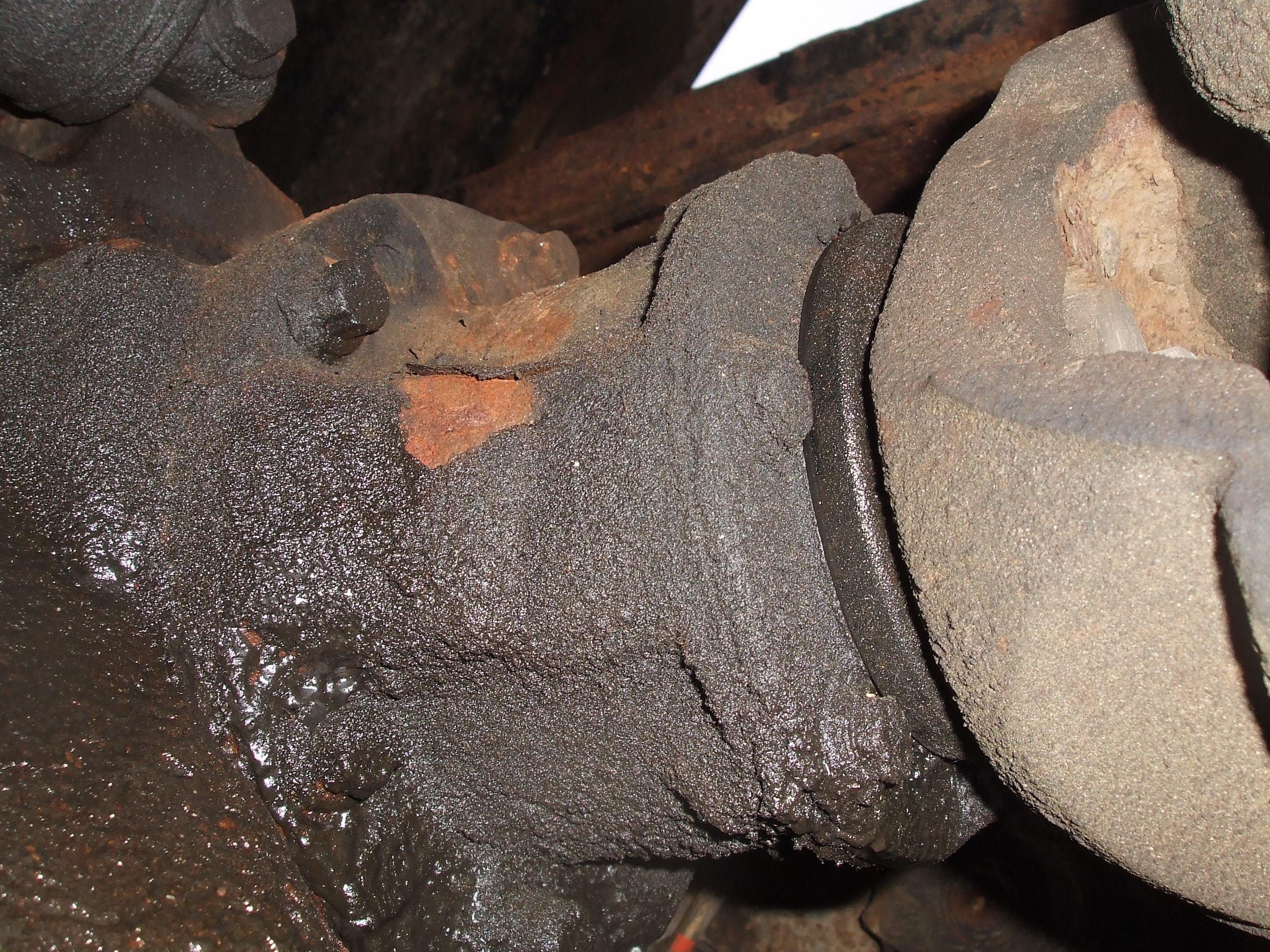

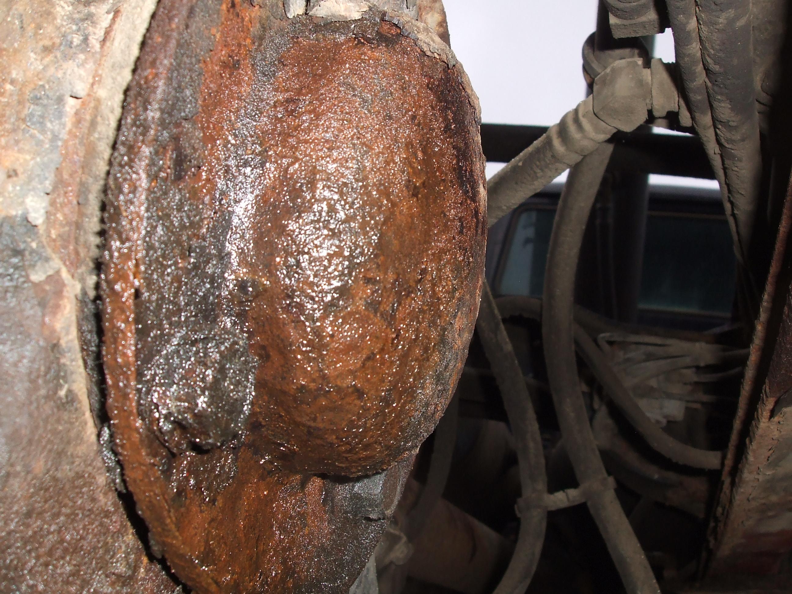

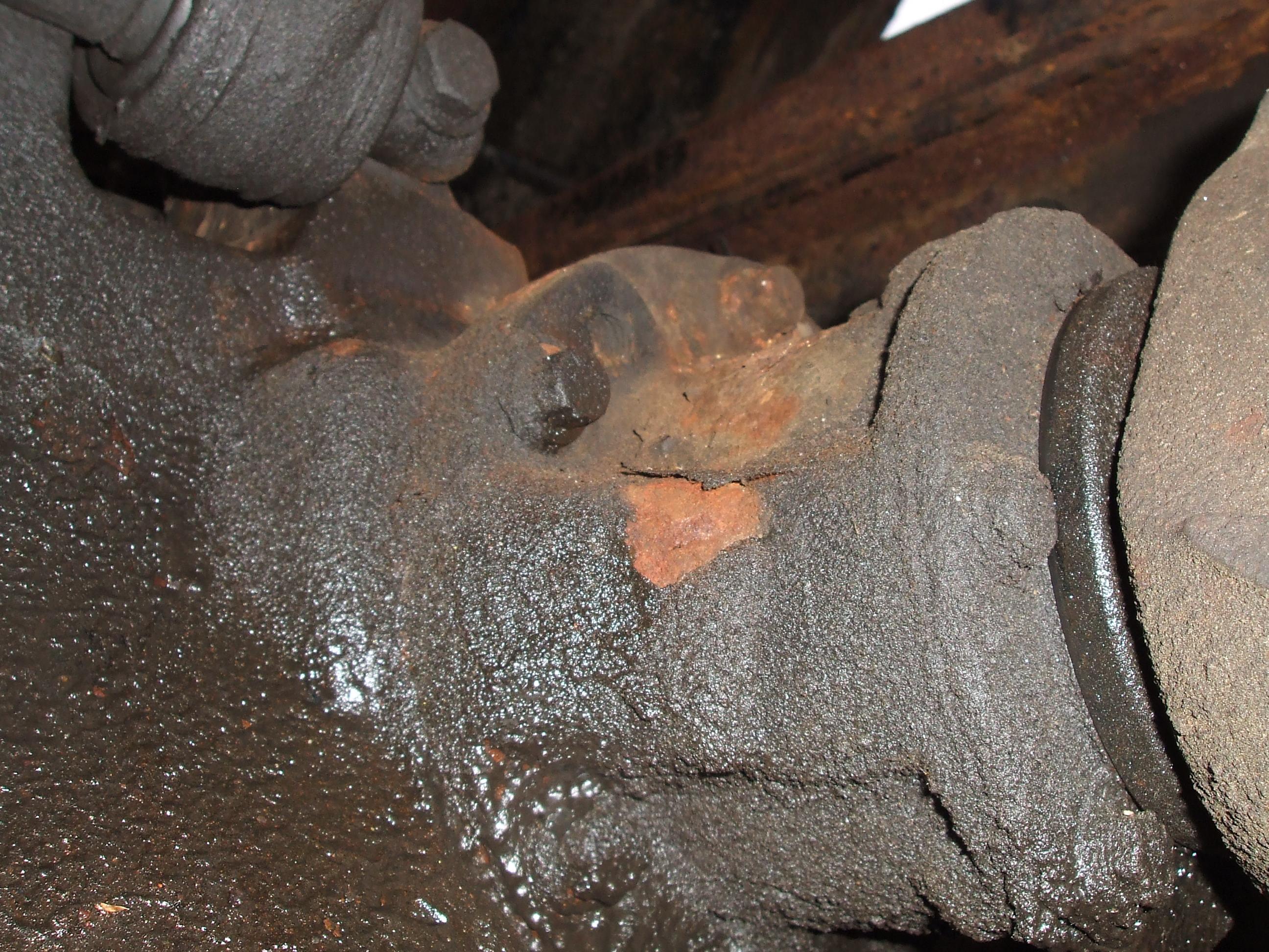

	Yes I agree it must be steam cleaned. These pics were after I drove it home from seller. About an hour and half drive. The wind must have forced the oil back making me think the leak was at the gasket not the seal.
	My first thought was the leak was at the gasket between the pinion carrier and the main housing but came to my senses and figured it had to be the seal. But again what caused the seal to fail?
	So you think its better to pull the seal only instead of unbolting the seal "retainer"?
	I got another question on this seal change. Will a lot of oil be lost?
	I am about to do the seal on my also. I have been heatin and beatin most of my life but as I get older I don't like surprises. So I got the puller. Tiger tools are the best but the most expensive. I looked for the best deal for what I do. I maintain my own stuff not a shop. so price was the factor. Found a new CAL-VAN on EBAY model 497 for $267, offered $230, came back at $250. So I took the deal. free shipping. Sure its made in China. My truck has 6 yokes, even if I only change two that aint a bad price to pay for knowing that yoke will come off. I was gonna make one but a 2" annular cutter 1-3/4" steel rod. 2" won't fit u-joint cap space, some 1/2" flat stock and a couple 3/8" drill bits, drill and tap for the threaded rod from my jaw puller adds up fast not to mention time. So anyways the rubber dam your talking about is behind that cup shaped piece behind the yoke? To cut or not cut. That will be the question. My concern is what is causing the seal to fail. Could be dirt behind that rubber which I had never heard of or loose bearing. Only 288,000 mi on 1999 RD688S triaxle dump. Time will tell. When it gets warmer cause I work outside. My advise get the puller. After I bought mine I found one the for $244. buy now. Will send picture of my leak later its on a different computer.

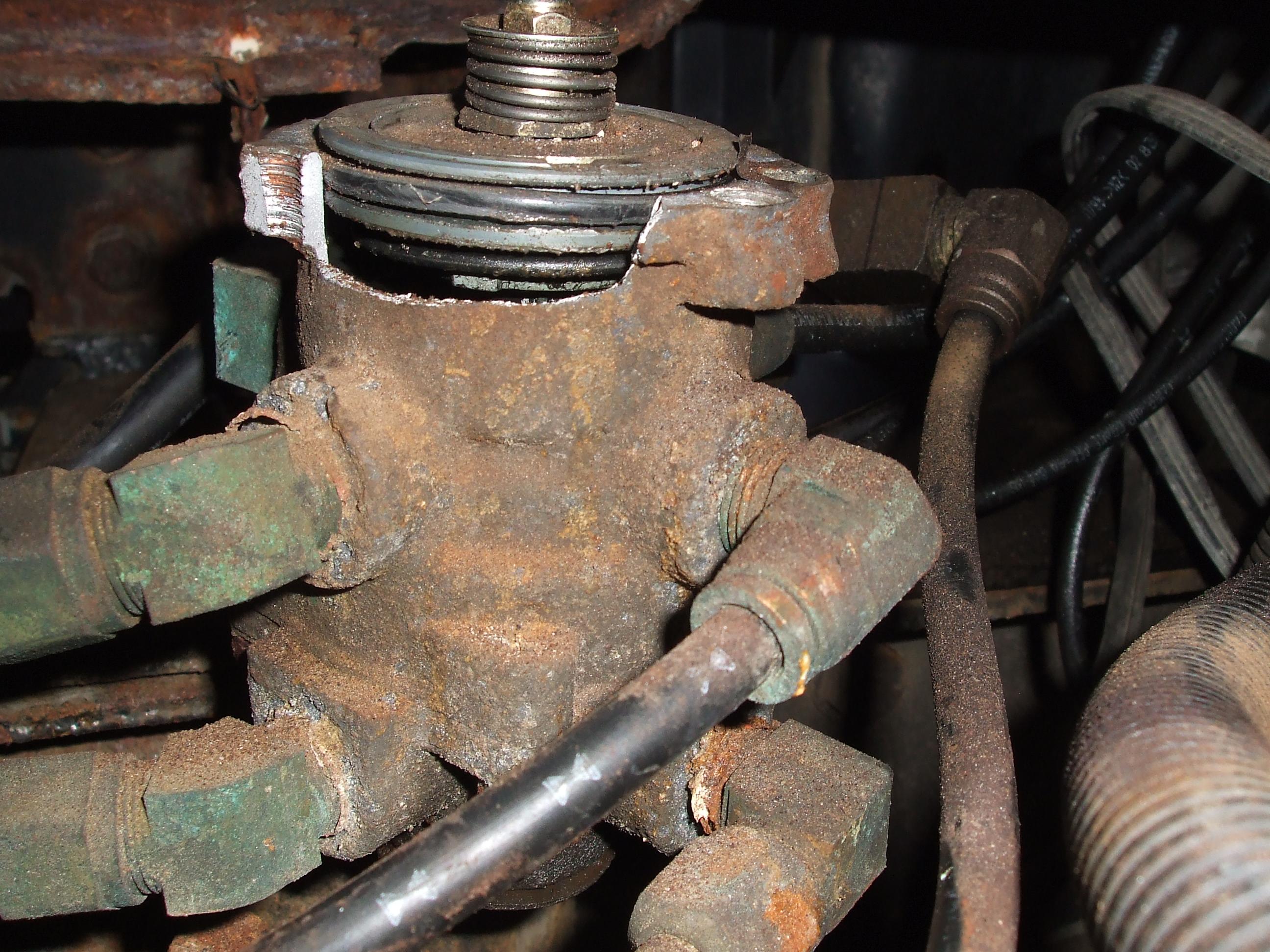

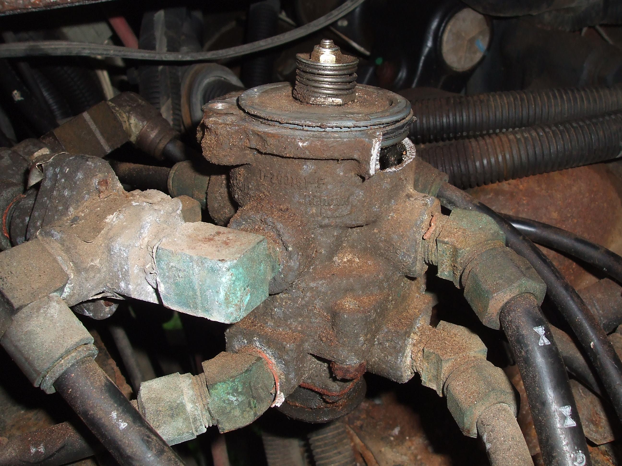

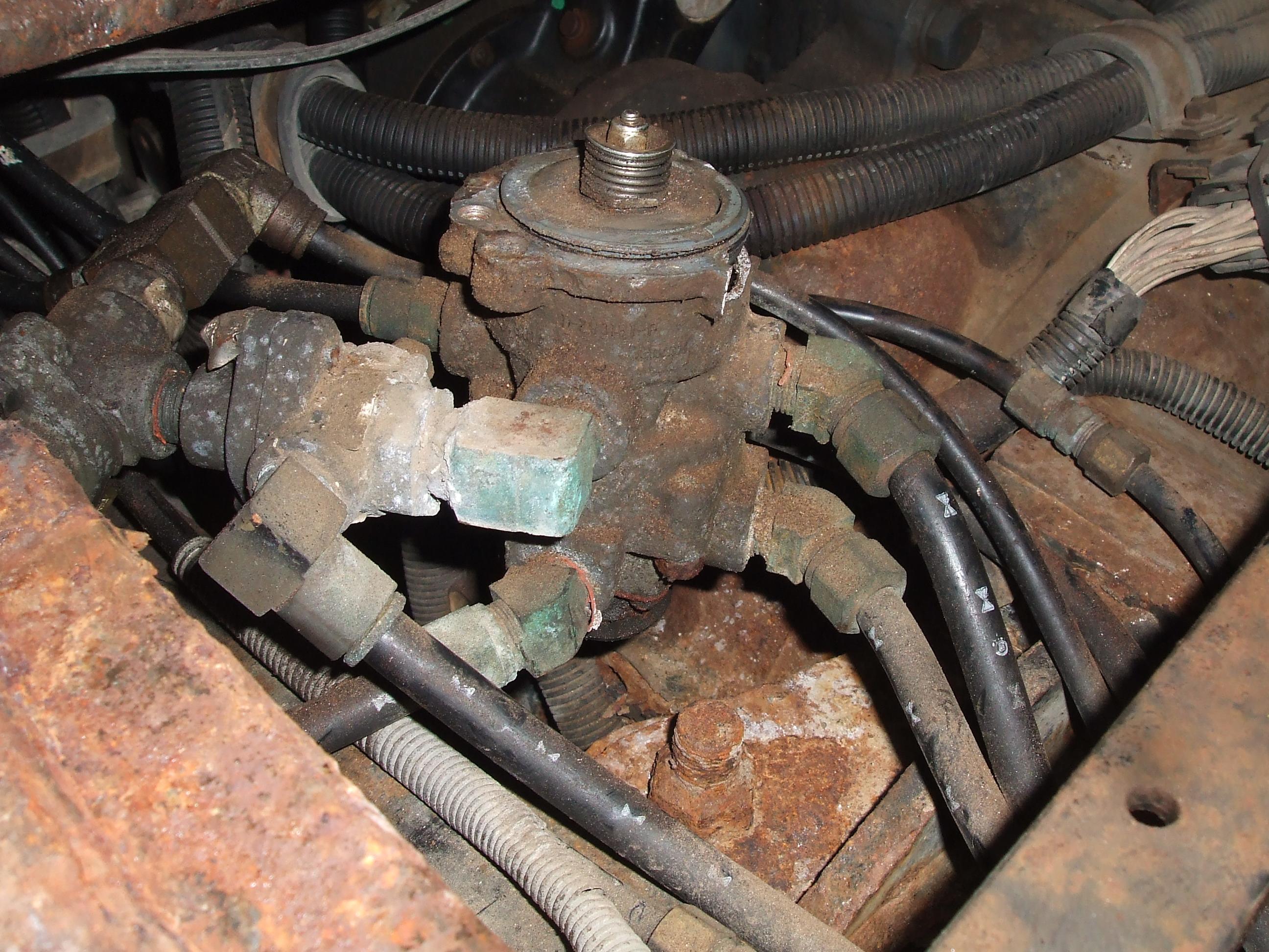

	Hello, I am replacing the treadle valve in my 1999 MACK RD688S dump truck. I believe it is original. The air line fittings are a mix of push to fit and compression. The two larger 1/2" lines are compression, the balance being five 3/8"lines, and one 1/4"line are push to fit. Can I replace the 1/2" compression with 1/2" push to fit? Or is there a reason those are compression? All piping to and from valve are plastic. I just added pictures. Can anyone tell me what the piece is to the left plumbed into the top section. I am guessing a check valve? Maybe a pressure regulator? Thanks in advance for any help.
