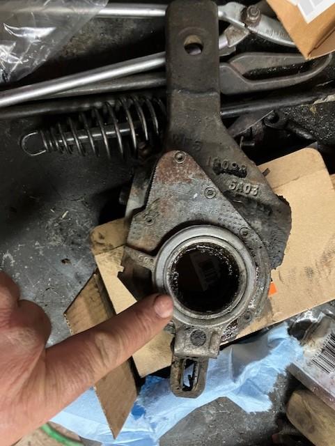

  5. All my linings and drums are good, I replaced 2 wheel seals and bearing sets over the summer and checked all bearings. I noticed some play in s cam but wanted to put it off until winter. I will be installing the 2 new slack adjusters next week. They are the standard 6" center to center 28 spline. I'm thinking that as long as I can maintain under 2" free stroke the cam play won't affect anything. Anybody that thinks you don't need to check brake adjustment daily with "automatic" slack adjusters should not have a CDL license. The manufacture state the adjusters should only be adjusted when first installed and when any brake work is done, that adjusting them any more than that actually wears them out prematurely. That does NOT mean you should not check the free play. Otherwise the only way you know adjuster has failed is when you can't stop or don't pass inspection.
  6. drums and linings are good. There is play in cam through bushing, now this has me worried. I ordered 2 new slack adjusters.
  7. no clicking
  8. the adjuster ring thingy my finger is on has tons of slop in it, so not sure just cleaning would make these work again. I will adjust so 1 1/4" travel when applied, within 2 days have 3" of travel.
  9. 7/16 to adjust. Haldex. both on drivers side drive axles, they worked fine for 2 years and then didn't. Back in fall on time when I greased lot's of water came out.
  10. 2 of my slack adjusters are backing them self off and not making clicking noise when adjusting. Should I try to take apart and clean or just order new? and are ones on ebay worth anything or stay with OEM?
