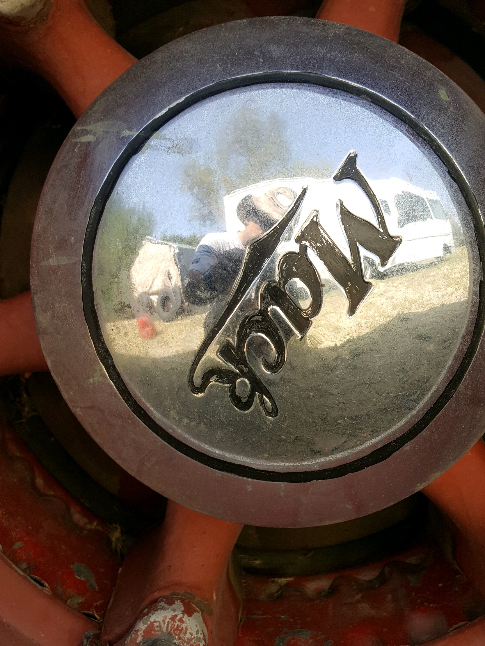

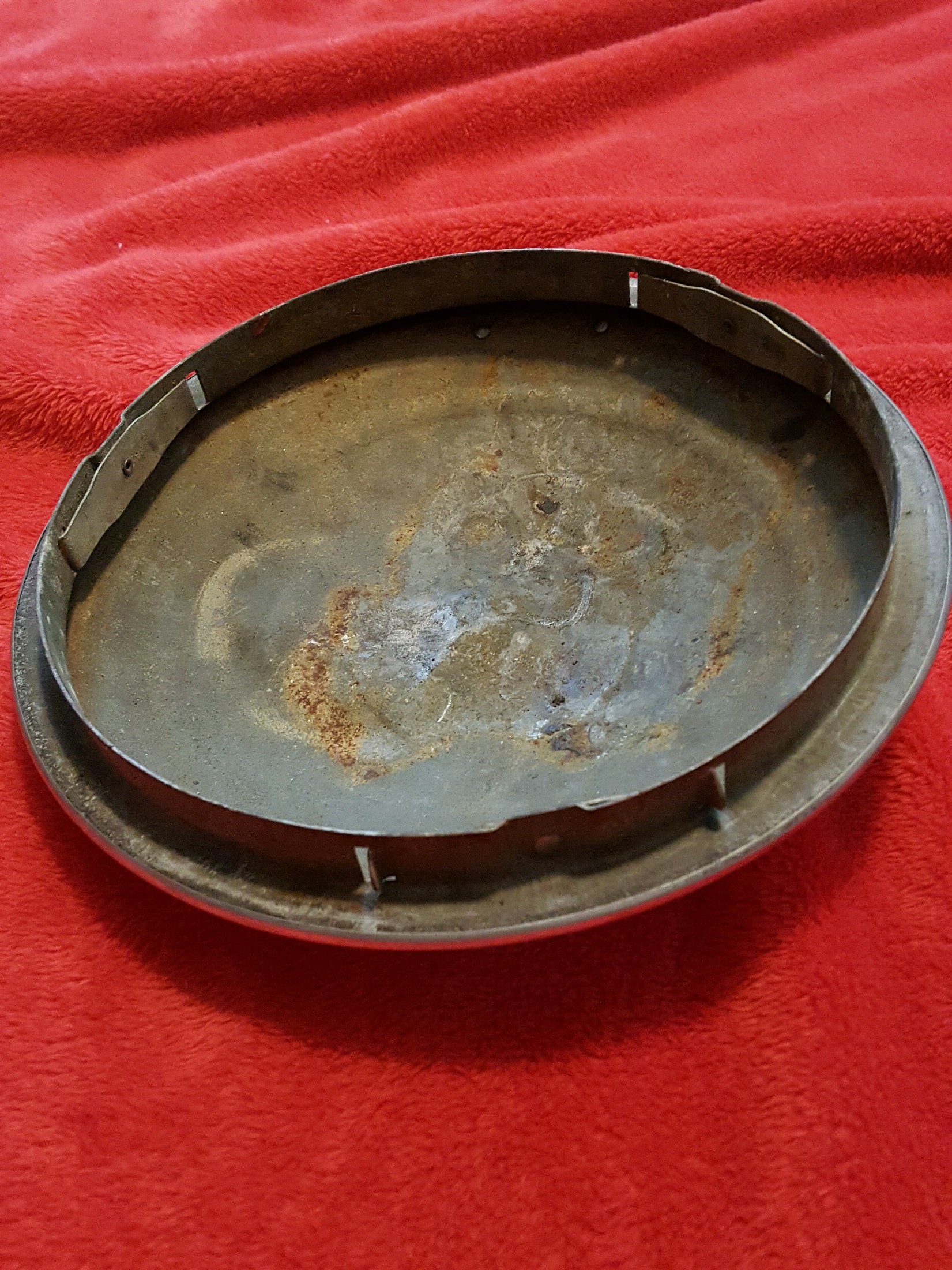

  3. Hello Good People, I need to replace one of my hubcaps on a 1948 MACK 505 hose wagon. Most of the post I found have been over 4 years old :-(. Not that I am a whizz at Blogs and or computers. Also, does anyone make hydraulic brake wheel cylinder rebuild kits for a 1948 ?? Any help will be a blessing . Many Thanks Hunior
