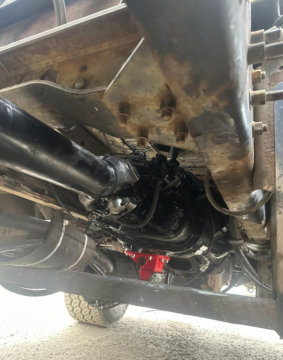

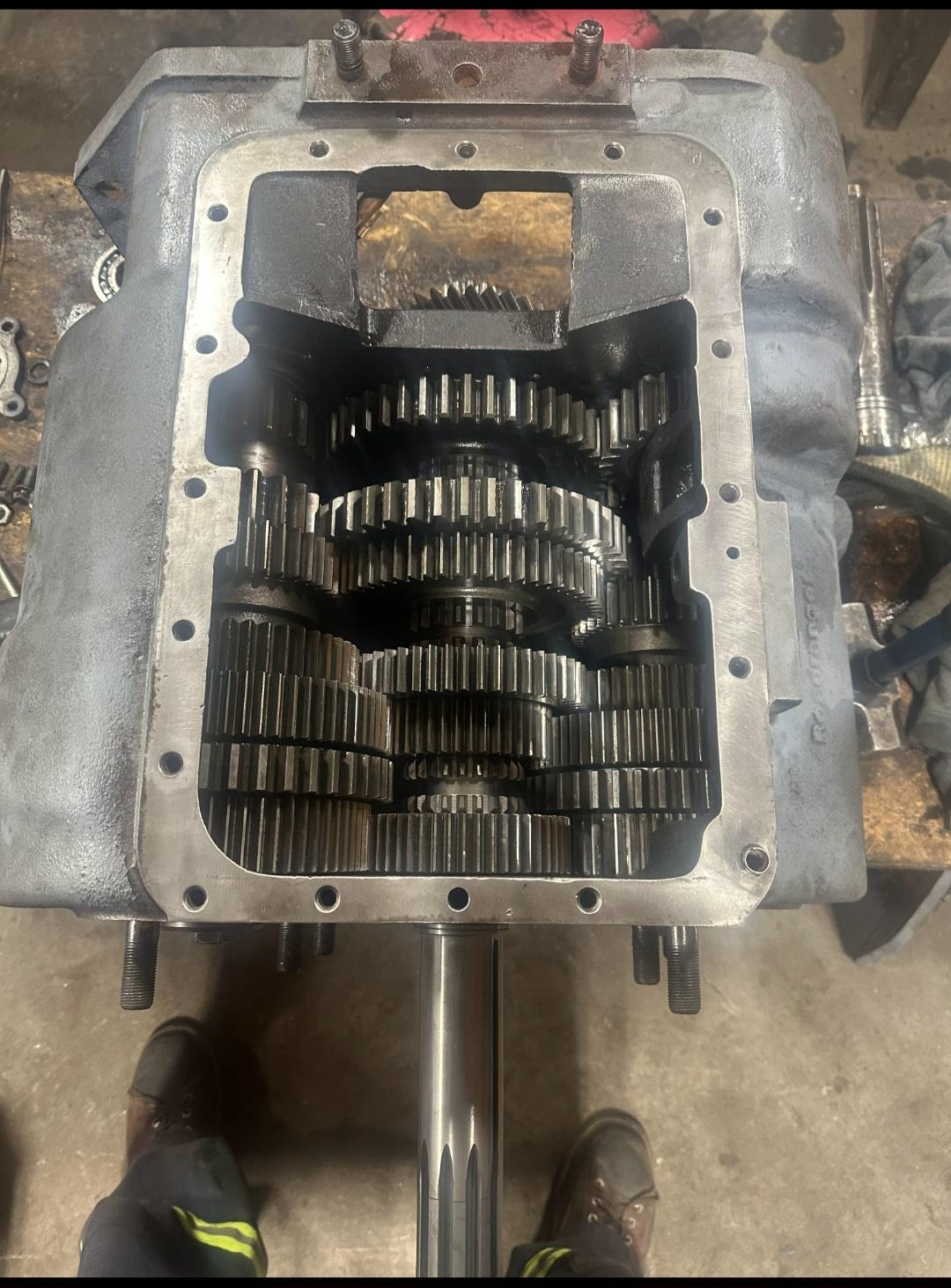

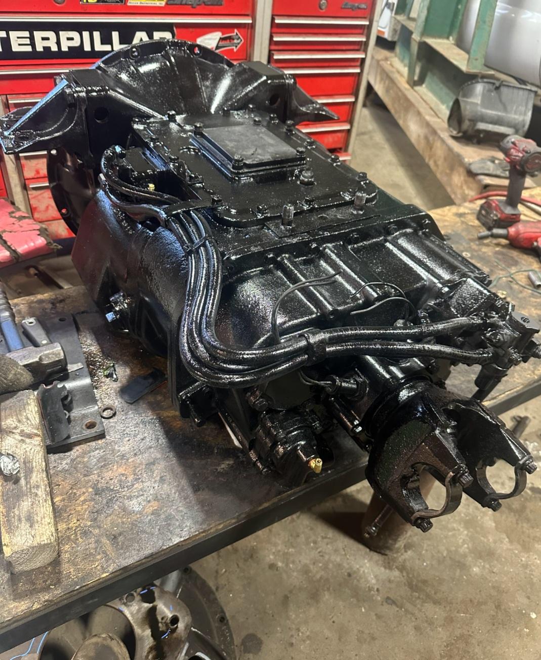

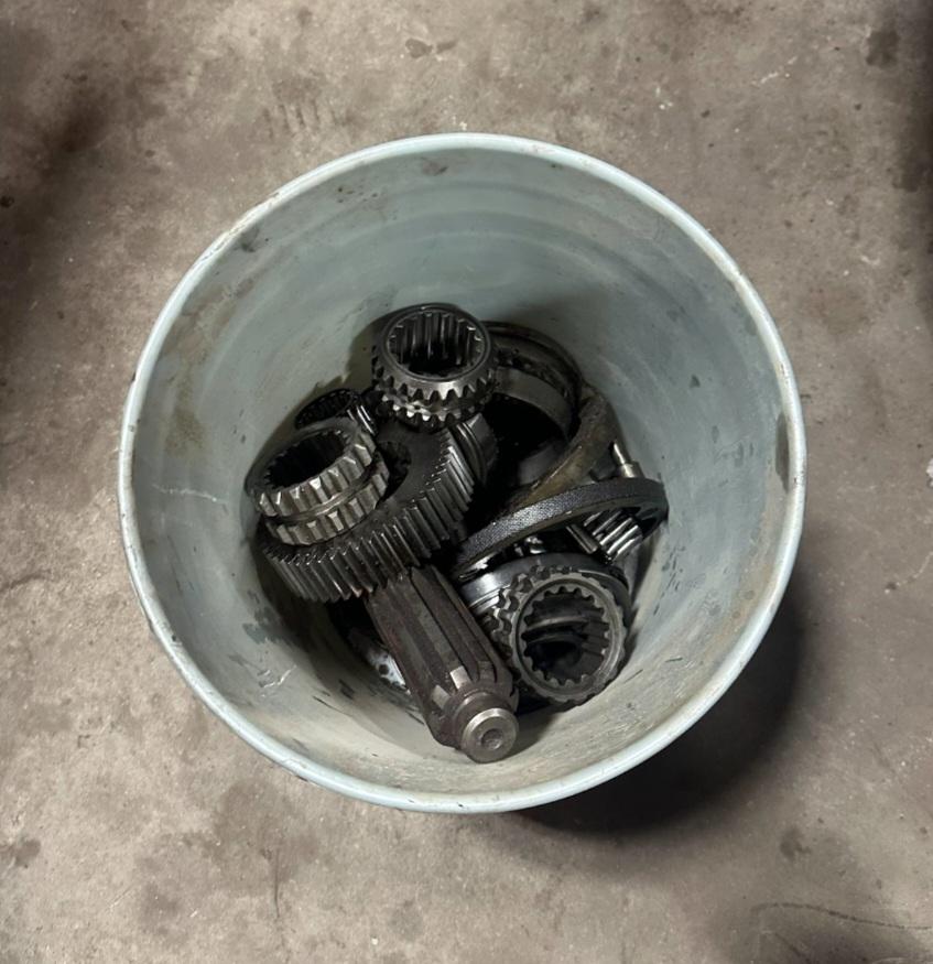

  1. Maxitorque/Eaton Fuller swap is done and i started working my truck yesterday. I'll tell you, she shifts like butter with this new transmission 🙂 final bill was $20,657.60 that includes a brand new rebuilt Eaton Fuller 18-speed transmission, brand new clutch, brand new pto, new drive shaft, and miscellaneous parts and labor. A remand Maxitorque was 20k plus shipping and tax from the USA to Canada, the clutch would have been extra, and new pto would have bin 6k for my setup. I would not been able to use my existing pto because when the tranny started, failing, parts fell to the bottom and broke the gears to the pto. Today will be my first full day working my truck. I have put on approximately 150miles and everything was working great so far 😀
  2. Actually 30,000 hours 🤣 lol gutless but runs good, if the motor blows up next week, I will do another swap 😎

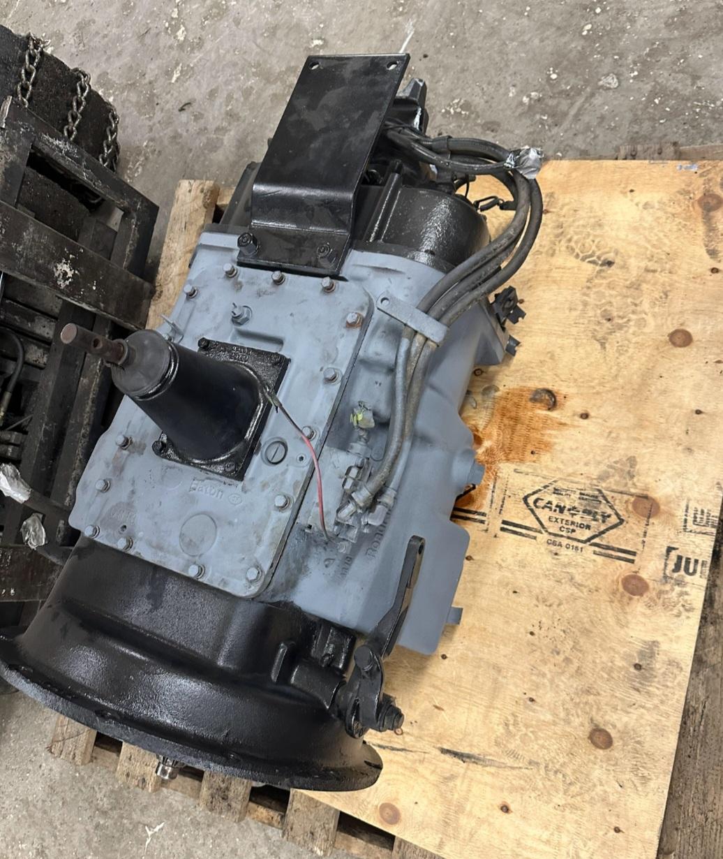

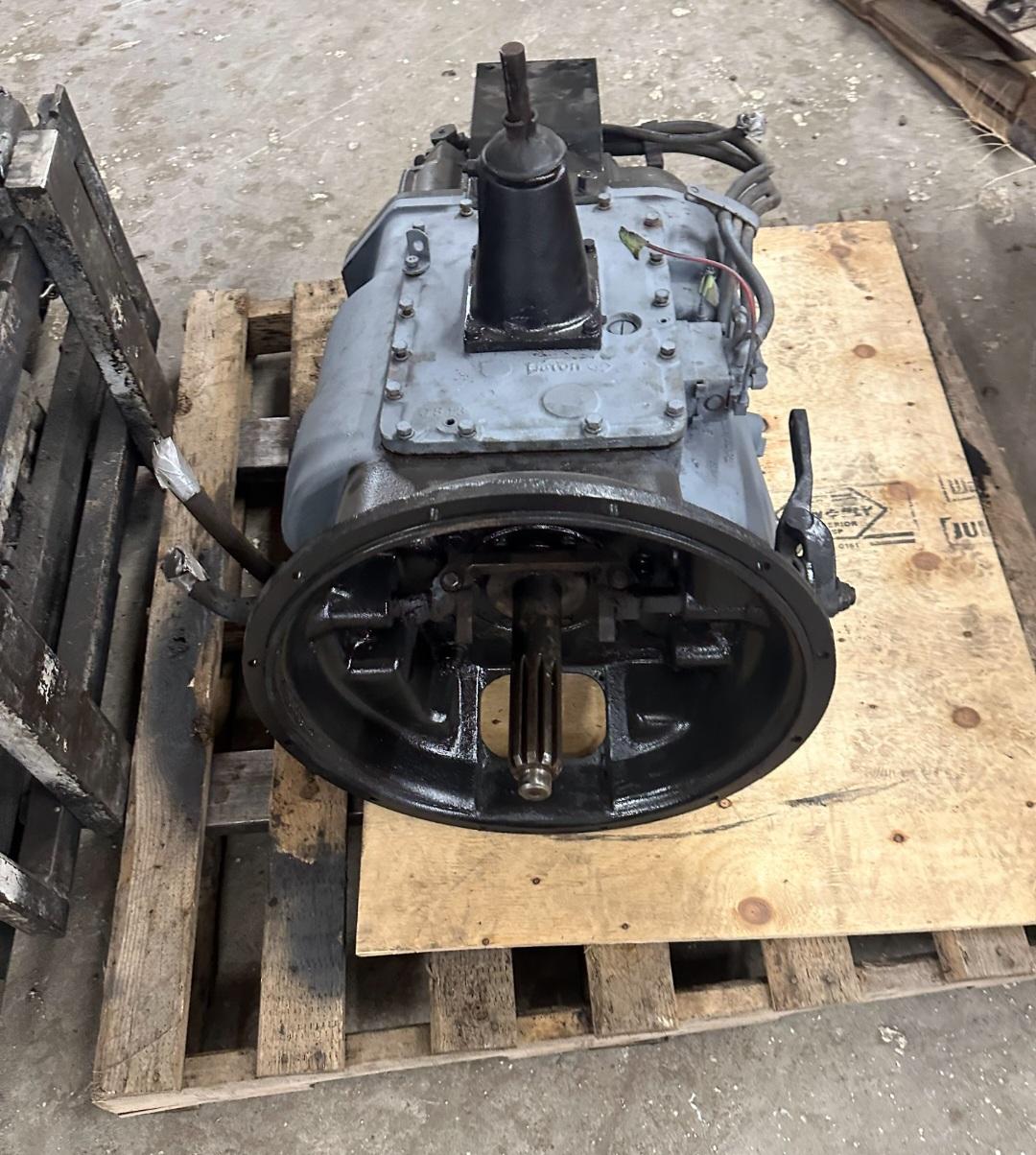

  3. Swap is going great. Bought an Eaton Fuller 18918b for 2k. Proper bellhousing for 1k. My transmission guy put new internals in, so she's pretty much new. Transmission is ready to go back in my truck. I have the PTO sorted out. All I had to do was call westech, the company who it took my truck when it was brand new and built the vacuum system. I gave him my vin# he sent me original pictures of the build. Told me everything i could possibly know about my truck. There were two choices for the PTO, It was pretty awesome 🙂 PTO is not cheep! $4700 😳 i will have all the numbers $$ once the truck is completely done. Looks like it's gonna be about half of what it would have cost going with a Maxitorque 🥳 i asked him what happens next month when my motor blows up? He said we'll do another swab not a problem 😁

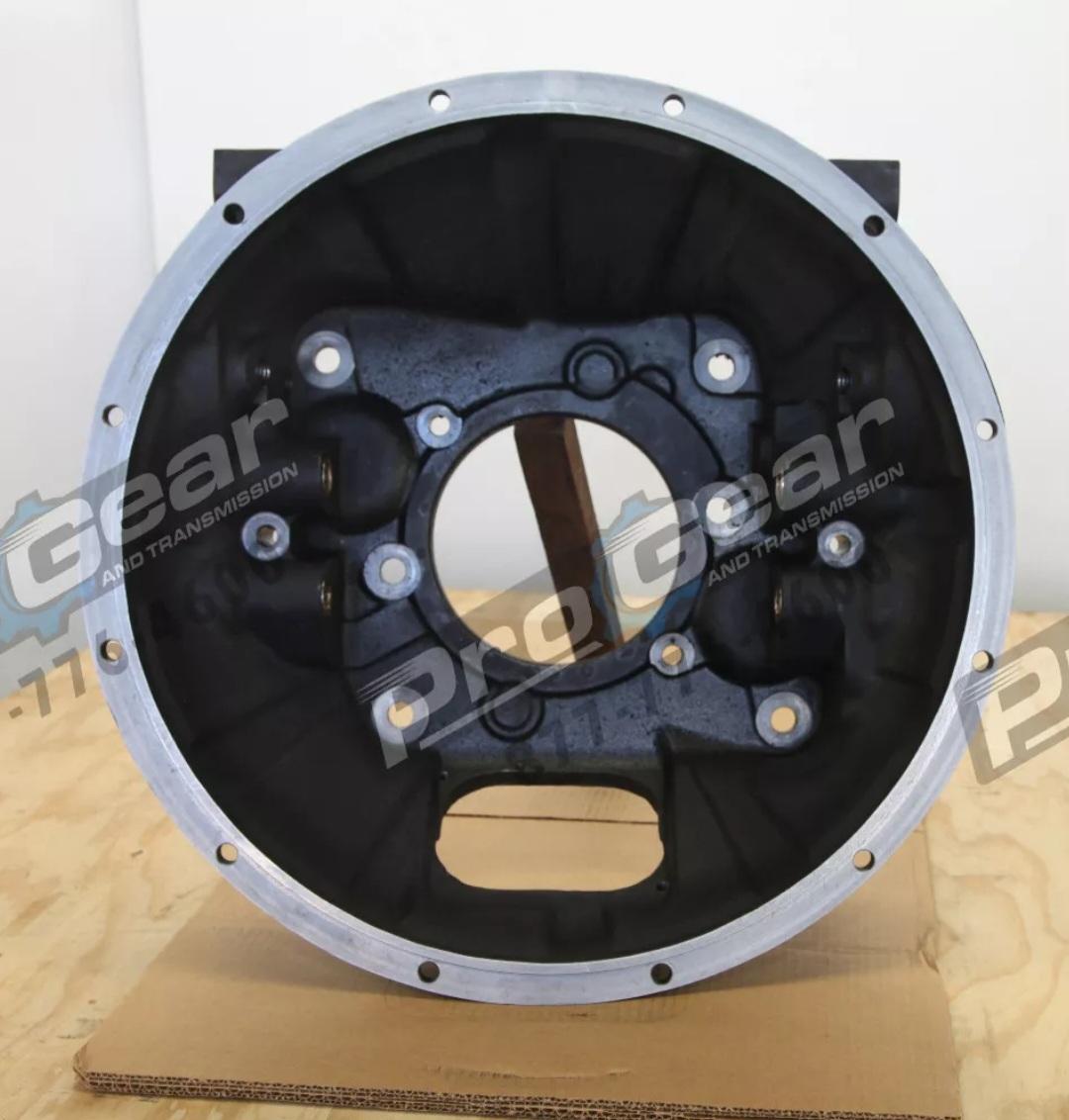

  5. A remand is 17k plus core of 5k plus shipping and tax of %14 here in Canada, shipped from the USA. New is 25k-30k plus shipping and tax. I already started my swap 🙂 Ended getting an almost new Eaton Fuller for 2k cash, no core. You could order my truck new in 2007 with Maxitorque or Eaton. I found a brand new Eaton to Mack Bell Housing for 800$ cash. Now I only need to sort out my pto and drive shaft. I'm working with a shop who do these swaps quite often. It's really a no brainer. I will keep everybody updated. Merry christmas! Iwill keep everybody updated 🙂

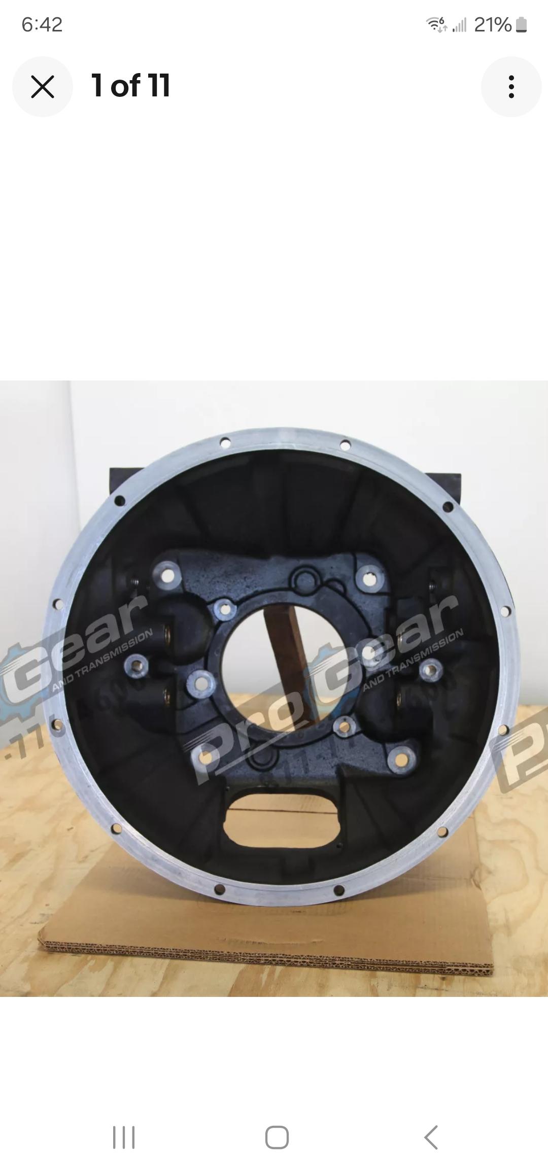

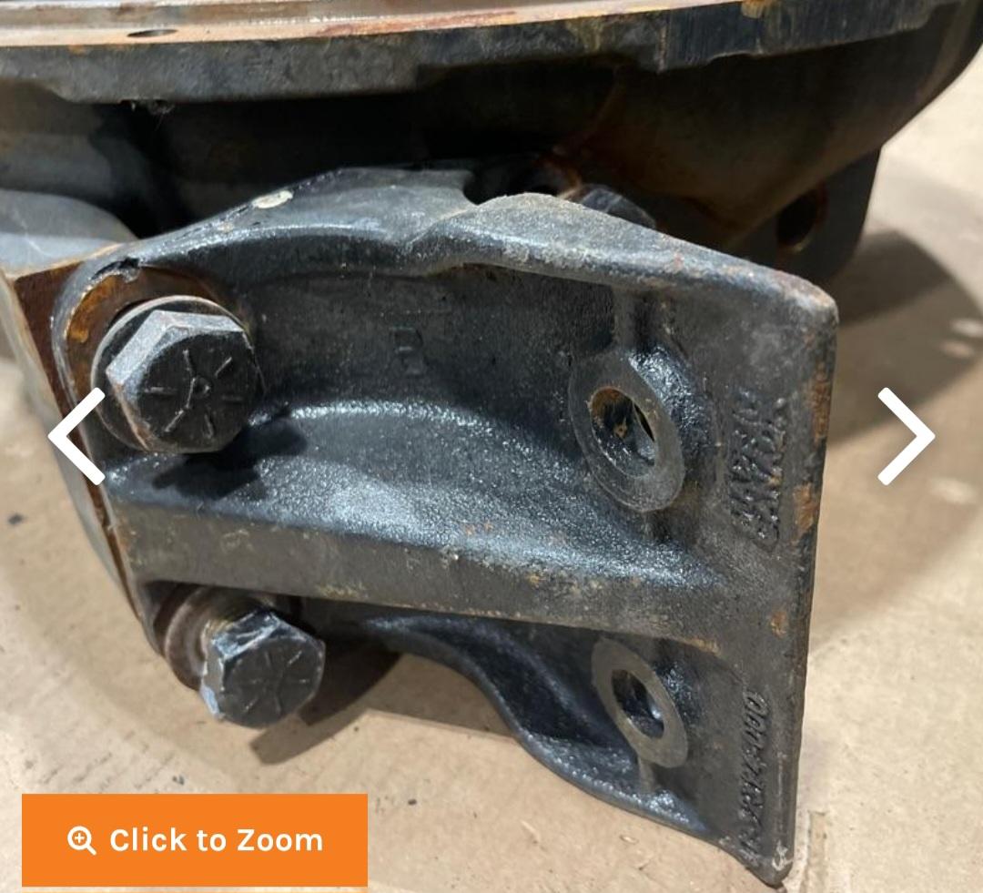

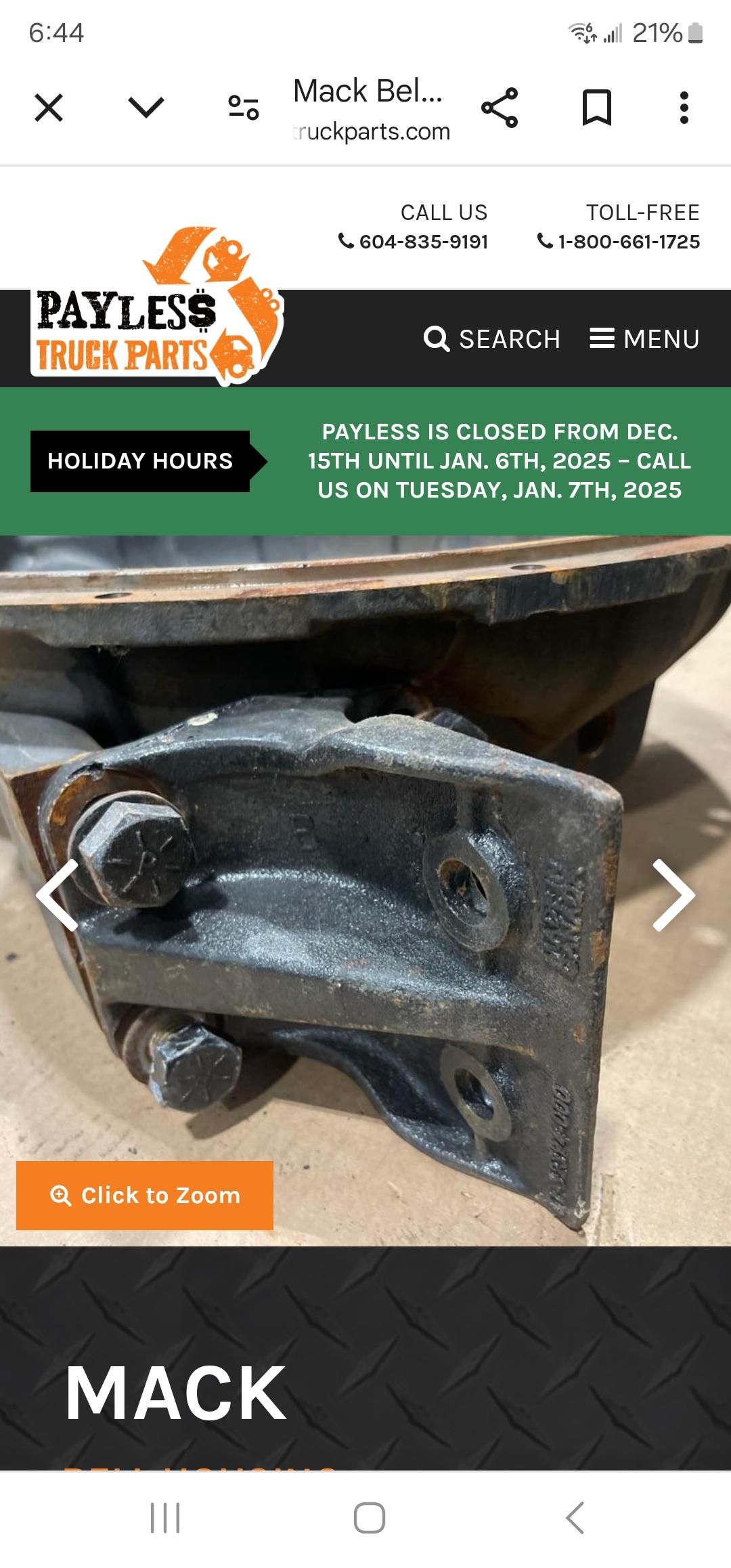

  11. A few days ago I posted, "I needed help figuring out if I could do this swap". I've done a lot of research and luckily enough. My truck came with either a maxitorque or an Eaton Fuller. I have a 2007 Mack Granite CV713 AI-460. There's actually a shop quite close to me who specializes in this swap. 25k canadian plus shipping and tax for new Maxitorque 18 Not including clutch or install. I bought an almost brand new Eaton Fuller 18 for 2k no core charge. $800 for new bell housing, Mack to Eaton Fuller 🙂 now I need a new longer driveshaft and it looks like my pto will bolt right up, i'm sure there'll be a few other gremlins to work out 🙂 i will keep everybody up-to-date on the swap. As i'm sure there's lots of people out there want to do this! IMG_20241223_183825.heic IMG_20241223_183829.heic
  12. Started the swap. It's actually quite common I found out, in my city. Found the proper bellhousing, Mack motor to Eaton Fuller. Went and bought the 18 speed Eaton today. My PTO should bolt right up. i will have to get a different drive shaft. And a few other little things 🙂 i'm lucky because my truck came with either a maxitorque or an Eaton 🤔 the price on a new maxi torque for me is 25k Vanadian. Ordered out of the USA, then I would have to pay shipping and taxes, plus clutch plus install lol no thank you! I can purchase a brand new Eaton Fuller off the shelf in my city, where I live forIMG_20241223_183829.heicIMG_20241223_183825.heic 7k. It is a no brainer 🤯
