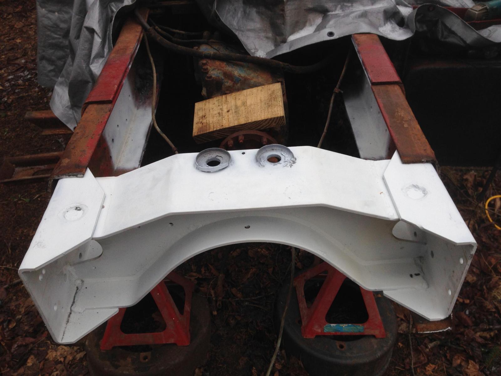

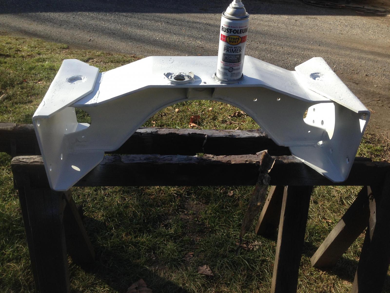

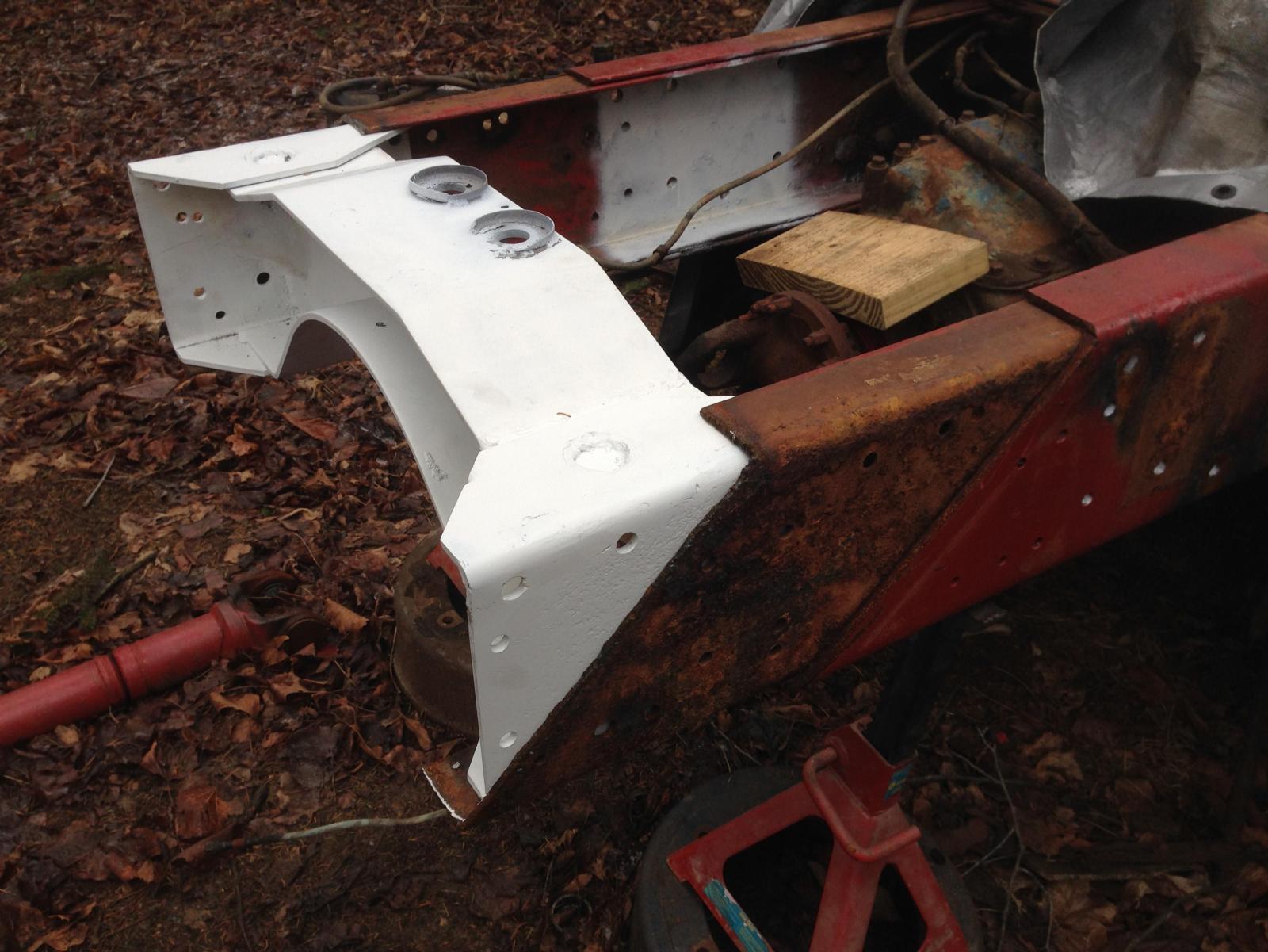

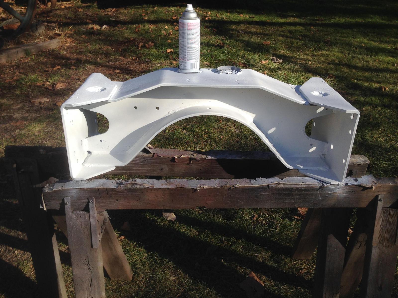

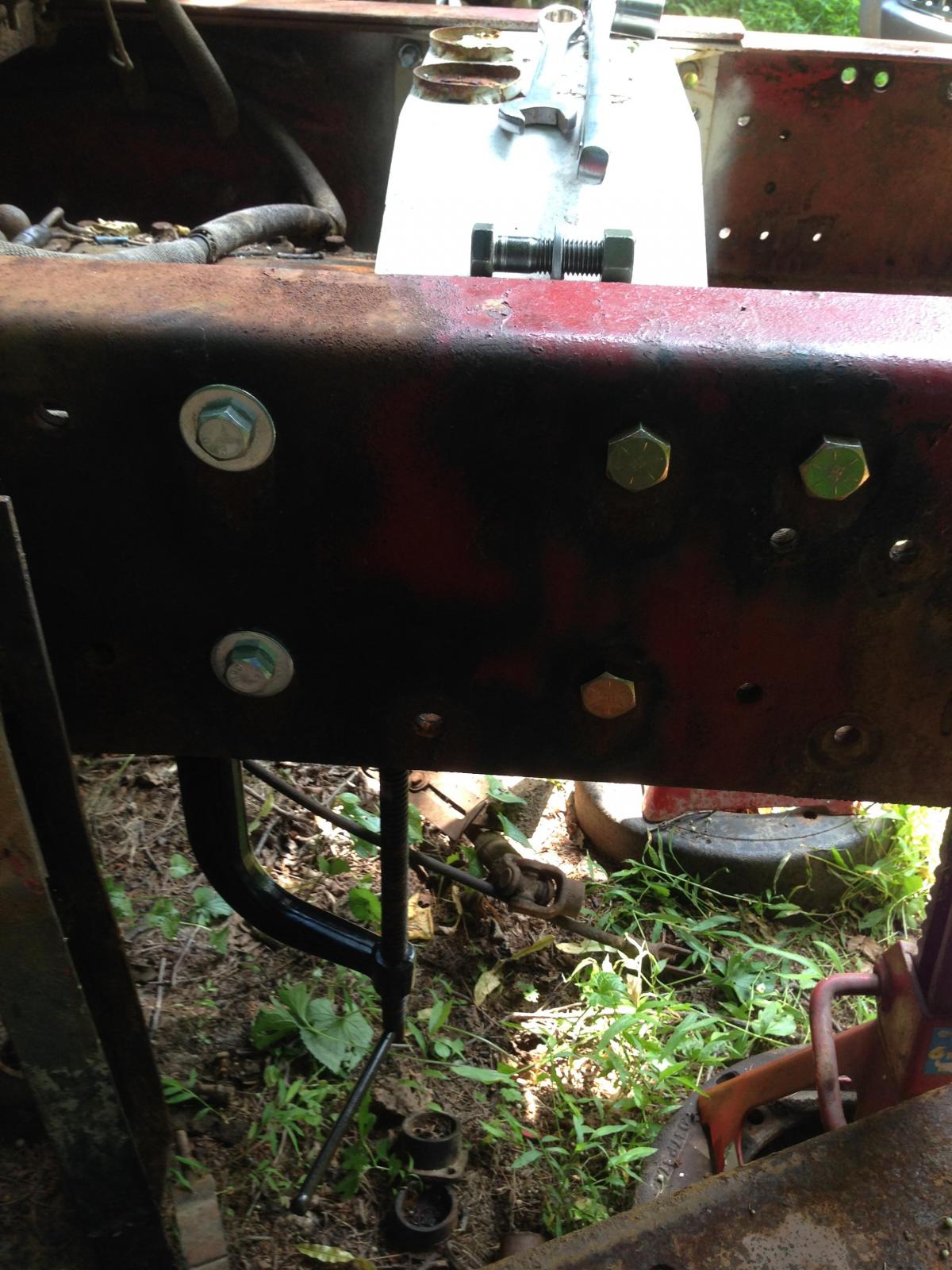

  4. Cross member cleaned up. Also installed tonight. Will get pics of that tomorrow.

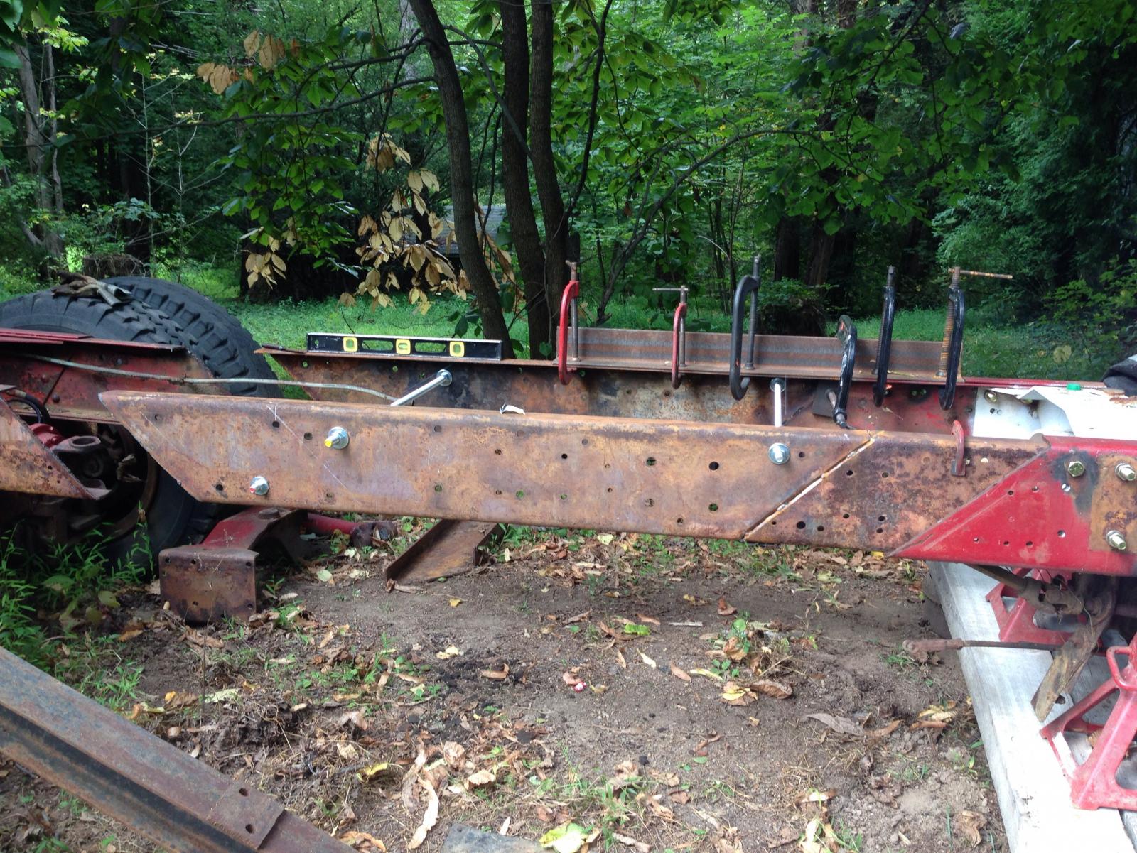

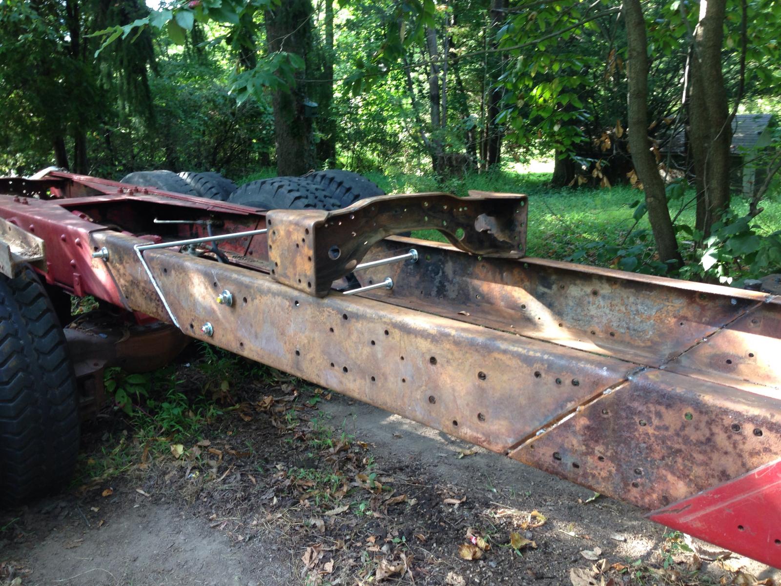

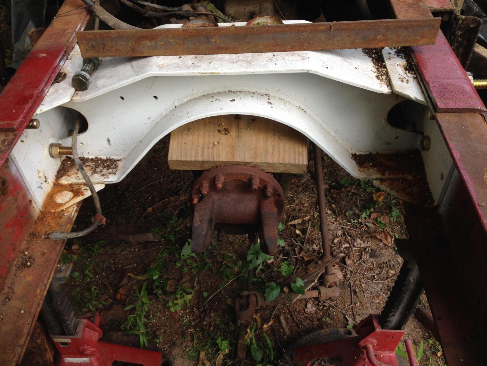

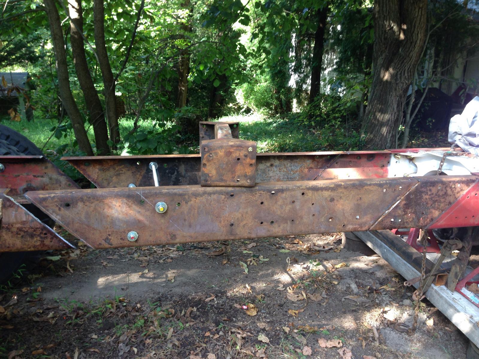

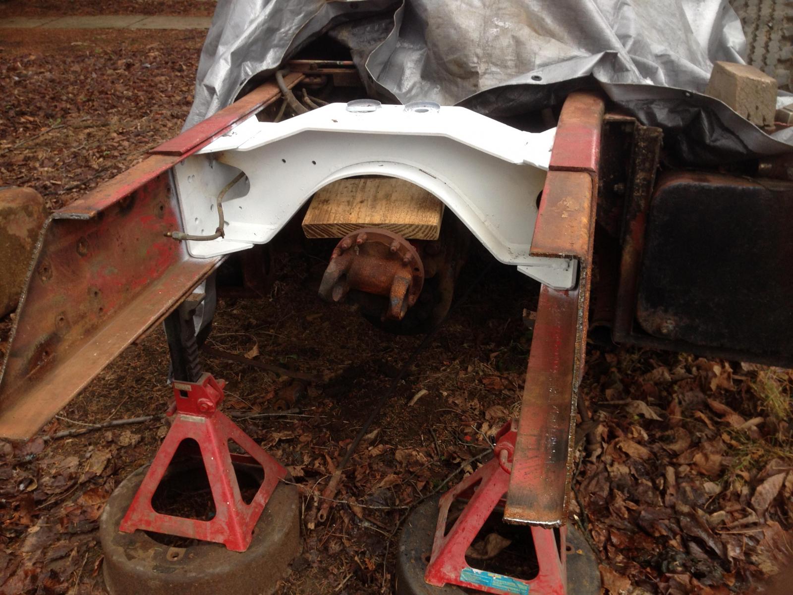

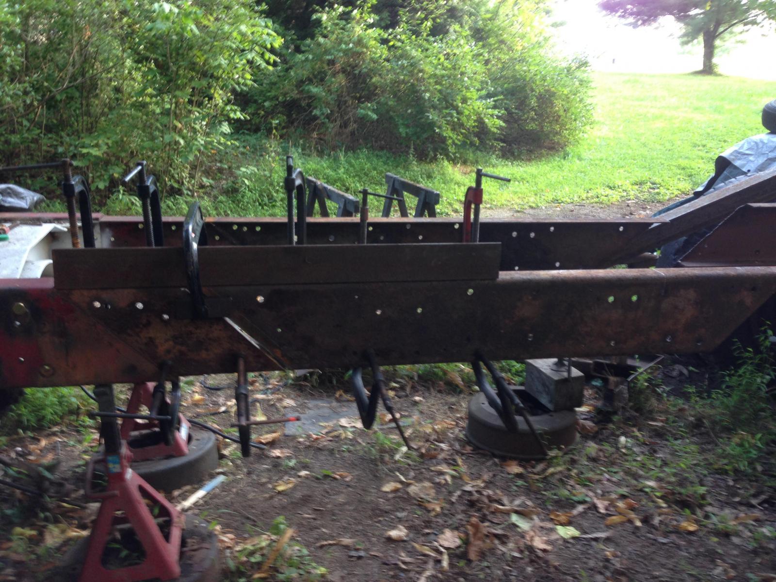

  5. Plan to... After about 6hrs of tweeting yanking cutting welds apart and rewelding the rails are pretty dang straight. Will post pics tomorrow. -->Also decided to add a cross member. So another delay but I as well as my dad think 6-7ft between members was a bit to much. (Thanks for the idea dad.) lol not sure how I'd get half this stuff back together and running with out him... :-)
  6. Getting closer to getting all the pieces put back together!!!

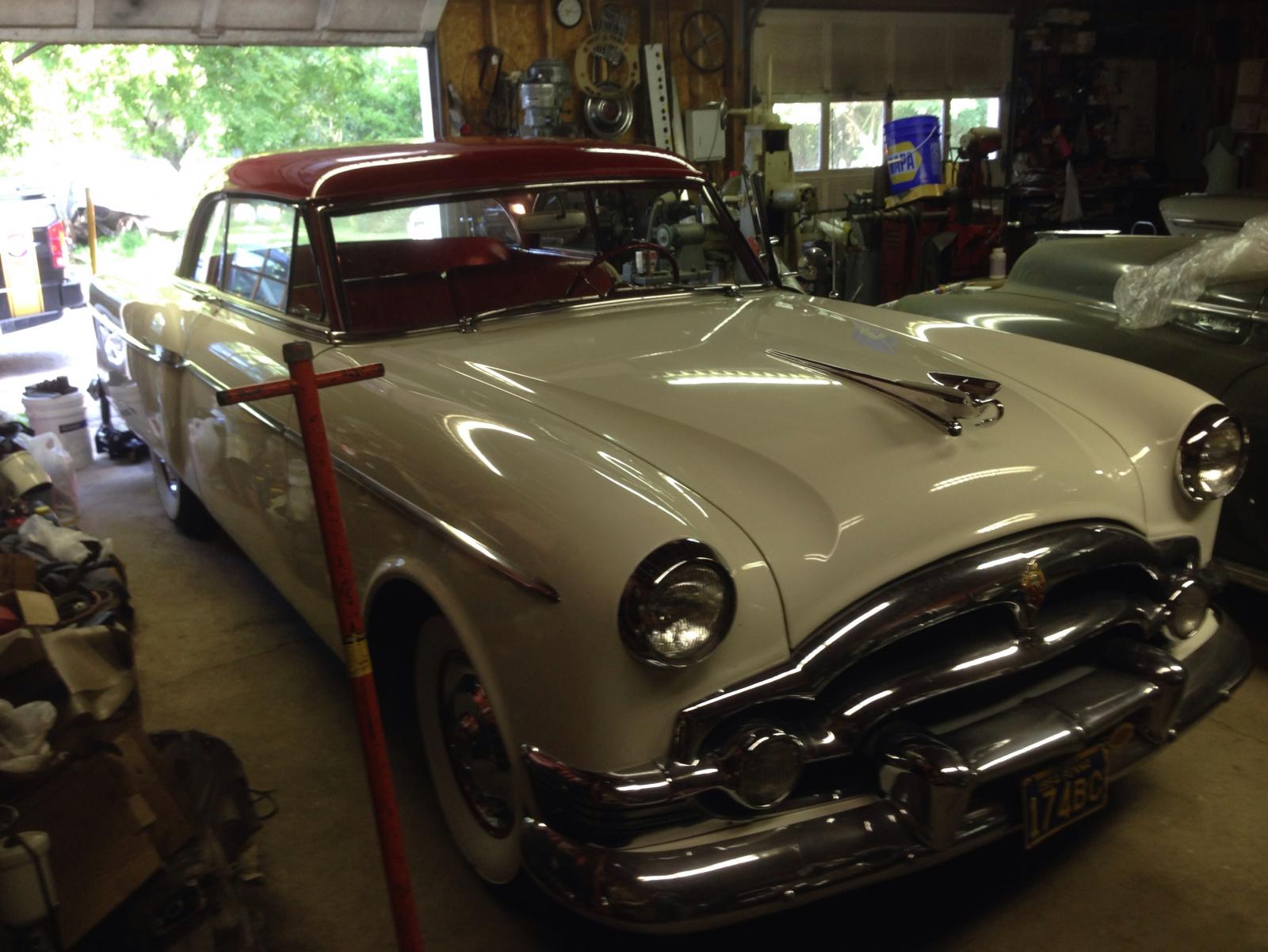

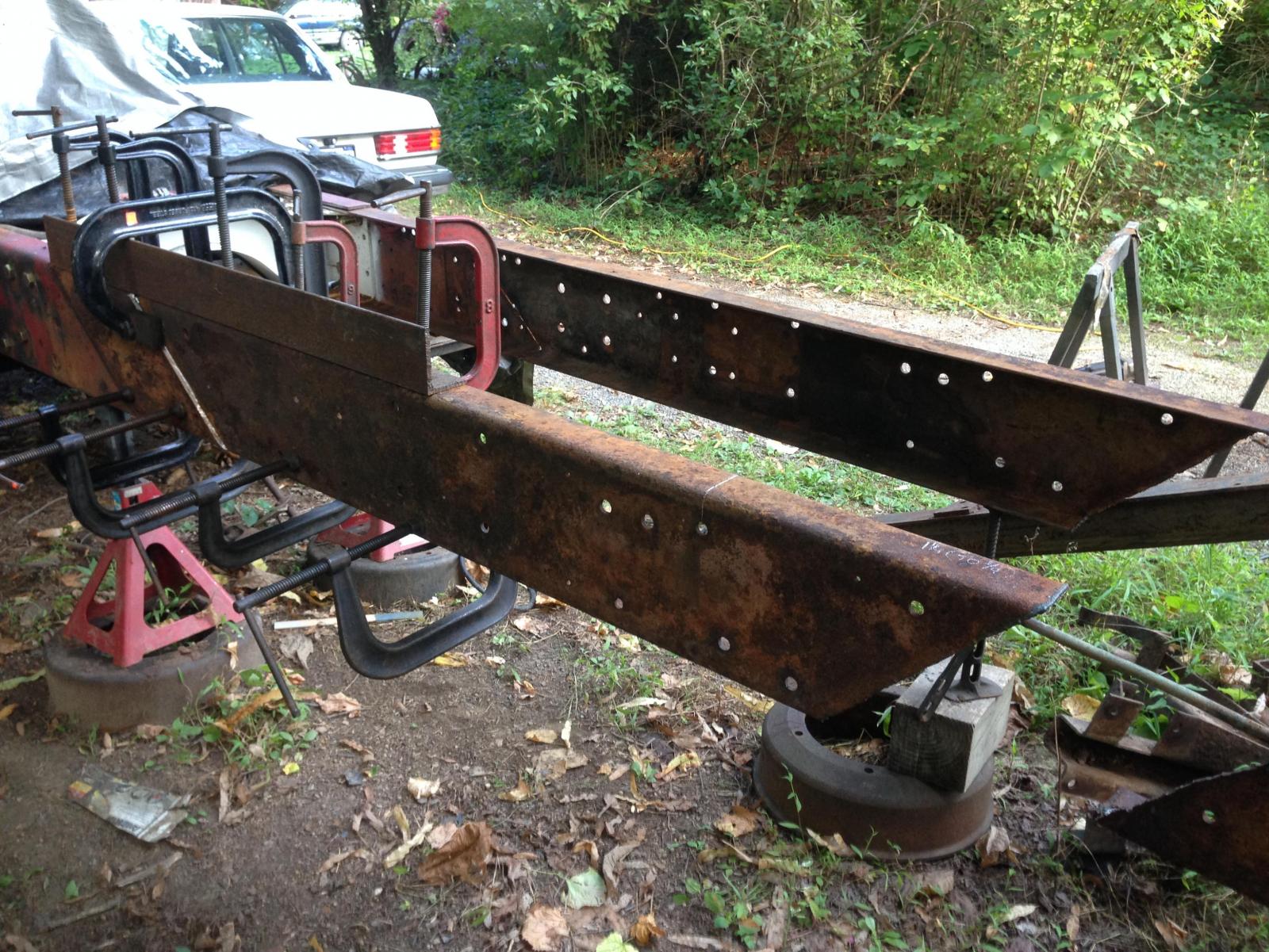

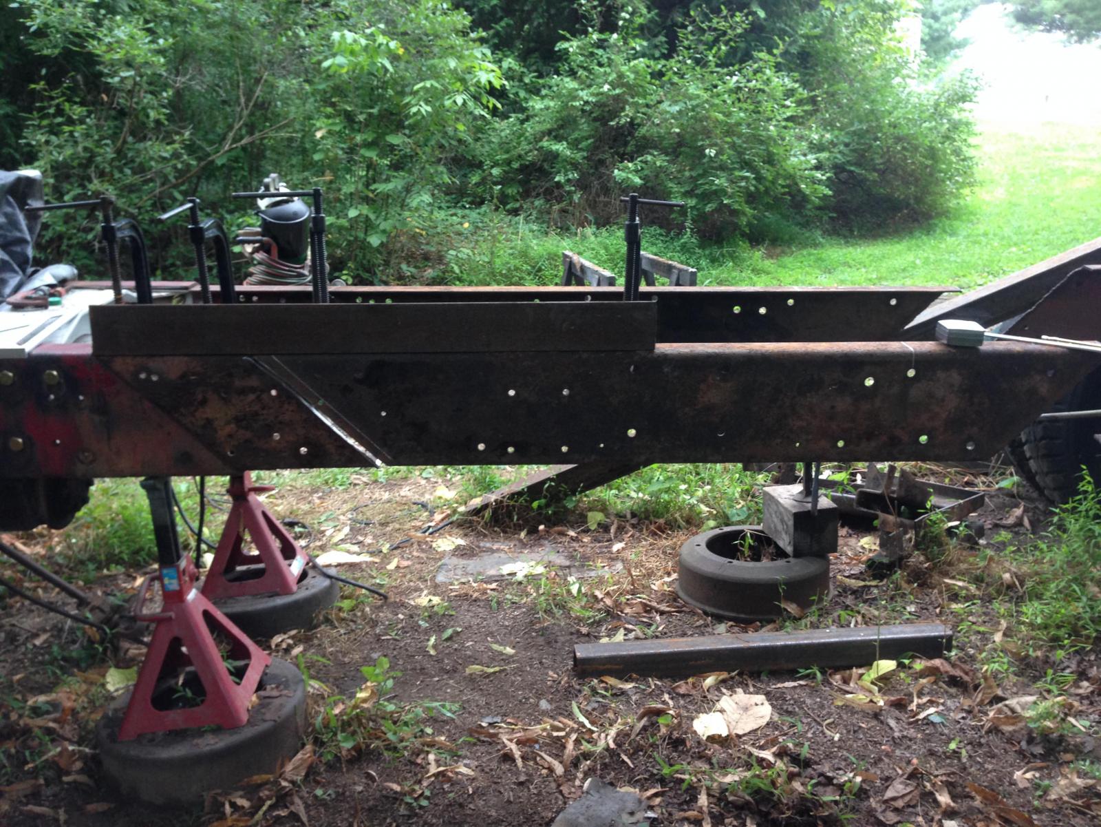

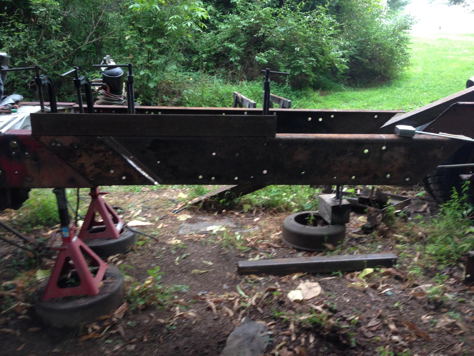

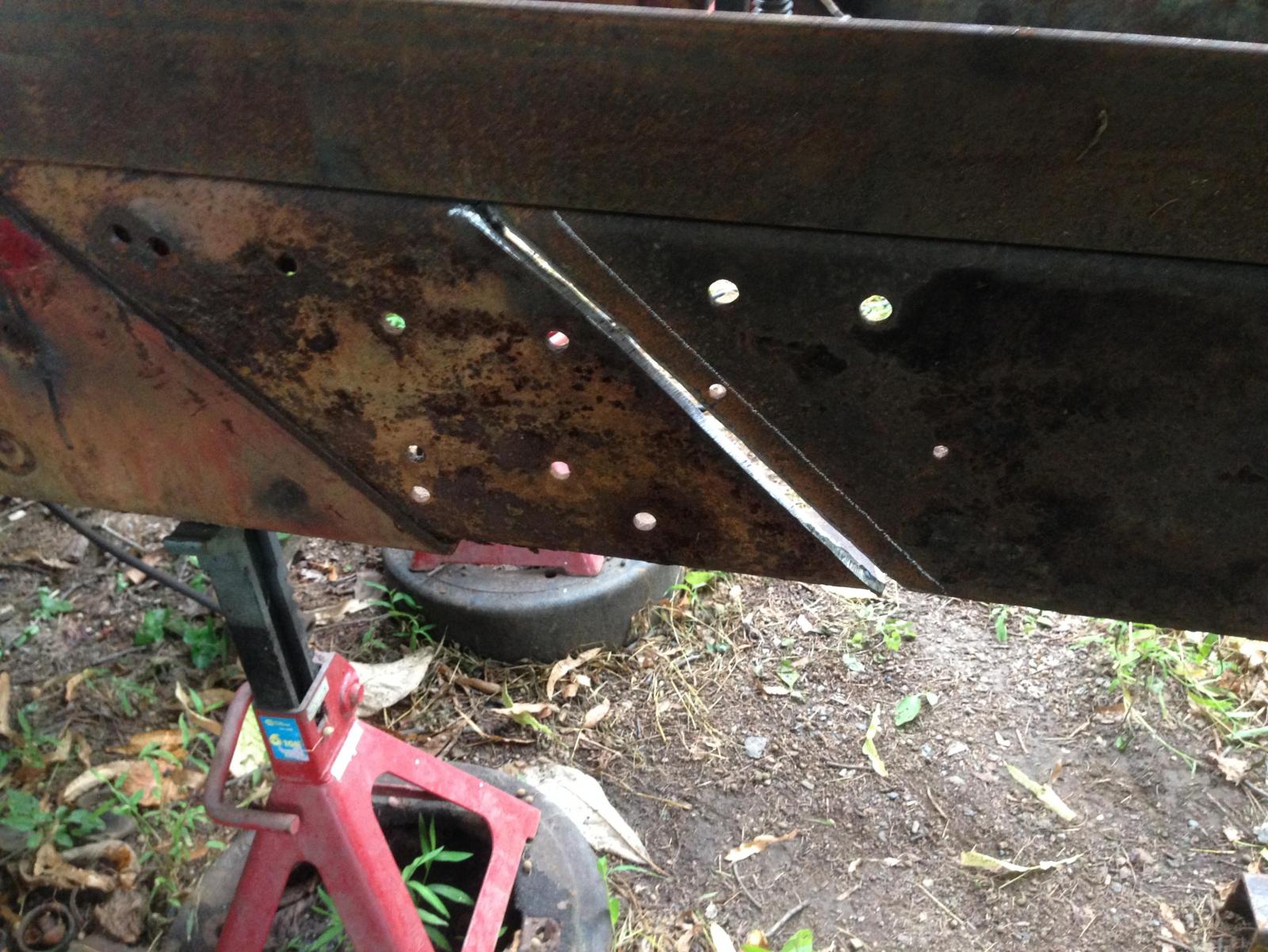

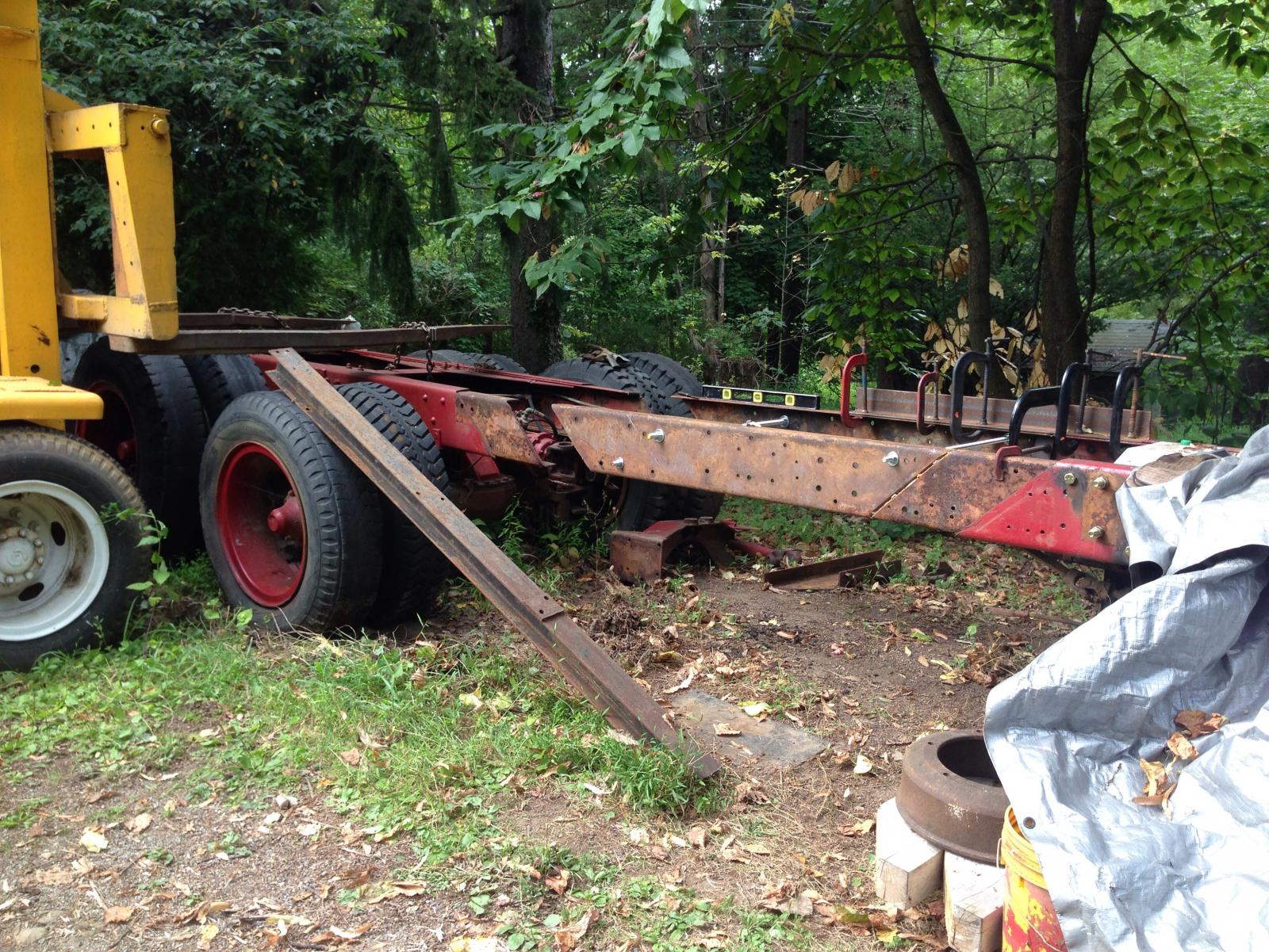

  7. I got donor rails from a truck that was being scraped. The inner rails are now tacked in place. Going to get everything leveled and tie the pieces together to get a rolling frame again... As promised 2 pics of the 54 packard panama super clipper...

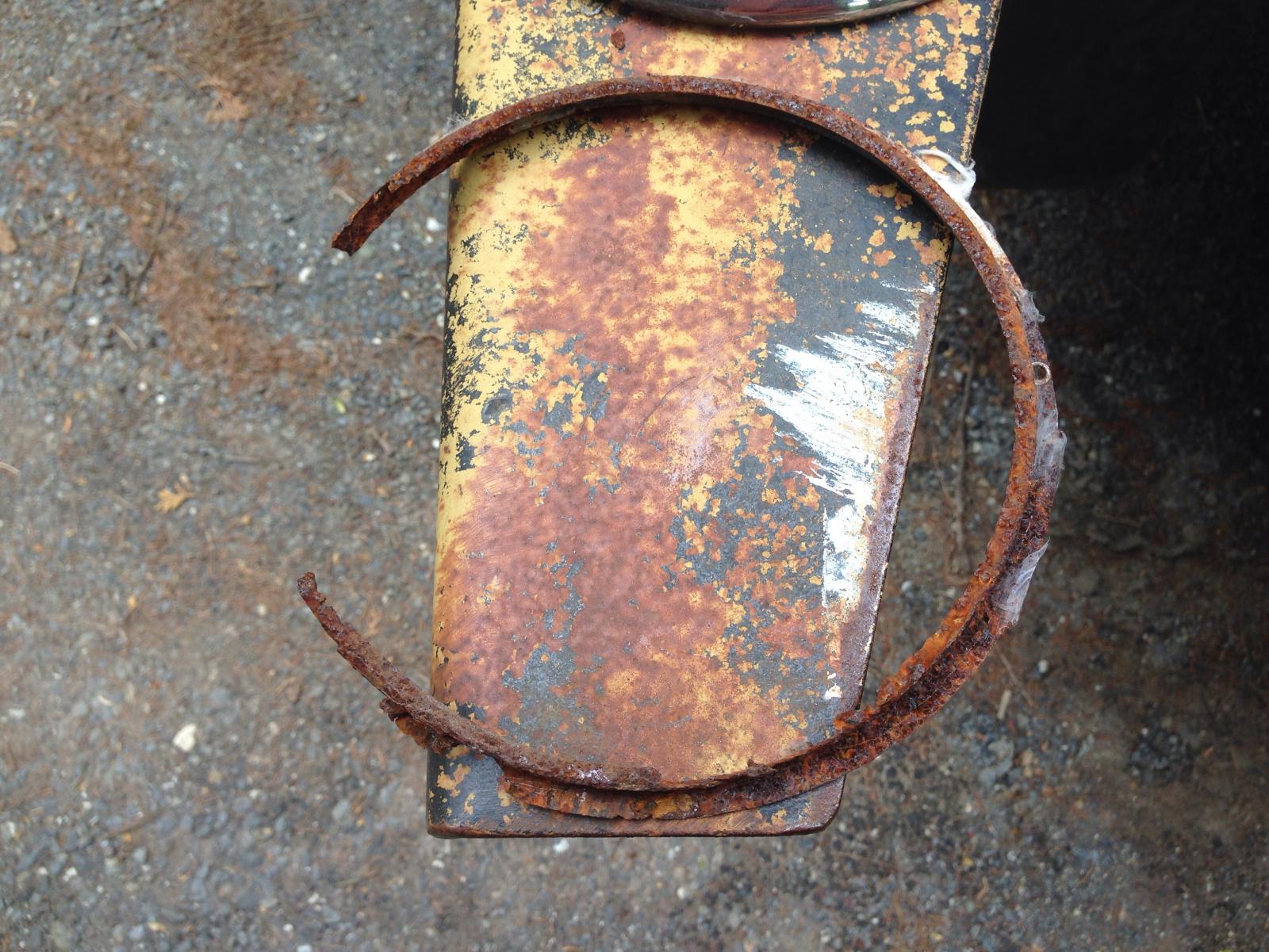

  8. 54 packard super clipper. I'll post a pic latter. And I should say the rat rod I'm building as well that's packard powered. And thanks for the help.
  9. Moving along slowly on this project due to above problem and working on my dads 54 packard.

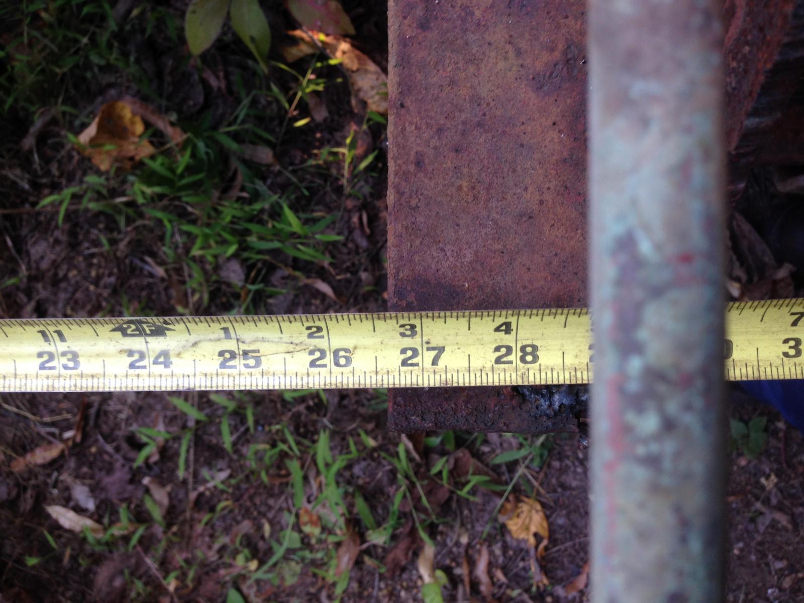

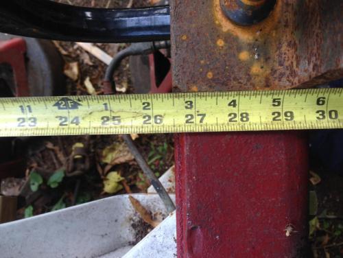

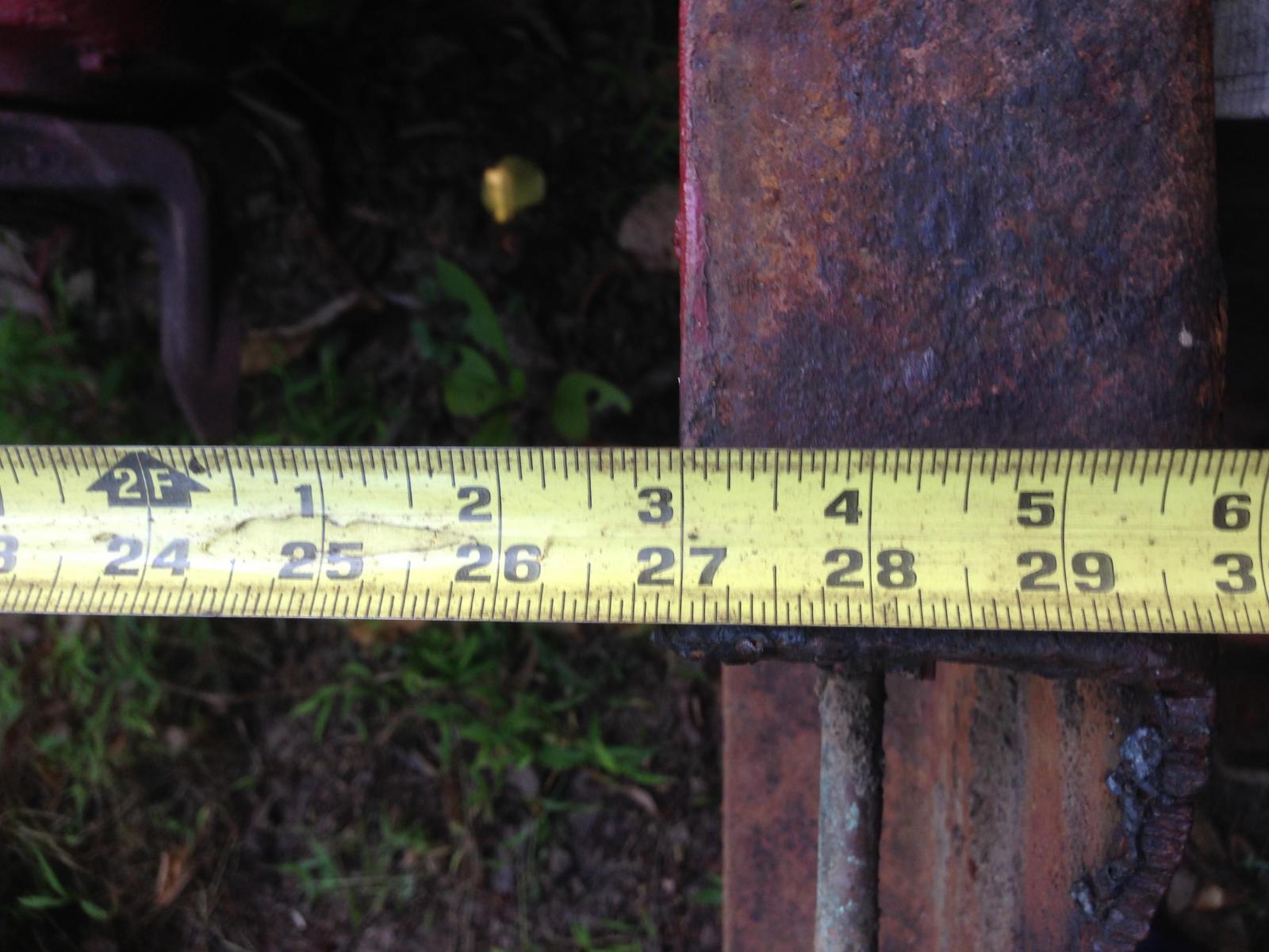

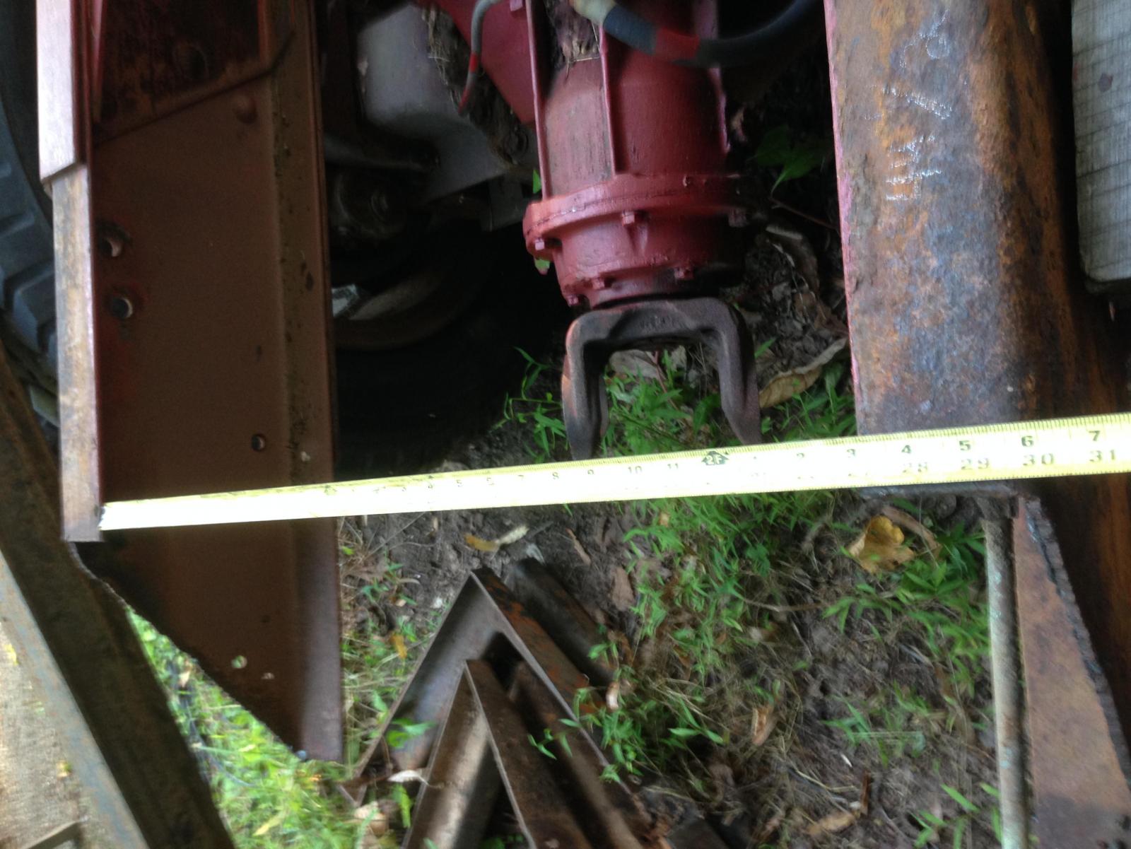

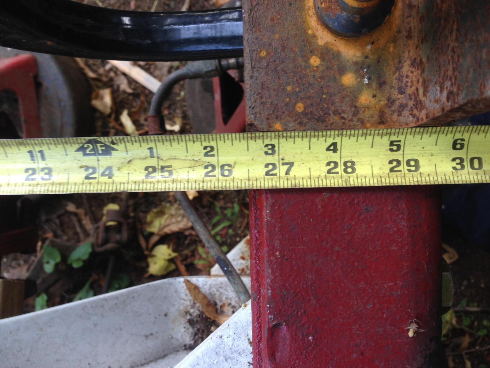

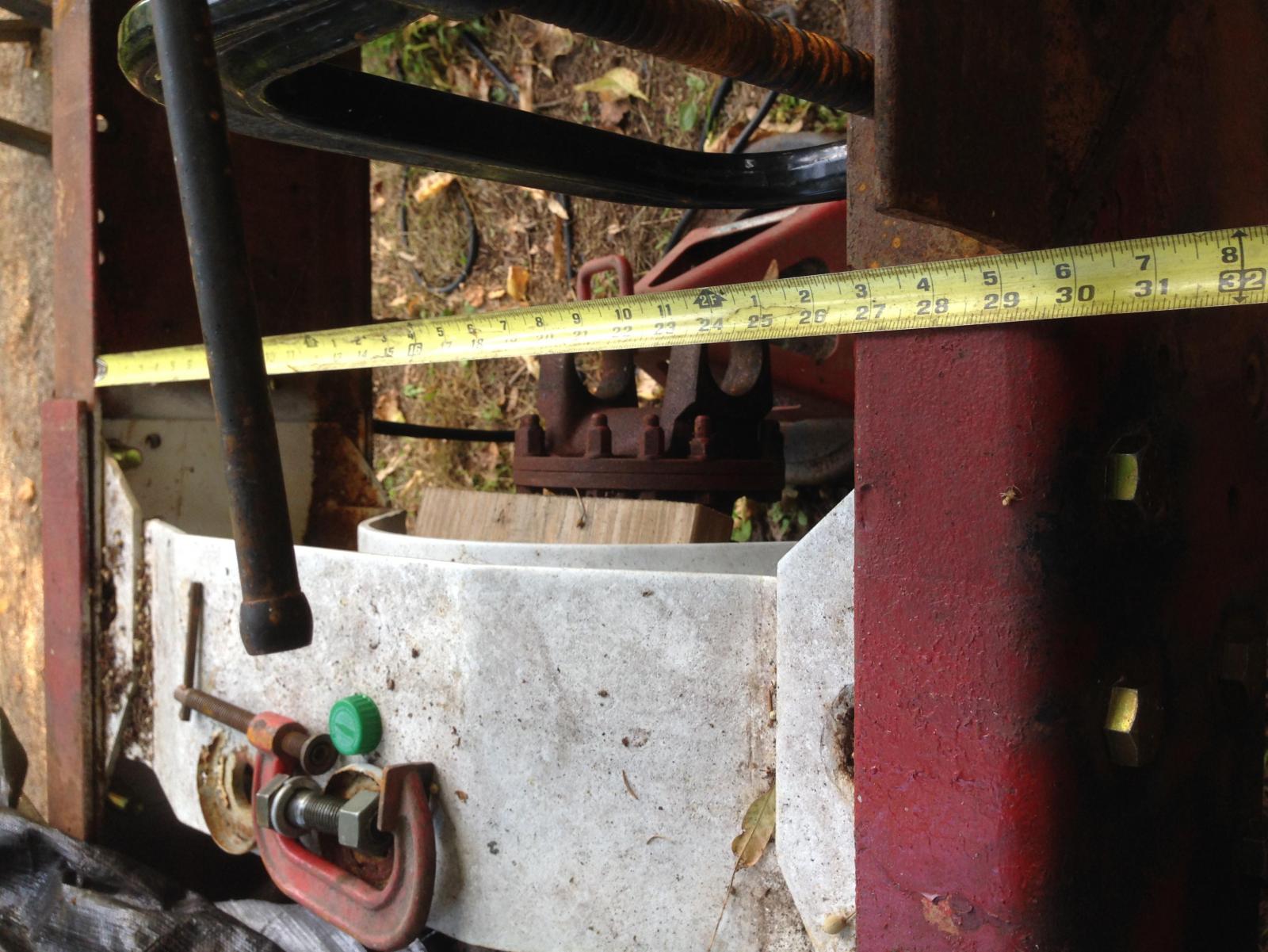

  10. Frame rail dimension issues. On the inside of the rail at the cross member that the cab sits on I got 26 1/2 inches and at the rear section in front of the 3rd rail I got 27 inches.

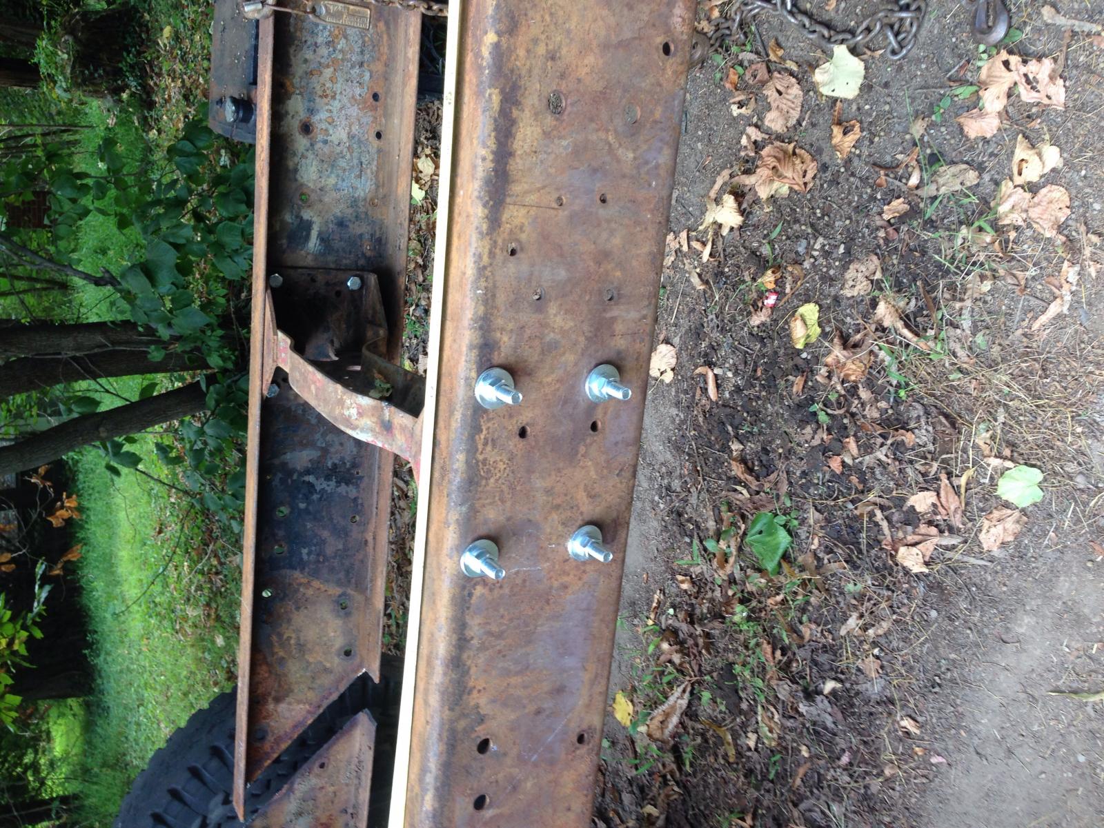

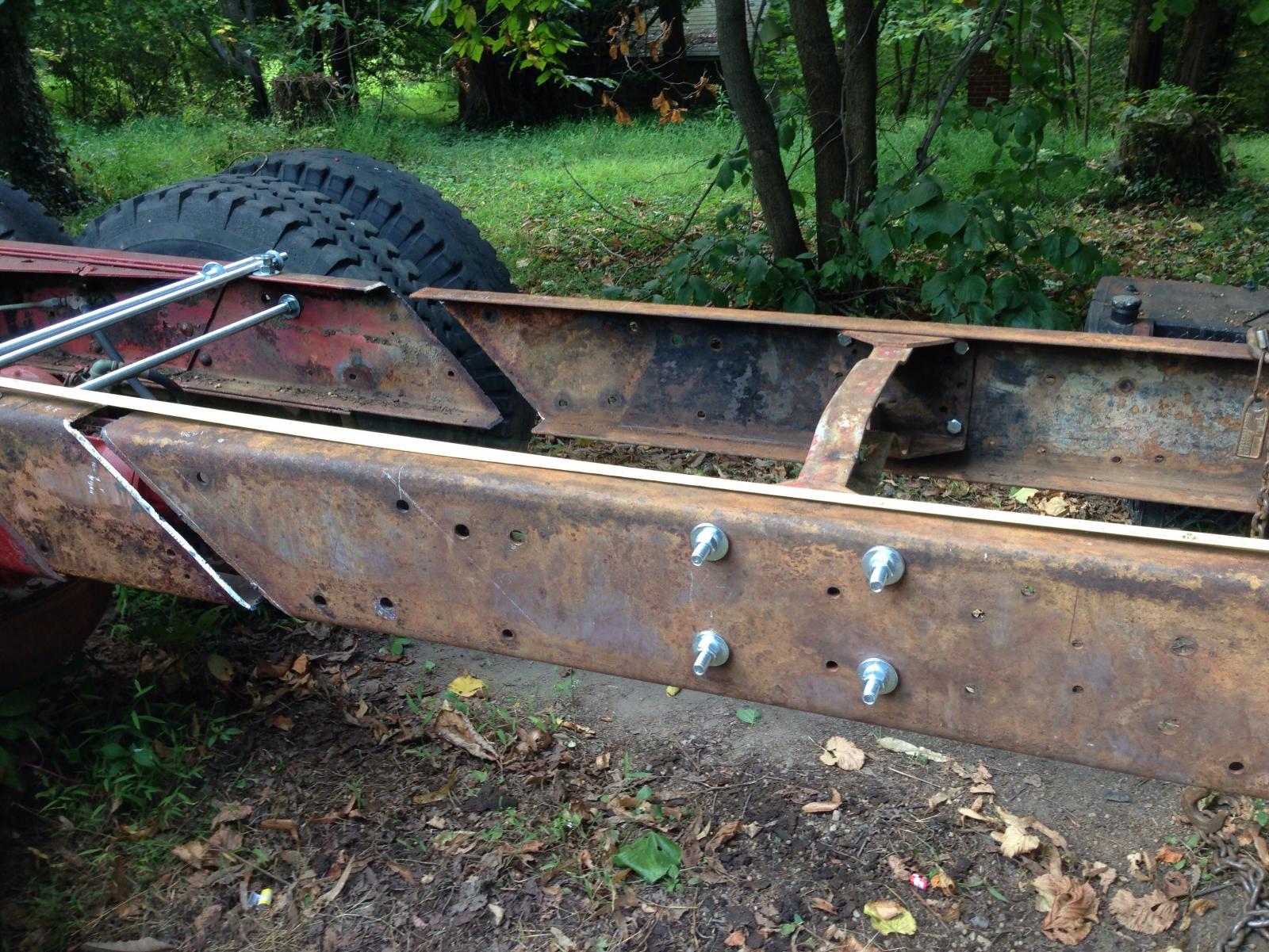

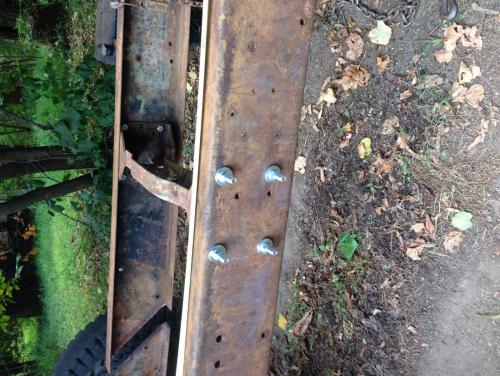

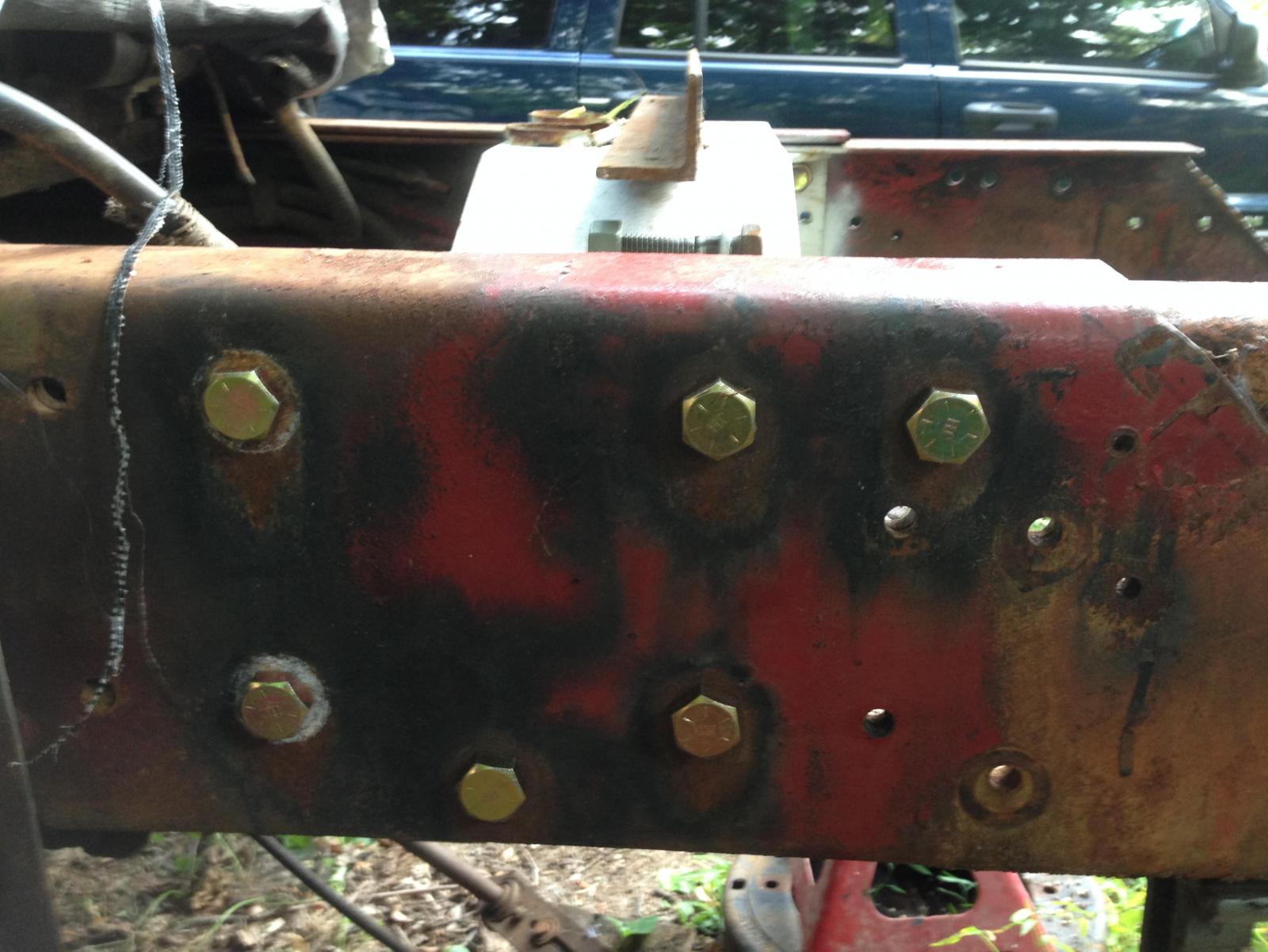

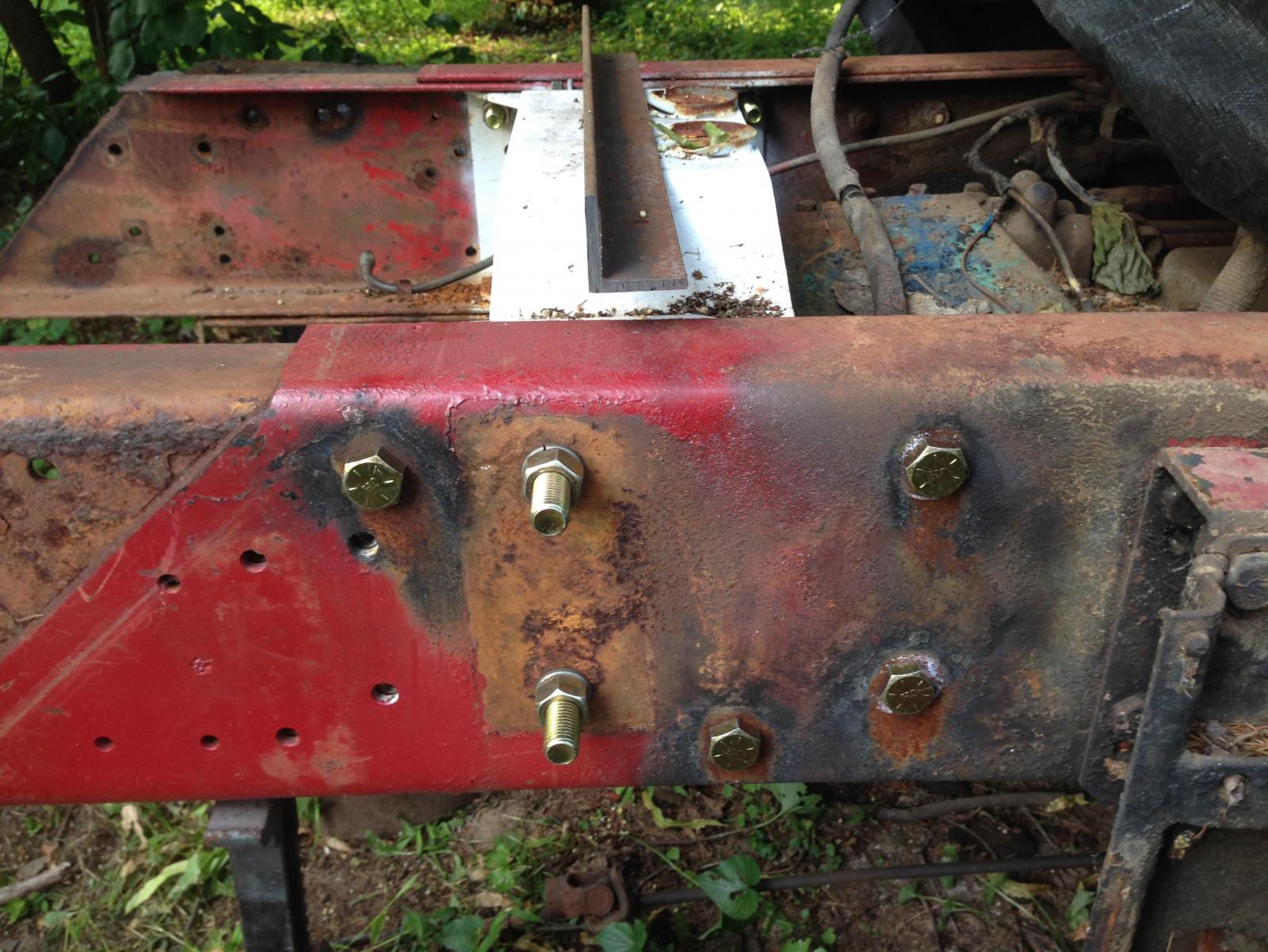

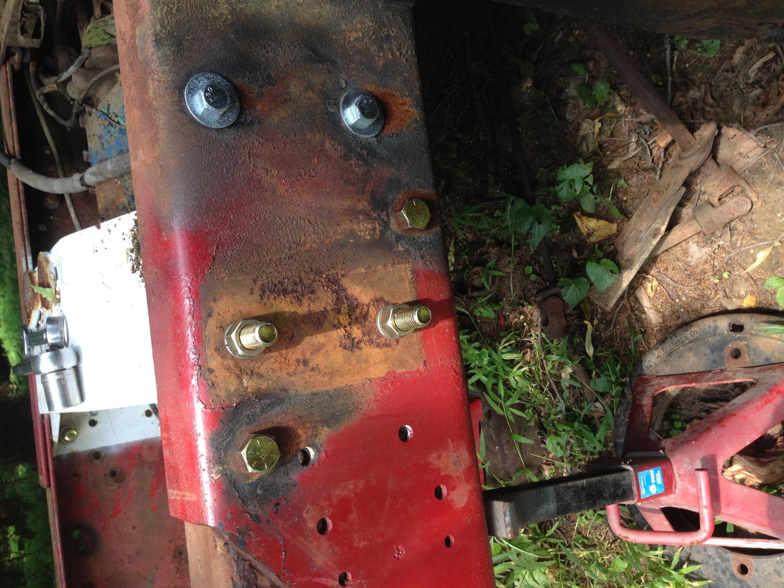

  12. The 2nd and 3rd pic in this set show the grade 8 bolts instaled and torqued to 325ft lbs... Next week im going to start adding the 4ft section of strech, will post pics as i go.

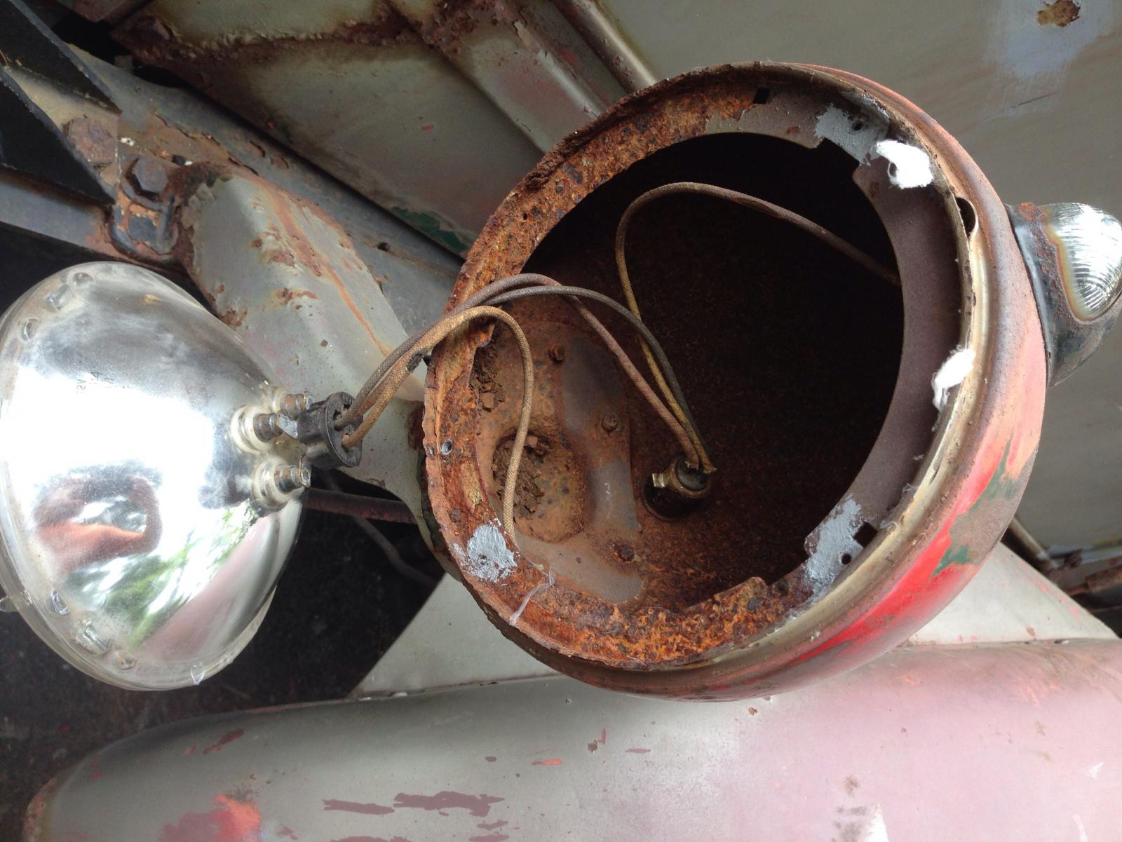

  20. Anyone know how to get this wire connection apart?
