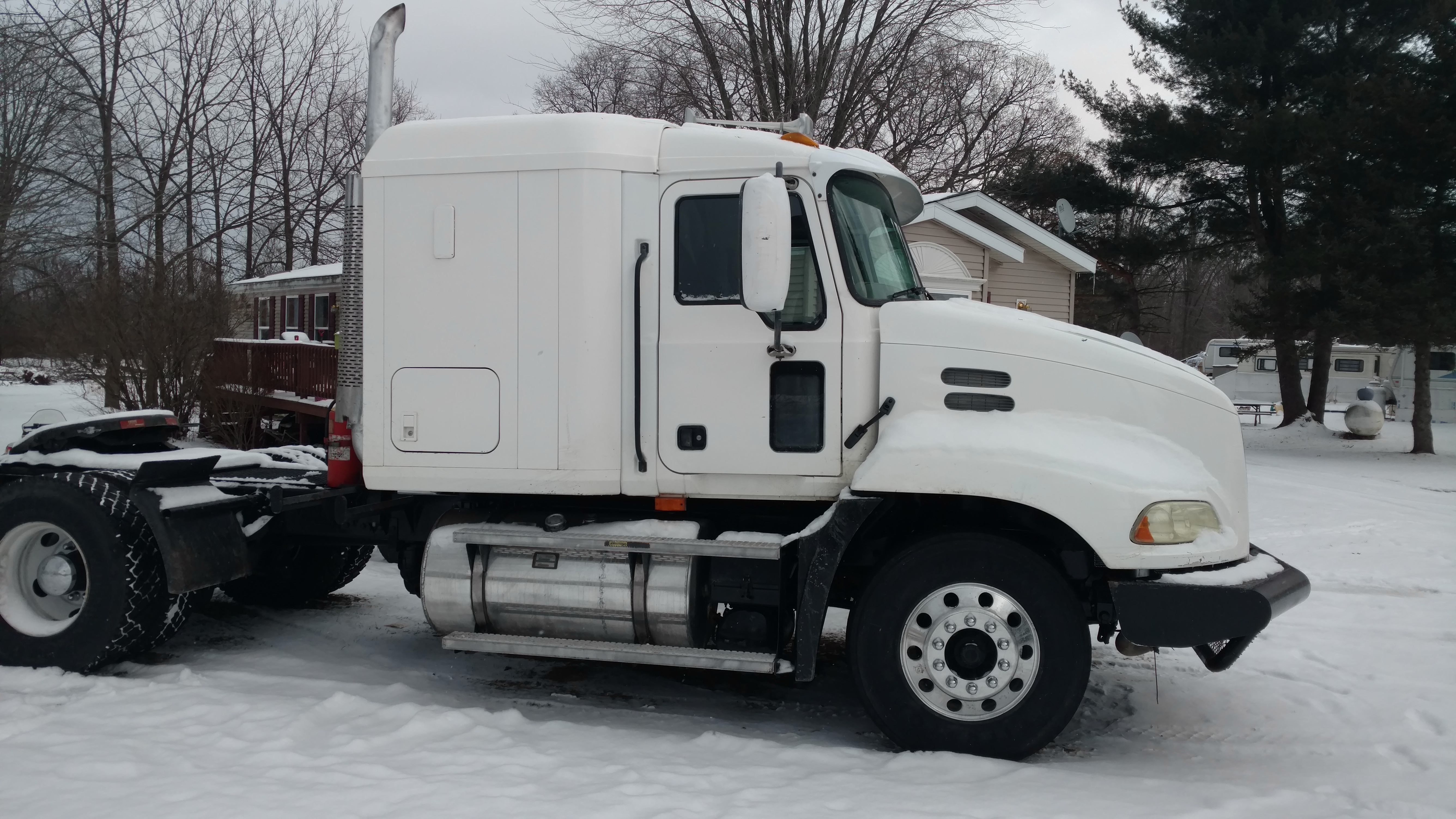

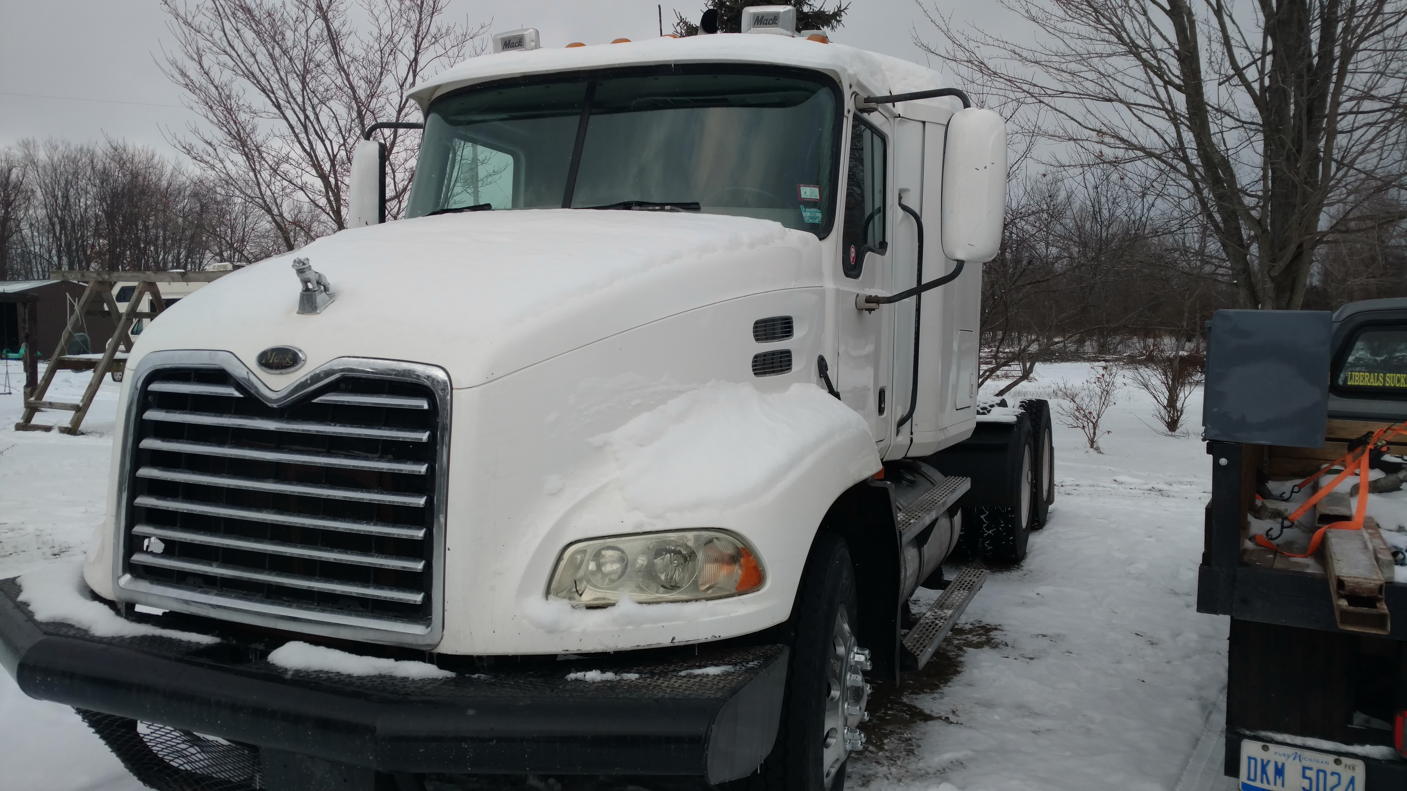

	Here's a couple of pics of the beast. I was told on here if there aren't any pics, then it doesn't exist! And before anyone asks- yes, the smoke stack is now turned in the right direction. This was just after I got her home from Texas, to where I live in Michigan.
