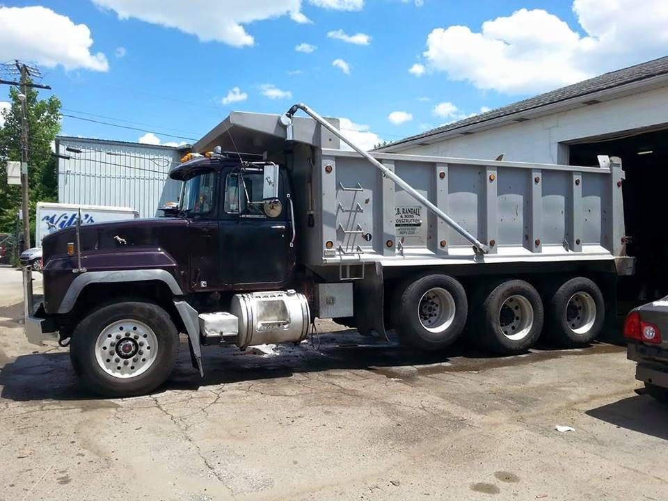

  5. RD 685s has 350 EM-6 4V with 7spd T2070 trans. 15' BMT Biebau box Truck now has hub piloted rims in rear, Spokes to pricey to replace 18 frt, 20 tag, 44 rears on Hendrickson.

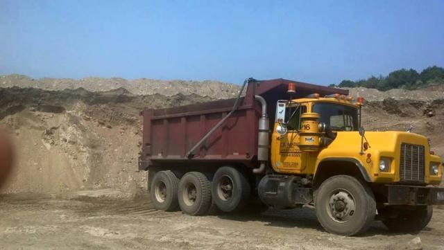

  6. RD 688s, 427 with 18 speed Mack 20 frt, 20 tag, 46 camel back
