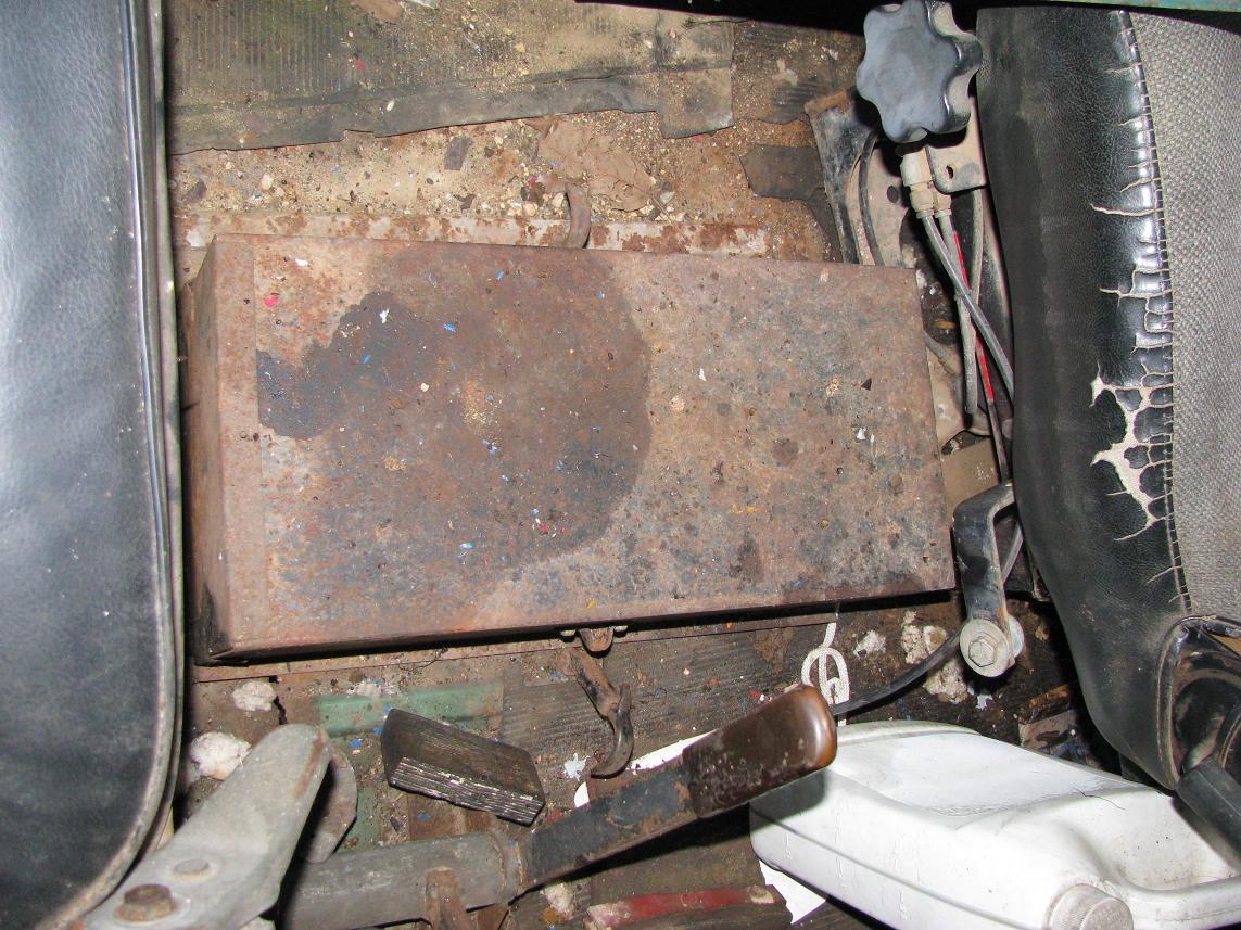

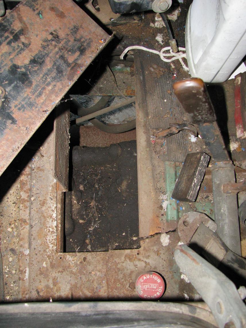

  5. what was the purpose of this box. i first thought it was a tool box, but there is no bottom. the box looks factory made.
