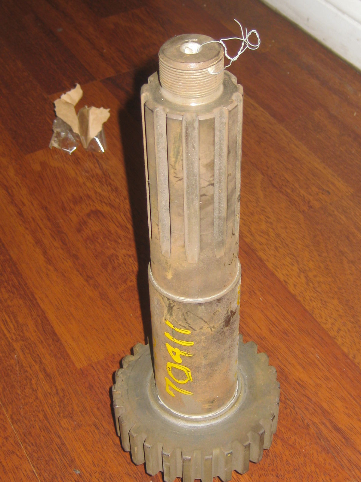

  1. Supplee bros had a few shafts and said thry replaced a bunch over the years from same thing but unfortunately no match. Have a couple machine shops that can do it, now just trying to get one to get it done in a couple weeks for about $1000.
  2. Waterous actually said this was fairly common caused by having parking brake on or trying to get truck over a curb or similar. They actually even had records that my pump shaft had already been replaced once in 1979 while still in service. In later years the trans and shaft were redesigned offering more strength but in this era the shafts just weren't strong enough to handle the power of the 707 cu in thermodyne engine. That's why they recommended converting trans and have the parts needed for that if I want to spend several thousand dollars.
  3. This is what it looks like, for sale on ebay, just not the right one
  4. See attached specs from Waterous. Yeah, shaft / gear, the one of the truck is all twisted and broken up. Finally found a machine shop to do it for $1300 but they need 8 weeks.... Another said they'd do it in a week, for $14,000, that one was a good laugh. Closest pump / transfer case I found several hundred miles away and a whole lot of uncertainty. Still goose chasing while trying to figure out if I can just run a small custom drive shaft temporarily to swap out later. Waterous 70375.pdf
  5. Thought I'd provide an update. Tracked down a few Macks with pumps, one from ebay winshield rig, two from D&D ('55, '64 & a '65) also talked to Cal Little and several others. Nothing short of great people all trying to help but unfortunately no match. Haven't heard back from ttttrucks, even tried dialing a Canada # from a post of his but not him. Also still trying to get in touch with the '61 Mack on ebay but won't return calls. Waiting on several custom gear manufactures for quotes, only one I got back wants $8k. Appreciate all the advice, we'll see what happens but looking like I might have to bypass pump and go with a custom driveshaft to at least get back on the road.
