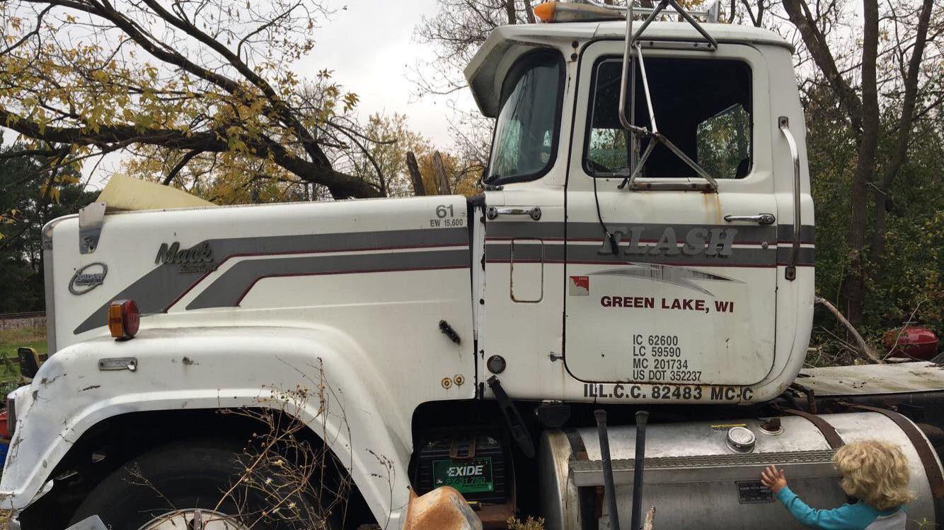

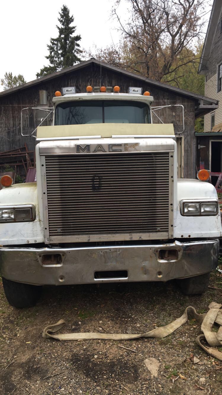

4v with dynatard The plan is for it to be a parade truck/ when the boss has to go out to the job sites. So we will be taking it down and doing it right. I think it's going to stay a day cab but we are going to stretch it to a 240" wheel base.

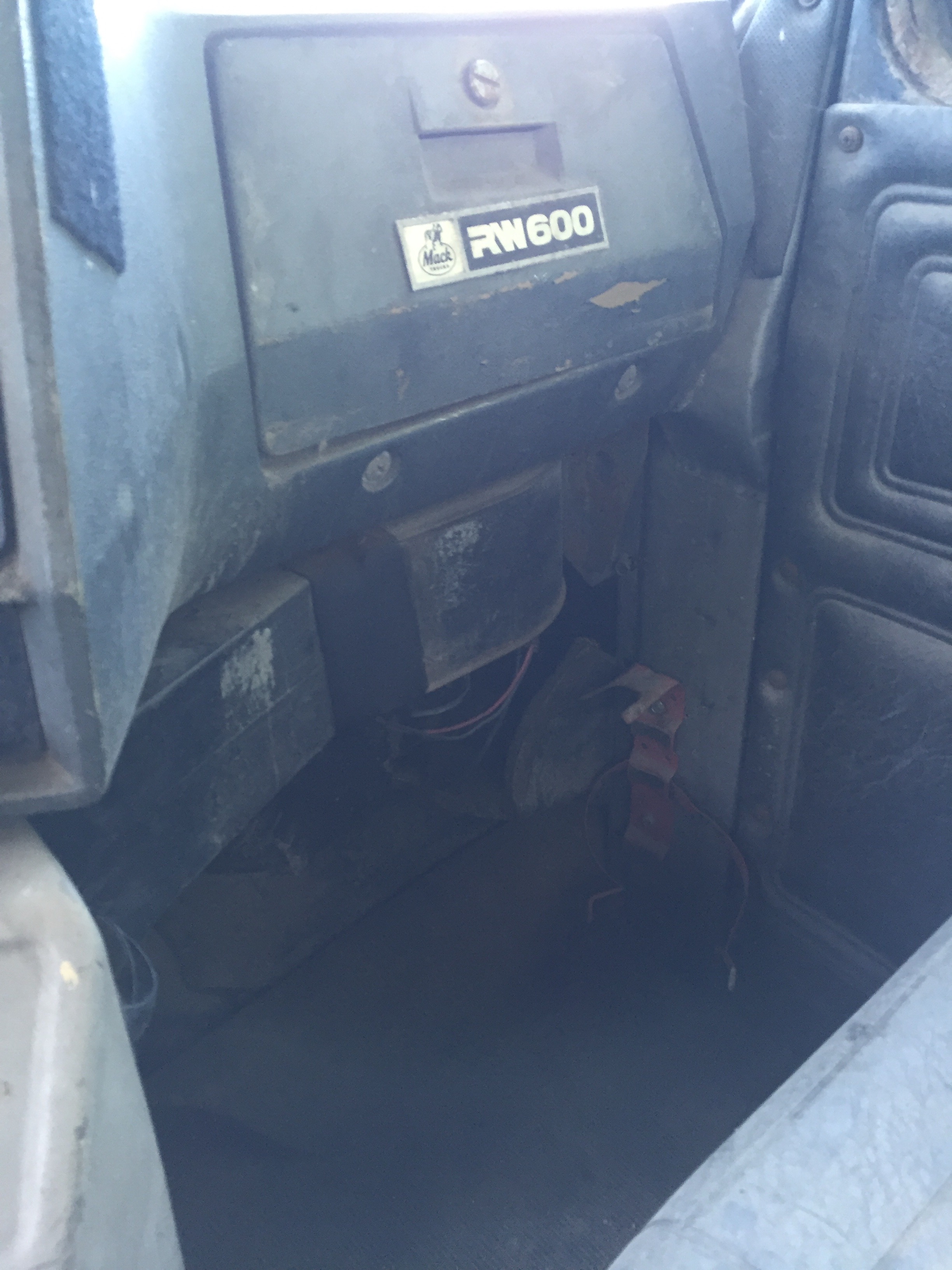

The guy it came from had it sitting in the back for 7 years. My boss told me he wanted to build a flagship for the company (all freightliners). Something that will turn heads. I told him nothing that has a freight liner badge will do the trick. . He laughed and said what are you thinking? I told him there is almost nothing that looks as good as a superliner but that they are hard to come by. And we should find a needle nose Pete or kenworth. He started looking and found this truck a few days later I went down to get it. As far as the glider I have no idea.. I think the badge is generic cause if I'm not mistaken it's a rw613

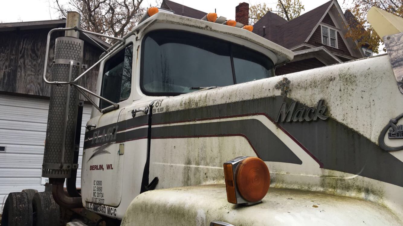

Some more pics it has over 1million miles and it's a bit on the tired side but we will be taking in this winter and giving it some new life.

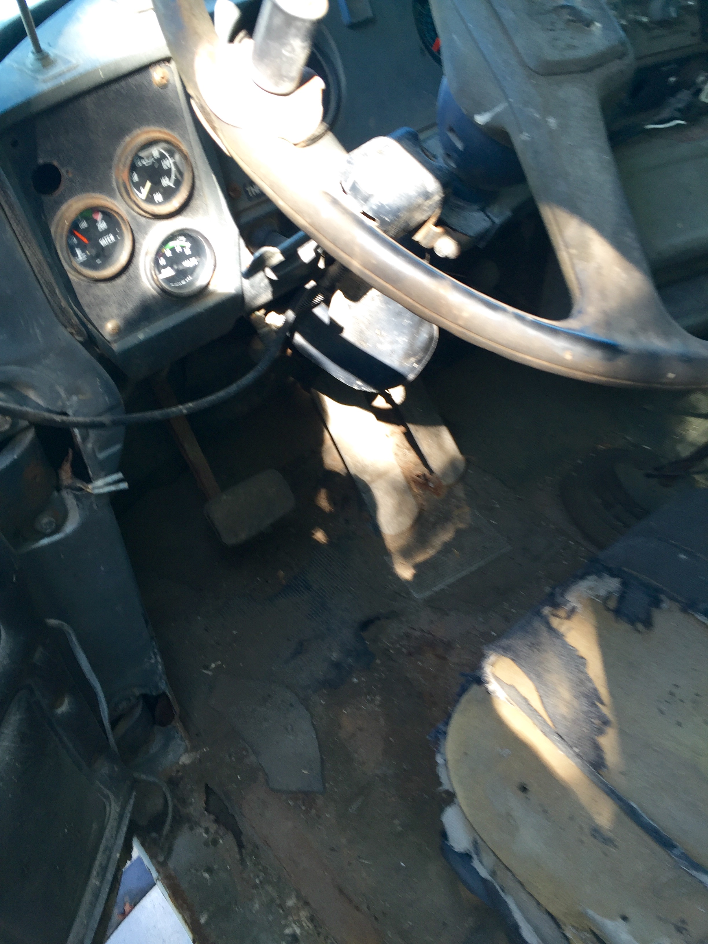

Well I have been asking some ?'s about things about these trucks, so I figured I'd show some pics. We are in the tear down process now.

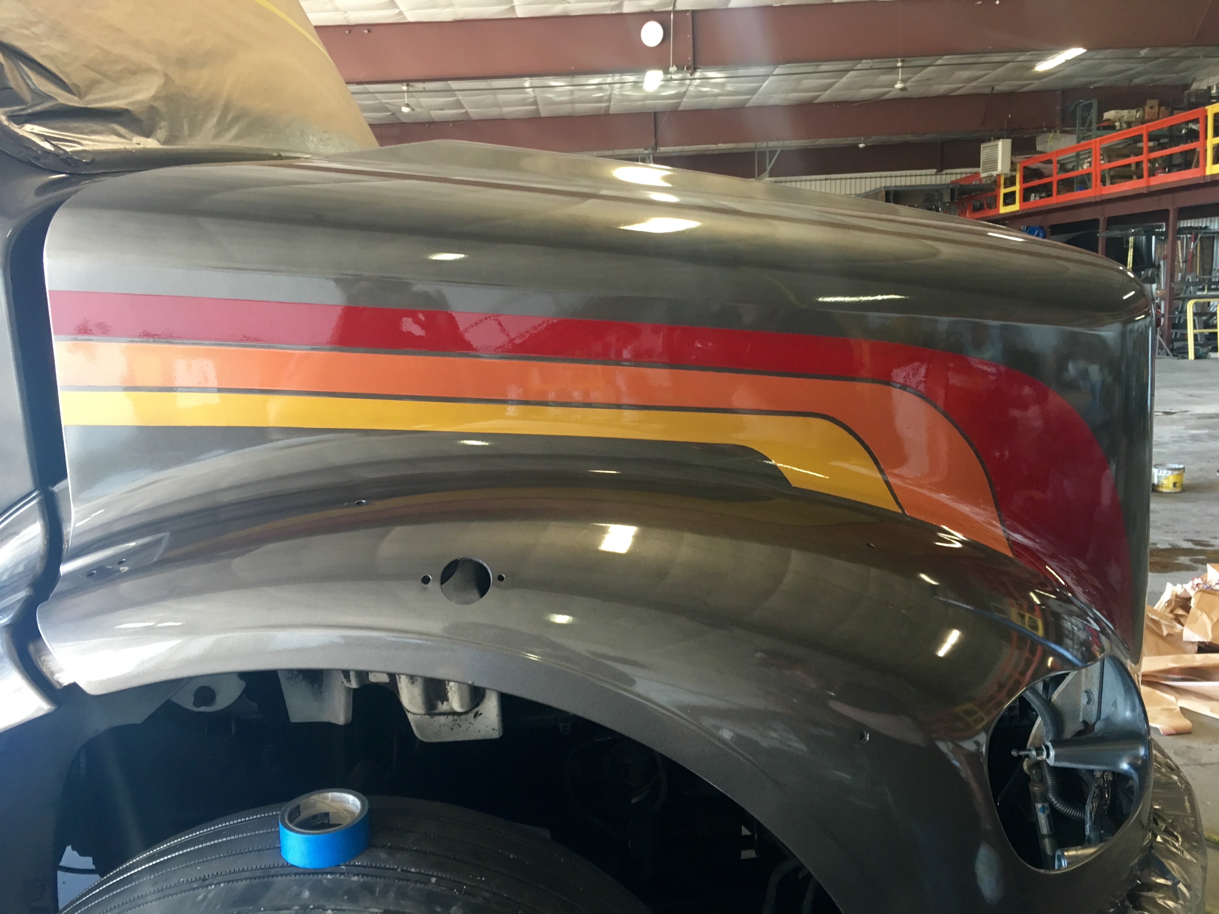

It looks good you don't notice the paint layer just looking at it. You have to run your hand on it.
The stripes were a after thought. The truck is a single stage urethane. then I taped off the area sanded it and painted the stripes one by one taping off each one and cleared just over the stripes. If I would have known I would have base coated the truck. Painted the stripes then cleared the whole thing. That way you don't have a ridge.
I agree it's crazy how it's getting I hate the prep but the paint makes the prep worth it. I also enjoy laying paint down.
I thank you sir. My dad held a high standard when I was in the shop doing anything. And it stuck with me over the years. I look at my paint and still see all the flaws. And things I could have done differently. I laugh cause my dad stopped by and he still holds me to the standard and will point out the stuff. I guess it's a tough love.
Thank you, I am no painter. I usually paint a couple things a year and when I go in the paint supply store I am shocked by all the new products. It's def a info overload. My hats off to the guys that do it everyday and are able to keep up with all the new tech. Being a mechanic the basics never change. As a body guy they change weekly.

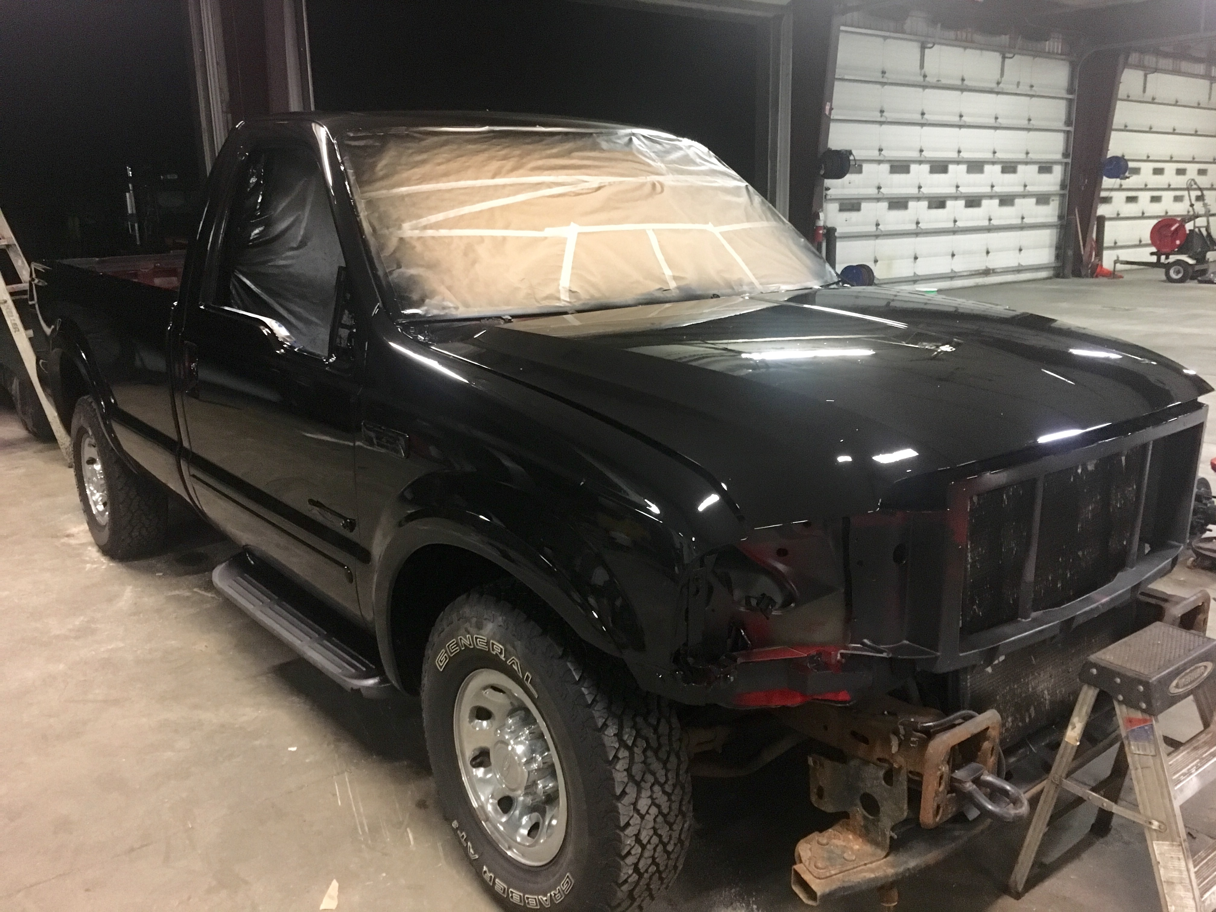

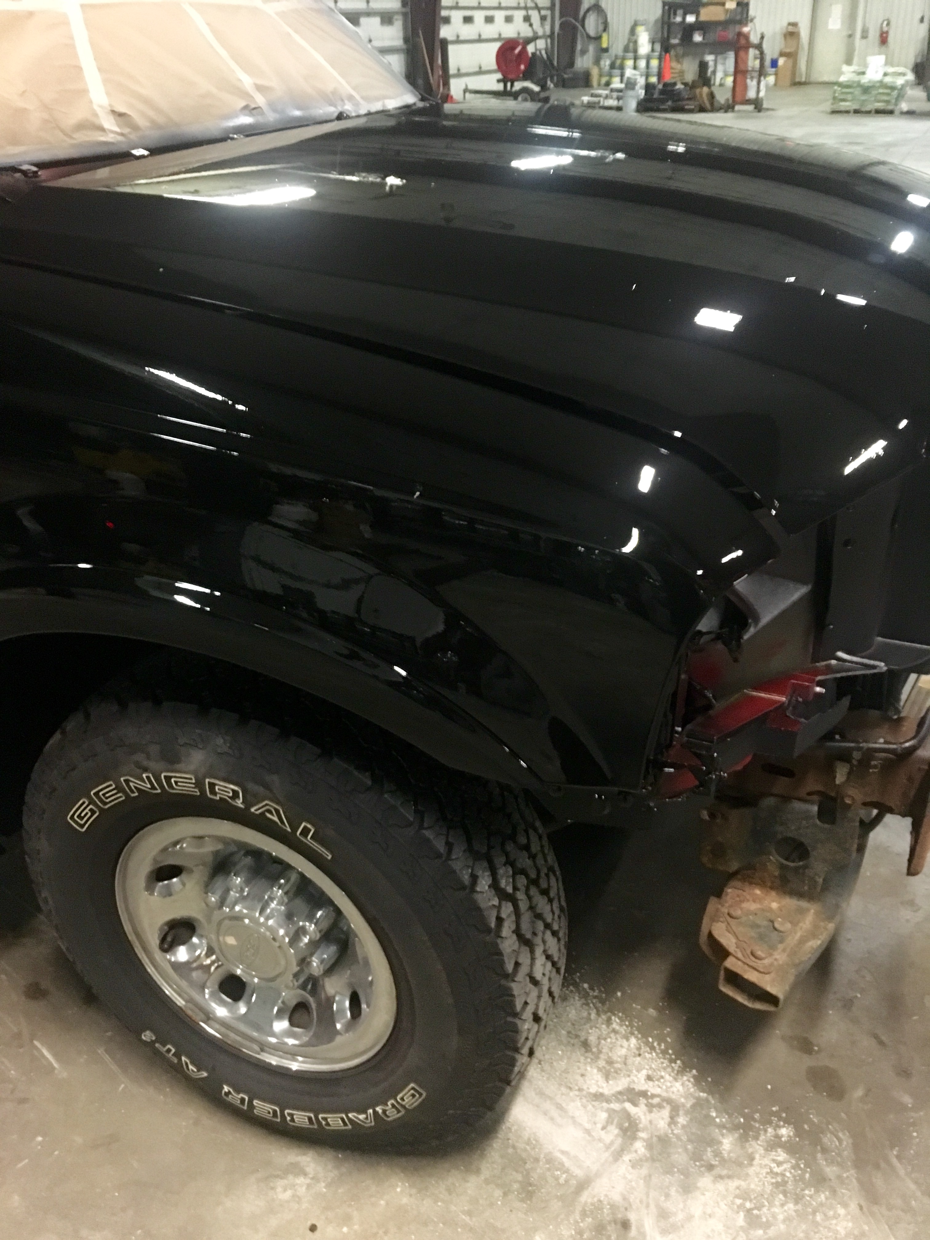

I am a mechanic by trade but I grew up a body mans son. My boss loves that I am willing to do basically whatever. Hear are some jobs he "made" me do.I changed the color from white to charcoal and painted the stripes.this one I changed from red to black nothing fancy but I thought they turned out pretty good.

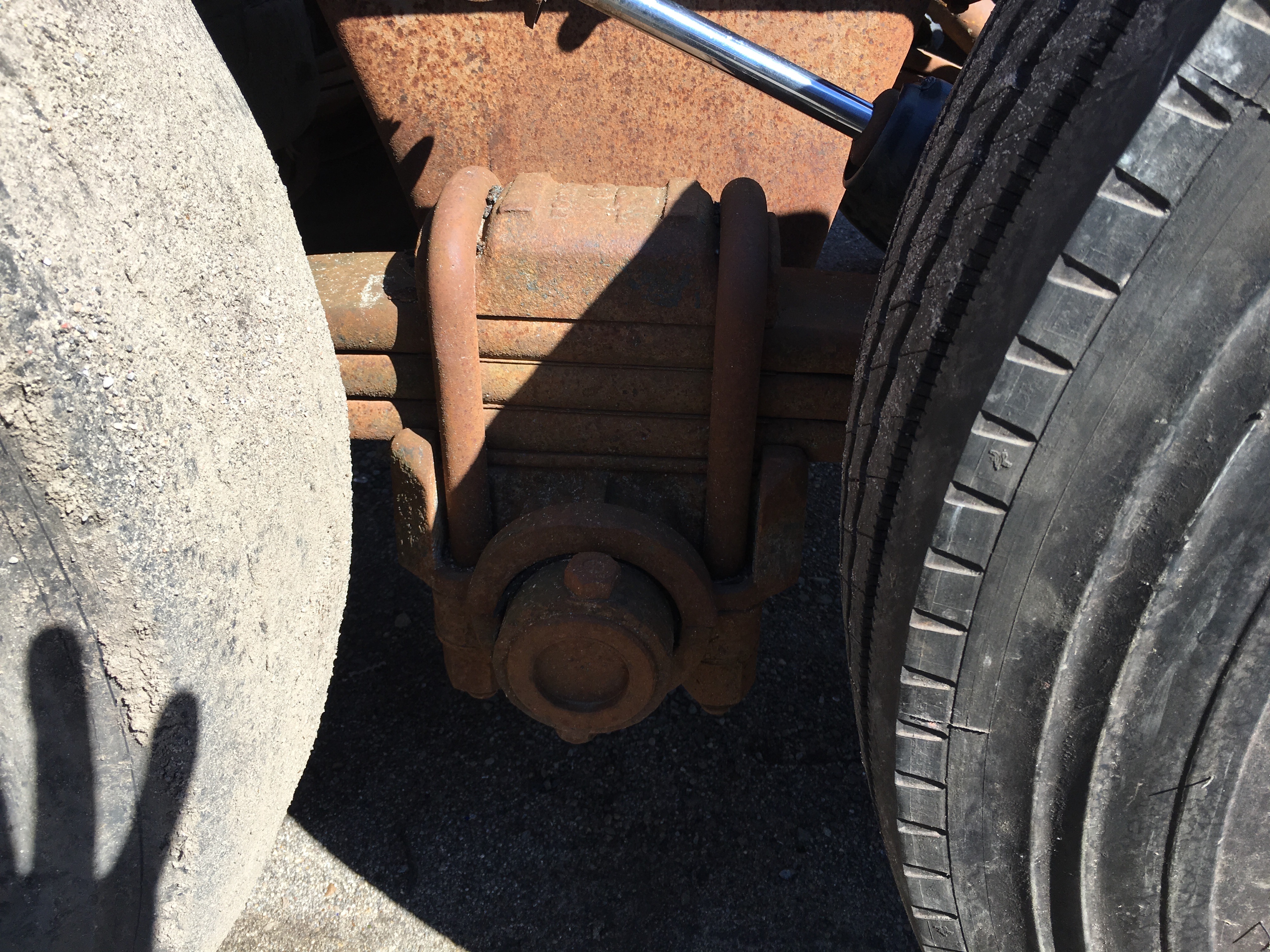

For the miles the truck will see, ride prob isn't a big deal. The truck is in the works to be a parade/back up hauler only for when he goes out. I would just hate to have problems with the taper leaf.
Maybe we will just swap it over to the trusty camelbacks and not worry about the taperleaf. With a air ride cab the ride shouldn't be too bad?
It's a play truck more or less but we have a good trunion so we may as well replace it.
Thank you good sir's. So it might be best to leave it there on a truck that is more play than work. The trunion is cracked and the boss got a cut off with a hd one and 44k camelbacks. We were going to just swap the whole set up onto this truck but if the taperleaf is a better ride then we might just swap the trunion and reuse the taperleaf.
What kind of spring setup is this? As always thanks for the info /wisdom. Sorry for all the ?'s . I'm just a noob trying to learn all I can.
