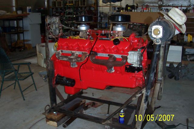

  5. http://www.youtube.com/haystack155 Anyone interested, You can hear her run on utube. I've changed the head and one piston on the right front bank since. The vapor coming out of the water jacket is just warm air. It was pretty cold in the shop and had no water in it. It was only run the 2 1/2 minutes. We, also, wear ear plugs. Cayoterun

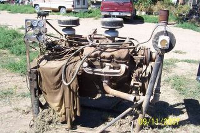

  8. All this engine has known is natural gas. It ran stationary on a 10" water pump from '64 thru '85. I tore it all down, and cleaned all the gunk out I could. Put a used head and two used pistons in and it runs pretty good now. Of course, new parts are history. It has .30 over propane pistons, and standard bearings. The engine has the equievelent of 5.5 million miles on it. That's stationary, 24/7 for about 6 mo. a year for 21 yrs. No telling how many times it was overhauled, at least one bore job. All engines run a long time on the pumps. Must be the constant temp, lube, & rpm. The farmers loved these and V-6s both. The sure burned lots of fuel. It smoked pretty bad on first start up, but changed one head and piston, and it runs pretty clean now. It will always use some oil tho. A neighbor had one, burned propane while natural gas line was being worked on. It used 22 gal an hour on propane. They are a simple and easy old engine to work on, aren't they? I'm enjoying trying to get it up and running in something. Feel like I'm saving a piece of GMC history. Cayoterun
  9. The V-6/V12s were built by GMC from '60-'66. I went to work for the guy that put this engine in service in 1964. I came out of the Army and started taking care of it in Feb. '65. Decided I wanted to do something besides old cars/travel trailers. The engines are almost all gone to the scrape pile. Found this in a neighbors barn. Was reunited with her after 42 yrs. She's up and running now, and am wanting to put her on a 1-ton truck frame and suspension/w a '62 GMC cab and front clip. Have a video of her first start and run on Utube. Cayoterun
