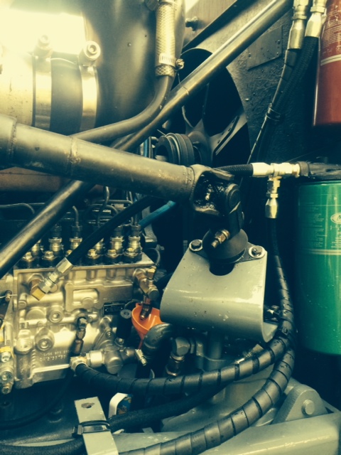

  1. Hey guys good news .... On the advise of another pump man I put a non-return valve in the line between the green filter and the fuel pump. It has started with no problems for 2 mornings now. Fingers crossed this is the solution. Thanks for all input and advise. DAVE

  4. Paul - Thanks for the diagrams. The differences I have are 1. The pump is a full Bosch not an Ambac therefore there is no Puff Limiter 2. I have an air start which I put a tap on before the lubricator too eliminate any possible leaks here. It made no difference. I had this problem on a previous V8. 3. There is no tube in the tank for the return line. Fuel just goes into the tank through an elbow and splashes into the tank. I have taken the return line off the pressure relief value on the pump overnight and placed a funnel and cup underneath - nothing was captured - I assume from this that nothing was leaking or draining back through the pressure relief valve back to the tank. In what your saying, I don't know if it will suck back through the pressure relief value back into the pump in the opposite direction. Though this direction may need more investigation. Maybe I could put a one way valve (I have here) in that line to stop any possible sucking of air back through the pressure relief valve. Working today the truck was stopped for 2.5 hours and it wouldn't fire without priming. It is Pissssssssssssssing me off. DAVE

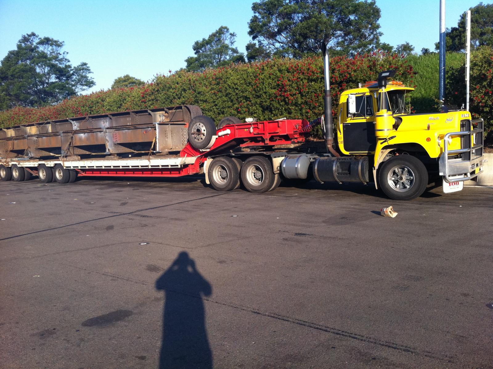

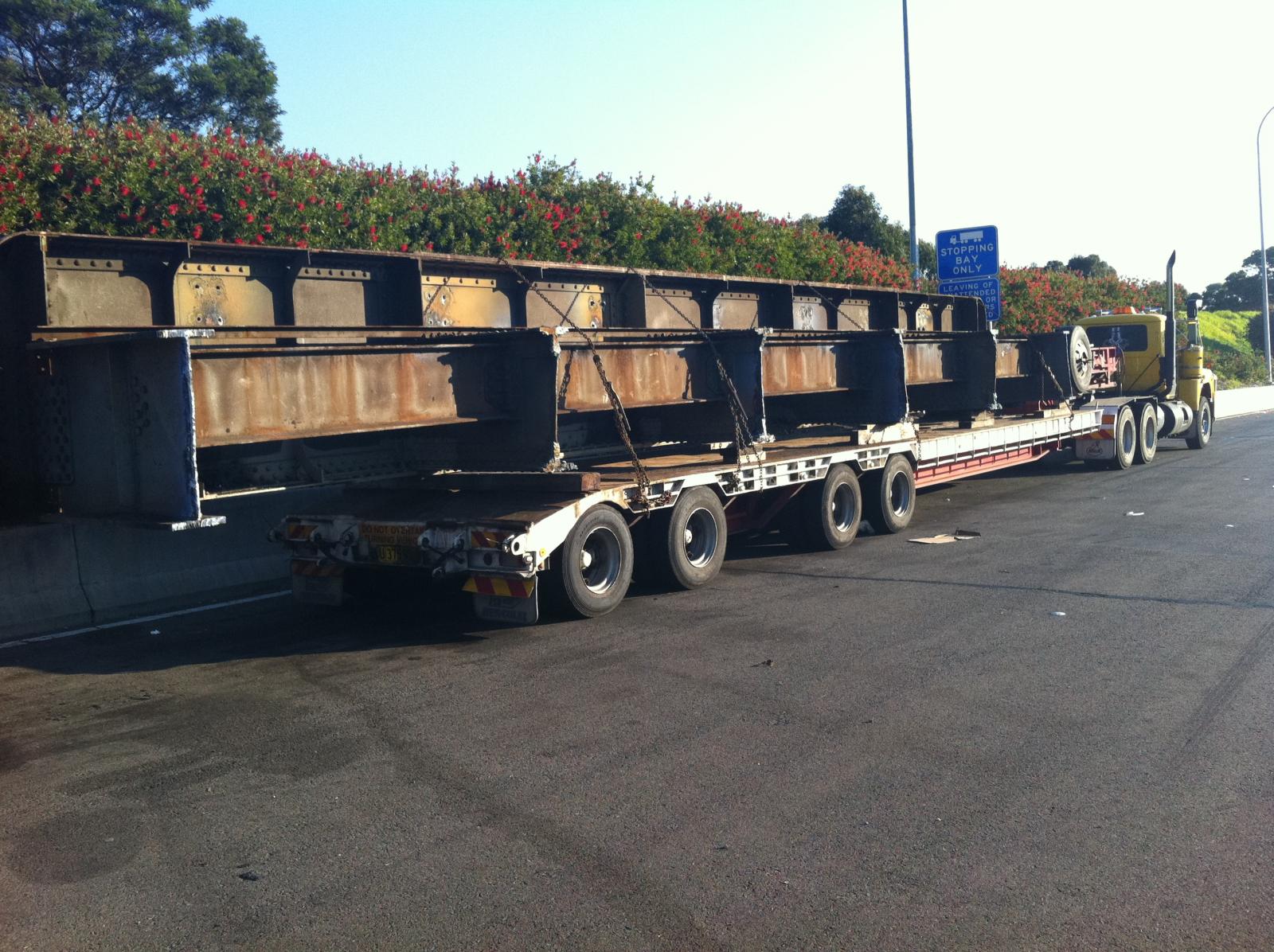

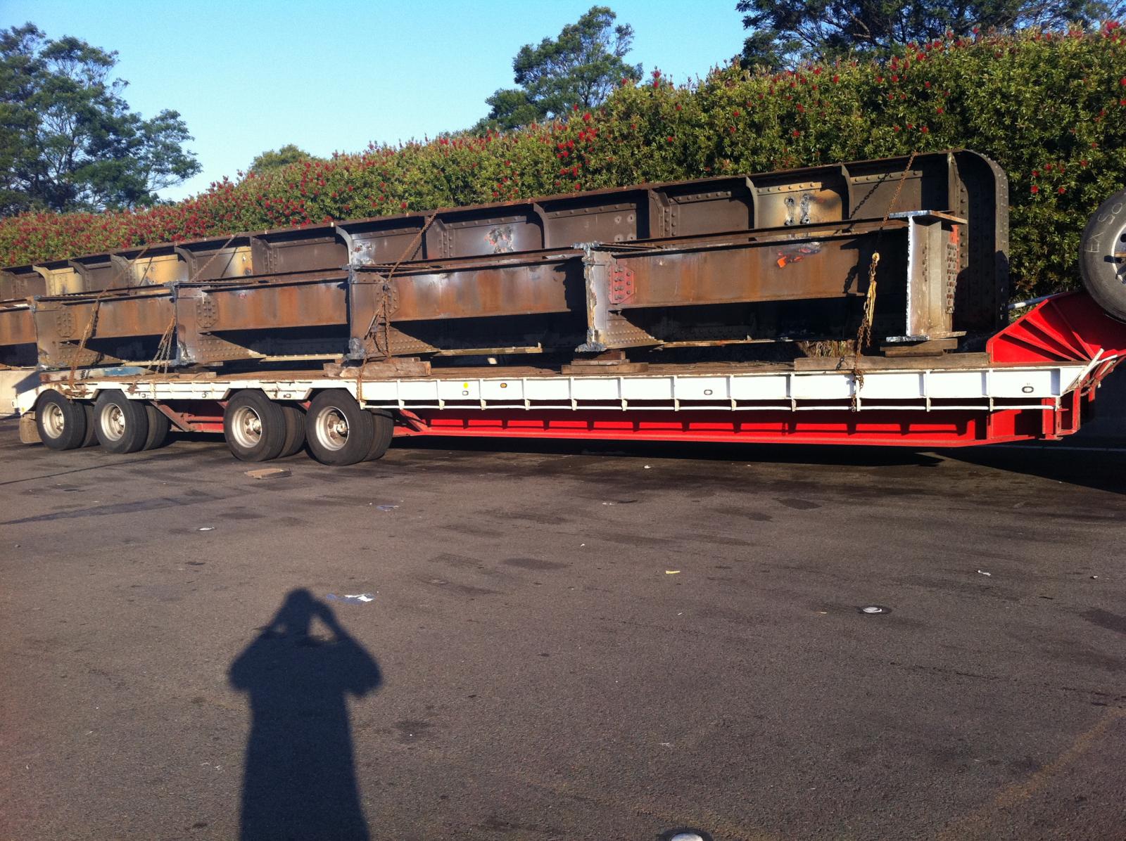

  9. Photo of the Old Dog working hard pulling a 26 tonne and 3.4m wide transformer from Inverell (highlands NSW) to a Sydney scrap yard. 750kms uphill and down dale - dog and driver worked hard that day.
  10. OK bad news - the problem is still there. Had to prime it up the last few mornings. Trying now by rerouting a fuel line to eliminate a potential problem from the line creating a vertical uplift into the pump. Probably not the answer but I am clutching at straws at the moment and it was suggested that the fuel line might be better to have a straight run all downhill to the fuel pump then that setup I had - see photos Also tonight I have disconnected the return line and placed a container under to see if any fuel is leaking this way.

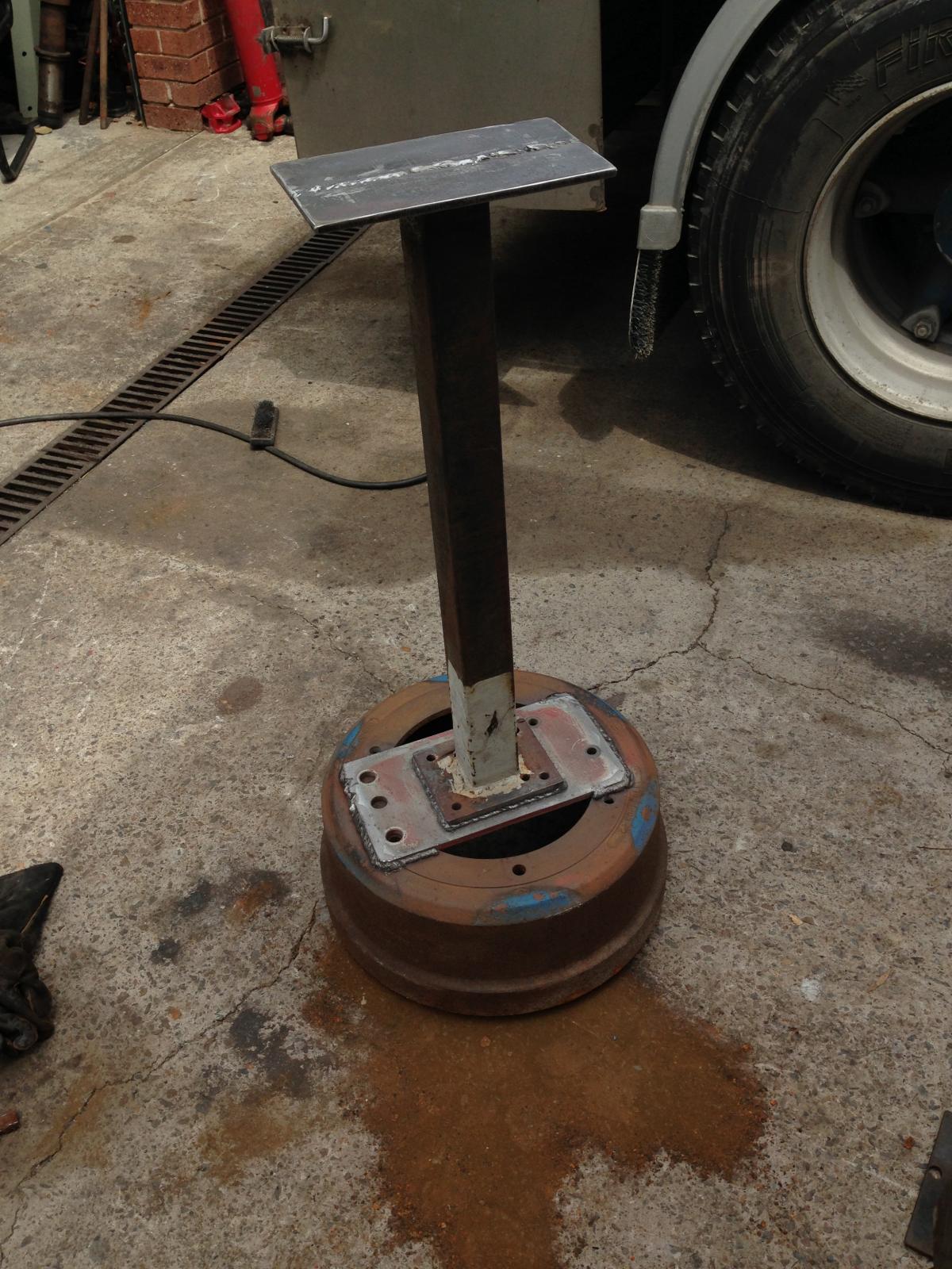

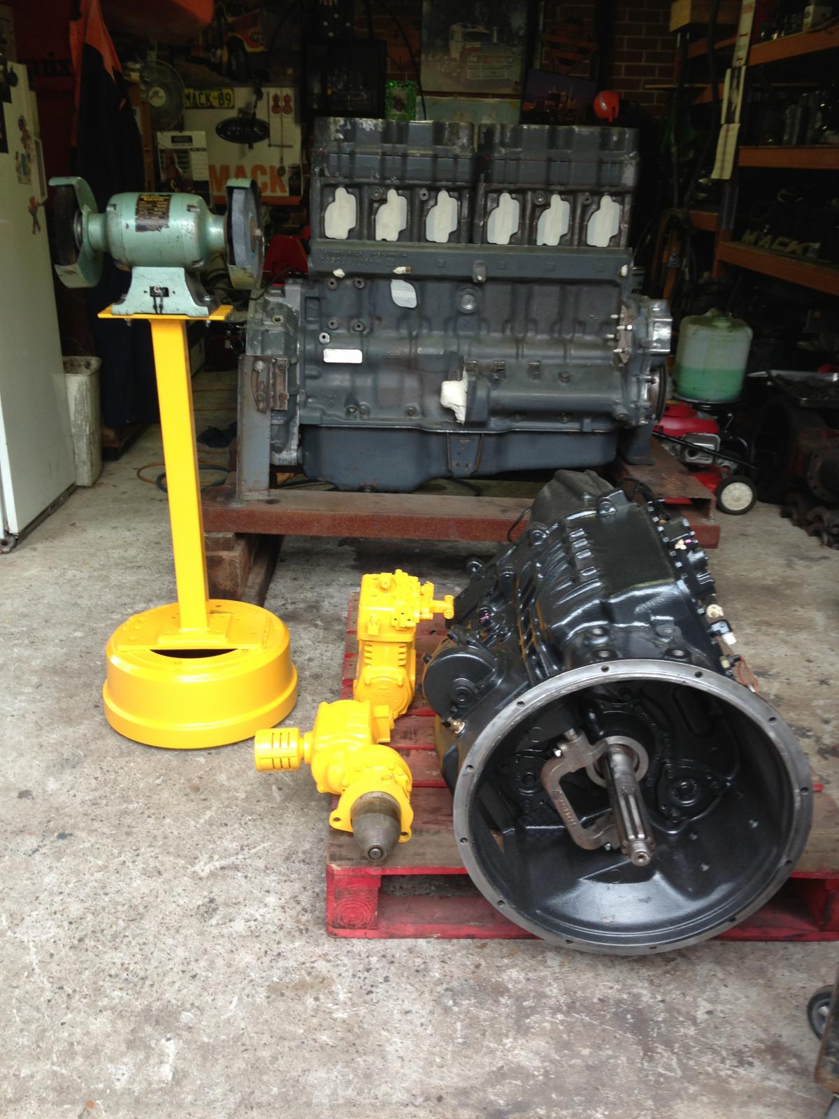

  12. Mucking round in the shed .... as you do ... and made a bench grinder stand with a Mack Brake Drum.
